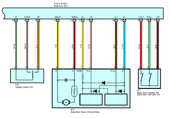

I'm not sure if #2 will work with this window. The motor has other "electronics" included. Does this effect a roll-up module?

I now have back window control on my remote.:D
I ran 3 wires from the tailgate (rear ECU) to the alarm system (behind glovebox).
These wires are connected to the tailgate key lock, at the ECU.
(LG-B) - (GY-R) - (V-Y)
They can now control the locks and when held for over 2 seconds, raise and lower the window.
I have seperate relays for locks and window, 4 total.
The alarm sends a quick .5sec pulse to lock or unlock.
And 2 extra channels send a 6 second pulse to raise or lower the window.
The hardest part was getting the wire from the rear ECU into the main body.

Another thing I found out.....
If you lock the doors with a key (or wires connected to the key switch),
then the unlock button on the inside of the door is disabled by the ECU.
So when connecting an alarm into the door lock system, I suggest you use the key switch wires, not the lock/unlock door switch.

Thanks. I was just hoping since both circuits go through the back door ECU, you could power either and get it to work. Thought I'd just give up, but then I said "what the hell!"
So, I ran the wires into the tailgate over the weekend. what a ***** of a job. tapped into the door lock wires, and voila! up and down functions on remote.
