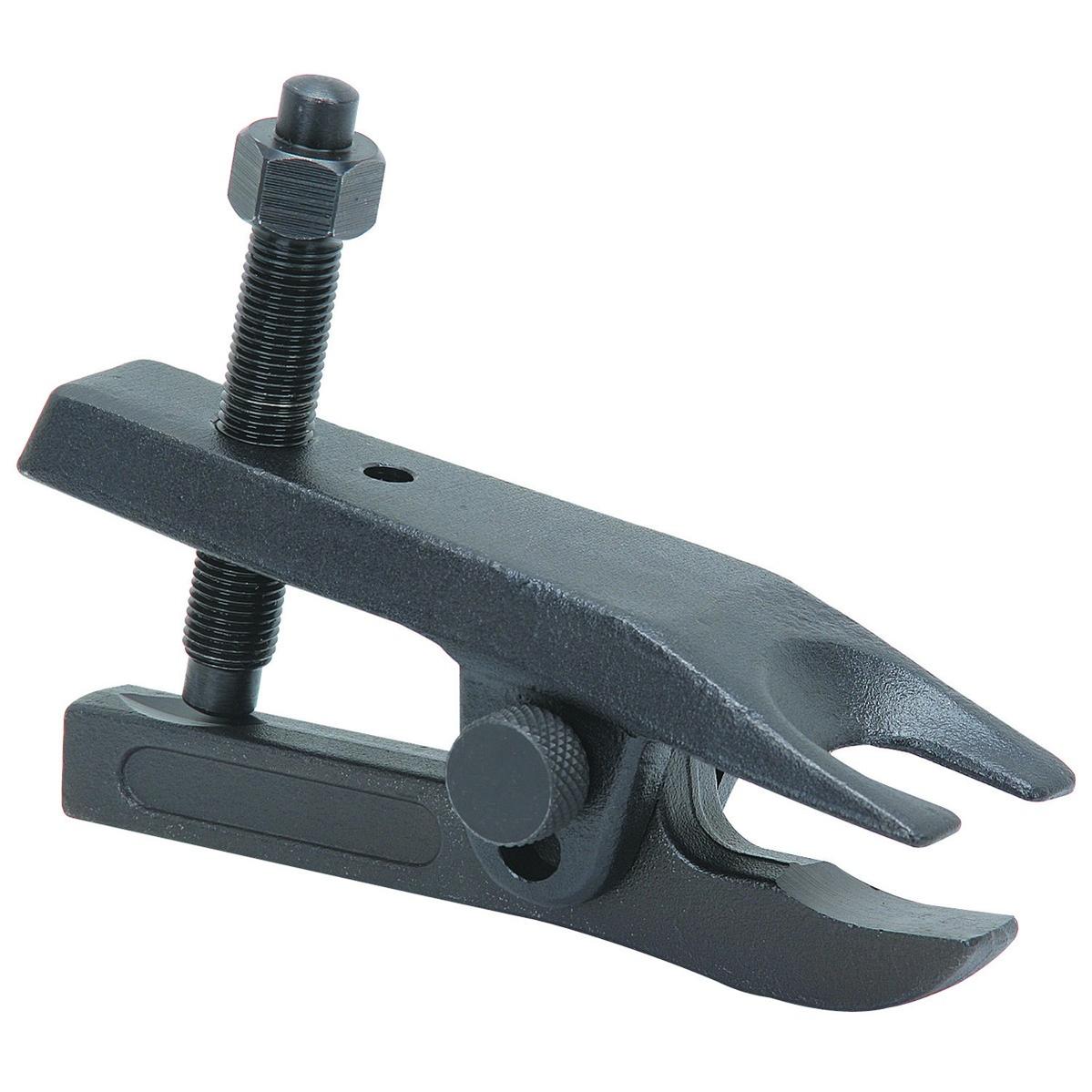

I don't have a video but I did my front brakes not too long ago. I thought my caliper was frozen and was about to get some reman calipers - only 1 piston was frozen when I tried to compress with a c-clamp. As I was going through my tool box, I saw my ball joint separator. I put it on the frozen piston and started turning the bolt to compress... I figured what do I have to lose. Lo and behold, the piston started to compress. I made sure the piston was still good by applying the brakes and was easier to compress afterwards. Seemed like it was just stuck... Thought I would mention as you can try this first before you replace your caliper - below is a pic of the separator and you can get them cheap at Harbor Freight. Put the "U" on the frozen piston...
BTW, call your local dealer and see if they have the pins for the pads (2 on each caliper) and replace them. Mine were so rusted, I had to cut them off and punch out the remaining pieces... unless they slide in and out easily, its worth the few bucks to save headaches for the next brake job.
