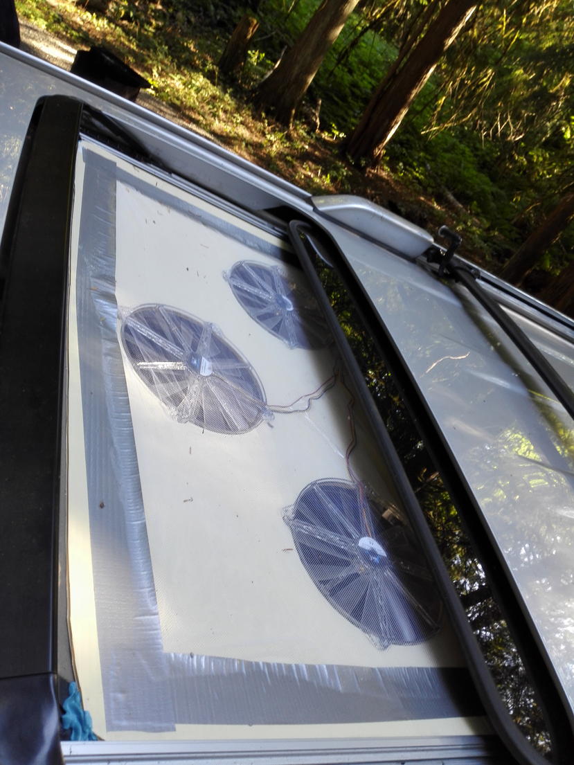

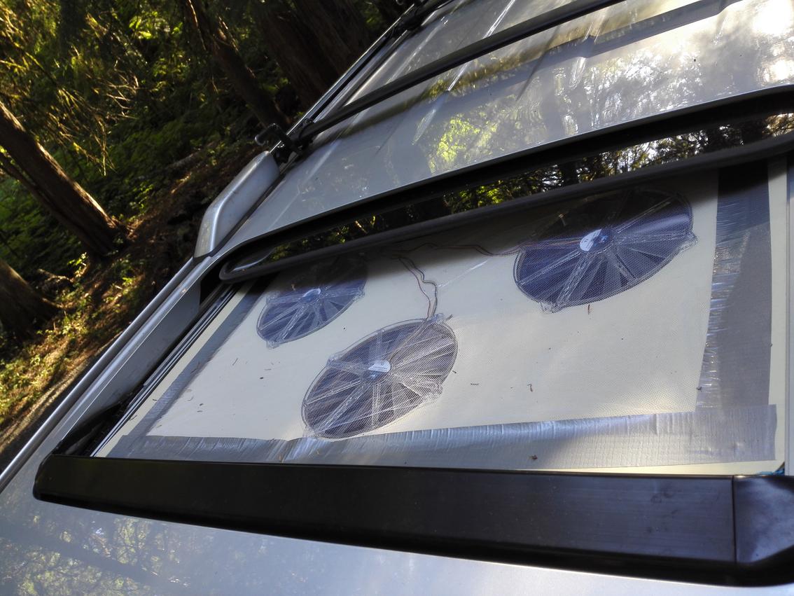

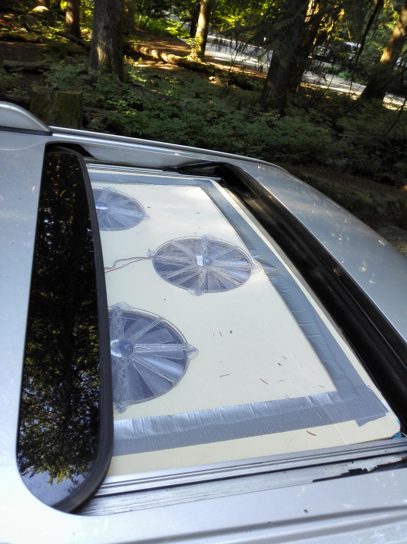

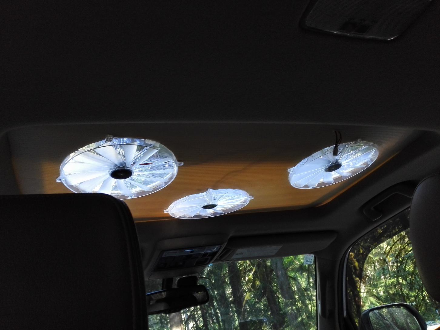

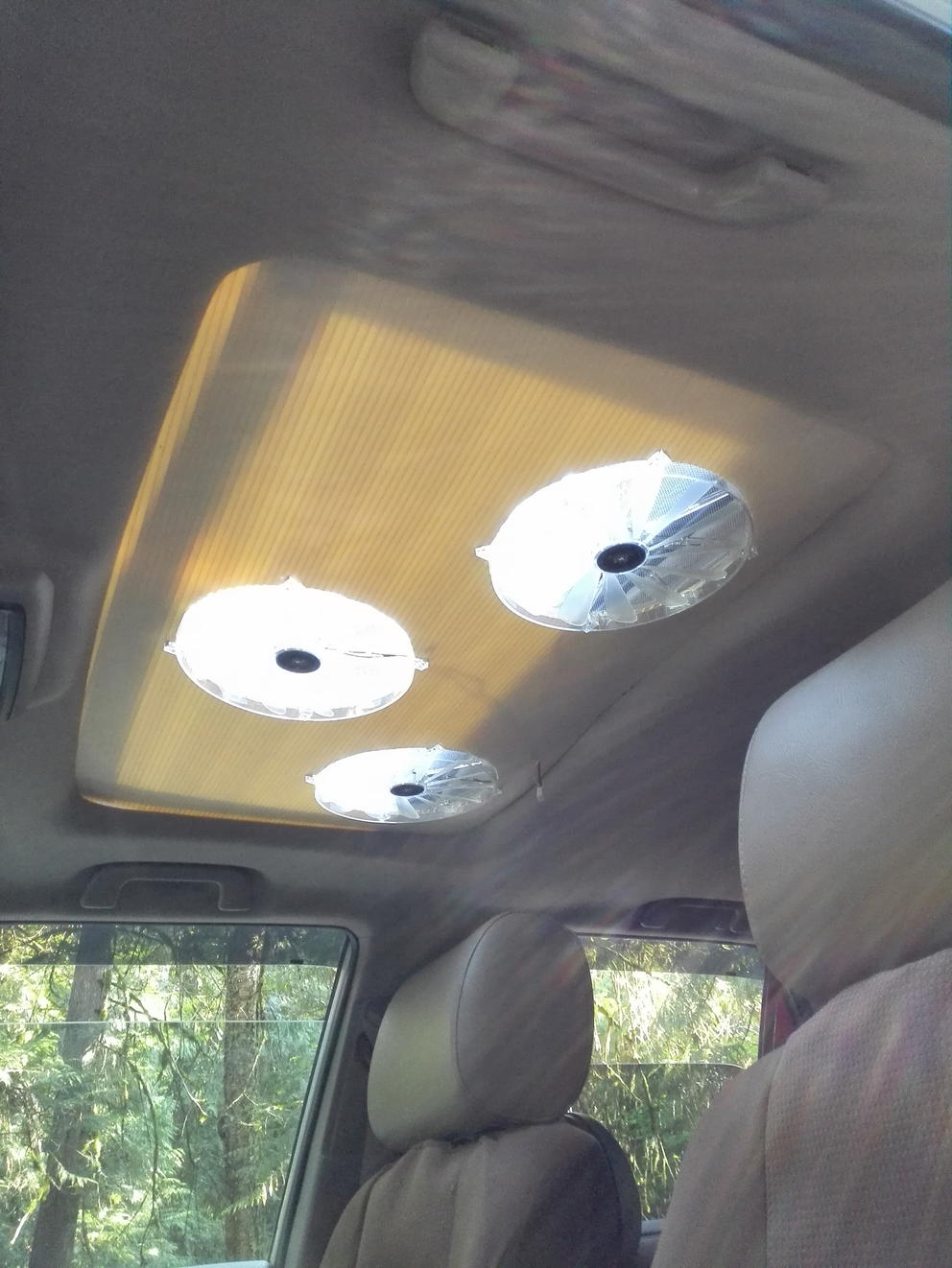

4Runner Car Camping Low Profile Setup : Cooling Fan
Cooling Fan – Air circulation is very important while you are 4runner car camping, you want to keep the fan running the whole night, meanwhile, you want to keep the bugs/mosquito away. ** It is assumed that you have a sun roof in your 4runner.**
Material: 3 computer fans (12V, thin size)
Plastic board from HomeDepot
Method: Customize the size to fit into the sun roof.
Cover the fans with mosquito screen (prevent bugs coming in from fans)
You can open and close the glass roof as you wish since the fans are very thin. But you cannot close the original sliding shape cover.
Power: It can be powered from your car battery or external battery (certainly, you may have concern about this, we will talk about it in the coming section of batteries in your 4Runner)
How to use: You can close all side windows, and then lower down the rear window with 4-5 inches. Air circulation would be maintained from the back to the front through out the night.
Please take a look of the pictures and give your ideas how can it be better.

I like this although the need for fans is a bit much for me up in the PNW. But it's a clever way to add a screen if you used that board as a border and had a larger screen area. A screen like this could probably work in the back window too.
Yes, the ideas of this threat is for park and sleep ANYWHERE, low profile with quick easy setup within 15 mins. We will talk about screen in Part 2. I did not see anyone add this kind of fans before, just to share you guys of your ideas for improvement.

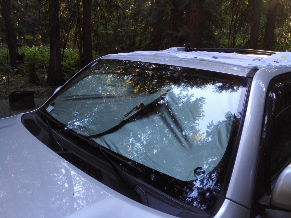

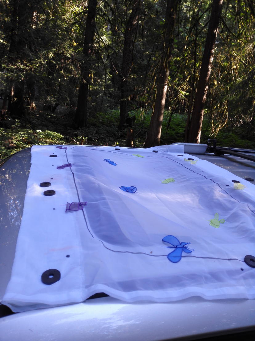

Take an initial look of the big screen net that was added on the top of the sunroof (as you mentioned)

Cool fan setup. Crucial in the summer here in Texas.
I recently camped out for a trail run by Austin and lent all my tents out to friends, so I slept in the 4runner. I grabbed a large mosquito net (no-see-um mesh would be better but I was in a pinch) at REI, wrapped it around the rear door, and wound the rear window down. I placed a large fan at the window and hooked it up to a battery. It was a solid night's sleep.
It is a nice alternative for anyone with the rolling window IMHO because:
a) you get more airflow by parking with the rear window into the wind.
b) more airflow through a larger opening
c) better natural protection from the rain from the spoiler if you only wind the window a bit
d) option to tie a small tarp to the roof rails for severe storms
e) very secure and tight fastening for bug protection
f) no handy work. just a large net, a battery powered fan, and maybe some cord to setup of the fan.
$15 on a net + fans that I already had = slept like a baby
Just my thoughts on a cheap and easy rig with very little work setting up.
My thoughts are that fans/small panel for rear window (protection from light rain under spoiler) and screened side front windows (w/vent visors for rain protection) would make it all-weather. Also, independent operation for multiple fans.
And, a bear might climb down the big sunroof opening.

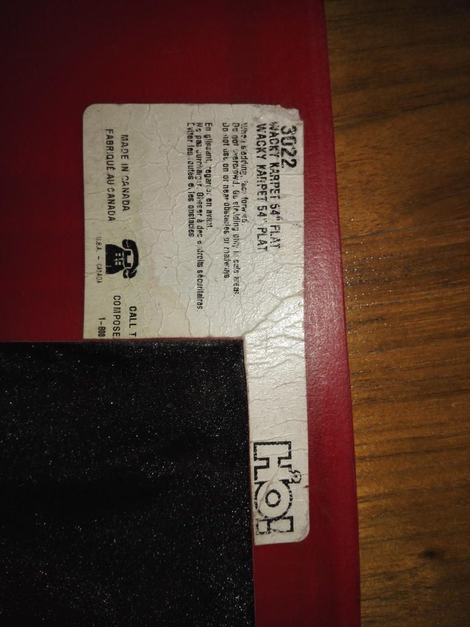

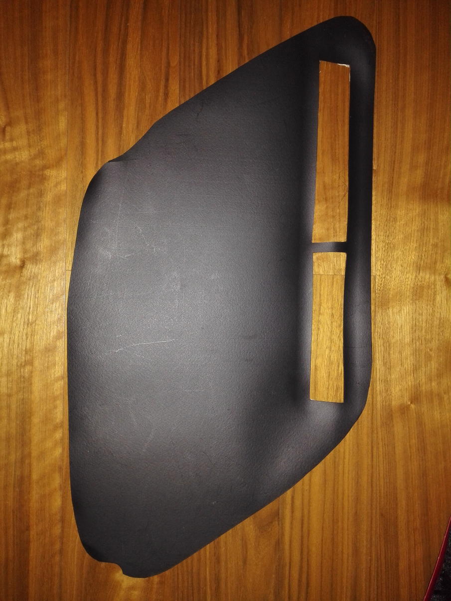

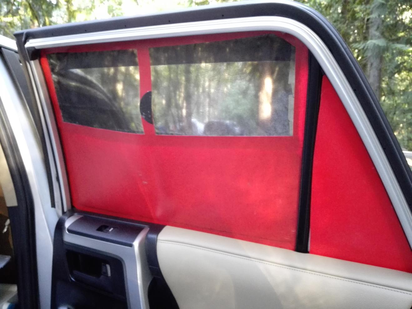

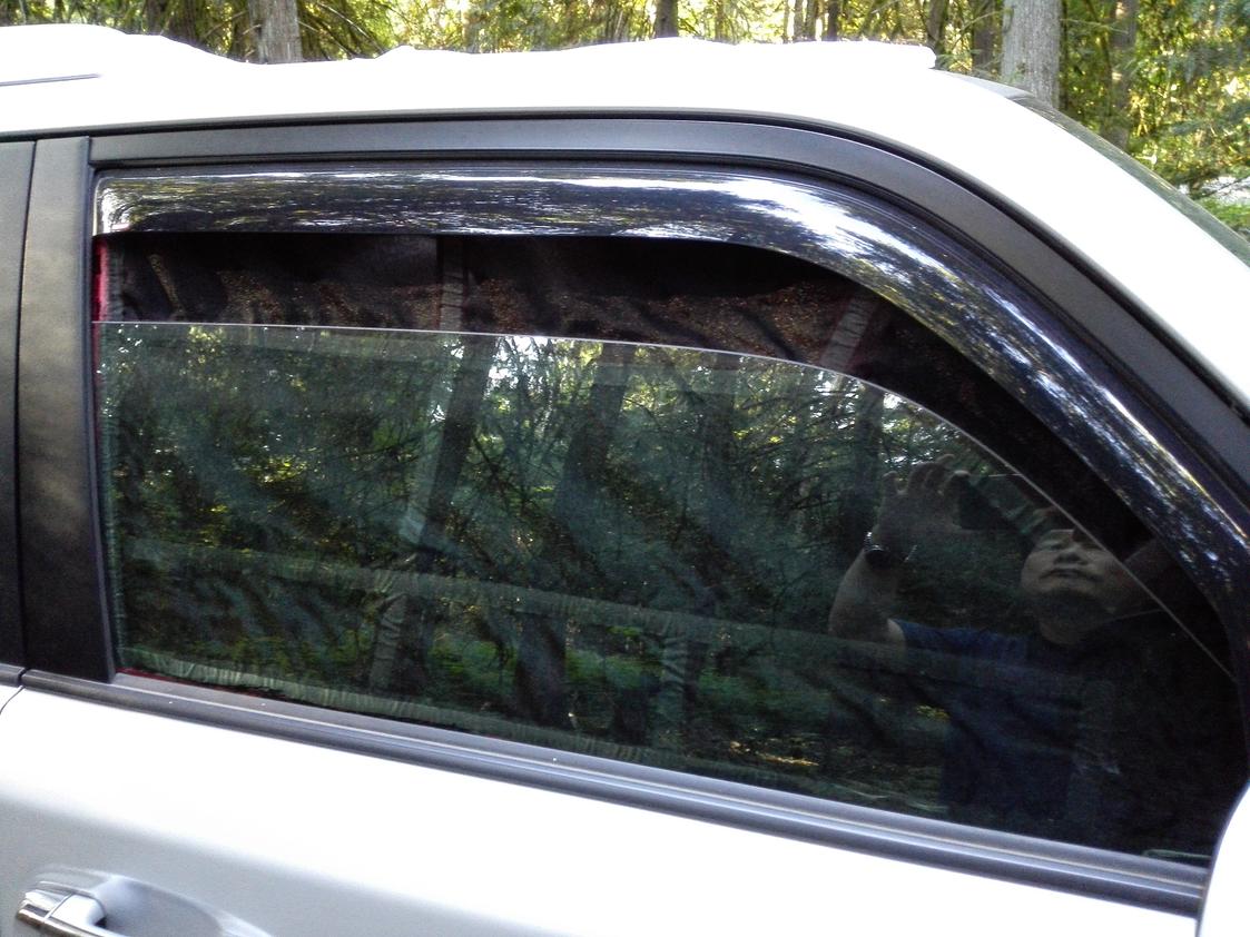

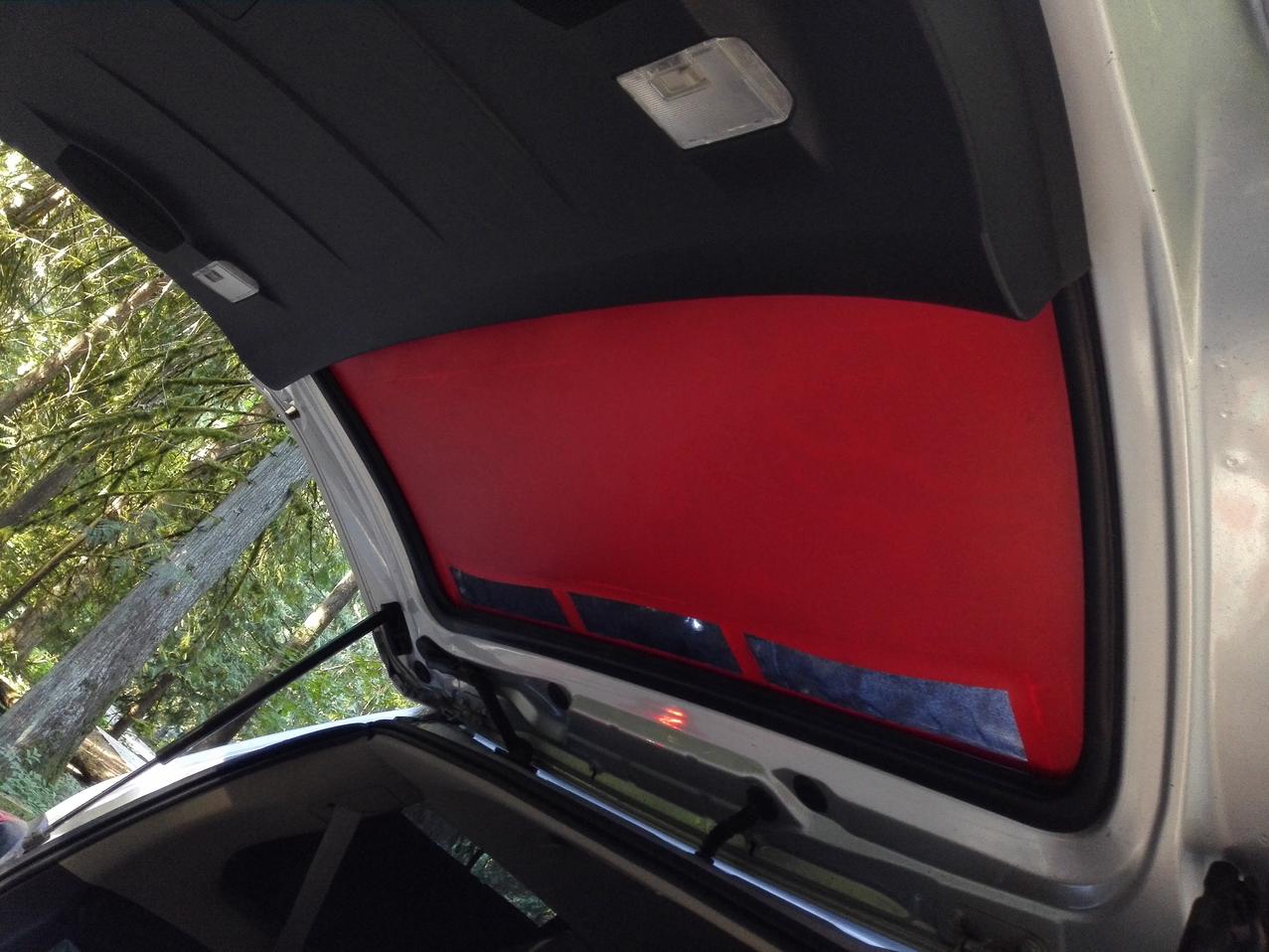

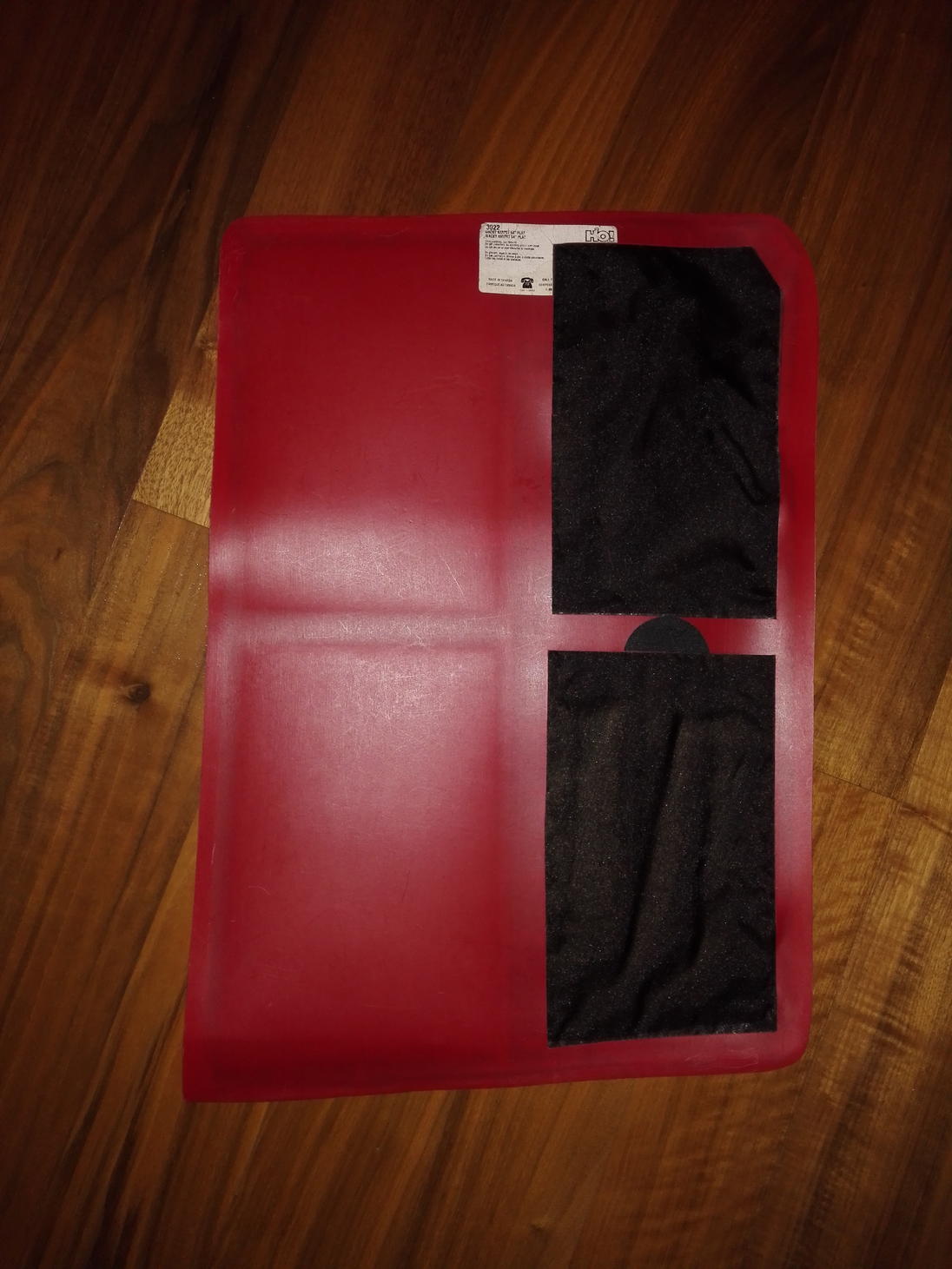

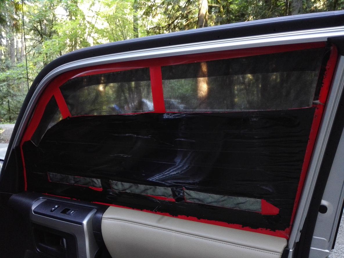

4Runner Car Camping Low Profile Setup : Bug Screen
Dear Folks,
Thank you guys that you have contributed lots of ideas in Part 1 (fan), your 4runner car camping experience triggers people's passion to explore its possibilities further. I like your sleeping concern (diagonal sleep) , we will talk more about this in Part 4 that I will share a simple flexible setup to accommodate the basic comfortable sleeping needs.
Now let's go to Part 2 of Bugs Screen customization – If you have a spouse/friend sleep inside the 4runner with you, everyone wants bugs free throughout the night. Cooling fan makes you happy but you do not want bugs sting on fresh meat, right?
Some criteria :
- You want air circulation in ALL windows,
- See outside from inside (with 360 degree viewing),
- Won't be seen from outside (in any angle),
- Raining outside (no water leaking into compartment but still maintain fresh air from outside)
- Low profile (no attraction to outsiders)
- Quick and Easy setup within 3 minutes.

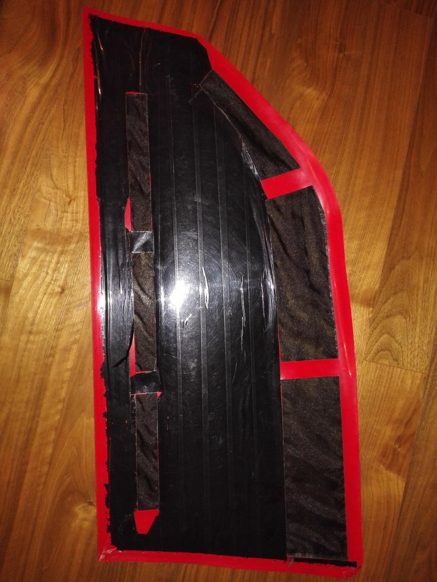

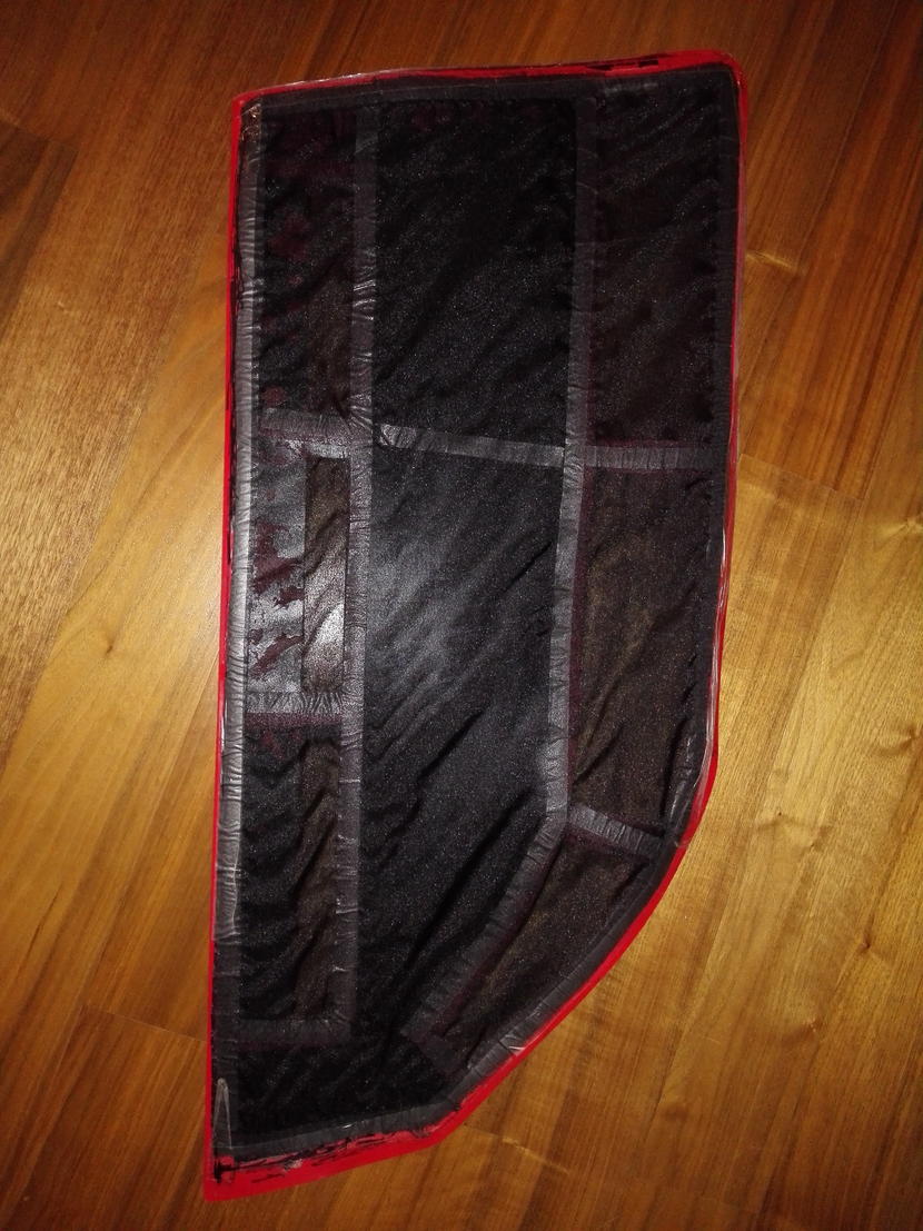

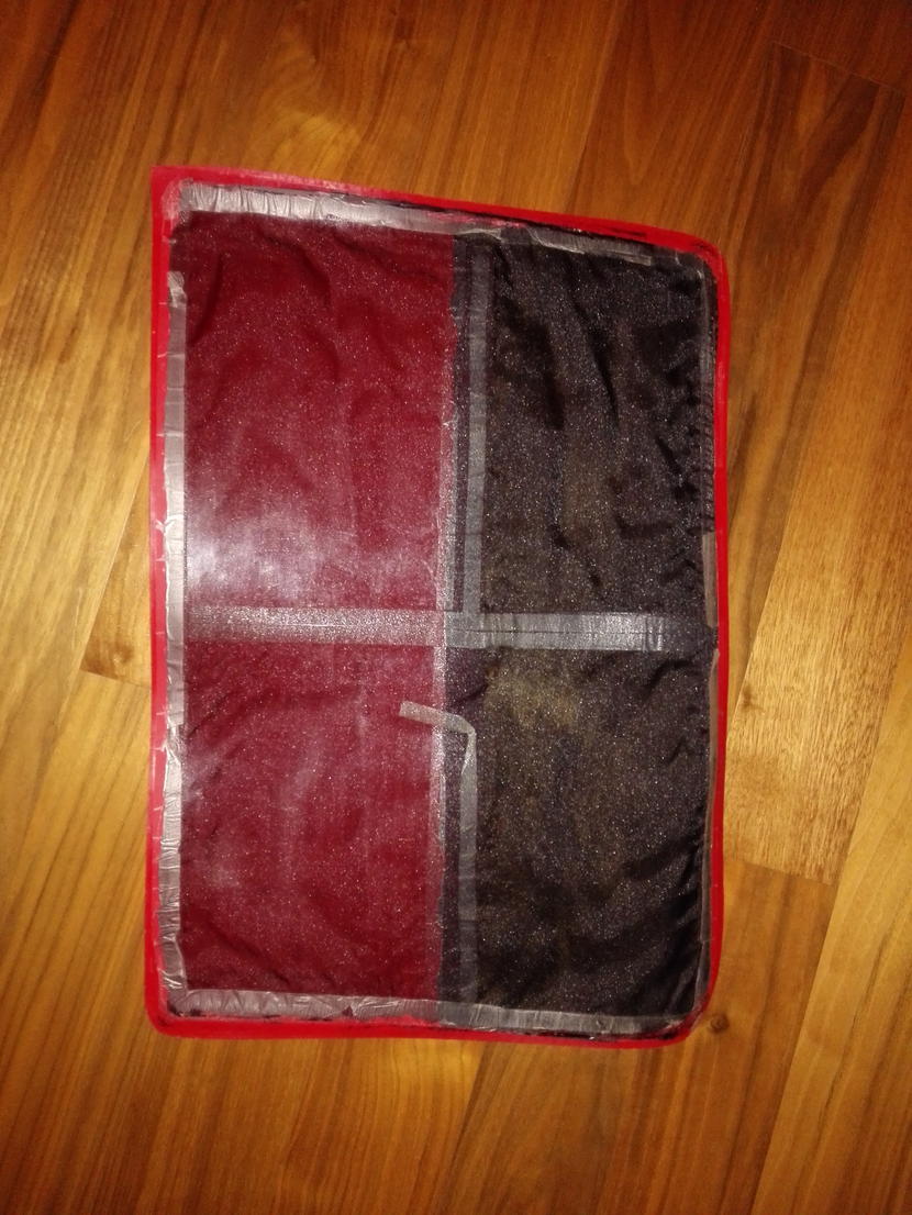

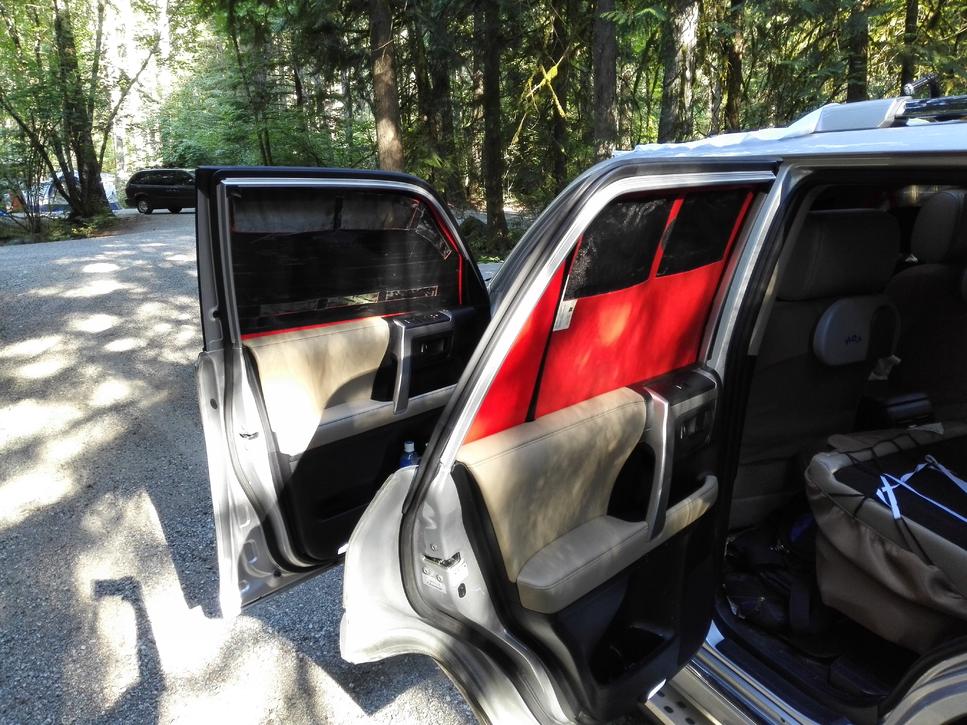

Material: Wacky Karpet (sled, $5 each) large size 54", RED color only. DO NOT use other color (because the plastic material of other color is not strong/tough enough). RED is the best. You may be able to find it in Toysrus or Internet :
H2O! Recreation Inc. Wacky Karpet 18" X 54" - Red: Shopicana - Shopping in Paradise
https://www.youtube.com/watch?v=XN2oS6KY_VU
A large piece of Black color of mosquito screen net.

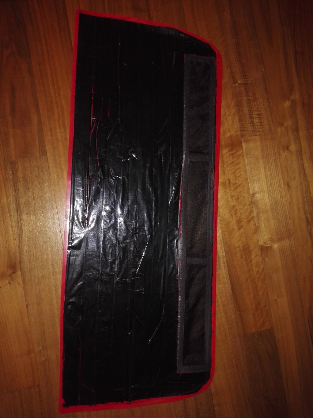

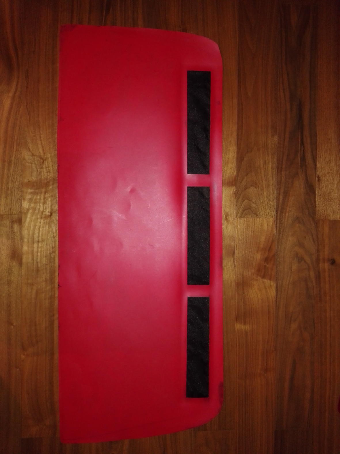

Method: Customize the WACKY Karpet to fit into ALL windows. You can go to Costco and get some large paper to tailor made a template for each windows size and shape. Then, you can use that paper (with size and shape cutted) and place it on the top of WACKY Karpet, cut WACKY Karpet with a scissor.
** You may want some openings on it for air circulation and see through from inside compartment, if anyone want to know the details of openings on the Wacky Karpet, please let me know **
Cover/stick the Wacky Karpet with a black color mosquito screen by double layer adhesive tape.

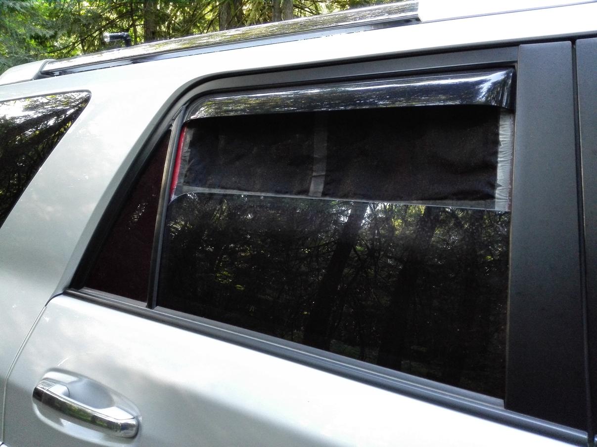

How to use: After you finish the customization, you can INSERT this bug screen (a very thin and tough layer of plastic) BETWEEN the window glass and rubber space. Yes, it can exactly fit into it without any gap ! Remember to let the black color side (mosquito net) facing outside, CAMOUFLAGE black color seeing from outside.
Once inserted :
- You are good to close all windows (including the rear gate window) if you wish.
- You are good to lower all windows (including the rear gate window) by 3-4 inches when there is rain outside (provided that you have a rain visor installed as well)
- You are good to lower half or completely all windows (including the rear gate window) if you want most of fresh air (if you do not afraid bear waive their hands with you in the middle of the night !)
- You are good to SEE 360 degree from inside through those small thin openings (covered by black color mosquito net).
- You can cover your windshield glass by regular sunshade cover.
** For the sunroof, just cover it with a mosquito net with magnets surround the edge **
Please take a look of the pictures below and give your further comments.

This is great! I'm doing something similar but different approach and design. Do you have pics of your screen inserts on the 4Runner?

Never mind you posted additional pics. That's pretty innovative and thoughtful. Nice job!
Mine will be smaller inserts that are storable in the vehicle when not in use.
Yeah, if anyone want safe guard from bear climb from your roof. You can close the glass roof and tilt up. Still these 3 big fans can blow air out of the car via the gap.:lock1:
