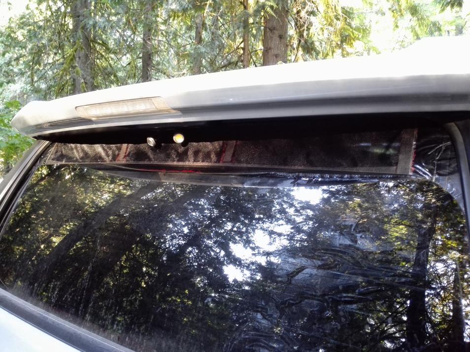

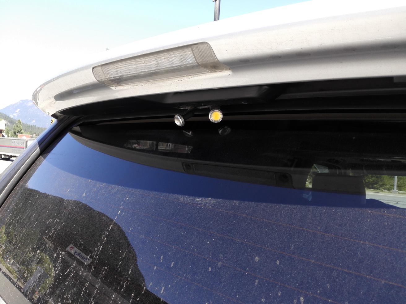

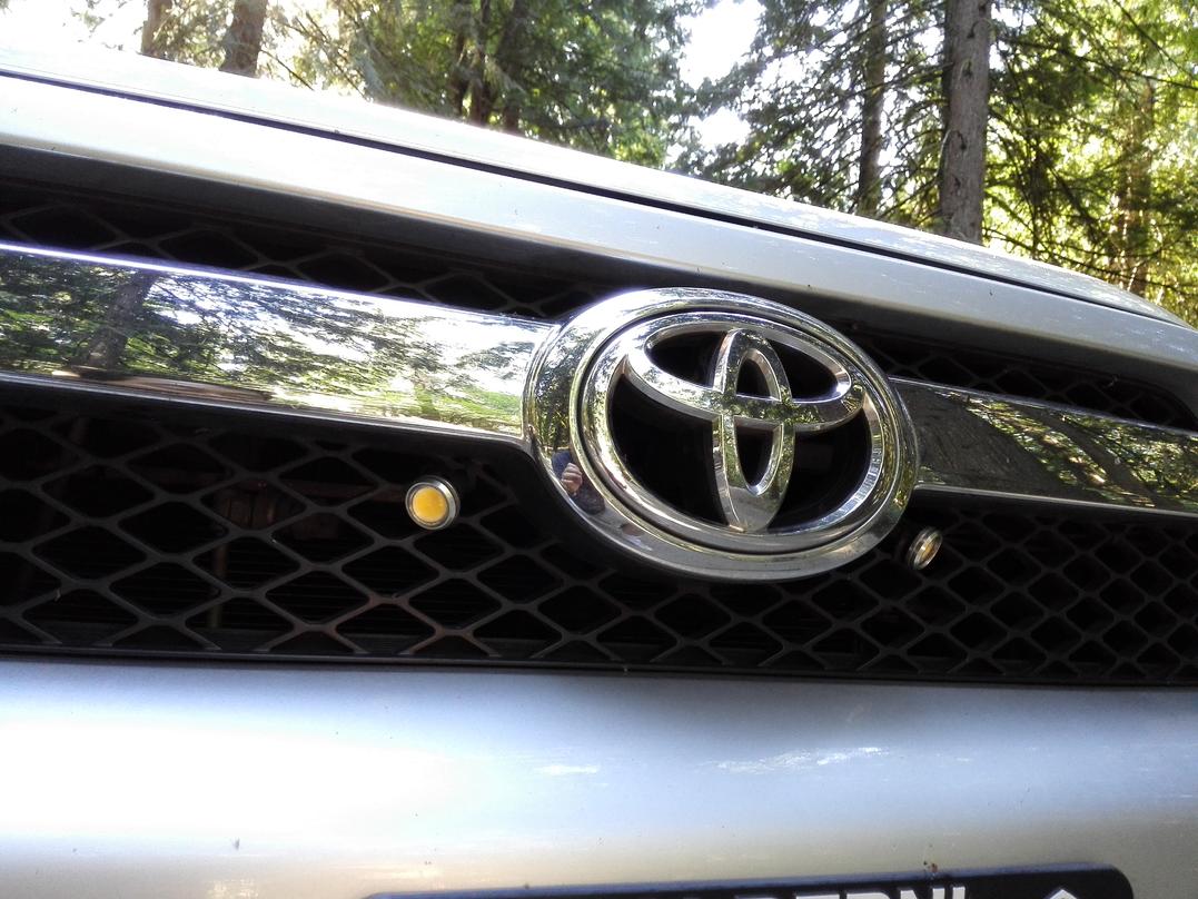

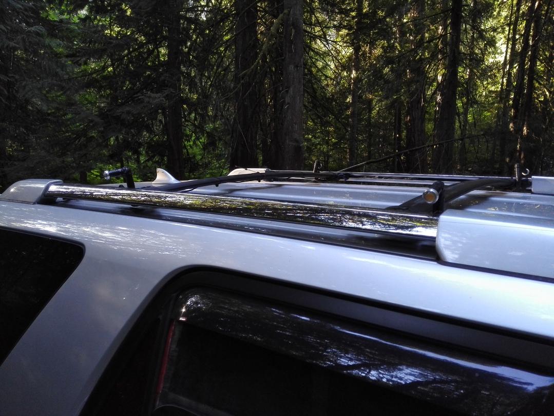

4Runner Car Camping Low Profile Setup : Exterior 360 degree LED Light 12V
Exterior 360 degree LED Light – Once you drive into a campsite or stopped in a rugged road or under emergency situation. You want to light up the place around your car. In some cases, while you are sleeping inside your car, you may wish to turn it on in the middle of night to check if there is anything (animal/people) around you. You can hide these lights (looks light a regular SUV) in the city. It is just a usage on-demand setup within 15 seconds.
Material: 1.5W COB LED Lamb Bulb (Qty=8, 12V, small size)
Flexible Cable Management Tie (Home Depot)
L Shaped Connectors (Home Depot)
Shrink Tubes (Home Depot)
You can easily these kind of LED Light bulb in Ebay or Amazon:
2 x 1 5W COB LED High Power Eagle Eye Rear Back Up Reverse Tail Light Lamp Bulb | eBay
Amazon.com: Elite Tech Gear Gear Ties, 16-Pack, Assorted Sizes: Home Improvement
You can install this type of LED stripes in front hood and rear spoiler to make it more low profile :
FRYS.com*|*PHILMORE
Method: Insert the LED into the L Shape connectors, Insert the L Shape Connectors into the flexible cable tie, tie them in the roof rack, you can easily adjust the flexible cable tie into different angles for area coverage as you wish, you can hide these LEDs behind the roof rack if you do not need them to be visible. Install 2 LEDs at the front hood and also at the back spoiler. Connect them to the car compartment with a A/B power control switch. You can control the on/off while you are sleeping inside your 4runner.
The light intensive/power should be good enough for most of the use, if you want higher power, you can use 9W LED instead.
Power: It can be powered from your car battery or external battery (certainly, you may have concern about this, we will talk about it in the coming section of batteries in your 4Runner)
How to use: You can control the on/off while you are sleeping inside your 4runner. It gives you 360 degree light within 15 seconds once you drive into any campsite or off road situation.
Please take a look of the pictures and give your ideas how can it be done better.

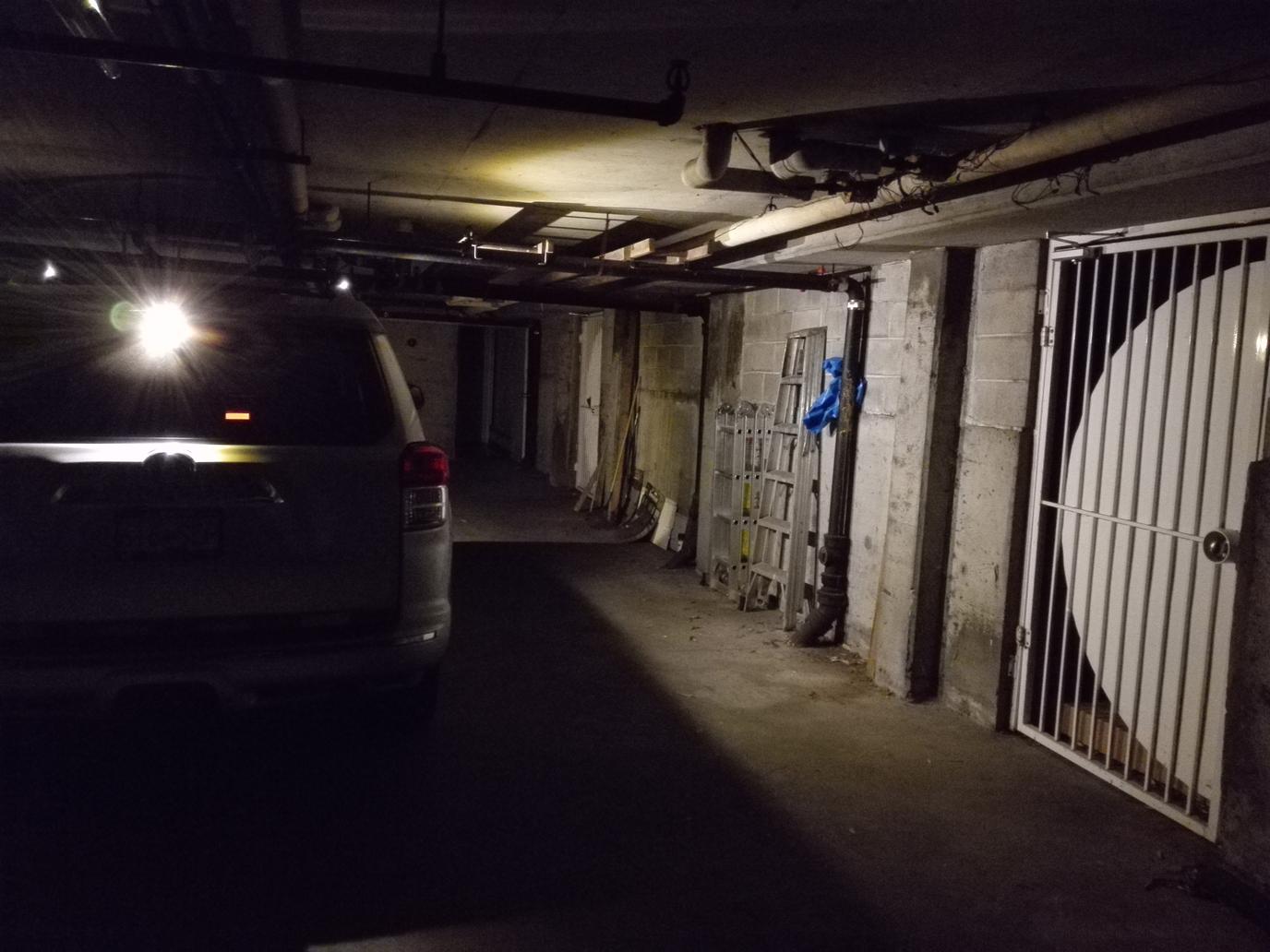

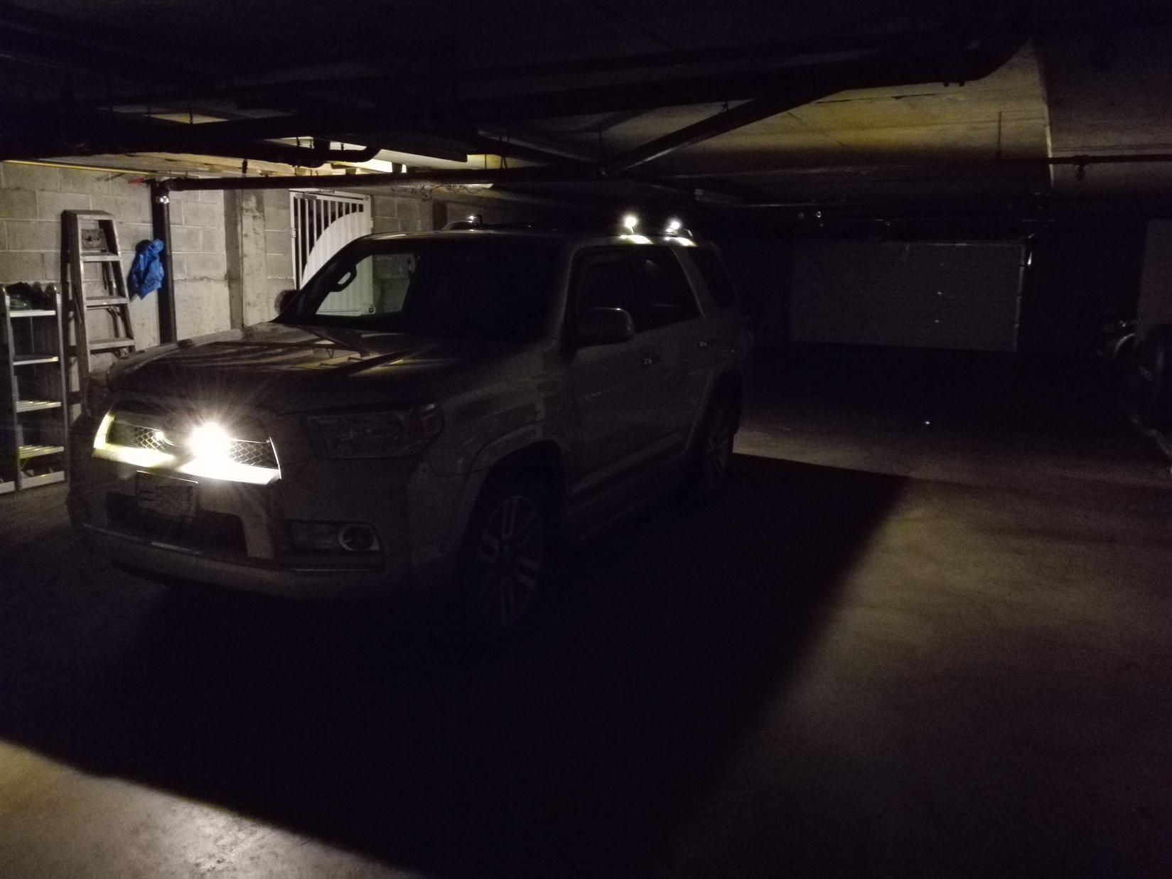

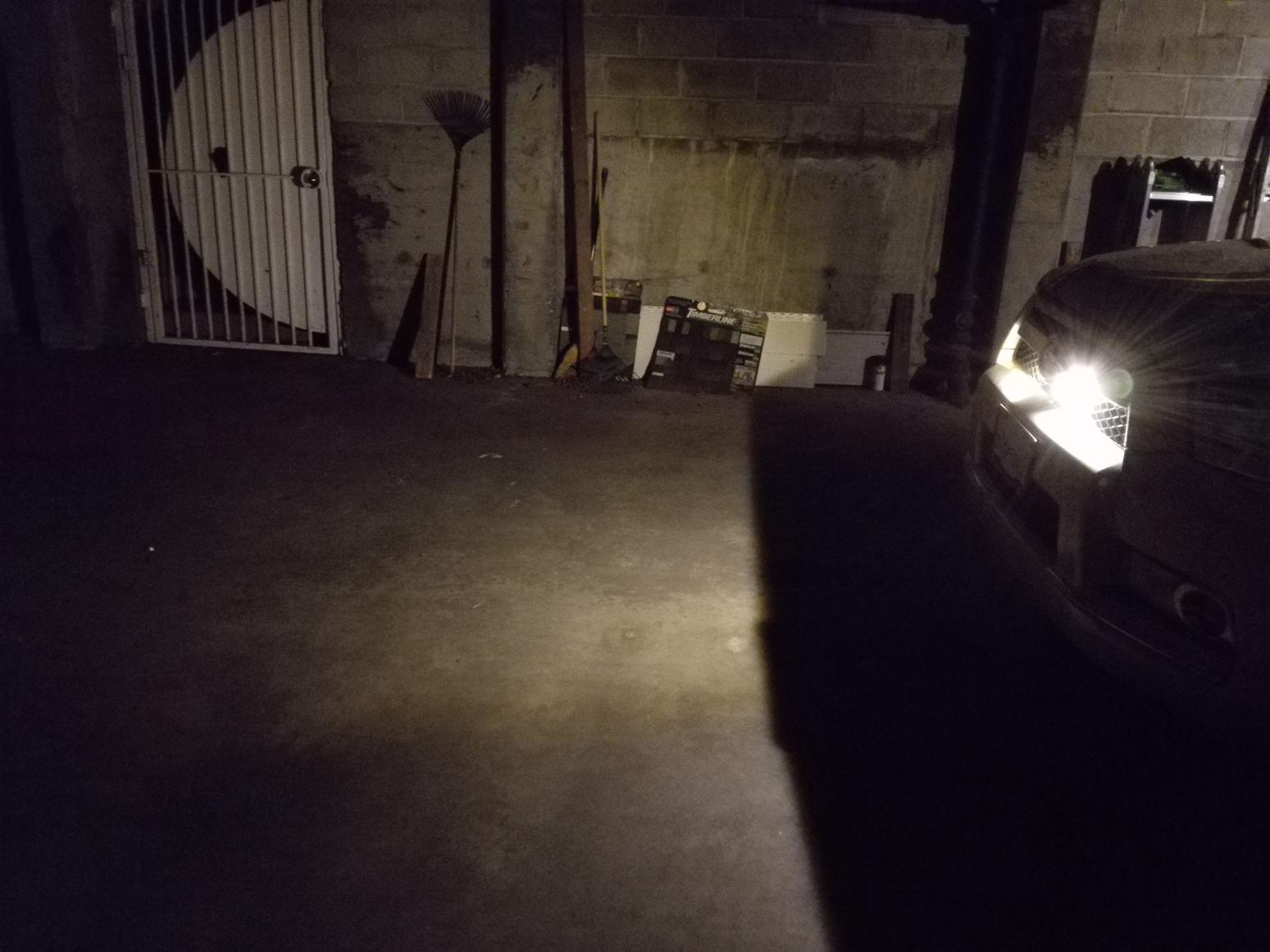

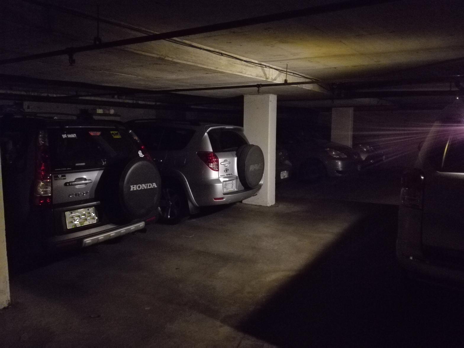

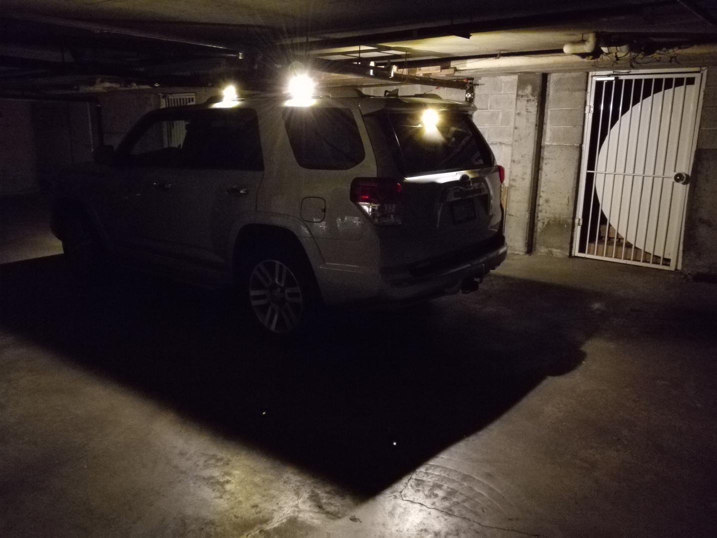

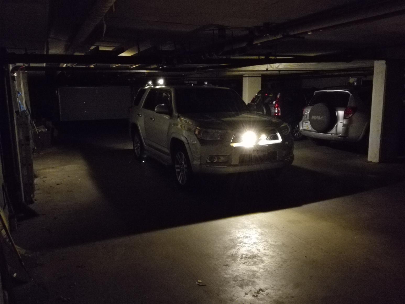

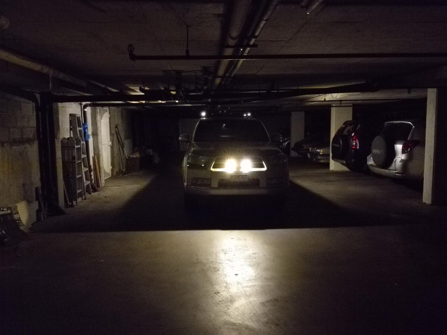

Here are the night shots. It was taken inside a basement with all the lights turn off. The only light source is from these LEDs. You can compare the short range brightness (light on the wall) as well as medium range (light on those cars).
Please give your comments of improvement.

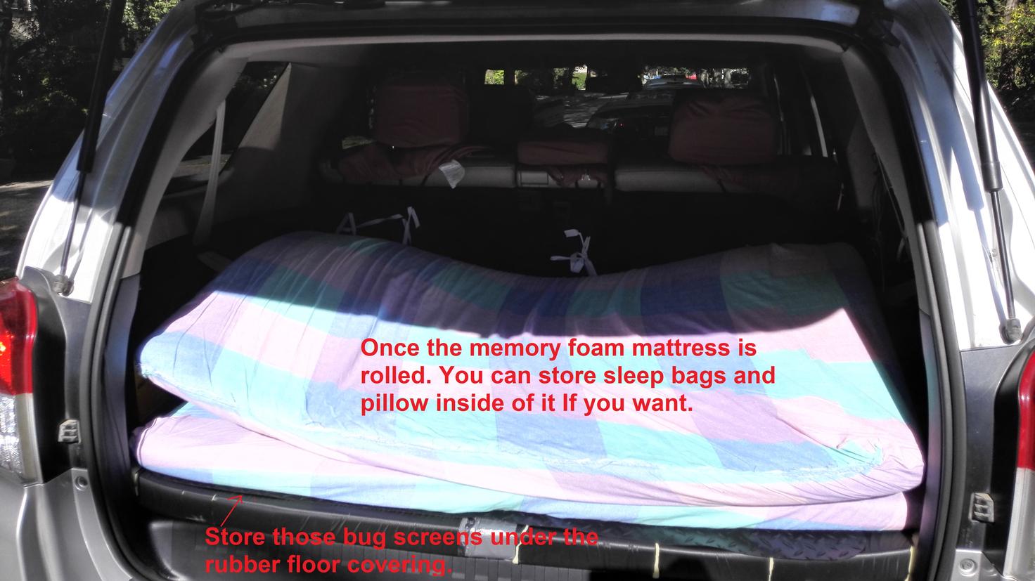

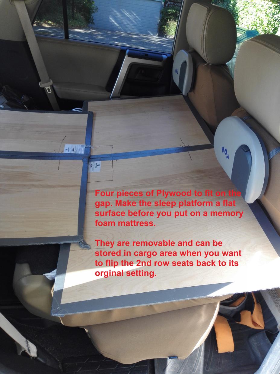

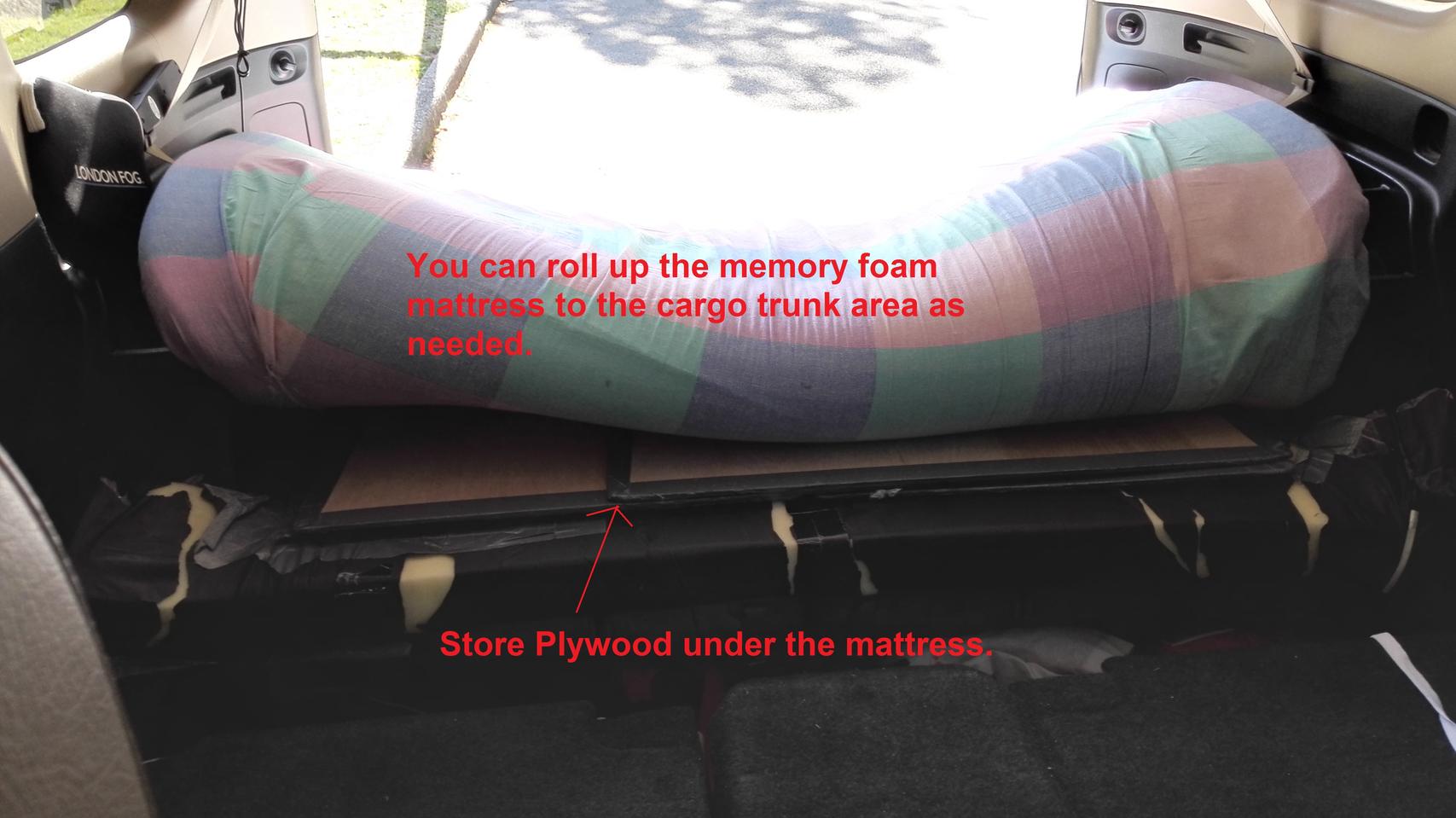

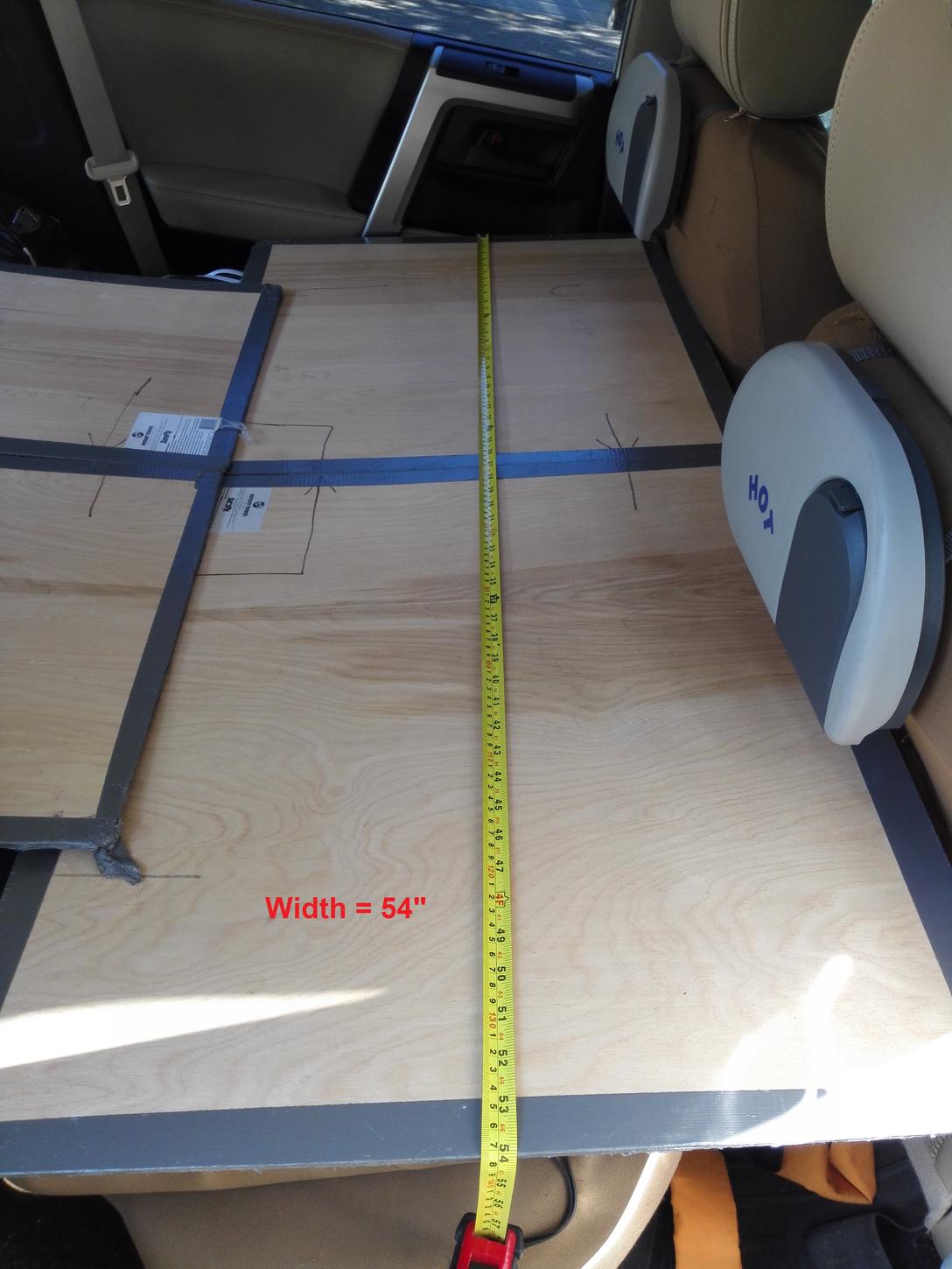

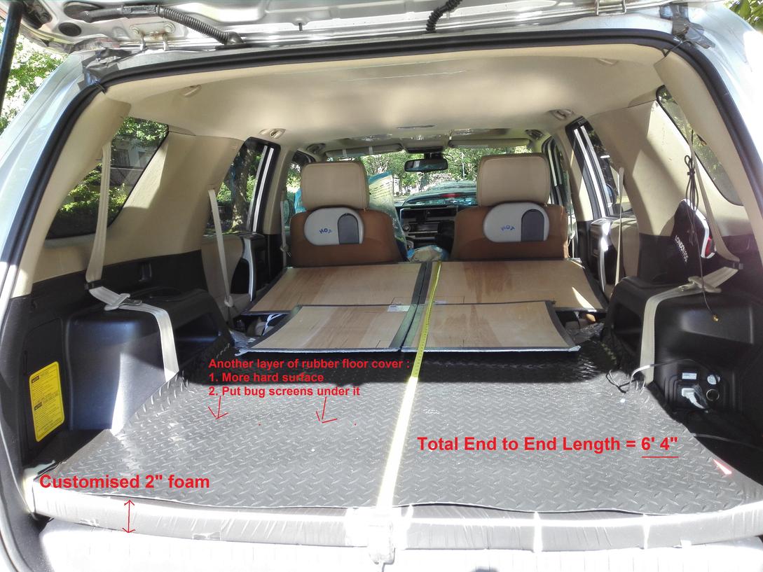

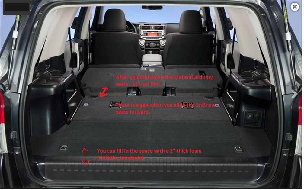

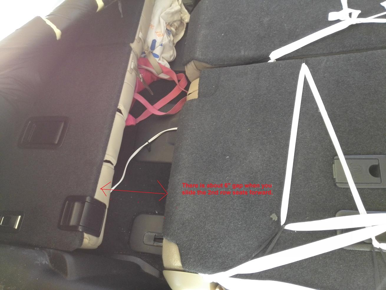

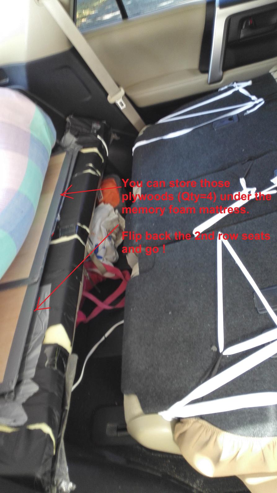

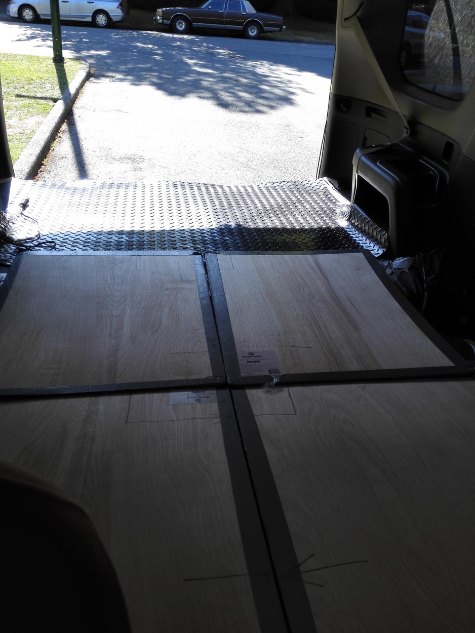

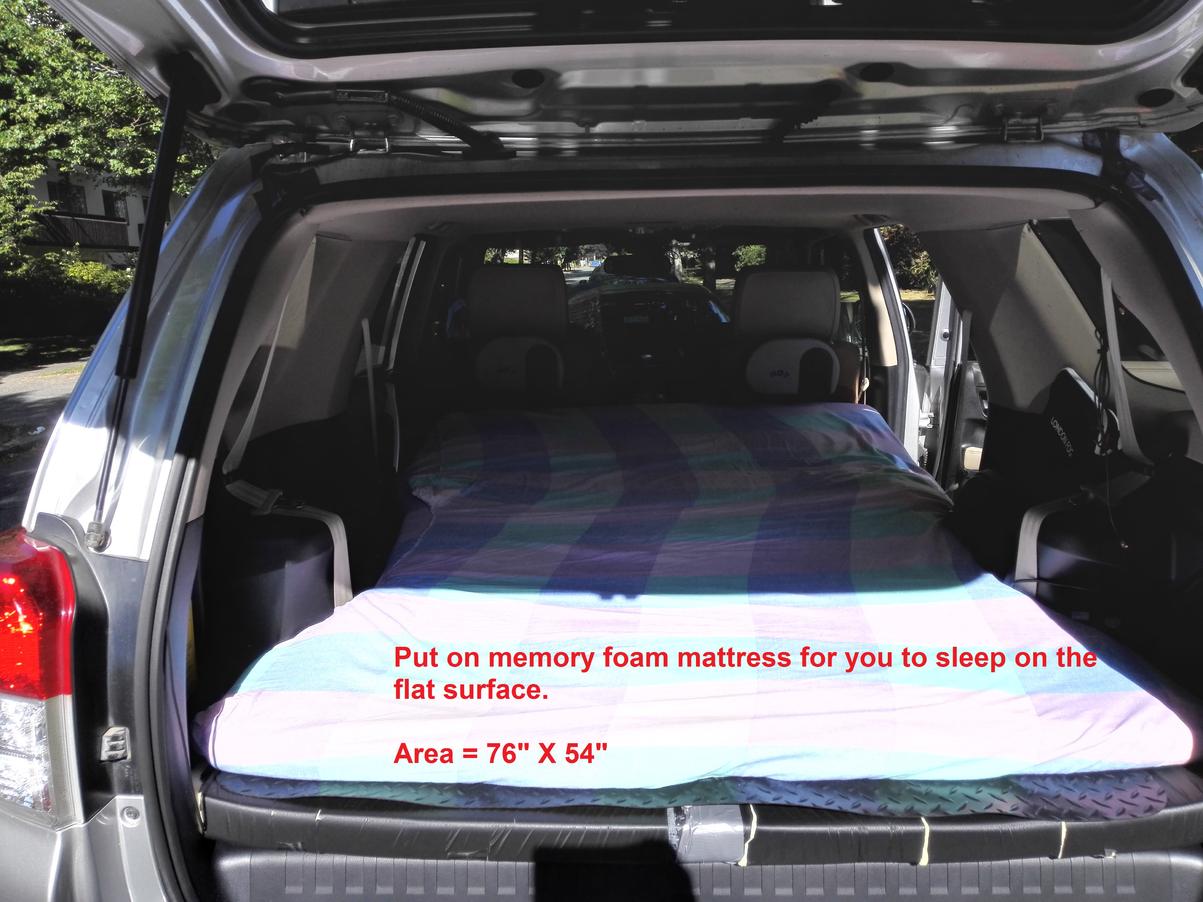

4Runner Car Camping Low Profile Setup : Flexible Sleeping Platform
:zoom:
This is not a professional solution. I know that you guys have done lots of nice conversion (e.g. take out the 3rd row seats, remove the sliding cargo tray and customise drawers under a completely FLAT platform …)
This solution is rather a flat sleep platform with fold up/down of the 2nd row seat on-demand basis (assumed that you have the 3rd row seats). You can finish the sleeping platform setup within 2 minutes. It can accommodate two people with a 76” X 54” sleep area.
Material: Plywood X 4 (you can get it from Home Depot and customise the size as you need)
2” Foam Layer X 1 (customise the size and shape to fill in the sleep area)
Rubber Floor Covering X 1 (make the foam surface harder, you can also store bug screens under it)
Memory Foam Mattress (customize the size and shape, exactly fit on the sleeping platform)
Pylwood (HomeDepot):
SurePly® Premium Underlayment :: Patriot Timber
Rubber Floor Covering (HomeDepot):
Rubber Floor Covering for Elevators!

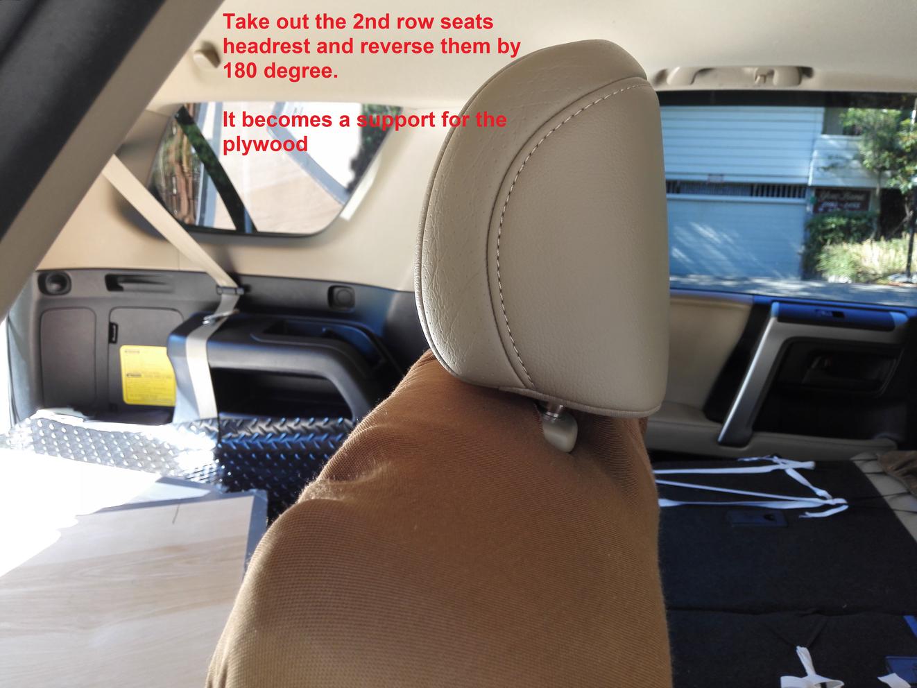

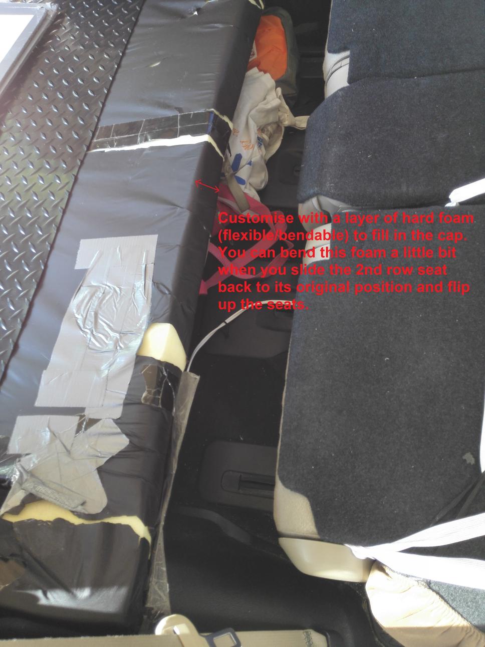

Method: Customize the Plywood (Qty =4) to fit into the sleeping area. Two of them place at the front, another two of them fill the gaps between the 2nd and 3rd row seats.
Customize the foam (2” thickness) to fill in the cargo area.
Customize the rubber floor covering and place it on the top of the foam.
Customize the memory foam mattress for you to sleep on it.
Reverse the 2nd row seats headrest, it becomes the support for the plywoods.
How to use: You can store everything (foam, plywood, memory mattress, sleeping bag…. Pillows) at the car trunk and flip the 2nd row seats back to its original position as needed.
Please see pictures and give your ideas of improvement.
Looks like you removed the second row seat bases to get the length..great idea on turning around the headrest.
Since my 4runner is the 7 seats limited model that the 2nd row seat bases cannot be removed. All I can do is to fold down the 2nd row seats and slide them forward, it can make 76" length space.
It is understand that there are some 4runner models with seat bases removable option, it can make it flat but the length could be reduced (no sure)?
