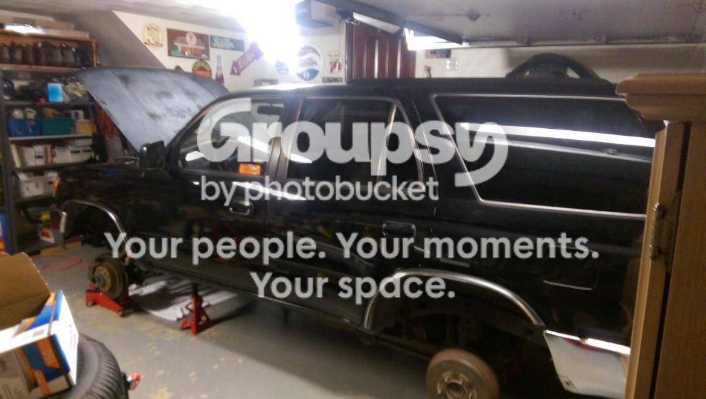

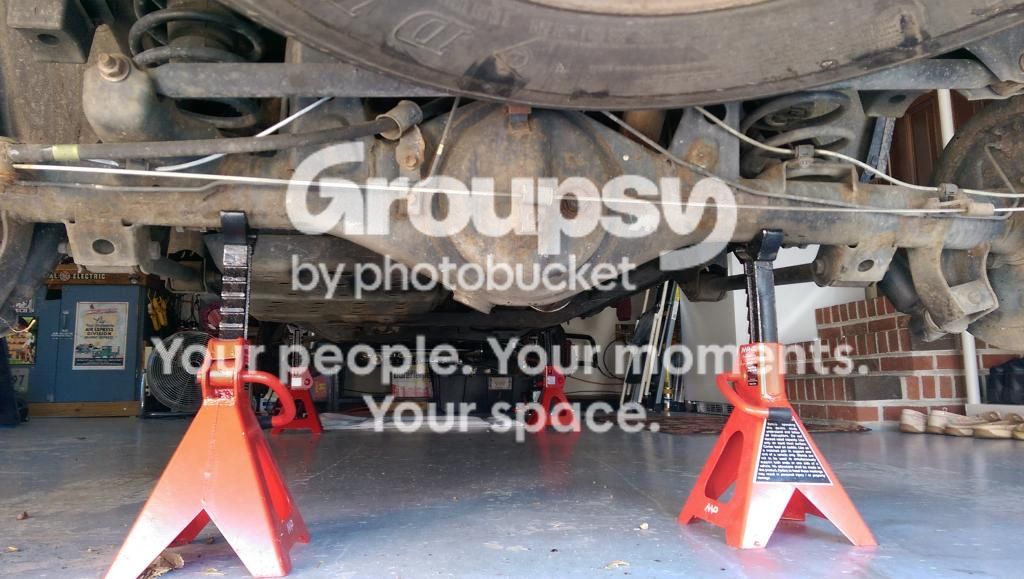

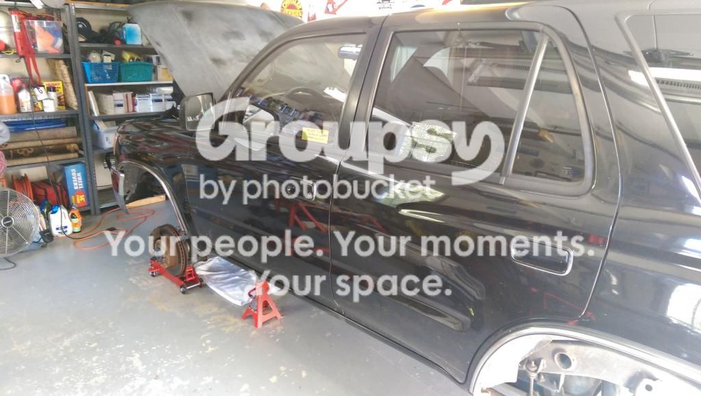

Nestled in the garage on jackstands. Paint is decent; minus the hood.
Pretty clean!

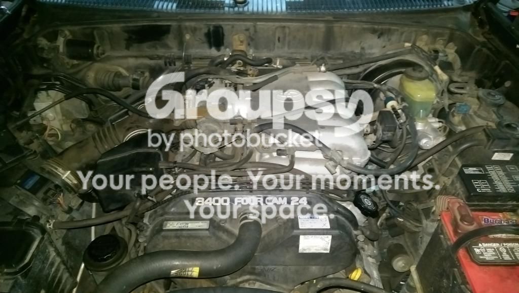

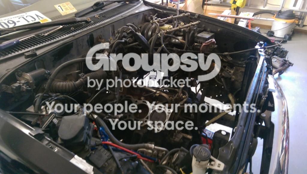

Pre-Teardown

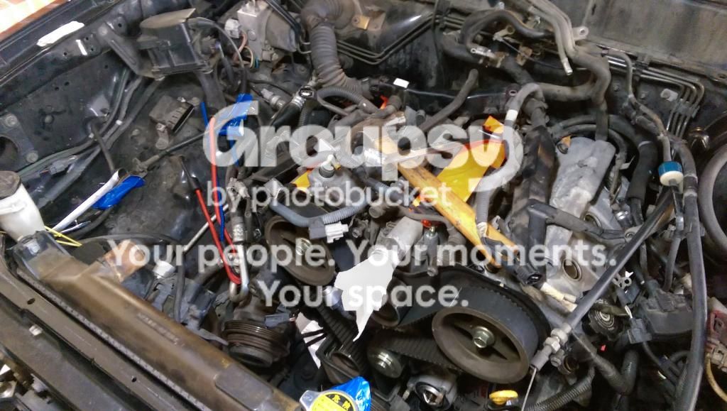

Getting there...

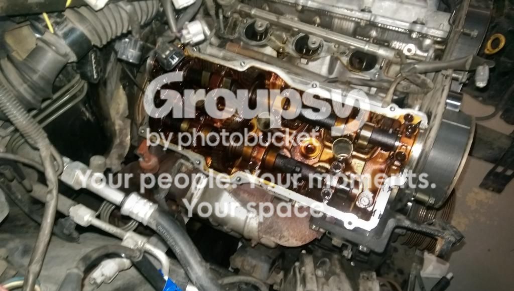

Valvetrain shot....
More to come!!

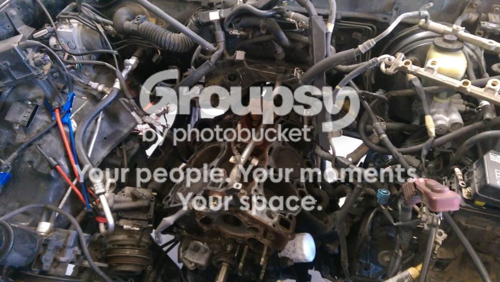

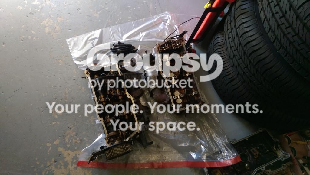

Got the heads off.... :party:

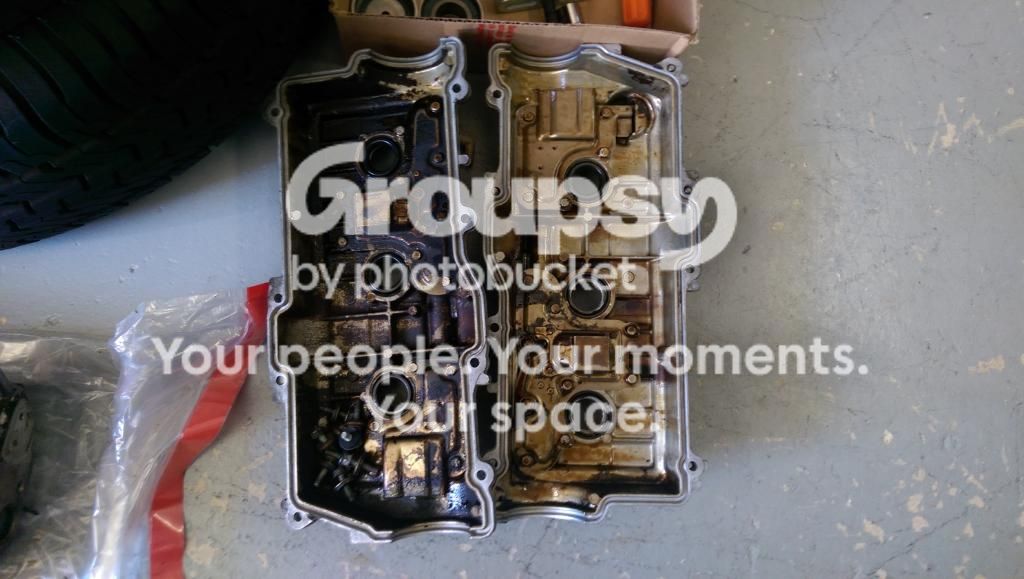

Valve Covers. Passenger side on the left and driver on the right. I think we can all tell which one was over the bad bank. :eek:

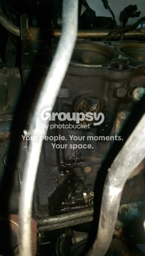

This is where the bad news started. I thought that was going to be it. Take the heads down, have them cleaned up, and BOOM. Done. No such luck, though.

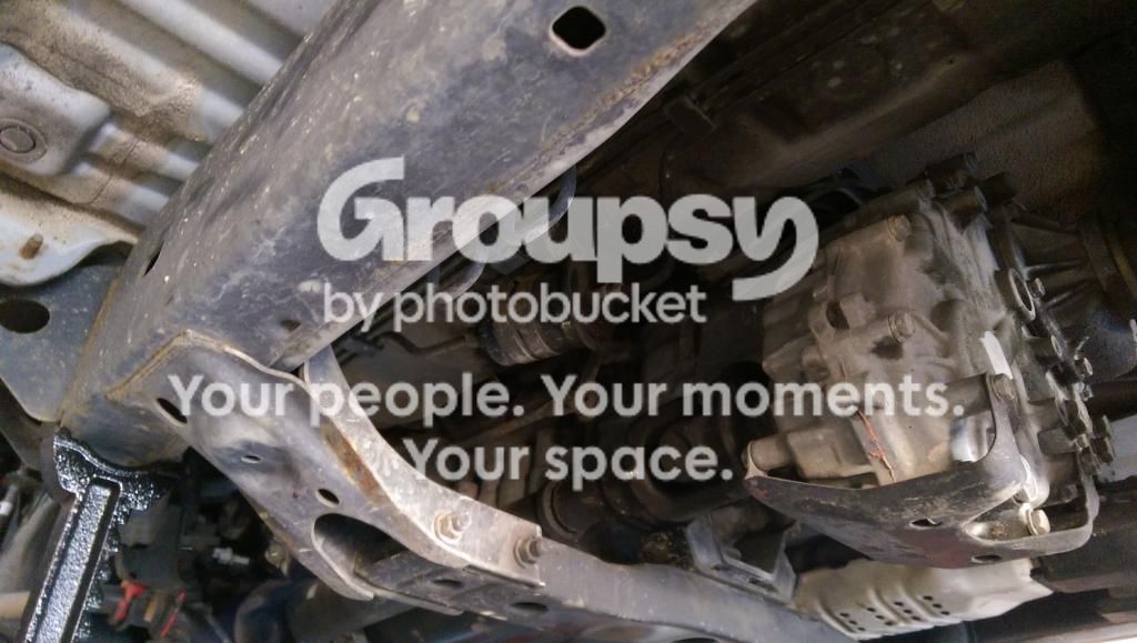

Looks like one of the freeze plugs is leaking too...
So the whole motor is coming out. :mad2: I'm still debating whether or not to take everything to a local machine shop or buy a rebuilt motor off Ebay. :noidea:

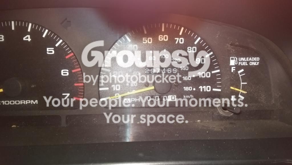

It's the last one on the passenger bank. I have already mentally committed to taking it out and just starting fresh. With almost 300K on the clock, I'd hate to have to do this all over.

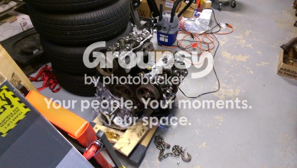

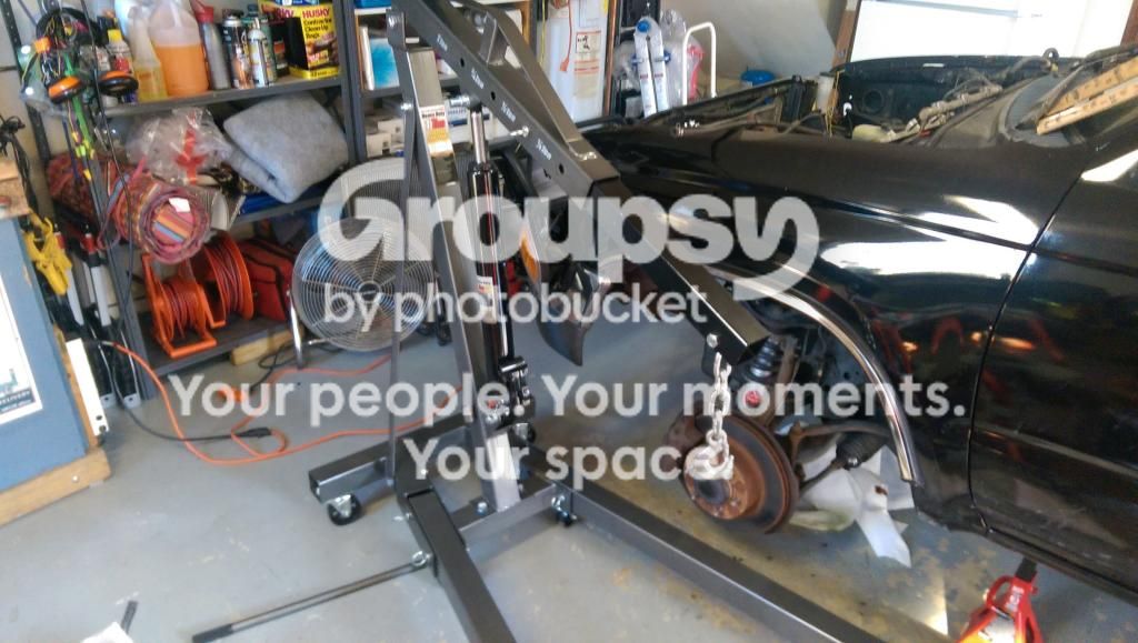

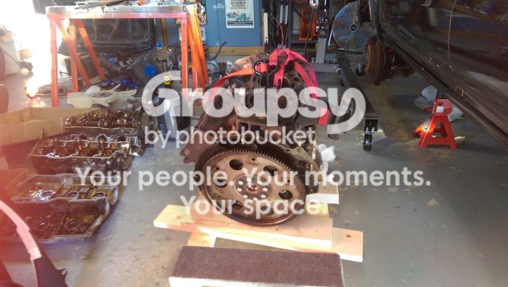

BIG milestone today! Got the motor out...
First, got some shiny stuff and everyone likes shiny stuff...
Got a killer deal on it. Normally $279.99 and walked out the door with it for only $120.

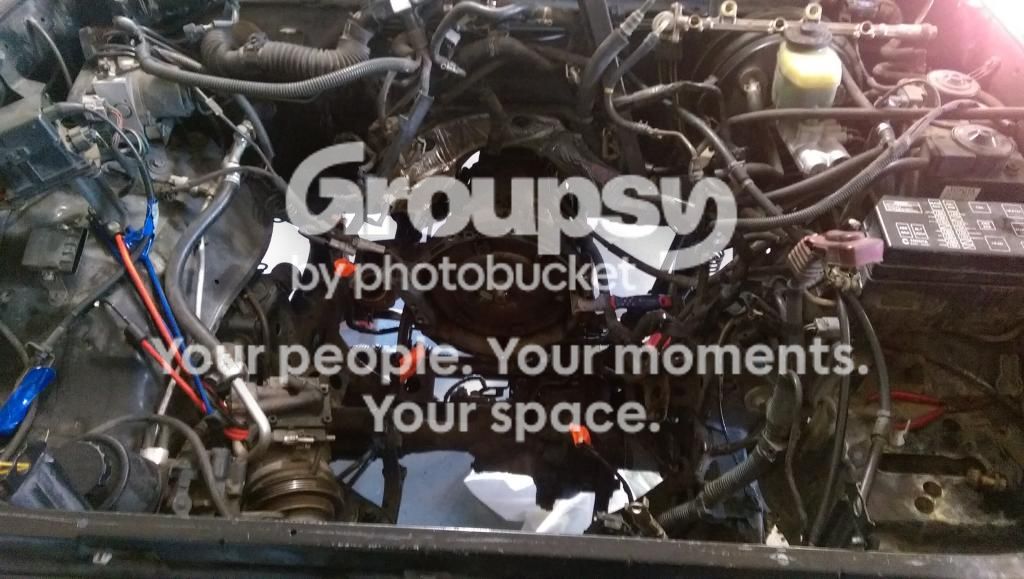

There she is in all her glory...
Shell status...
Anyone ever powerwashed their engine bay in this state? Yay/Nay? What's your verdict T4R.org????

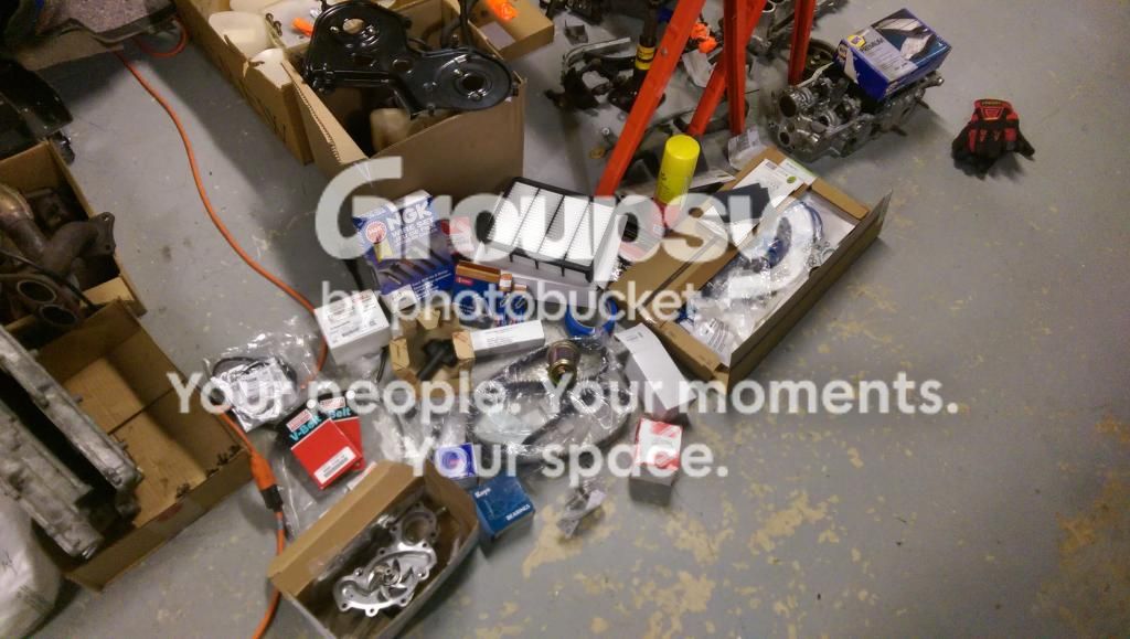

I sent the engine out to get rebuild and that has given me some time to finish a lot of little projects and acquire some goodies.
It's like Christmas all over again!!!

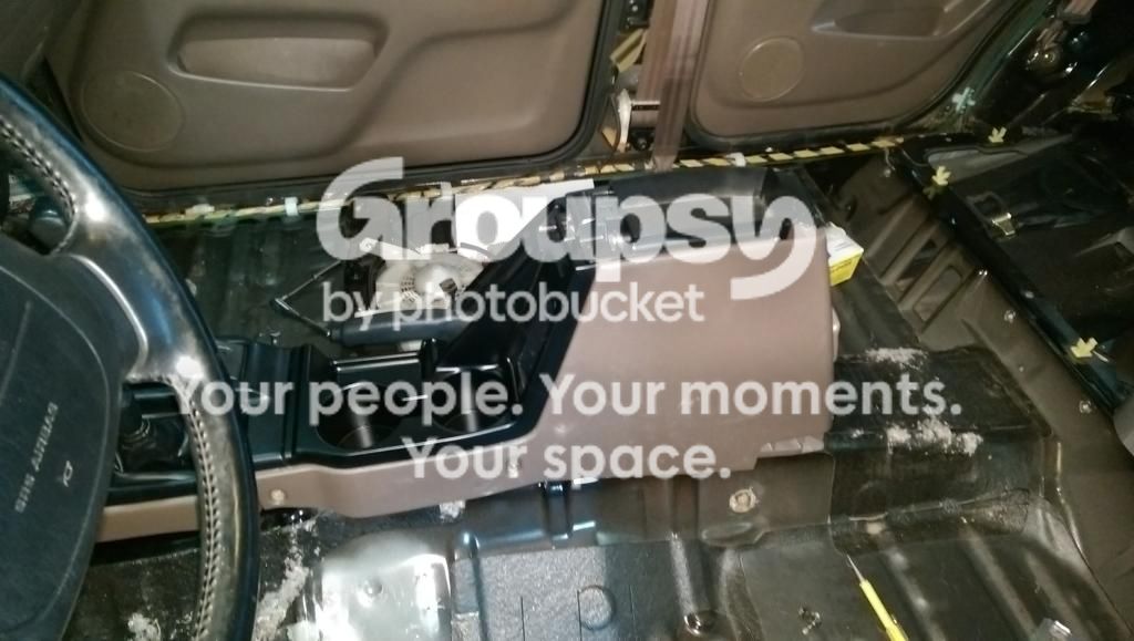

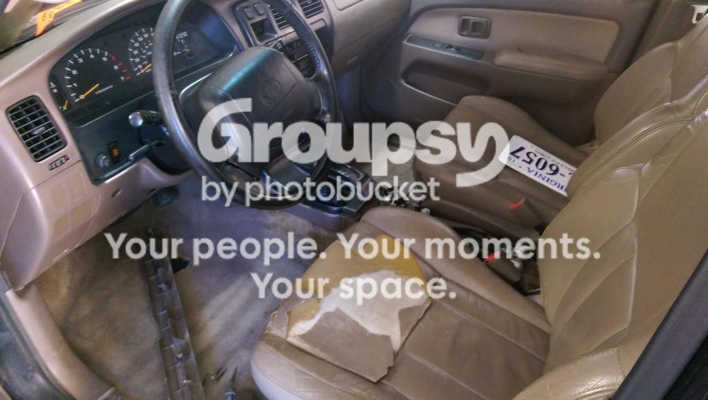

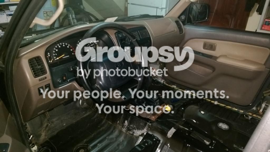

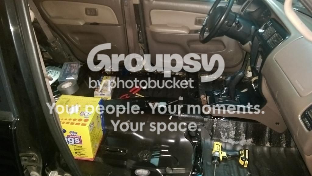

I set out to cleaning the almost 20 years of crap out of the interior. It was DISGUSTING! And I only found like 50 cents.

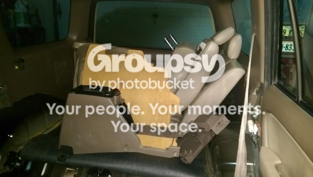

The rest of the interior in the back.

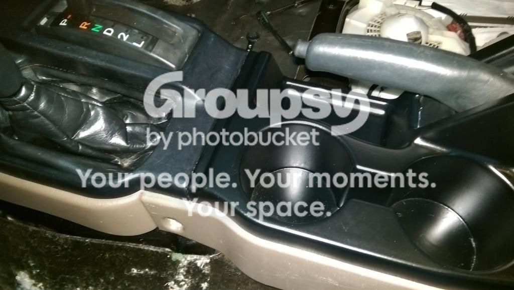

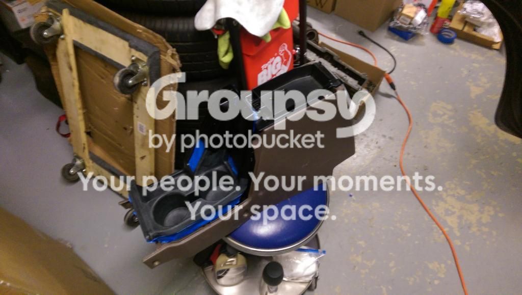

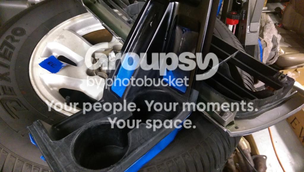

Also got a 99 center console! SCORE!

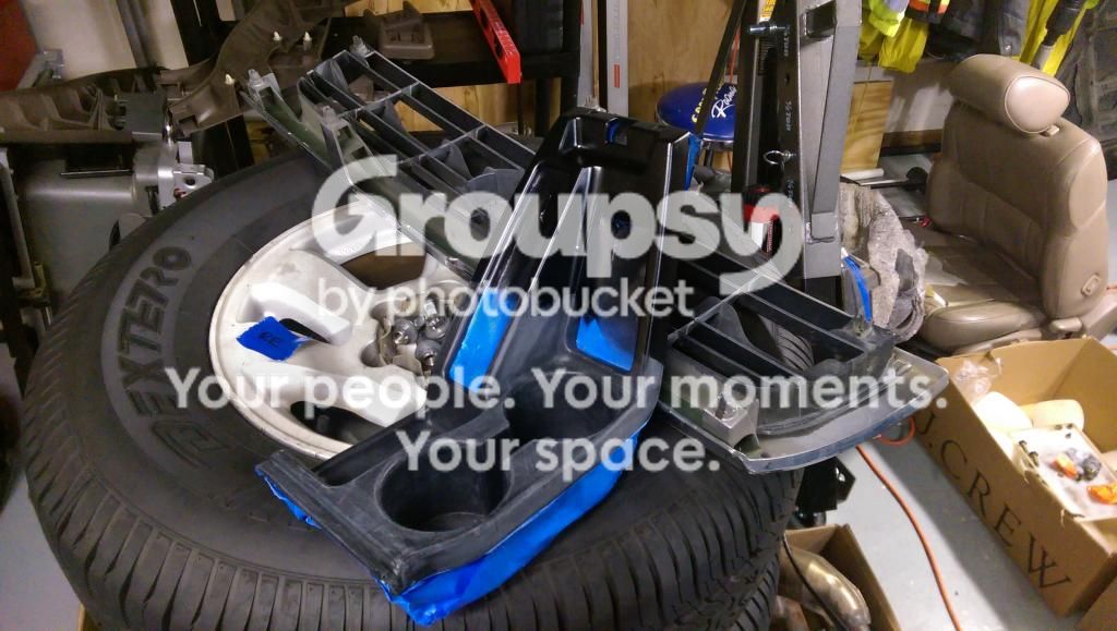

The actual cup holder part was scratched and had seen better days.
I scuffed it up a bit and shot it with a few coats of this.
Half of it done. Pretty good. We'll seen how the rest of it turns out.

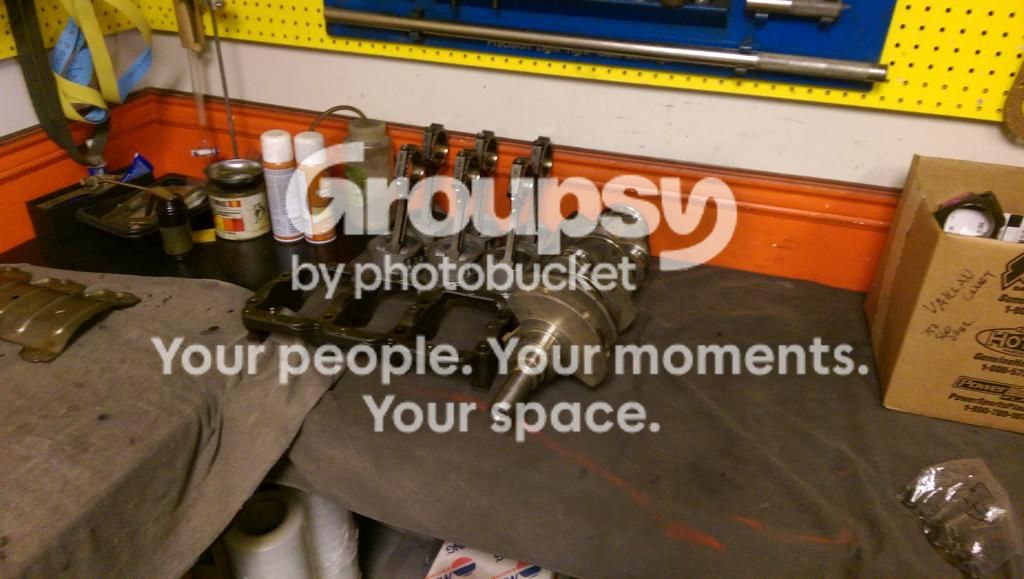

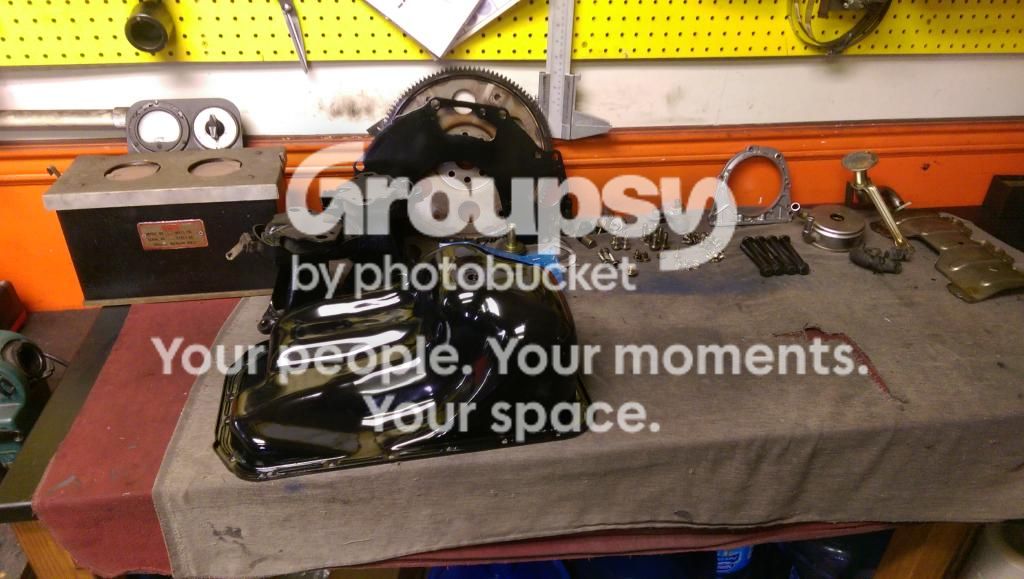

Went and dropped off some head gaskets and other little things at the machine shop today. While there, I got to peek at my block and its guts. Guys said that everything on the bottom end looked great. A light hone on the cylinder walls and she is good to go! (And that's with almost 300K on it!)
Clean and freshly painted parts always make me feel warm and fuzzy on the inside. :madgrin:
If anyone in the 757 reads my thread and wants their engine rebuilt, I would HIGHLY recommend these guys. Have been completely upfront for price, extremely knowledgeable, and inclusive (took time to show me the shop, other work they had, and my parts).

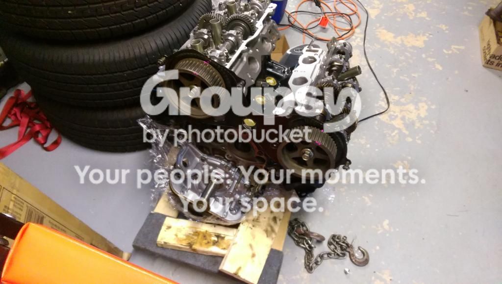

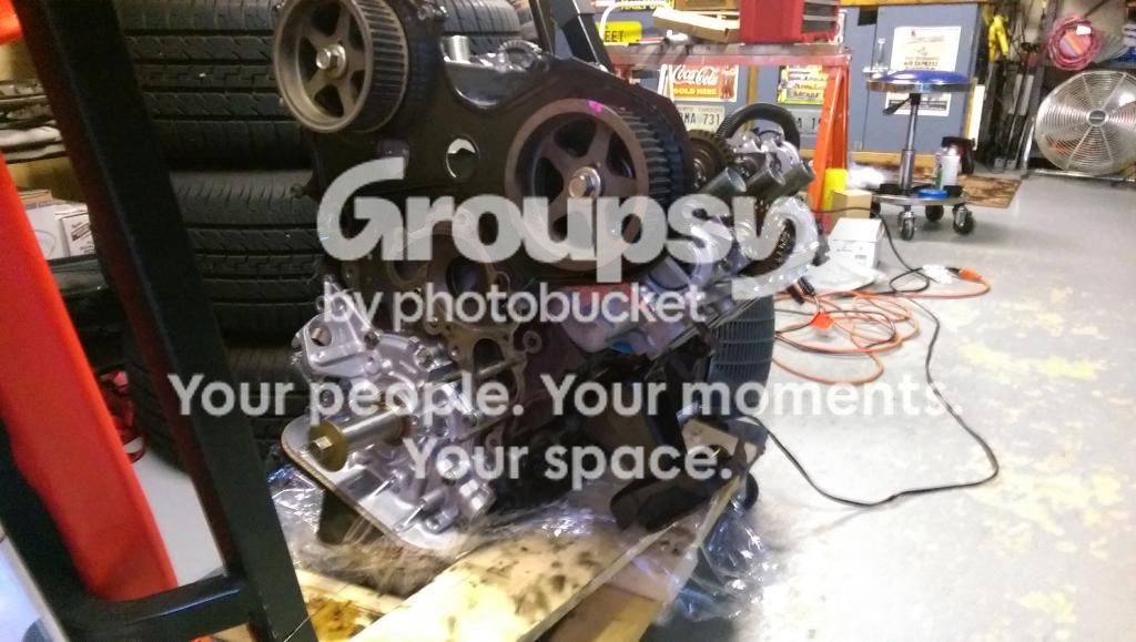

Got the engine back from the machine shop today!! So freshy! Can't wait to get a free day or two to throw it in.
Until that time comes around, I'll have plenty of clean up to do. The mental list keeps getting longer and longer; valve cover gaskets, intake plenum, throttle body, front transfer case, miscellaneous tabs and brackets. :pout:
Thinking I may do the TB/WP, starter, and alternator while still out of the truck...
And a follow up to the cupholder insert on my console. All freshly painted...I think it turned out well.
A close up of the shifter cover for comparison.
