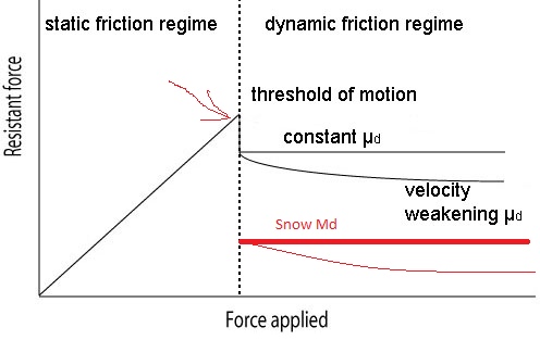

It's most of the time the difference between moving and not is about how close you can approach the threshold of motion - and really the peak threshold at all 4 tires. (That's why lockers have the physical properties of mechanical coupling that allow more peak traction than any traction control system. Also why you can in fact stop faster on snow/ice with a 4x4 than a 2x4 - often quite a bit shorter stopping distance.) In snow this is one reason automatics are not as capable as manual transmissions. You simply cannot control an automatic as well as a manual with very low gearing.
Anyway the goal in most cases is to get as close to the peak as possible - without going over. Having greater control allows you to potentially approach the peak and maintain near peak drive force better than in 4hi.
Also 4 low changes shift points significantly and keeps your engine much deeper into the rpm range at a given speed so you have a lot better throttle response at 20mph and much quicker application of power.
(at least on ice). When you are stopping, engaged drivetrain/ locker or otherwise would have no bearing on the braking system. Assuming the pads are all applied in equal force, 2 or 4 wheel drive will slide equally on ice. Stopping is based on the friction of the tire/surface. Brake pads, maybe, studded or snow tires maybe, lockers/torque, no way.

Mechanically coupled tires can approach the net threshold of motion of all 4 tires. Uncoupled tires do not with current brake systems that balance hydraulic pressure and therefore stopping force, not rotational velocity.
The easy example is to take a single axle. (I'm not using units to make this very simple) Let's say for example that the right side has a static friction of 10 and kinetic of 2. The left has static of 5 and kinetic of 1. When you apply a force of 7 to each tire, the left will lose static friction and only provide 1 unit of braking force. The left will provide 7. If the differential is locked the left tire cannot exceed the threshold of motion due to the mechanical coupling with the right tire. It acts as a single system, not two independent systems. So the left will in fact provide 4.5 units of force while the remaining braking force transfers to the right through the axle shafts and the right will provide 9.5 units of stopping force, providing the full 14 units of braking force.
To recap - in open diff scenario you get 8 units of braking friction, in the mechanically coupled axle, you get 14. 14 units of brake force stops faster than 8. Ergo - mechanically coupled drive trains can in many cases stop faster on snow and ice.
