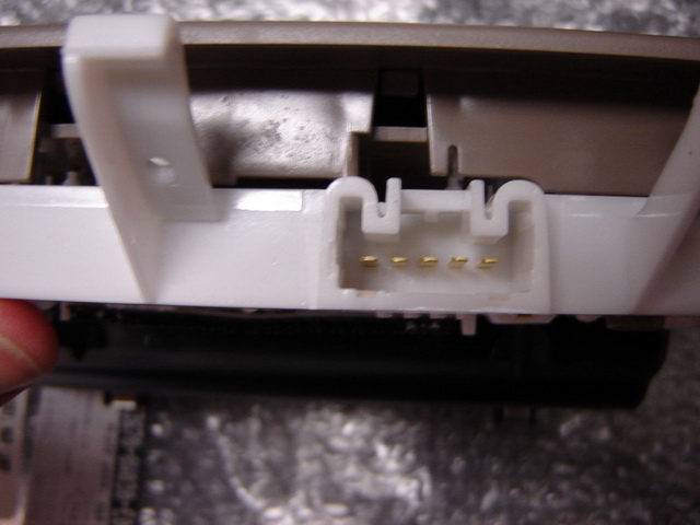

The unit is very easy to install since all that's necessary is to pull the old one down from the ceiling by pulling from the side that faces the windshield. The old unit unplugs with 1 plug, and you simply plug the new unit back in.
The plug has a spot for 5 wires, but in my case there were only 2 wires in the plug from the ceiling. These 2 wires WILL power the map lights as well as the Homelink unit. I imagine the other 3 pins are for powering the sunroof (which I don't have). You can then follow the directions in the owners manual for programming the Homelink unit.

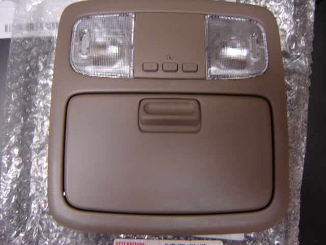

It's really simple to install, it literally only took about 5 minutes to do. It took longer to get it programmed for both of my garage door openers than it did to get the old unit out and the new unit installed.

There aren't any instructions that come with the unit, but the instructions for programming the Homelink are in the owners manual.
How did you remove the whole unit. I tried to do this when I was installing a bluetooth kit and I could not pull the map light assebly off. It felt like I was going to break it.
Grasp with both hands the edge that runs along the window and pull straight down. It'll have a tab that slides up over the headliner that it hinges from on the opposite side. Once out remove harness and reverse you steps with putting the new one in.
