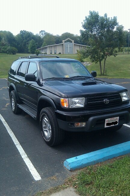

Hey, new 4runner owner, 99 black manual SR5. I love the truck but I'm having some issues. My rear driver side window won't work and when the window buttons pressed, which to me indicated that it was electrical. I took the door panel off and looked for anything out of the ordinary. Has anyone had a similar issue? I'm just looking for a diy solution.
The other problem is my driver side door can only be opened with the key. The keyless entry and button appear to not have an effect. It started getting dark before I could get in and look so if anyonoe could give me some theories on it that would be great.

time to download the service manual and get out your multimeter to do some diagnosing.
I had a seized power lock motor on one door. It might just be one of the snap connectors?
I also had a corroded switch for the rear window. A little cleaning and it works like a charm.
I'm going with the corroded switch idea. Just clean the contacts with a small wire brush of whatever you can scrub it with.
x2 since all of your problems are on the left side i'm thinking it may be a pig tail of some kind or a plug has become rotten/disconnected.
