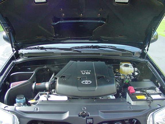

Seriously, AEM makes bypass valve??? Never saw it. How it looks like? Some sort of tube or just insert for a tube?
There is no point in getting an aftermarket intake unless you are getting a snorkle for the sake of fording water. The OEM intake sits very high in the fenderwell as it is and any performance cone filter will only increase the chances of flooding the motor.
K&N Performance Intake fits exact the same place as OEM one. I was wondering of floating it at this point when water coming over the hood. In this situation it floats original and any other intakes, so I thought of ideas to find a solution (without snorkel) to prevent water coming to the engine.

Alex, i was driving from barrie-bradford-newmarket-north york... if i saw another black 4runner i would have noticed. chances are, we would have been the only ppl in the right lane plowing through puddles. hahaha...
anyways, about the intake. an idea i had was maybe a ram air like design....but with flexible tubing. such as the SPIRAL-FLEX INTAKE SYSTEM http://216.120.227.145/~racings//prod_spiralflex.php
i dont know how to do links and stuff. i dont know if the link will work. hahaha....
or a ram air kit from weapon r. you can place the intake in whatever position and you have a cover to cover it if you need. you can pretty much place the intake filter and tubing wherever you want. but i think a drop in filter would be just as if not more effective. hope i was of some help.
