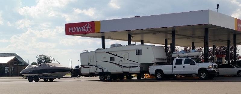

People do some crazy stuff. Saw this wreck on the highway in Idaho. After I got this pic we passed it on the interstate trying like hell to keep the rolling train of shat on the road. Scary!
What's not obvious is the 5th wheel had a roughly 6x8 foot hitch box loaded with stuff and the boat was then hitched behind to the back of the hitch box. And there's another paddle boat on top of the truck. At some point it's time to quit adding.

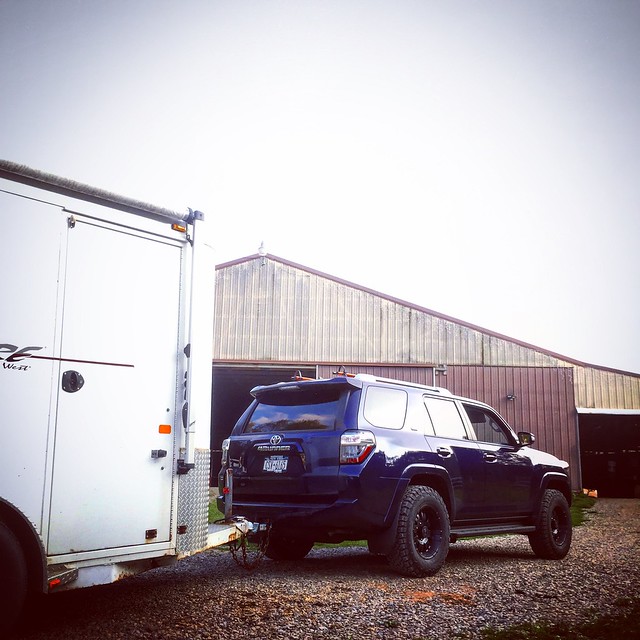

I used mine to pull a steel two-horse trailer Friday night. It only had one horse on it (about 3,500 lbs total).
It pulled ok, but I wouldn't want to drag around much more weight than that.
