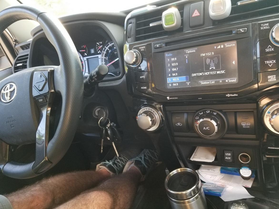

Ummmm....anyone ever put the wrong key in their 4Runner? Tonight I put my valet key from my 2010 Tundra Crewmax in my 2016 4Runner Trail, started it and drove off with no problems.
Anyone else tried their other Toyota keys? I didn't try the door to see if it would unlock also. I keep it in my garage and park in a safe place 99% of the time, but am still not thrilled.

The keys are chipped so it's probably only working because you have the correctly chipped key right next to the Tundra key. Still odd the cut matches, wonder what the odds are off that. If you want to really test this leave your 4R key in the house and then try the Tundra key.

In your case the chipped key had to be in close proximity to trick the sensor. Is that it hanging on your key ring? Otherwise the Tundra key would have turned but no start.
