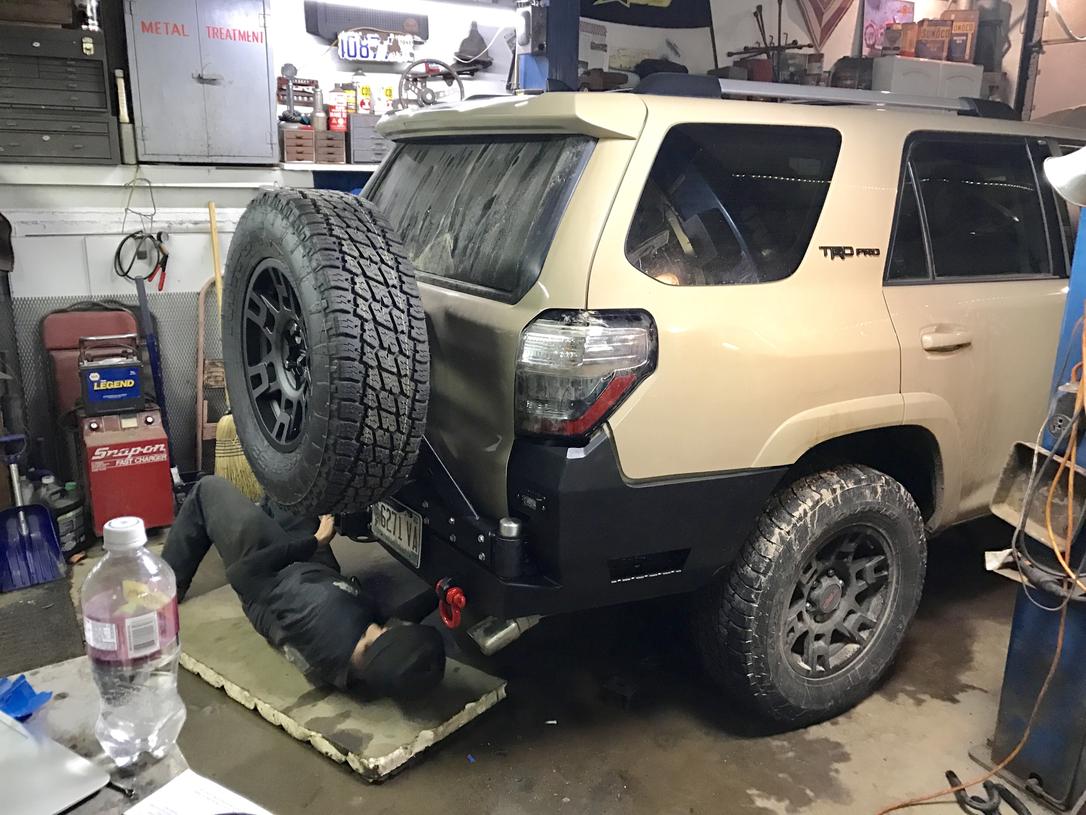

Cornfed with SSO rear bumper
Well I finally got my SSO rear bumper which leveled my trdp.... anyway. I want to lift it now. I honestly don't like the leveled look. It doesn't look as aggressive to me. I'm torn between the toytec 2" lift or cornfed. I'm thinking the toytec will give me the slight rake I like where a cornfed 2" all around will just raise it 2" level. Any input or experience with this?

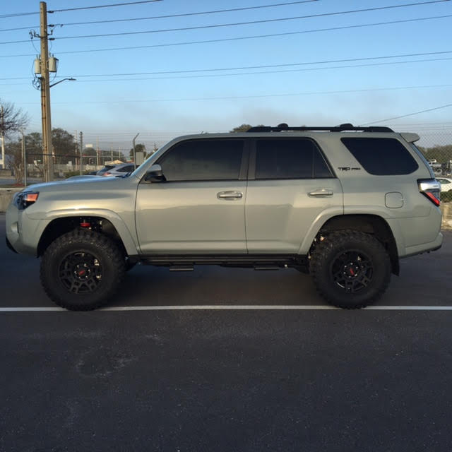

I do. Cornfed 2.25" front/ 2" rear, Spidertraxx 1.25" wheel spacer. Comfortably sitting on 285/70/17 Cooper STT Pro with minor bumper cut(in addition to port mod), fender liner mod, and removed the mudflap. I'll try and get some better side shots, and comparison shots up soon. I think the 2"/2" would easily fit an A/T tire. I did the extra .25" in order to eliminate the rake, but it is still marginally there.

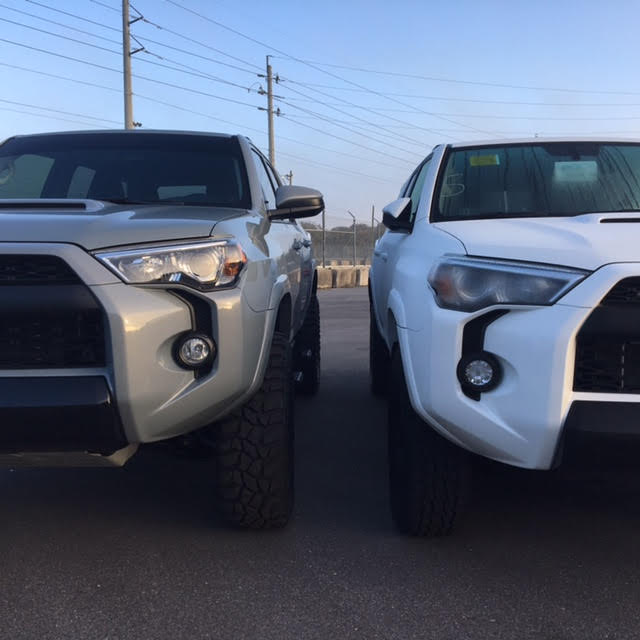

Comparison...
Probably the best I can really offer up at this time. Sorry, iPhone is my camera. The white is a bone stock TRDPro. If it's been said before, say it another 100 times, pictures do these things no justice. As stated, definitely need to do some trimming. I threw on the SPC UCA's and would really like to push the caster forward a little in order to correct some additional minor rub when in reverse full lock left and right. Hope that helps, and congrats on all getting new Runners! :cheers:

So sexy. I am thinking I will start with the 275s and use those until theyre oht and upgrade to the 285s. 275s will have no ruband when I upgrade the tires I can do the fender liner mod
Definitely not a bad approach. Also, and I don't think I mentioned it, but for all you saviors of petroleum... well as you can imagine I took a fairly good hit on the MPG and went from 19-20mpg to about 15-16, maybe 17. SO if you're looking to keep the mileage up you will certainly want to go A/T.
