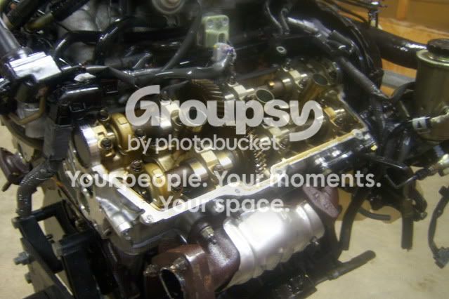

As far as swapping in a JDM motor can I use most of my engine harness etc? How much work is involved? They seem to be super low miles from what I can see.
You will be able to re-use your old harness. Its basically just a plug and play operation except youre unplugging everything from the motor, pulling it, dropping in a new one and plugging everything back in.
Some of the JDM motors come from vans or 2wd vehicles so your motor mounts and oil pan could be different, and there may or may not be an oil cooler but you have all the necessary parts from your old motor. Swap those over and youre good to go.
What is the benefit of importing a JDM engine instead of one out of a US car? Same engine -- what parts are different?

The miles. JDM motors usually have VERY low miles... 50k ish.
I wouldn't buy a JDM motor without being able to inspect it first, there are pictures and stories all over the internet of JDM motors that never had the oil changed for the 50-70k that they were used in japan, that's some nasty stuff.
The place I got mine from had walls full of them, I walked out into the shop and they pulled them down and let me inspect them. I sweet talked the lady at the counter to let me pop the valve cover before I dropped my cash, and it paid off.
yea, I figured from the name you were somewhere in Oregon or Washington, in the NW we have the convenience of having huge warehouses full of JDM motors, I'm not sure if the OP has the same luxury.
So I found a motor locally but they were saying something about different generations of motors? Late and early model? Is any of this relevant or sould any 5vz work?
