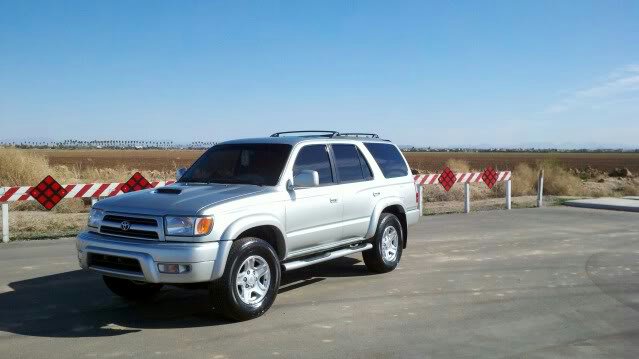

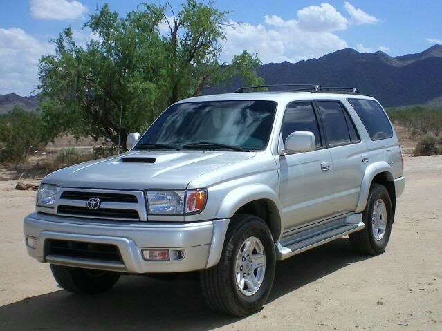

Here it is when we first bought it. July 2010

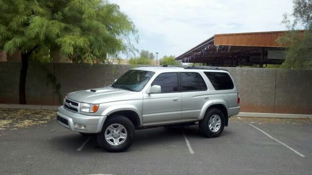

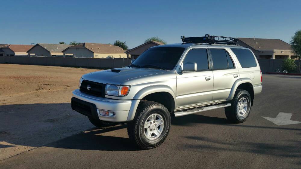

How it sits now

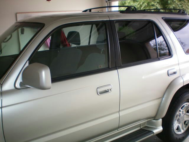

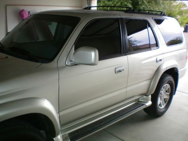

Hot in Arizona. Had to tint the windows first. A before and after
Went 15% all around which made the rears basically limo. And had the limo windshield strip put on.

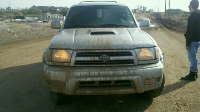

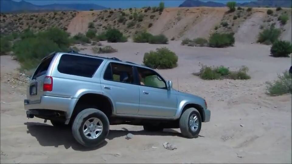

Had a buddy of mine show me how to get her dirty for the first time! Loved it!

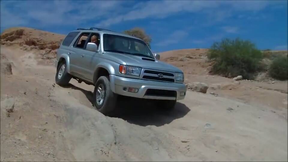

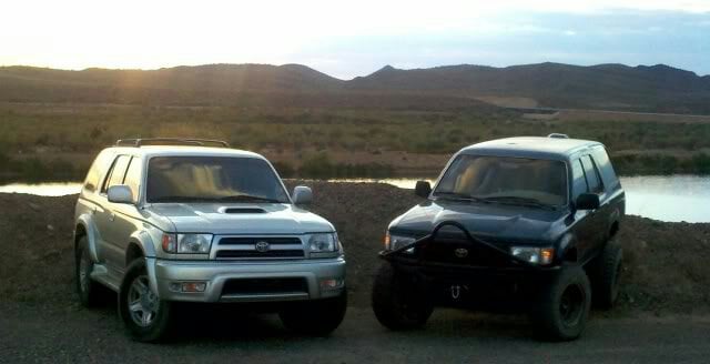

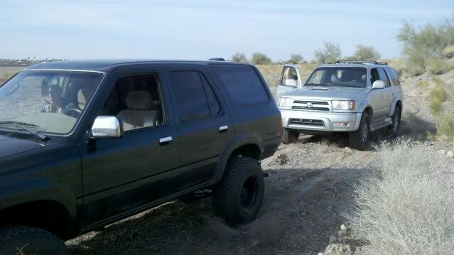

Which led to a little more fun with my buddy and his 2nd gen. Headed out to Saguaro Lake through the Butcher Jones Trail. first time getting her on 3 wheels. All stock setup and highway tires.

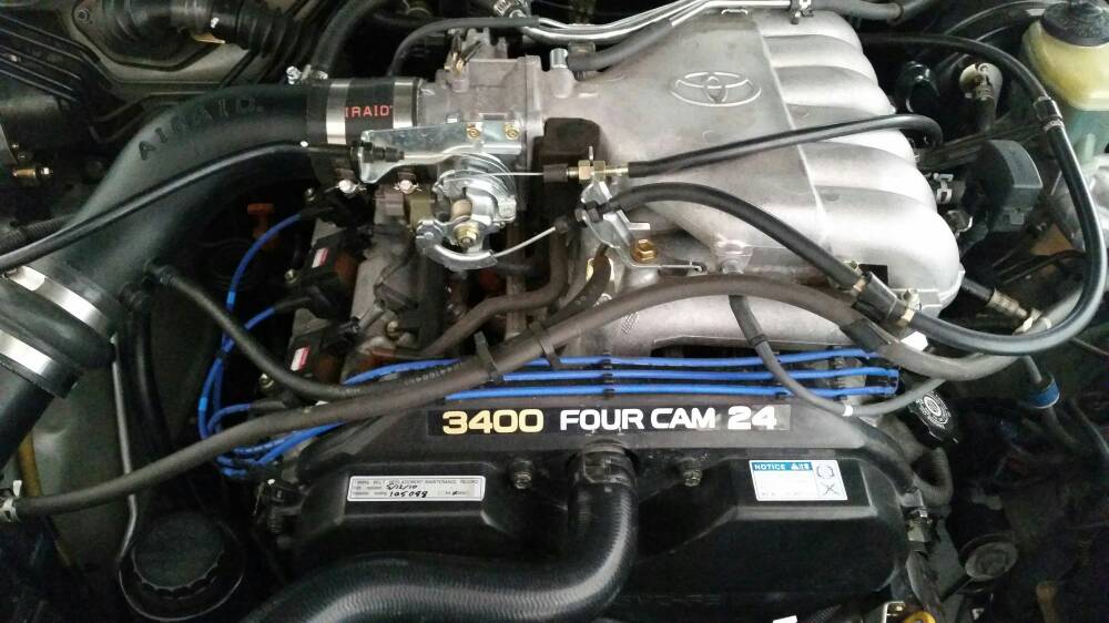

So needless to say the money started going towards that and not so much into the fun stuff. But still did a few things to it. I did the isr mod with the air raid that I got in exchange for a wax job on my step dad's truck. Good deal! And I did the deck plate mod! Wish I did it when I first bought it! Nice difference.
And you can see in the picture that I also did new wires and plugs. Ngk blues. Dressed up the engine a little bit.

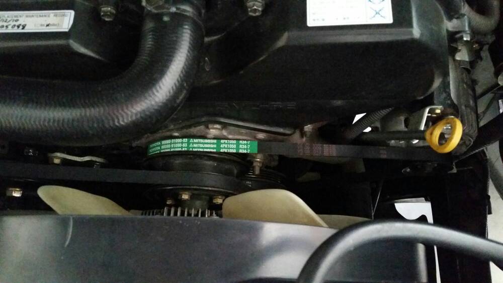

Just little things here and there for a while. I wasn't very good at documenting because I didn't have a build thread at the time. Wasn't even sure what that was! Lol. Couple years went by and about a year ago, the AC compressor started making a lot of moaning noise. I thought it could be the belts. So I replaced all of the drive belts with oems. Too much money. Looking back now I would have just gotten the Gates belts.

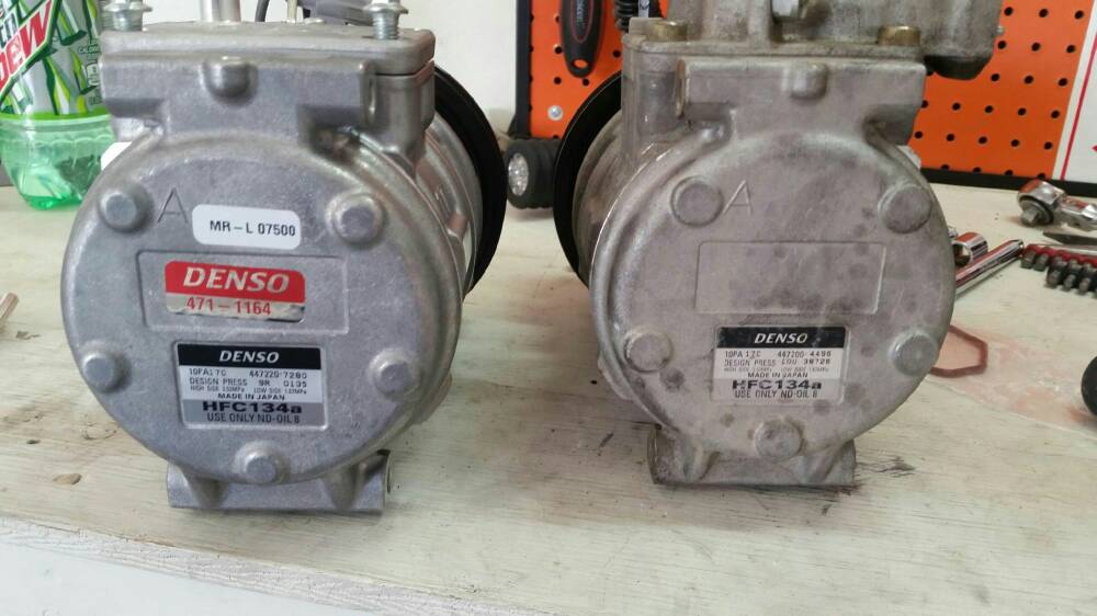

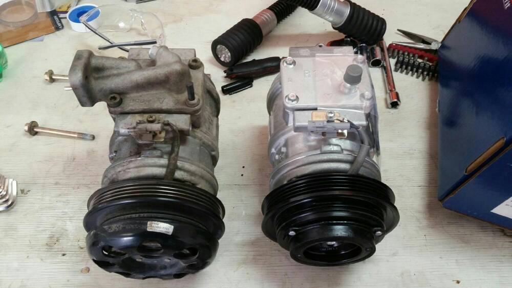

But that didn't fix the problem. Was hoping for the cheap resolution. Guessing it was the bearings on the clutch? Wasn't sure. Didn't wanna mess with a rebuild so I got a new denso unit on amazon and installed that. Along with a new denso dryer.
Put it all together and took it to an auto shop close by to vacuum and recharge. No leaks. This was my first major wrenching job on this thing. It was nice to see it turn out ok.

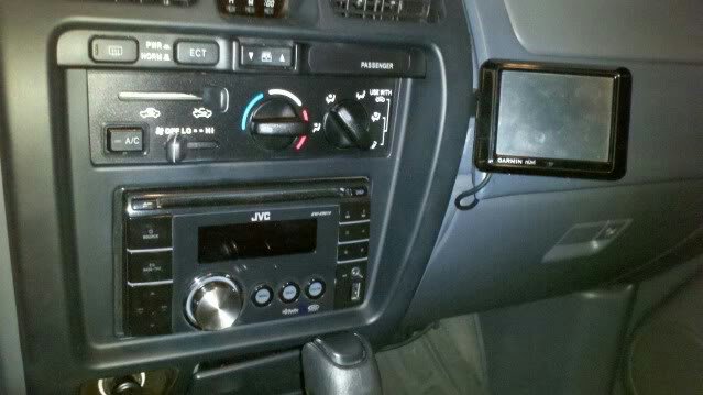

Added a new stereo. Wanted the double din so went with a jvc (which will probably be replaced soon with newer technology) and mounted the Garmin next to it.

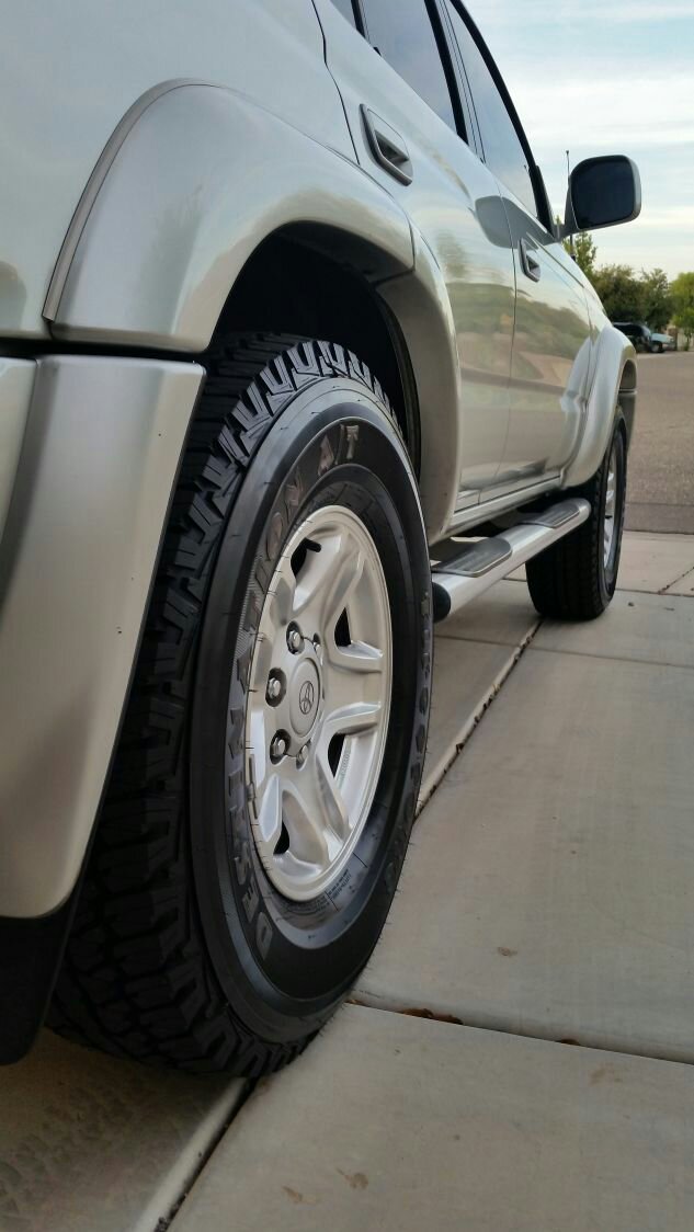

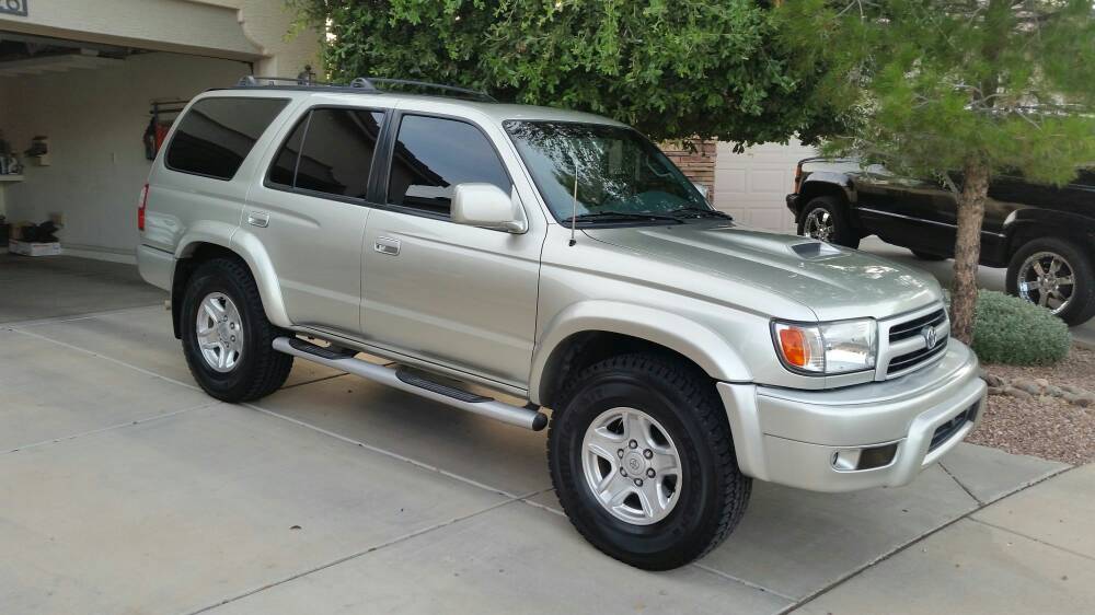

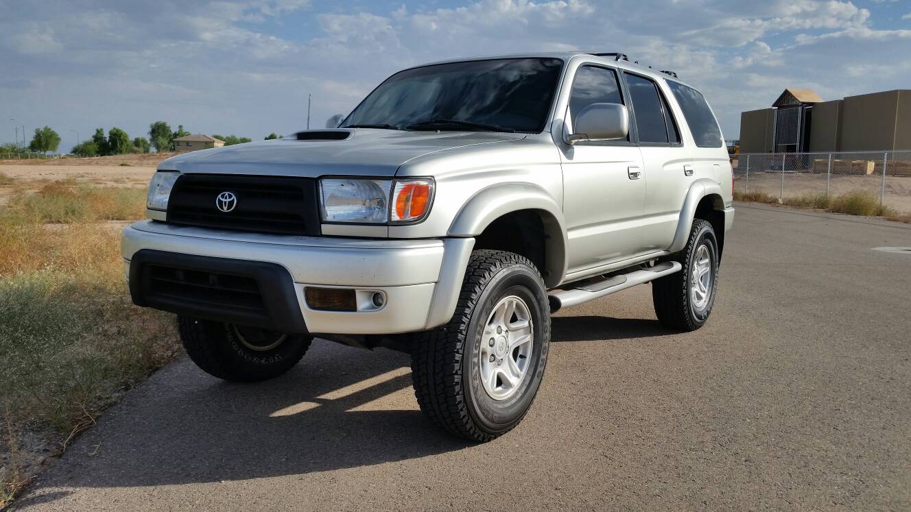

The highway tires finally wore out and I threw on some 265/75/16 Firestone ATs. One size bigger and the all terrain made it look a lot better!

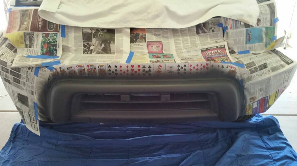

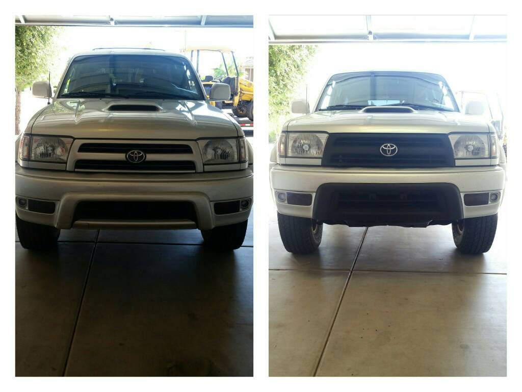

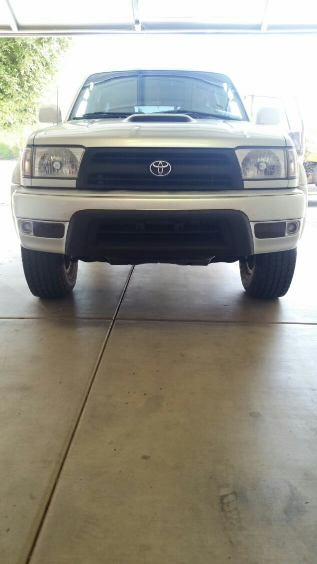

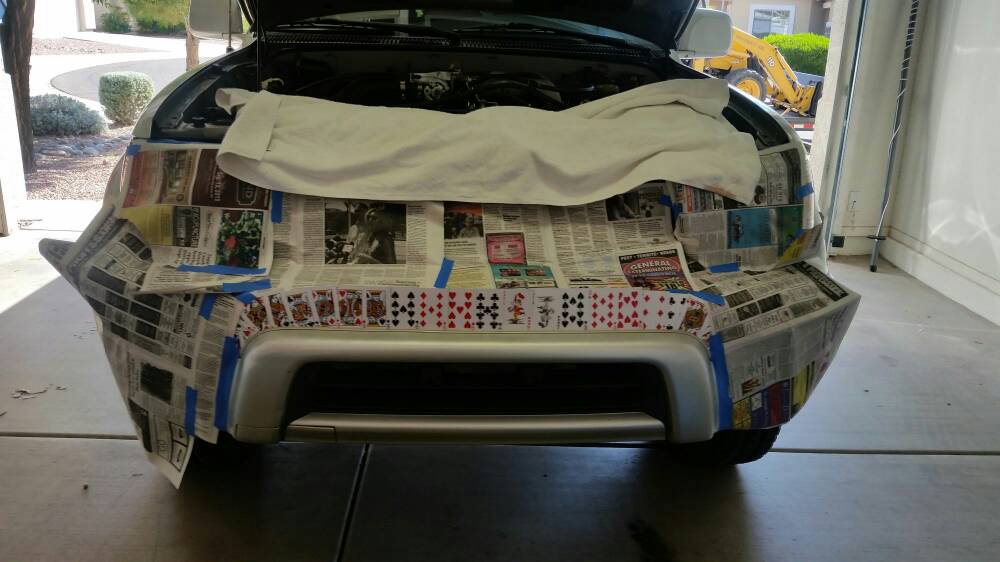

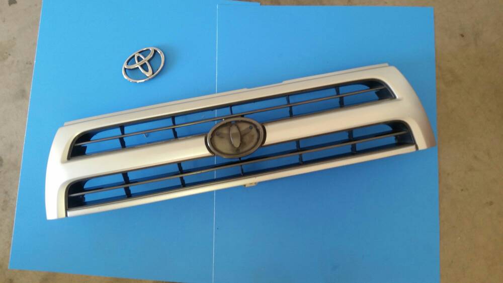

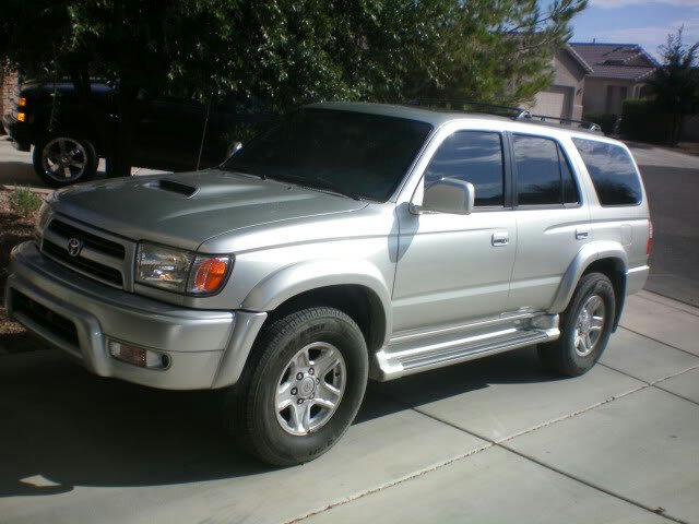

I was bored one day and decided to plastidip the grill and bottom of the bumper. Not sure why I did it but I ended up liking the look. Going to do the Satoshi Grill in the near future so I'll just leave it for now.
And a little before and after
Made it look a little sportier up front. And a little like the 5th Gens.

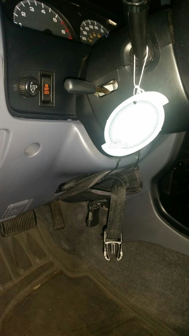

And a little cheesy but I didn't want to drill holes so I zip tied a holster under the steering wheel. Gets the job done and you can't really see the zip ties

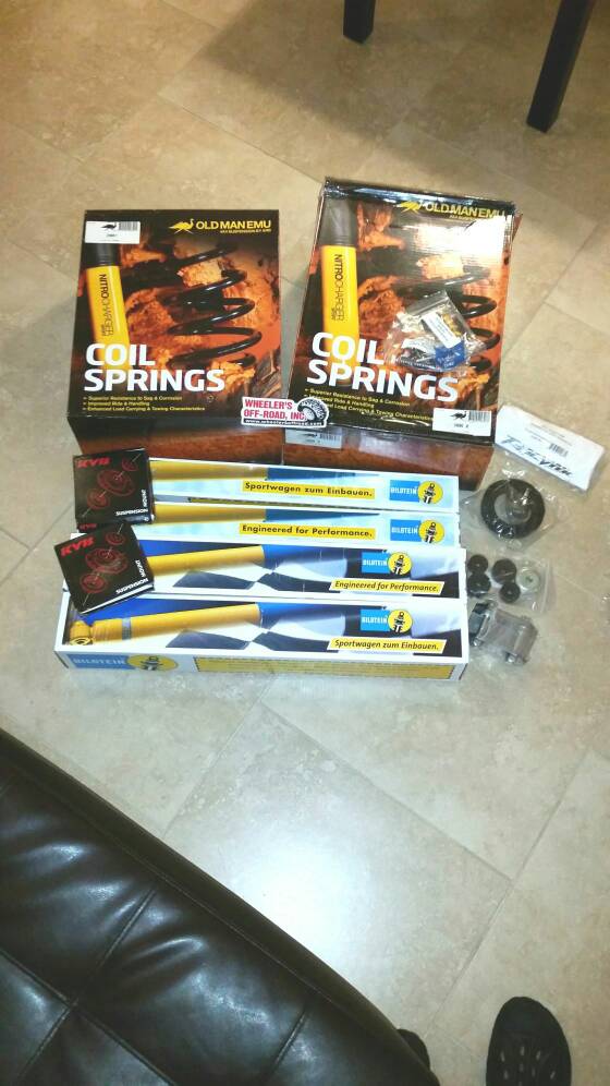

After A LOT of research mainly on this forum I went with 4runner 5100s and ome 881s up front with topout spacer and front dif drop, 5100s in the rear with ome 890s and Panhard bar drop bracket.
When I got the lift I was working a crazy amount of hours and honestly didn't have the time to install. I also wasn't sure if I could do it. So I gave all the parts to Desert Rat in Phoenix and had them install it all about 6 months ago. Sucky thing is that while doing the lift they noticed the rack was leaking pretty bad and had a lot of play in it. Showed me also. So to save the labor I had them throw a remanufactured oem one in while they had it up in the air. The finished product was awesome!
I liked the way it looked. But after a few months the back really started to get lower than the front. So I took the topout spacer out of the fronts. On my own. And I realized I could have easily done the lift myself! Ugh! Now I know I guess.

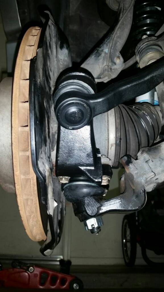

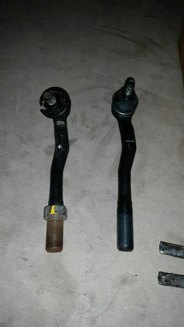

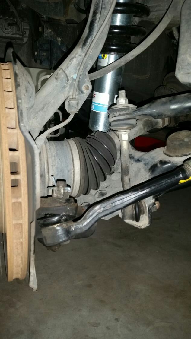

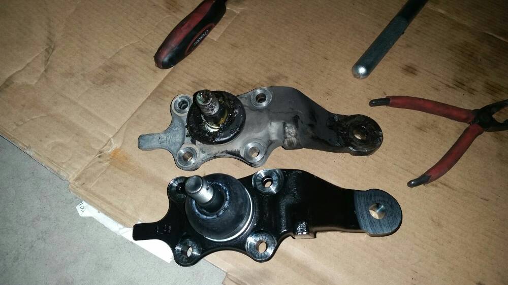

After lurking around this forum I figured Lbjs and OTREs were next on the list.
This job was a lot easier than I thought it was going to be. Took maybe a couple hours start to finish. They really didn't look too bad but it was worth the piece of mind with the wife and daughter in it all the time.
The new and old
And all installed and good to go!

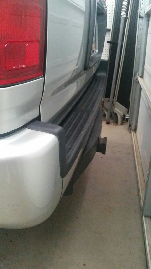

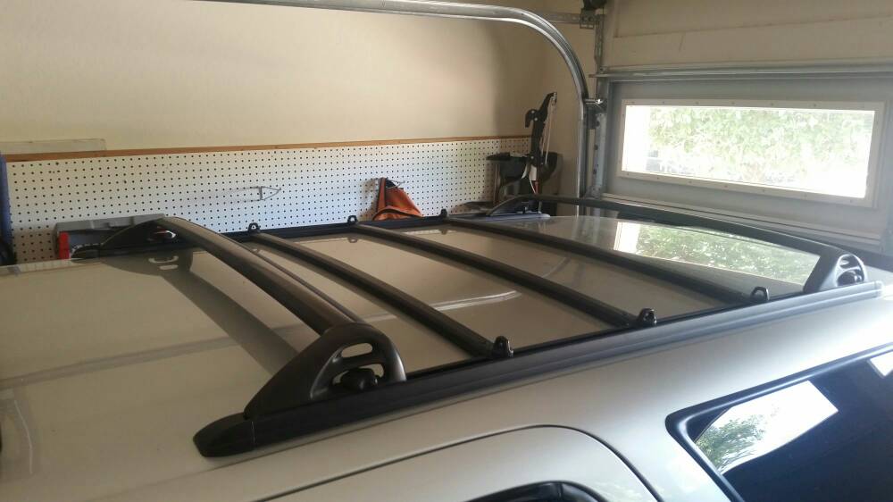

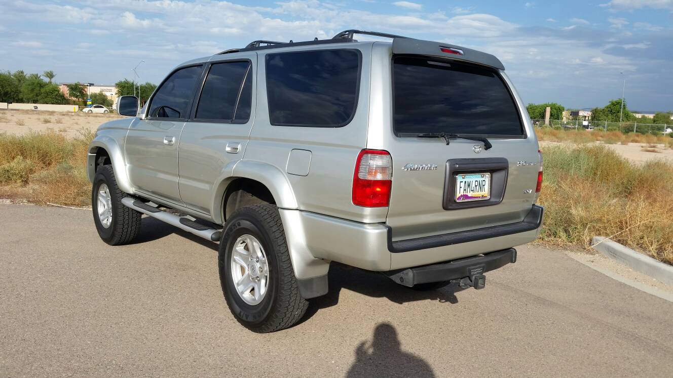

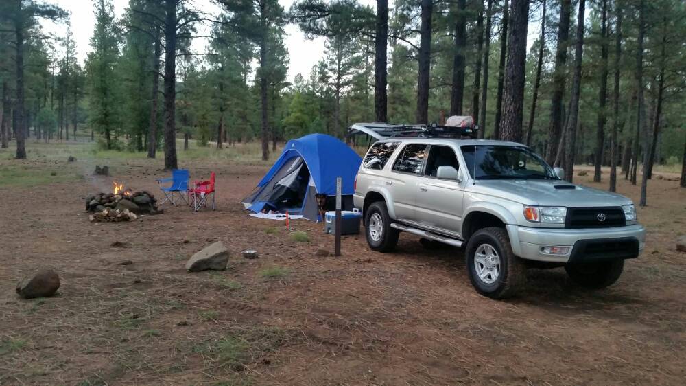

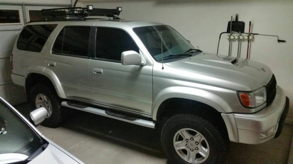

We were getting ready to go on a camping trip soon and needed the rear cargo area for the dog mostly so I needed a roof basket now. I really wanted the Rola but I took too long and it wouldn't have been in in time. So I went to Walmart and got the Reese one. It was on clearance for 79. Good enough for now! Actually like how it looks. Not too small like I was afraid of! And it holds 150 lbs. Enough for some firewood and bags and chairs and the tent. And I wanted to get some lights for camping back roads at night so I got some cheapie led fog lights with great reviews on amazon with prime shipping had them the day before we left! And installed those too! And again. Didn't really photograph the install. Eh. Here it is all installed in the garage. I didn't even check to see if it would fit in the garage before I installed everything. Lol. Luckily it did. Clears by about an inch. Whew!
And some photos of the excursion. Went up to Coconino national forest. Just north of Sedona past oak Creek Canyon. Nice country out there!

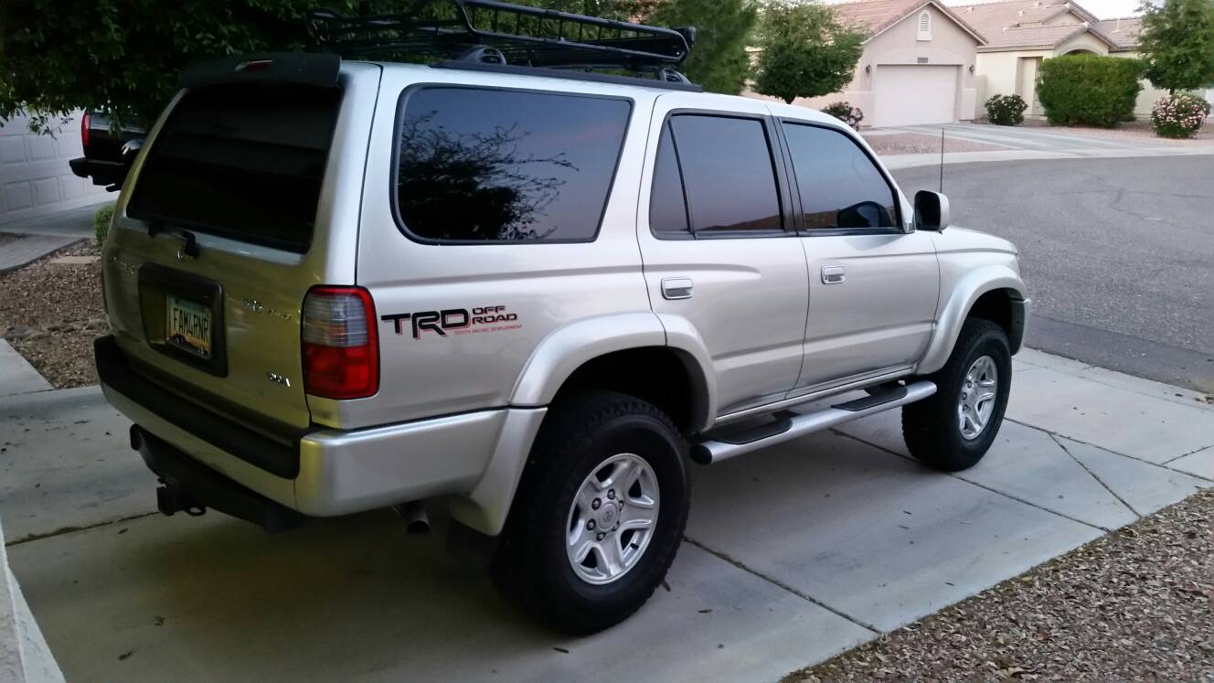

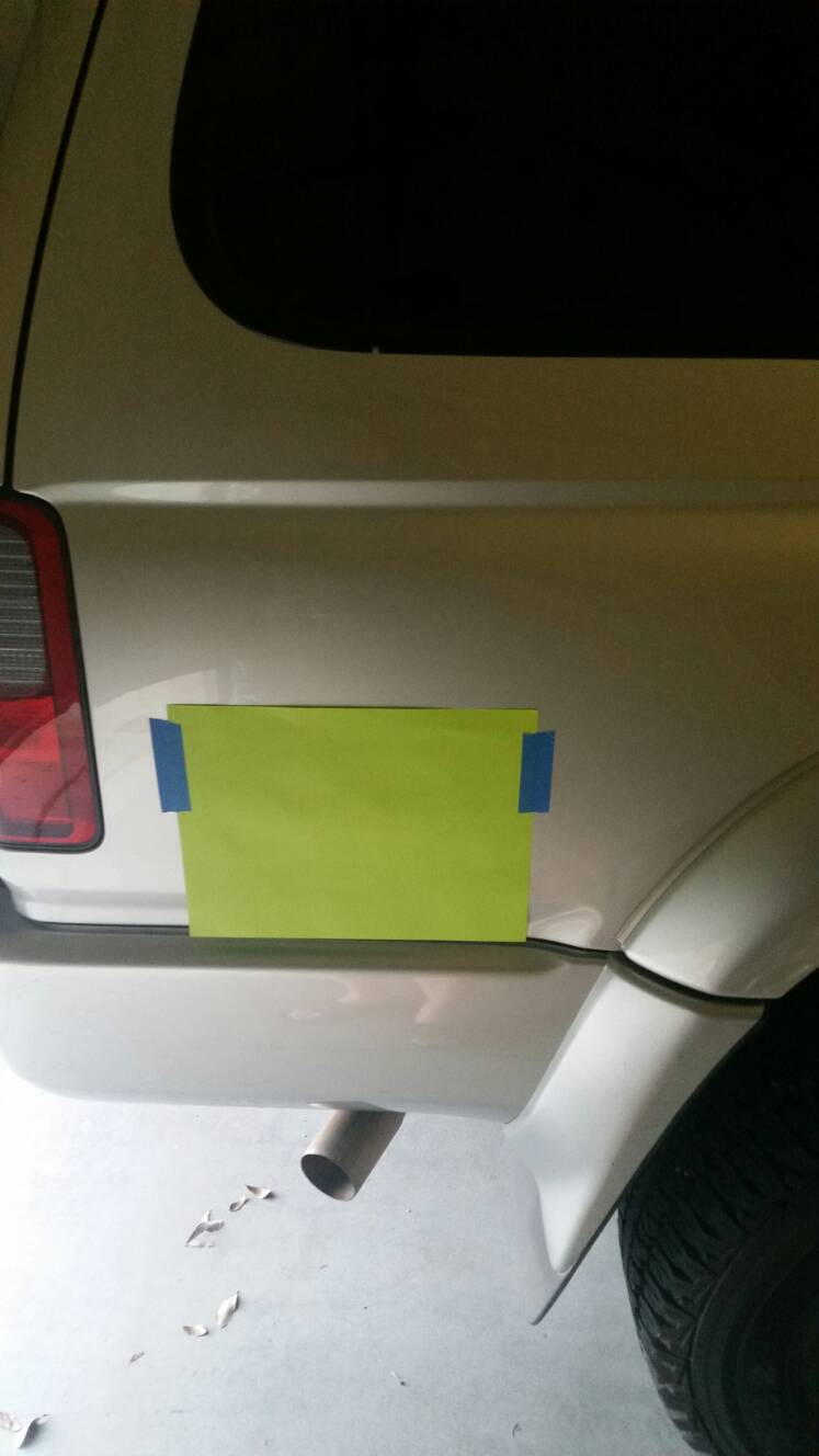

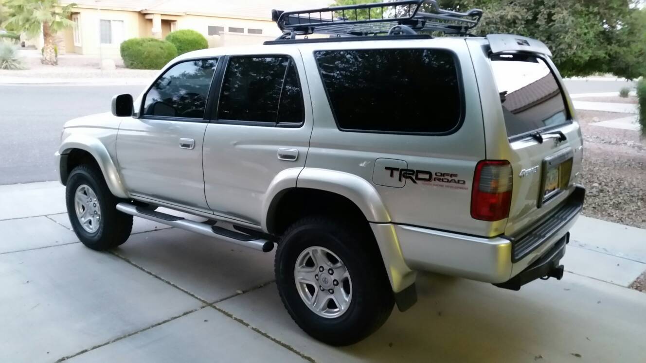

I got some TRD stickers in yesterday. I know some don't like them but I've always liked the look of them on the 3rd Gen. I got them on eBay for $12.50 shipped. Why not? I couldn't wait and threw them on yesterday. I used the paper method to line it up thanks to SURF RUNNER.
Line a piece of computer paper up with the body line above the bumper. Then line the sticker up with that.
Turned out great! They are about 1/2 off of the Tail light.
truck looks great. I was thinking about grabbing a walmart rack because I only need it every once in a while. Looks great.
Thanks you! Yeah. I mean at first I was nervous about it. But it comes with rubber sleeves and rubber washers to seal all points that water can get in. And it actually is really sturdy for what it is. And that sticker peels right off. Like you said, We don't use it enough to spend the money on a gobi or anything. It does good for what it is.
me only plan in the future is to buy an awning I wonder if it will mount to it. I haven't done the research yet since it's not happening that soon.
Yeah I haven't checked into that. It Might not because the rack isn't very long. But maybe the mounts can be moved on the awning? Not sure
