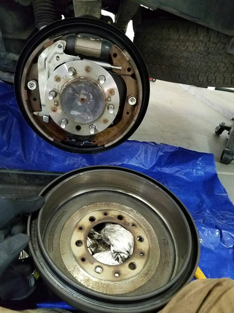

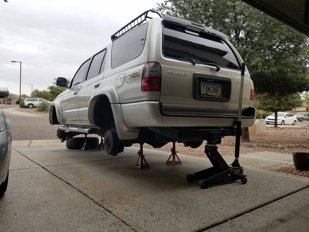

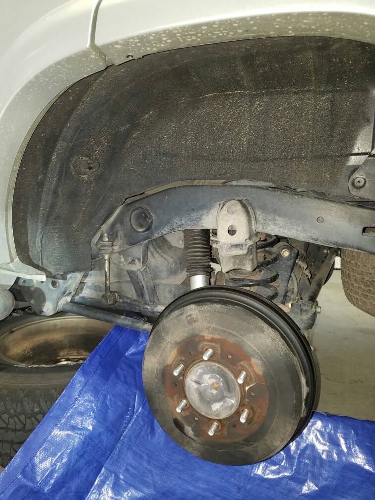

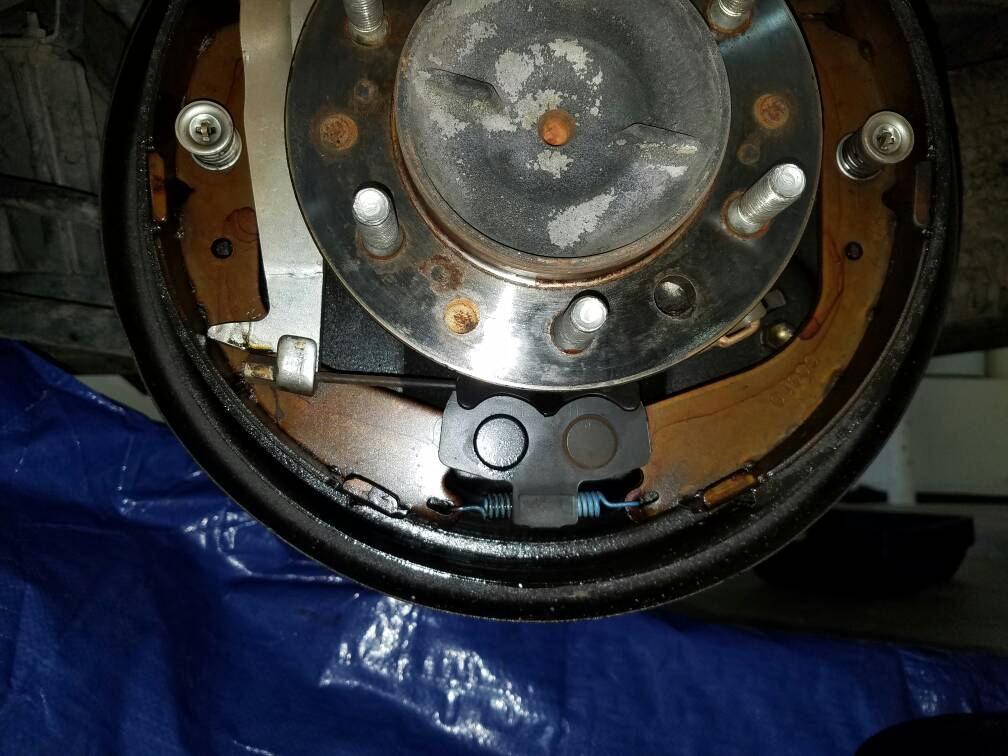

Got it jacked up and started with the bad side.

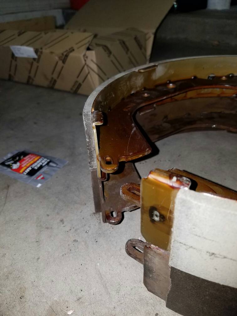

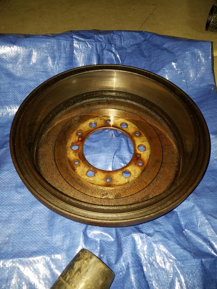

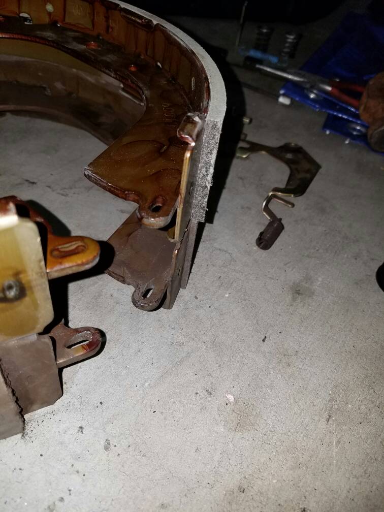

Took the drum off to find everything covered in gear oil
Got it all cleaned up and new shoes put on
When I removed the side that wasn't leaking I noticed that one of the shoes was worn all the way down and the other still looked new. Wondering if it was sticking for a while or what

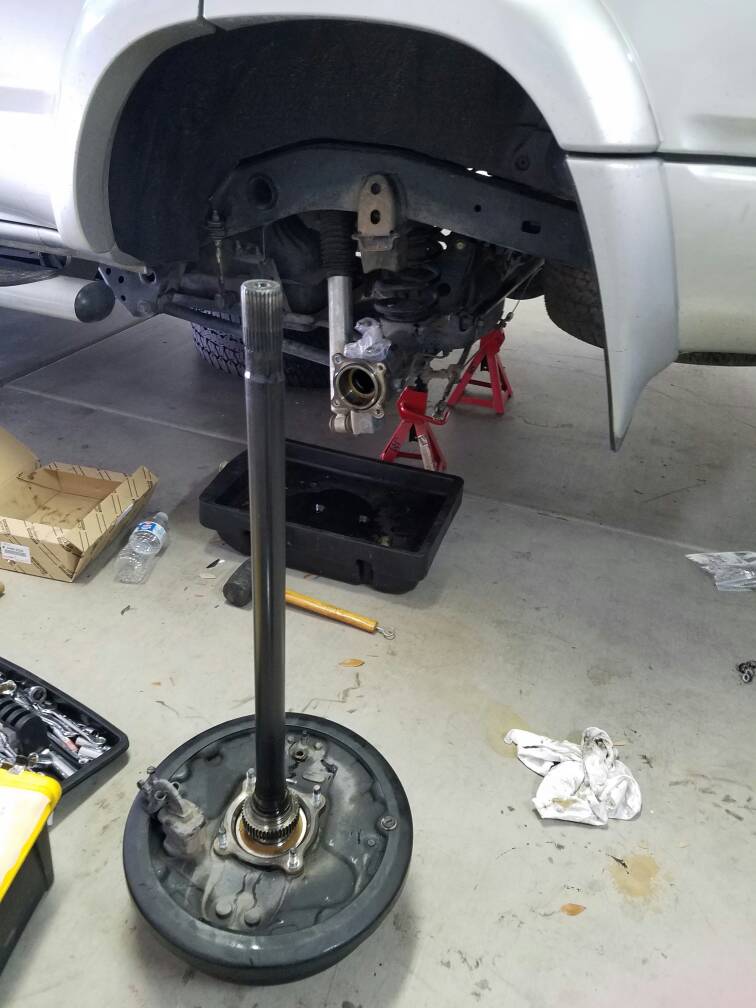

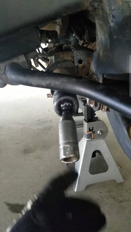

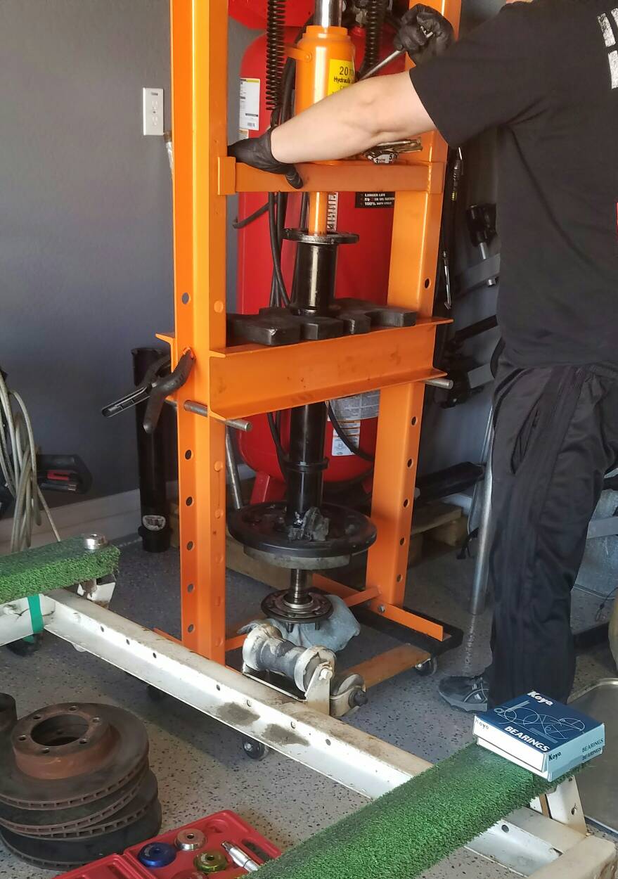

Then removed the axles
Then loaded them up and was off to [MENTION=123173]Jhelms[/MENTION] place for the press work!
Put it all back together, Adjusted the brakes a little, put in new synthetic gear oil, and did a brake flush. Next weekend will be the dif breather mod.

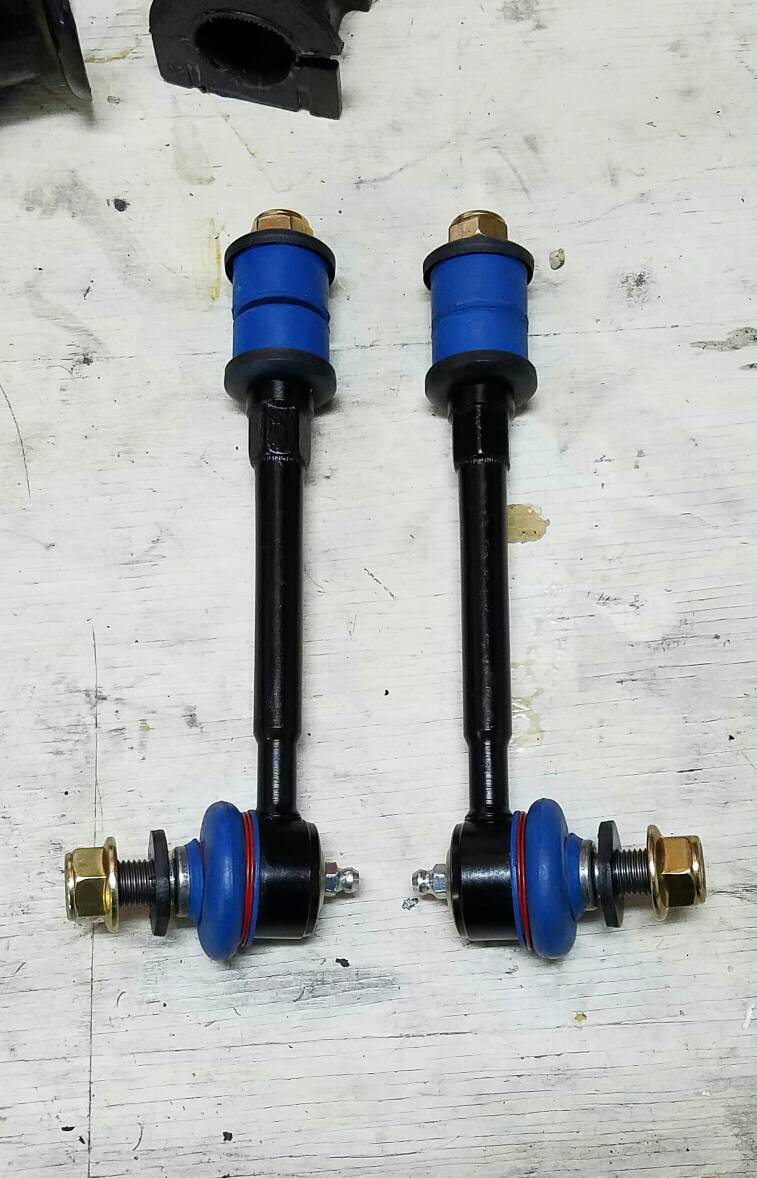

Found that one of my front end links broke. So I got some new ones off of ebay. They have the moog part number K90681 stamped on it. Kinda weird. Built pretty solid and came with a grease zerk.

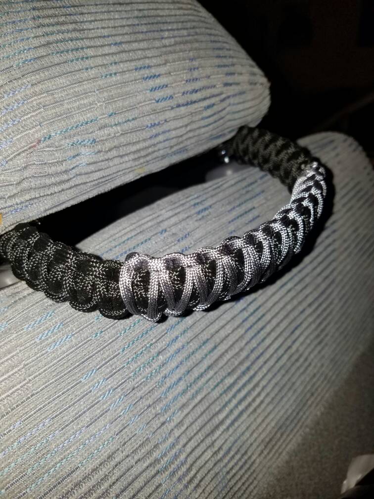

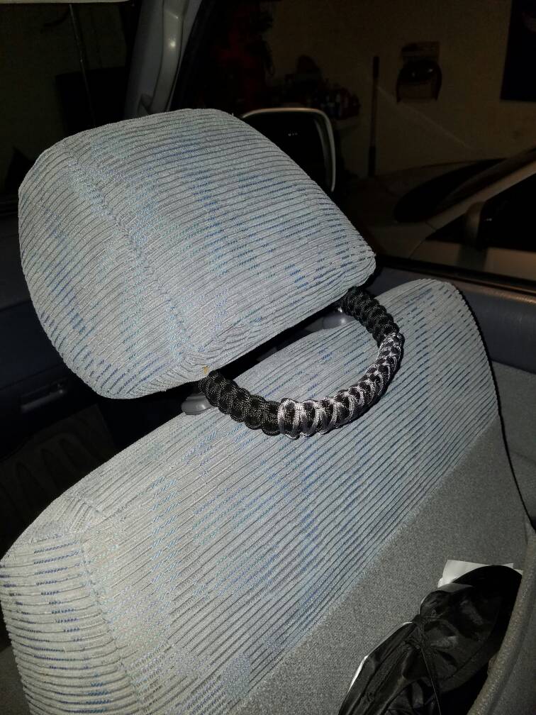

Also Got bored yesterday and finished up my paracord handles. Definitely helps the kid get in and out of her carseat.
I went with gray and black. They turned out pretty well for my first ones

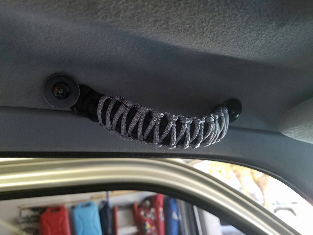

Also did the Oh shit handle for the driver side. Hate that it never came with one but also glad that the holes are there if you want to add one. Have to head to ace hardware and get some washers and bolts and then I will post pics of that one.
Here it is

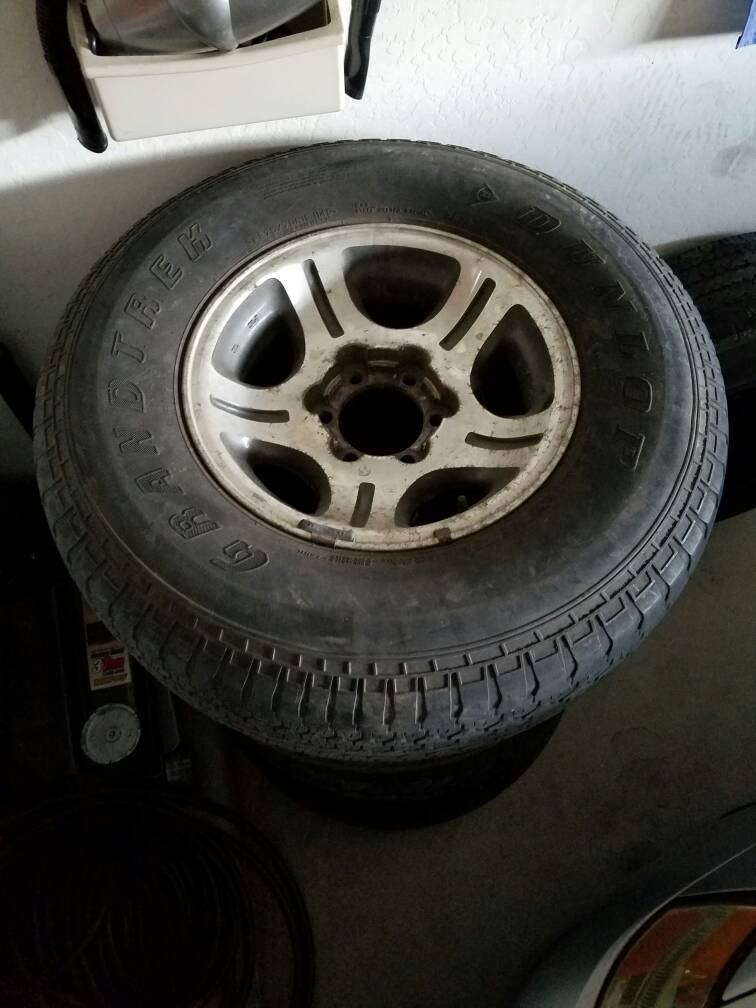

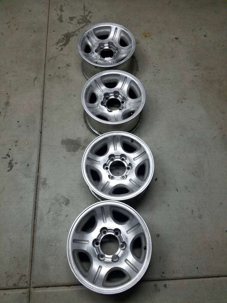

Scored 5 Lx450 rims on Craigslist last weekend! For cheap! Been looking for a while! Painting starts this weekend. Can't wait to get them on!
Sent from my SM-G935V using Tapatalk

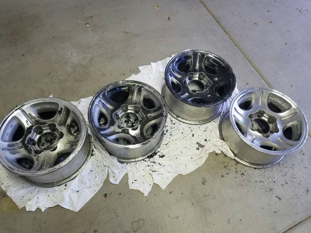

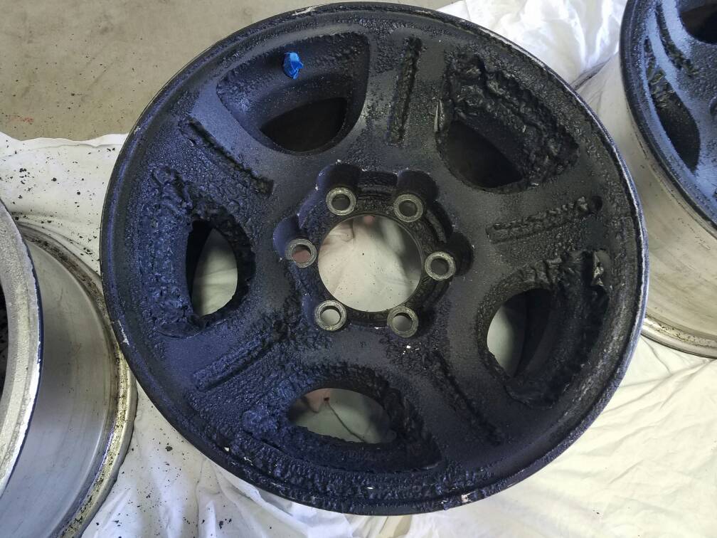

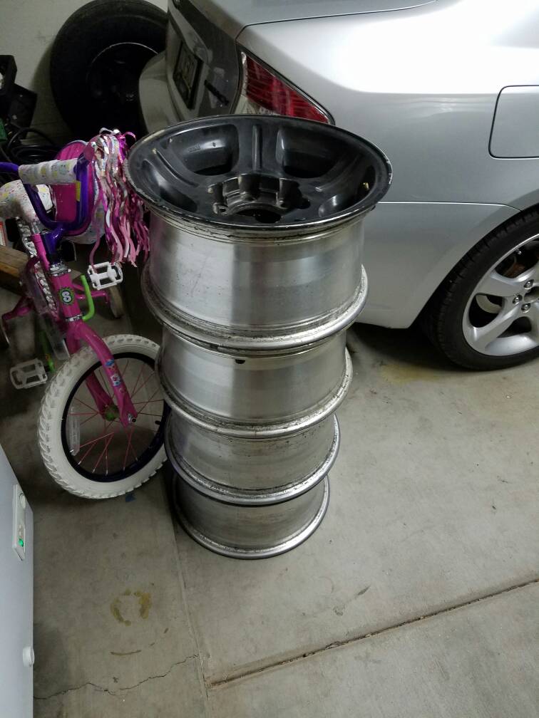

Ok. So I decided to tackle the rim painting this weekend. The first step was to get all of the old black paint off of them. When I bought them, 4 looked like this... Minus the pink bike..
And only one was factory color still. I decided to only do 4 of them because the 5th one needs a little more work and I don't have a tire for it now anyway.

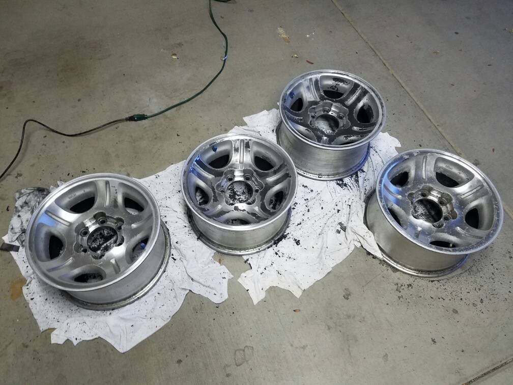

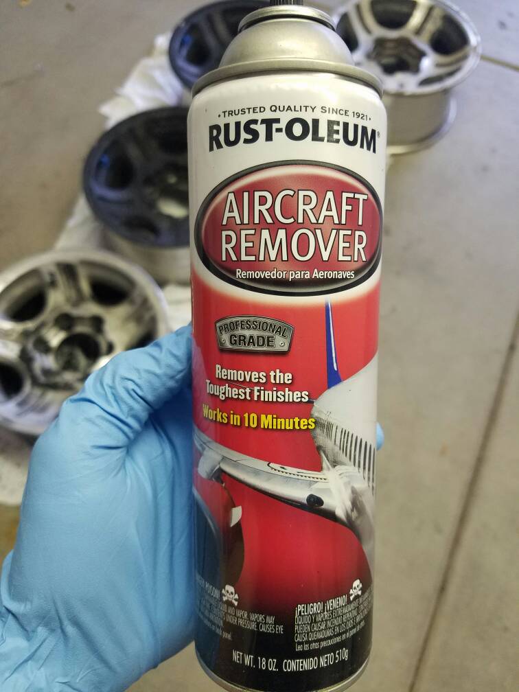

So after searching I found this stuff
Pretty cool to see it in action. I used 2 cans
After one coat and wiping it off I was left with this
After 2 coats and 3
Then I sanded down some of the rash that was on there with some 200 grit and
Used a wire wheel to get the rest of the paint off. A 3rd can of that stuff would have been good. Guy had a lot of paint on these!

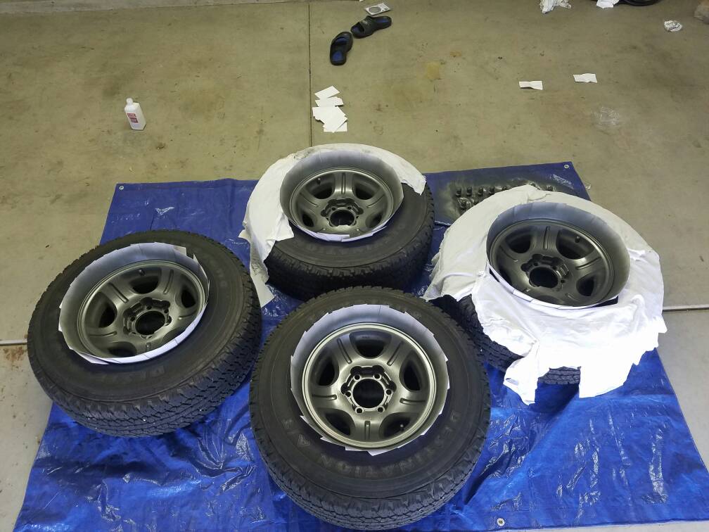

Then I went and got them mounted on my tires. Didn't want them to mess up the new paint job. Look good silver...

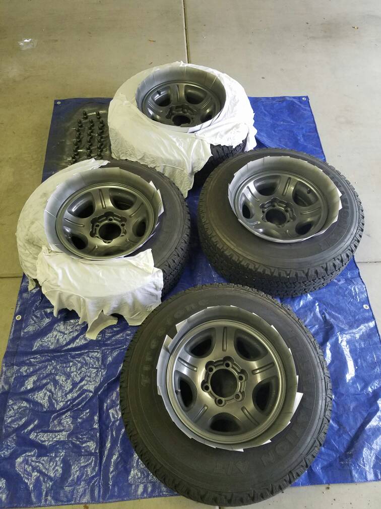

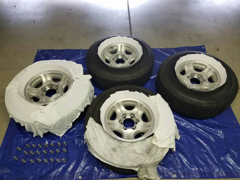

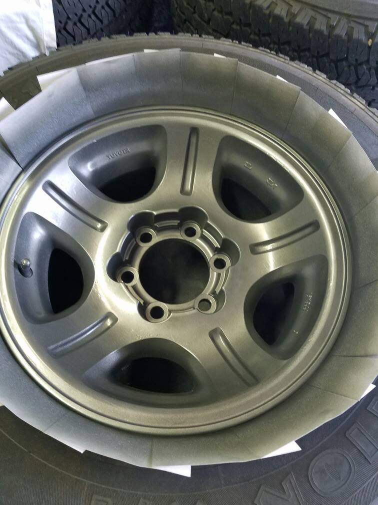

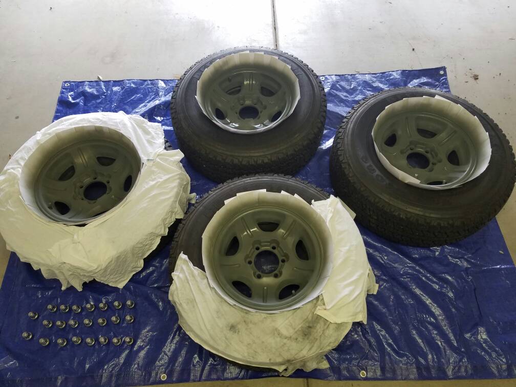

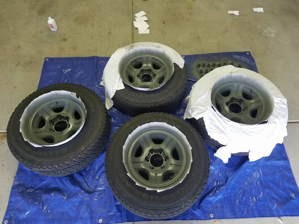

So then it was off with all the wheels and in the garage for paint. I'm sure the association loved seeing this if they drove by. It was raining outside so I had no choice.
Went with the index cards because the dollar store was out of playing cards..
Prepped the wheels with rubbing alcohol to get all finger prints and grease off
Time for paint

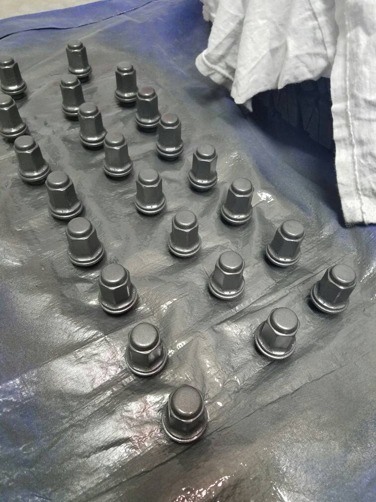

I used these three

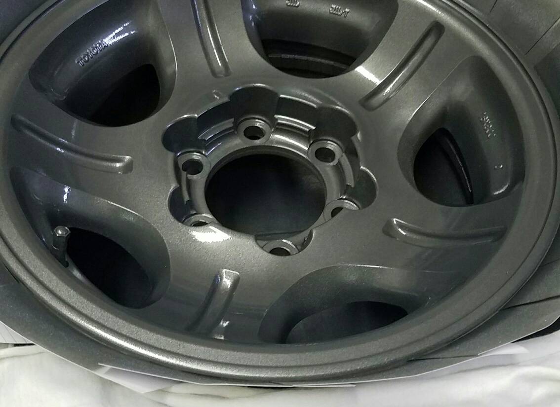

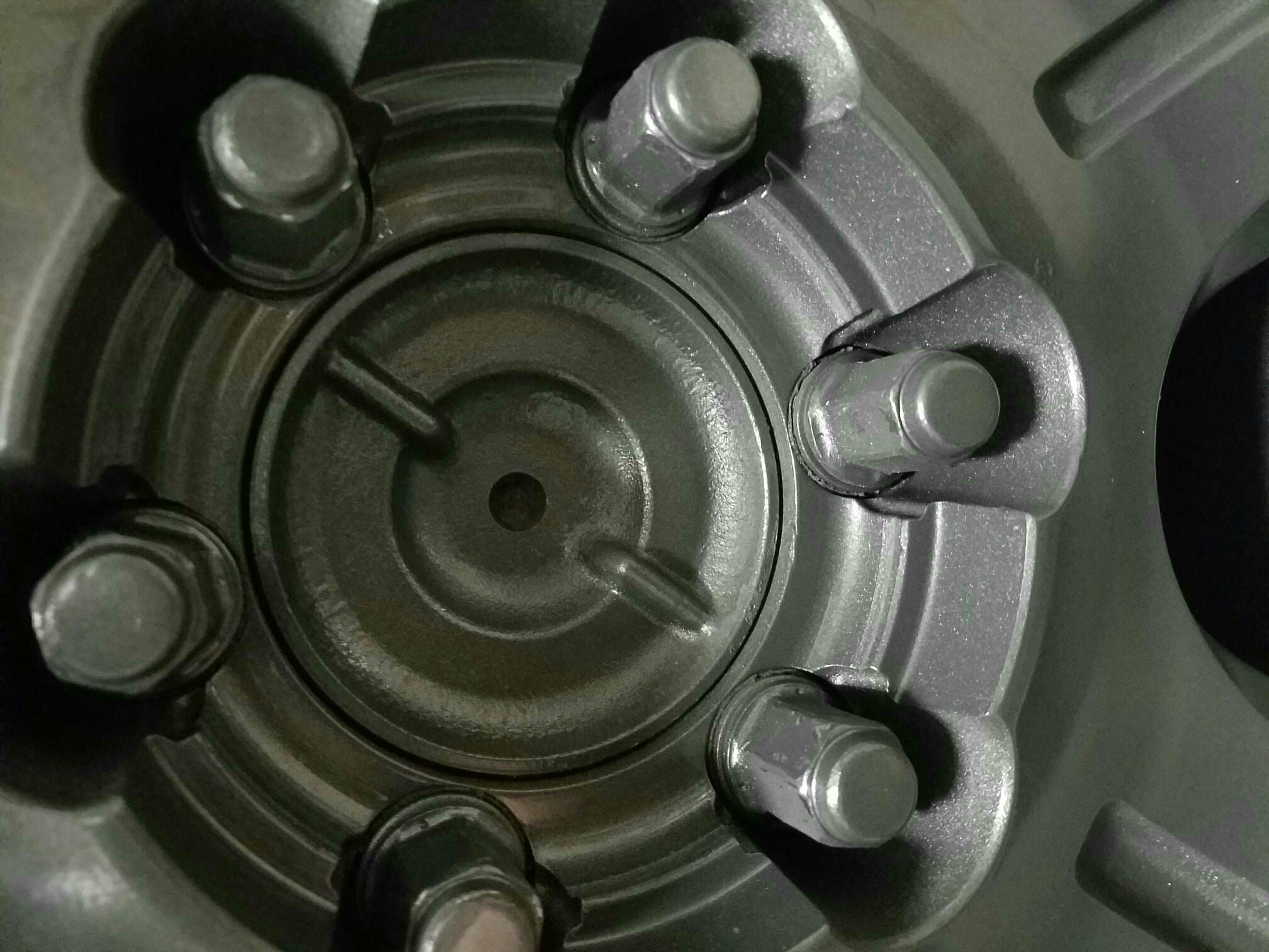

Did 3 coats of self etching primer
Then 3 coats of Rustoleum Graphite

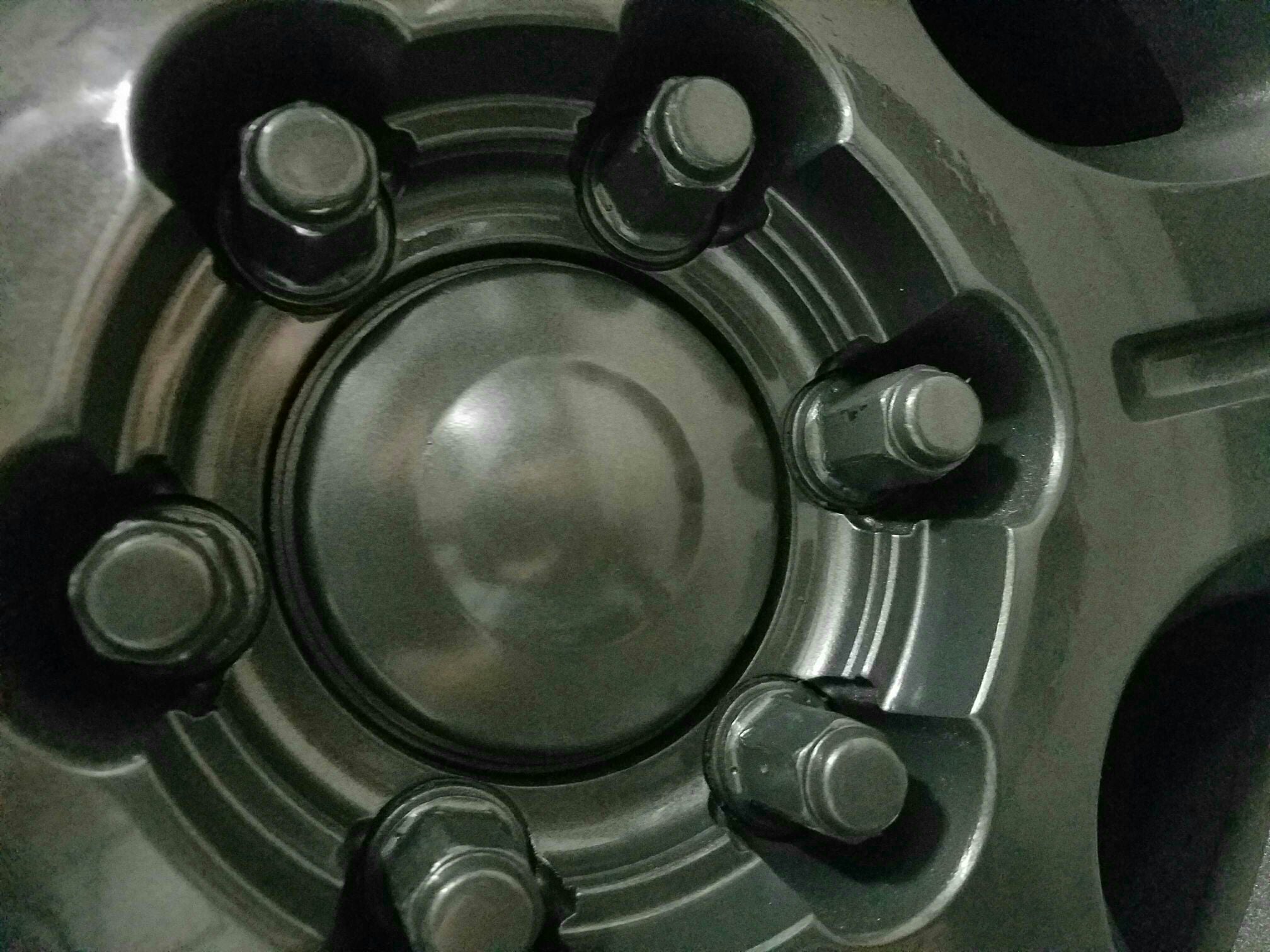

Used all the same steps on the lug nuts too
Then I used 3 coats of clear. That made the color really come out!
I also painted the hubs in front because I don't have center caps yet. Wanted it to look decent.
And the visible part of the drum in the rear
After about an hour I carefully mounted them so I could roll the rig back into the garage. Lug nuts got a little messed up. But not noticeable unless up really close. Counted on that though.

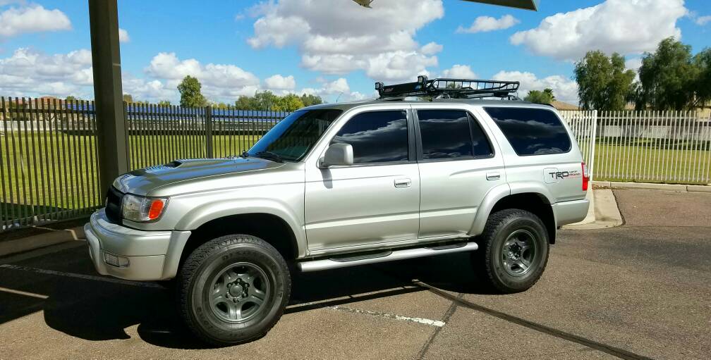

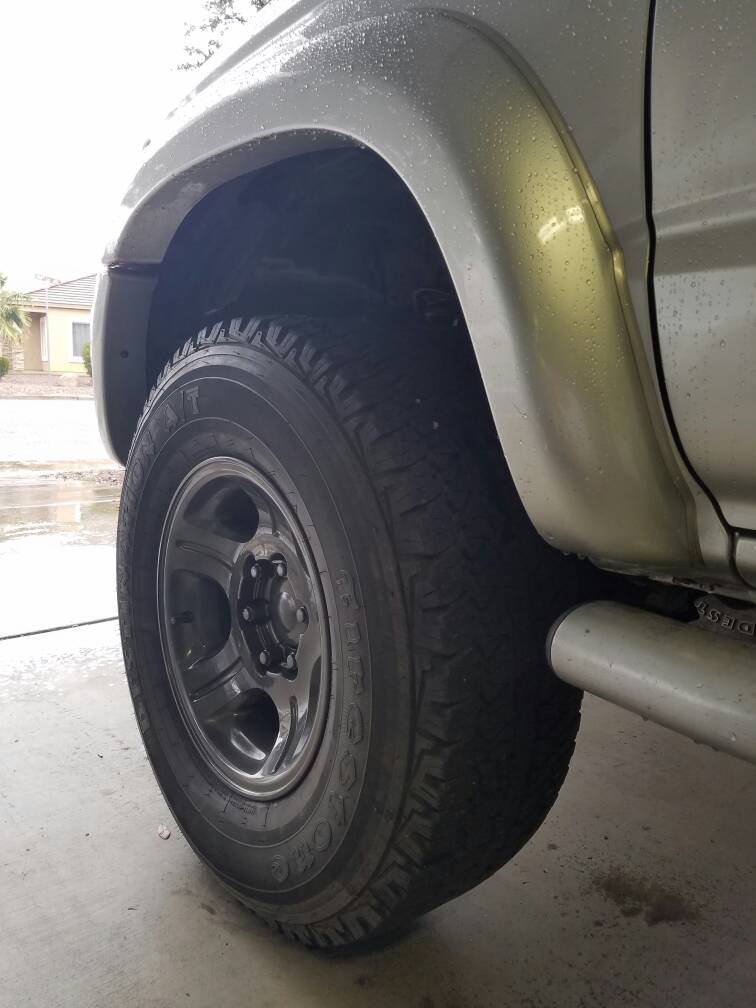

A shot of them on the rig. Its raining so I still haven't cleaned it up or the tires.
I am happy with how they turned out! Spray paint has come up since the last time I used it! Any angle spray from rustoleum is ideal for painting rims. I used 2 cans of clear, 2 cans of primer, and 2 cans of graphite. 30 dollar paint job! Obviously prep is the important part as usual but this paint makes it easy.
Once I clean it up I will post a better pic of them on there. The stance looks so much better with these rims. They sit flush with the flares now. No more skinny stance!

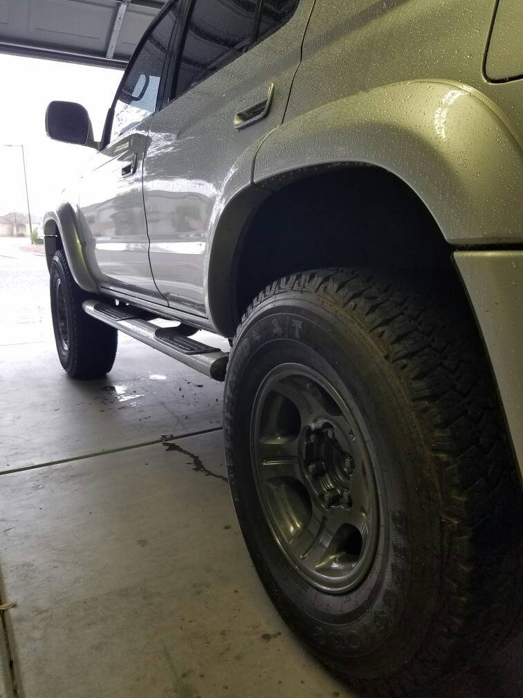

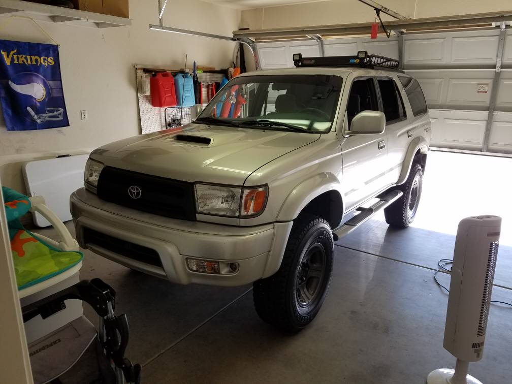

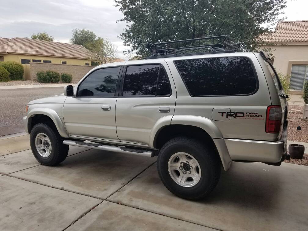

Got it all cleaned up finally
Also just received some toytec superflex Springs. So I should finally get the little bit of rake that I want.

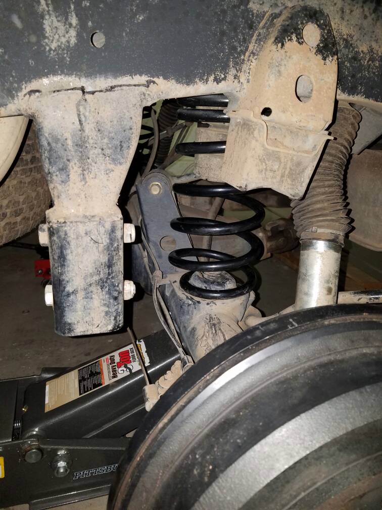

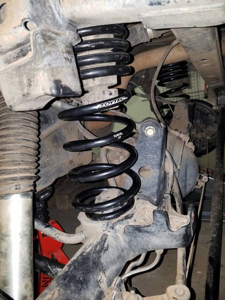

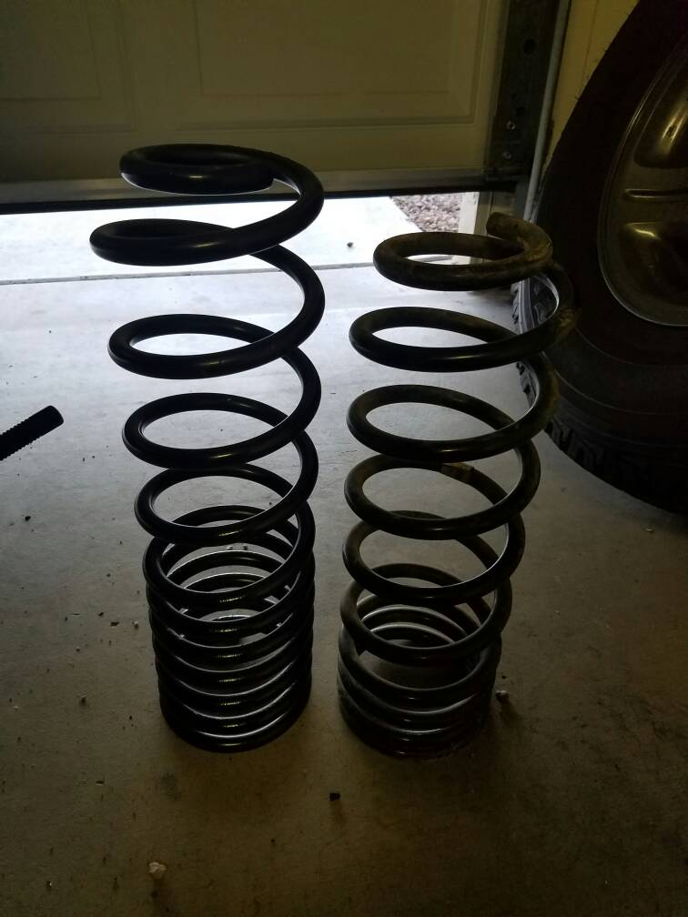

So this weekend I did the Superflex Springs. Damn those things are tall.
Compared to the 890s
And I added the trim packer on the driver side. Glad I did. Leveled it nicely.

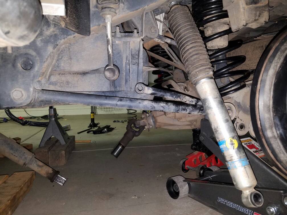

These things kicked my ass. I tried to do one side at a time. But had to disconnect the control arm to get enough room for the driver side. Big mistake
Drive shaft fell and made me nervous. Took the springs back out and got it back in. Big pain in the ass! Then re connected the control arms and just dropped the axle all the way down with Jack stands under the frame. Should have done this in the beginning. That rear trim packer didn't help matters at all. Even with the rear axle all the way down, still had to fight it.
As usual, not a lot of pictures. Sorry about that. Once I get involved, I don't stop. Here they are finally in
So it gave me about 3/4" more in the rear than the 890s. Exactly what I wanted. I now have a 1" rake in the back. Took a picture of her to compare to the other. Looks a lot better. No more saggy ass!

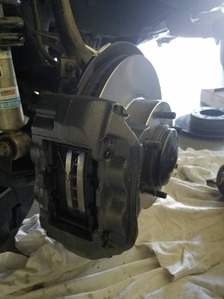

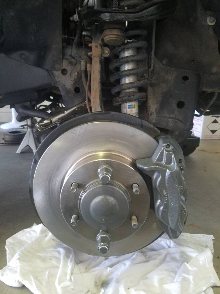

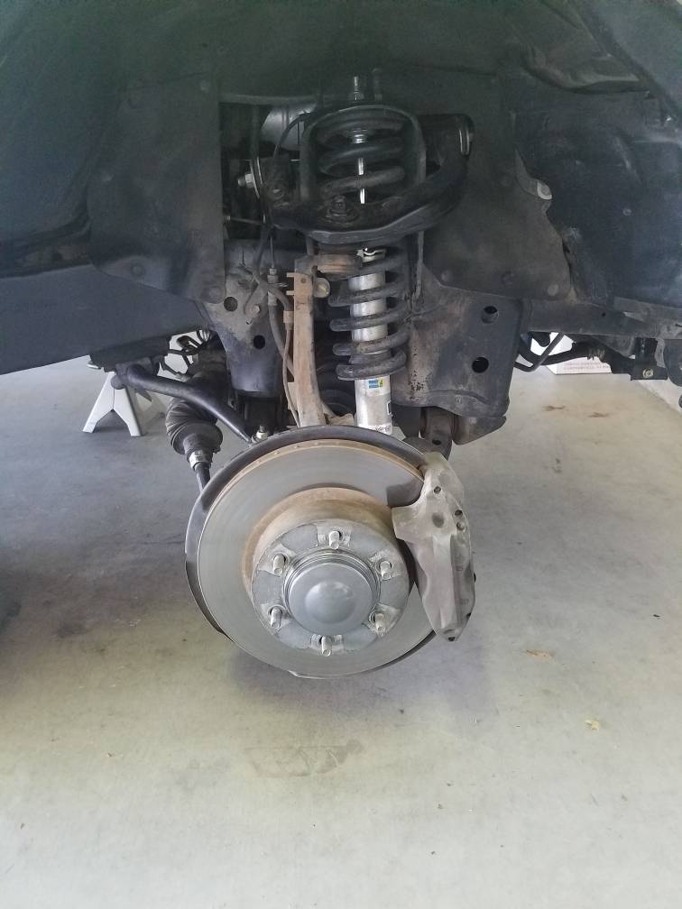

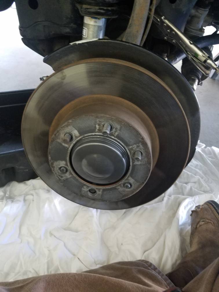

So last night I went ahead and did the Tundra Brake Upgrade 199s. There are plenty of write ups on this so I won't bore anyone with the process. But here's a good link to a write up I used
https://www.yotatech.com/forums/f2/01-tundra-brakes-installed-98-gen-3-4runner-146160/

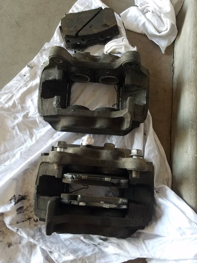

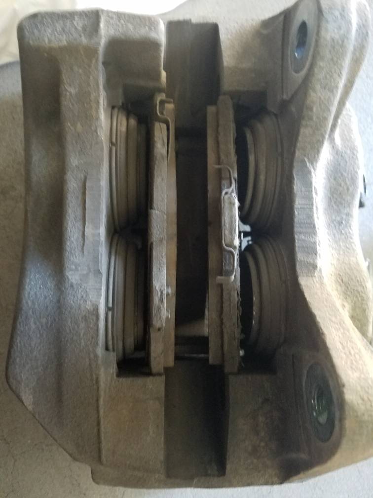

Here's what they looked like when I took the wheels off.
And then with the calipers off.
Pads were definitely a little on the low side. Other side was to the wear indicator.

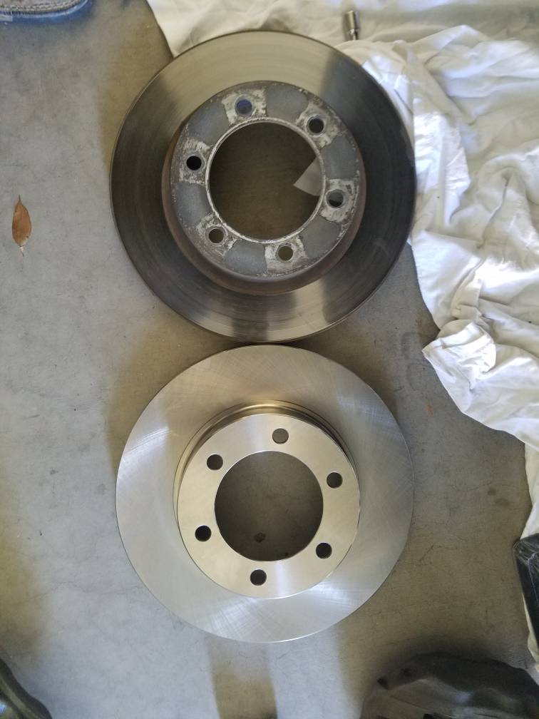

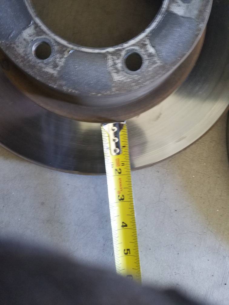

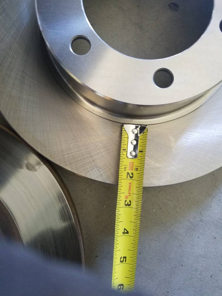

Side to side
Quick shot of the difference in brake surface

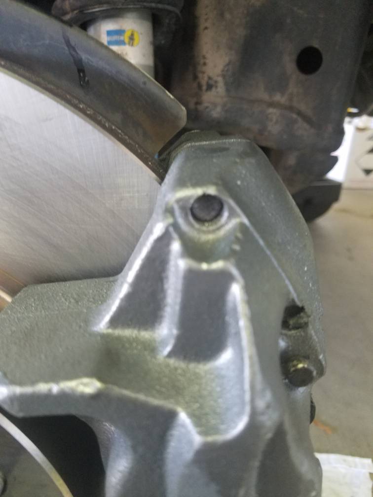

Real close to the dust shield but didn't have to trim so that's good
All mounted up and shiny new!
After mounted up I did a brake flush and was all done! I thought.

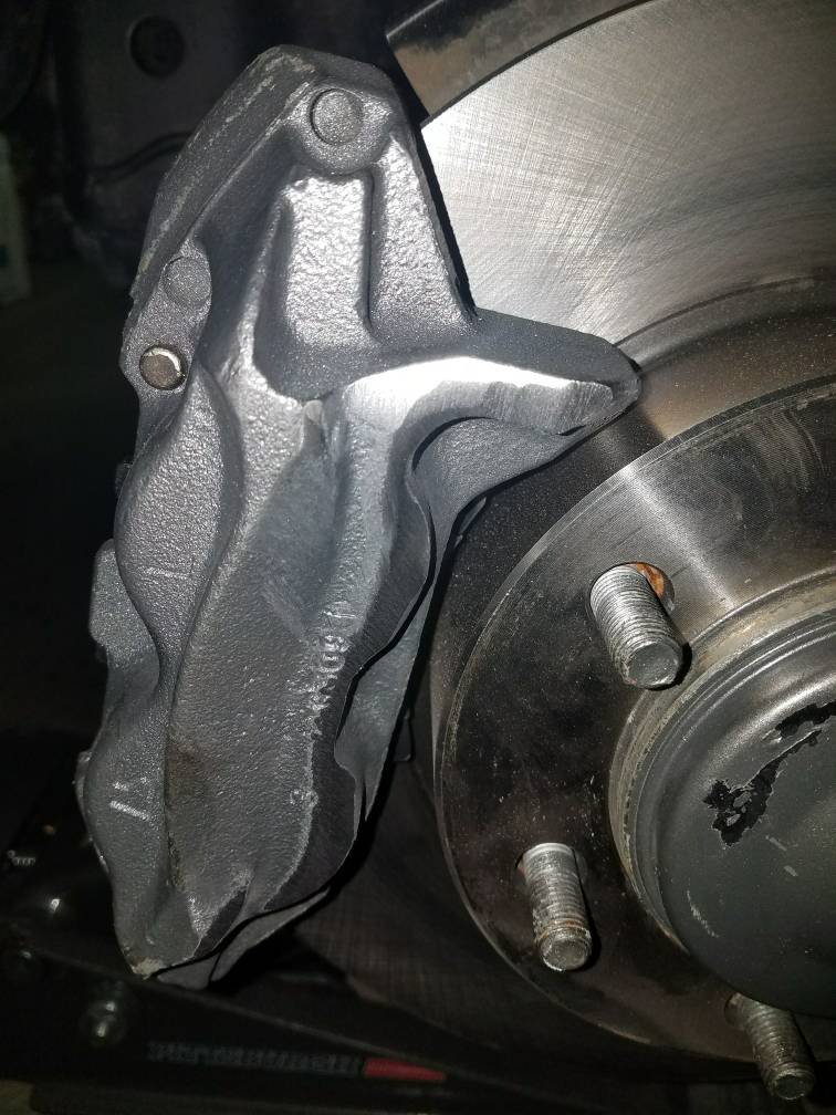

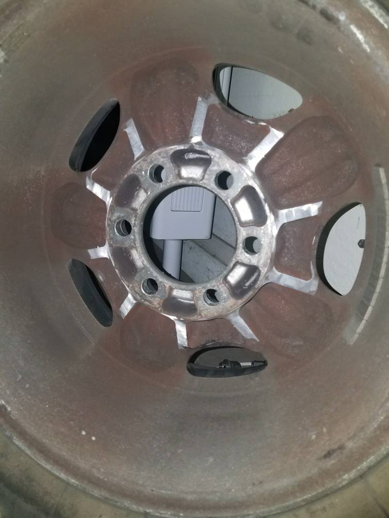

So... This process took me all of an hour to do. Everything was going smooth until I decided to put the wheels on. I knew everything was going too easy. Apparently these brakes do not clear Landcruiser or lx450 rims! They rub pretty good! After a few swear words and thinking of all the time and effort I wasted, I was not gonna go back to stock! So off to harbor freight to get a grinder and some sanding discs.
I had to grind down the back of the rims and front of the calipers. I chose to do the calipers a little more than the rims. Then threw more paint on the calipers so they don't rust.
One hour job turned into 3. But I'm glad I was able to get them to fit without too much trimming. They definitely stop a lot better and aren't as mushy as the factory ones. I'm glad I did it!

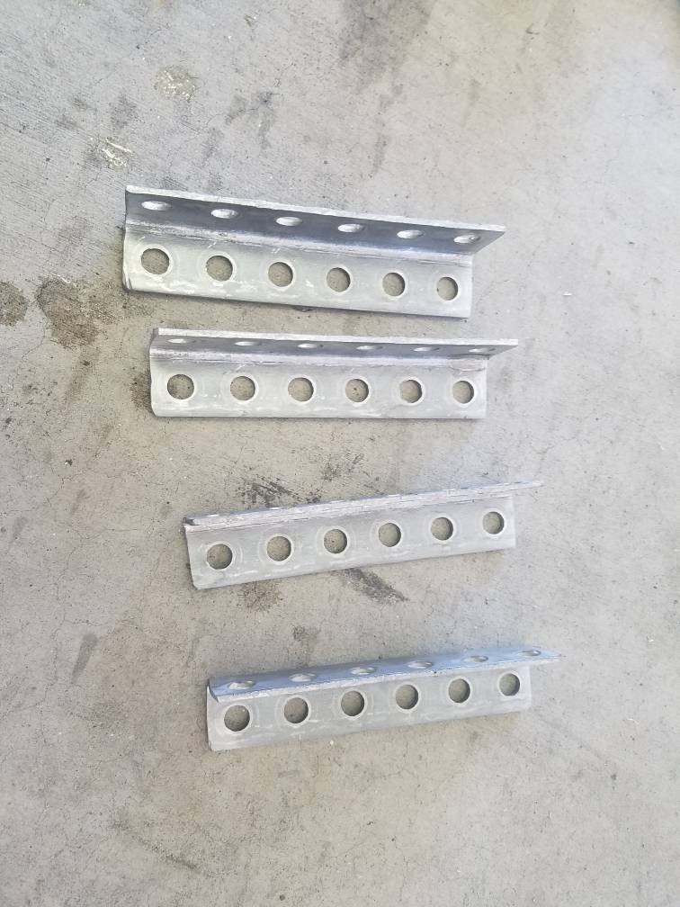

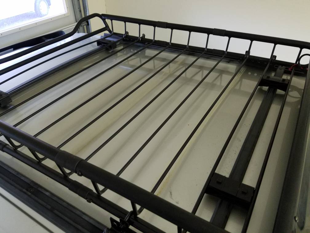

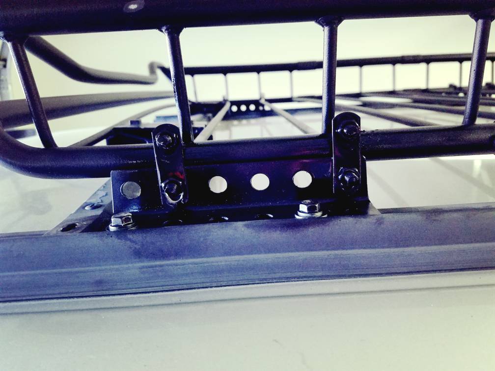

Changed the oil yesterday. And lowered my rack with some angled steel brackets and some u bolts. Seems pretty solid. Cut some 6 inch pieces of 12 gauge brackets. Mounted them in the factory cross bar locations with some M6x1.00 bolts. Painted everything black to match. Sits a lot better now. I used the pads that came with the rack and set them on the little cross bars for added support. Didn't want it resting on the roof once I add weight.
Sits a lot lower now. I like it

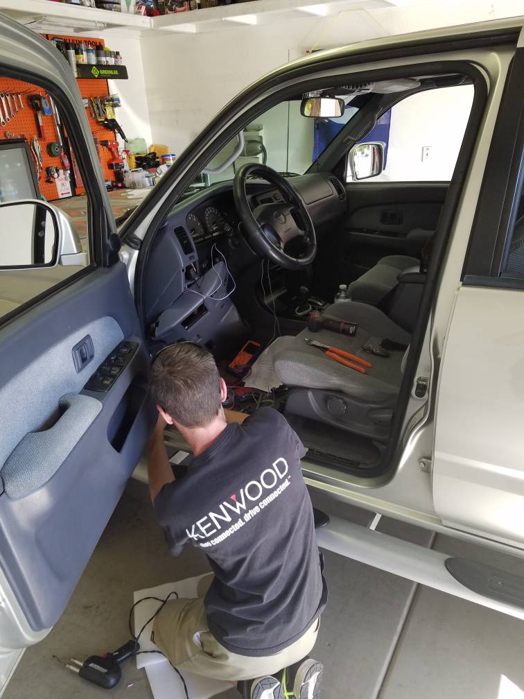

Also had the brother-in-law, who has his own business, come over and install an Avital remote start. Just the basic one. With the 2 kids and being hot as hell out, it was a good little addition. Makes the wife happy too.
