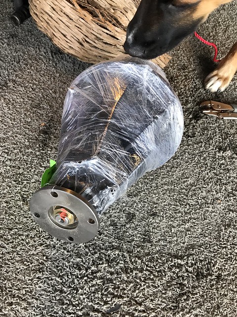

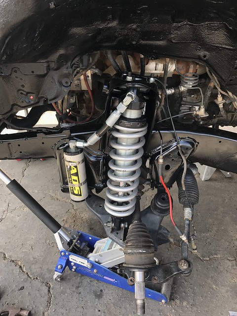

Today I got the diff pulled
Untitled by Connor Rhoades, on Flickr

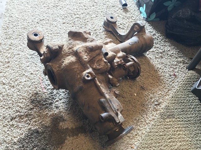

My old ADS resi mounts

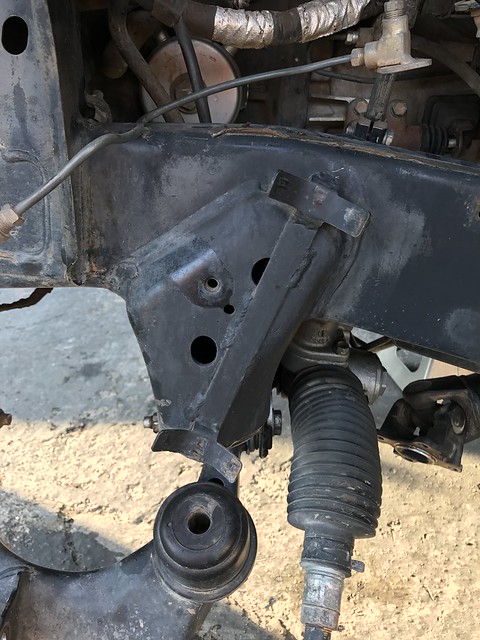

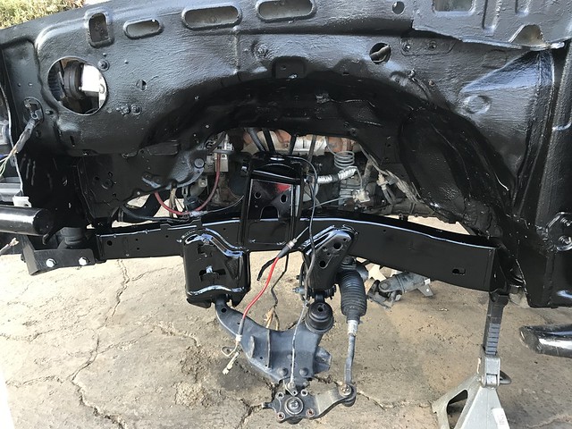

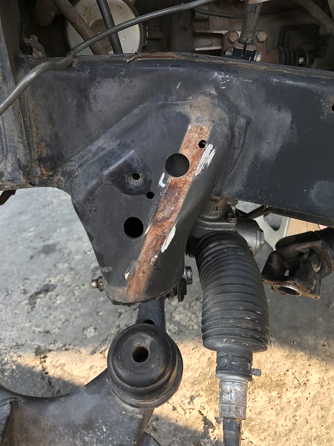

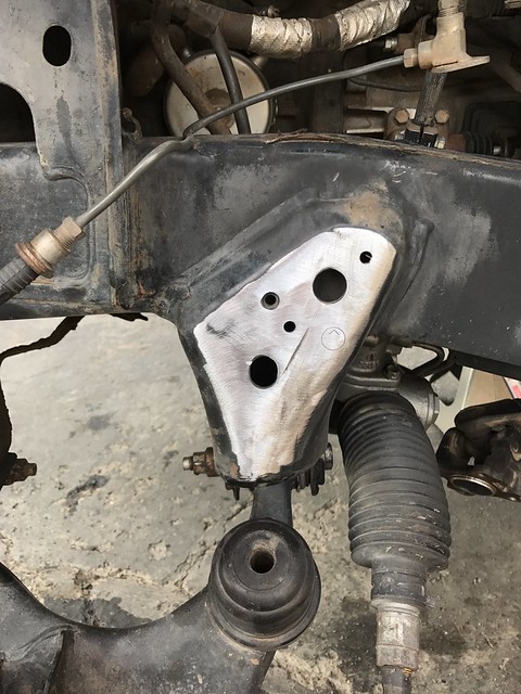

I broke a weld on the back LCA mount where the skid plate bolts up. So I ended up welding that back. Tomorrow will start the cleaning process up front, and hopefully rear end tear down. Plan is to reassemble on Sunday or maybe Monday.

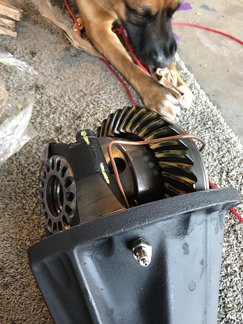

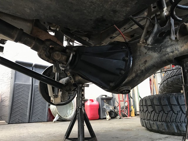

Ok well the rear teardown went down nice a smoothly. I'm lacking on the pictures but this is what was accomplished today:

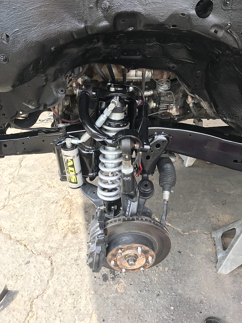

1) Front frame rails and fender liners painted gloss black

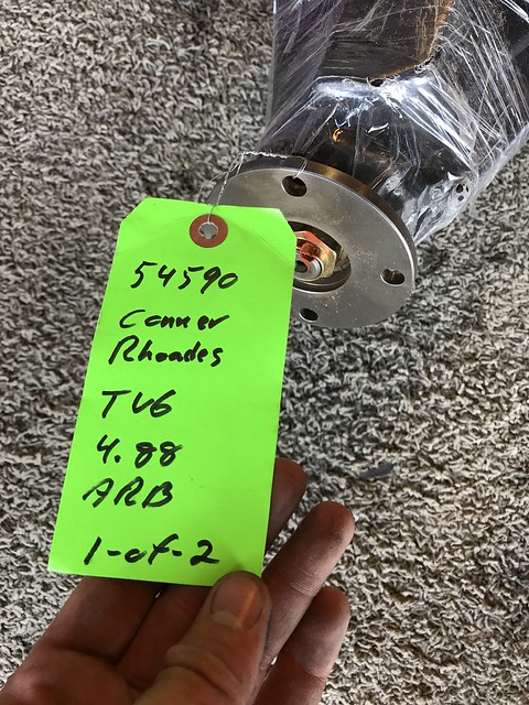

2) Installed rear diff and used Toyota FIPG to seal. Waiting 24 hours before filling with oil.
3) Installed rear axle shafts, brakes, e-brake etc. Backend is ready besides oil and tires.
4) Swapped ADD components to new diff which was a pain in the ass. **** clamshells.
5) Relocated cruise control and made a new bracket for it
6) Made a spot for my new ARB compressor in the engine bay.

Introducing the dual locked, 35's, and 4.88 powered 4Runner.

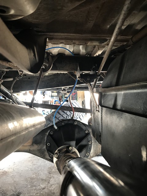

Started by plumbing the rear diff

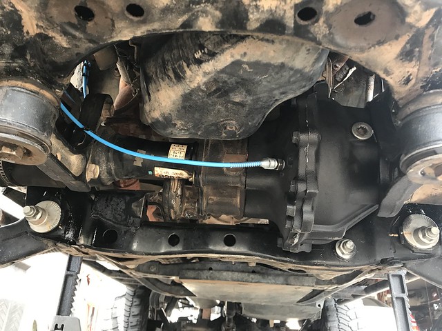

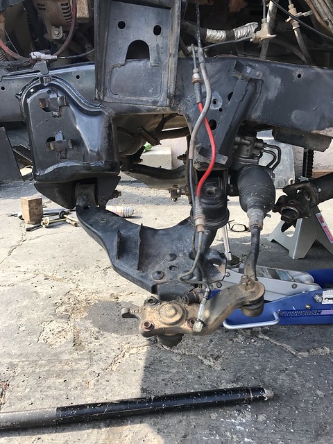

Installed the front diff (Clamshells still suck)

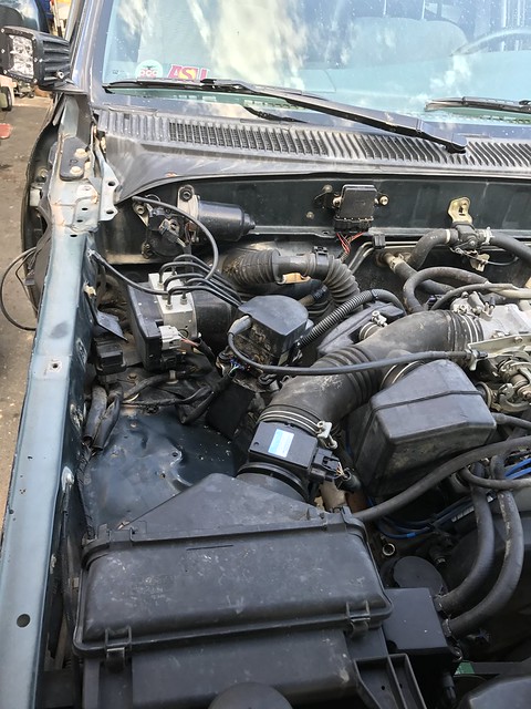

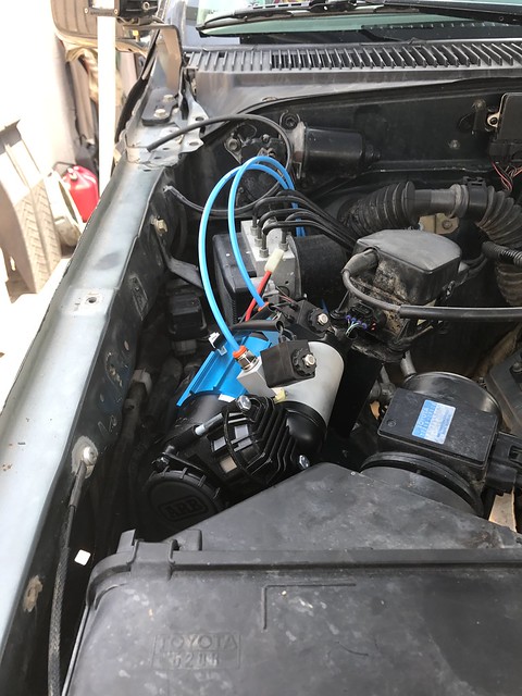

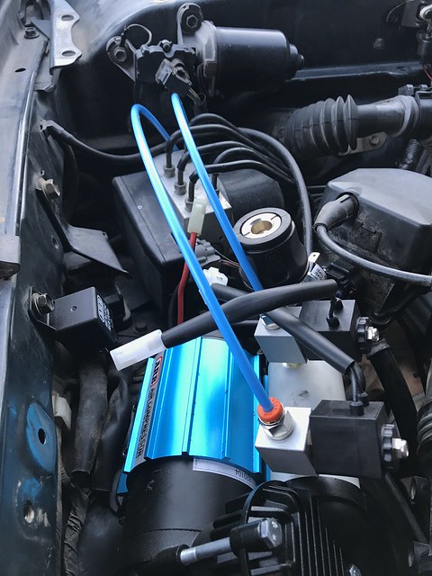

Compressor is mounted

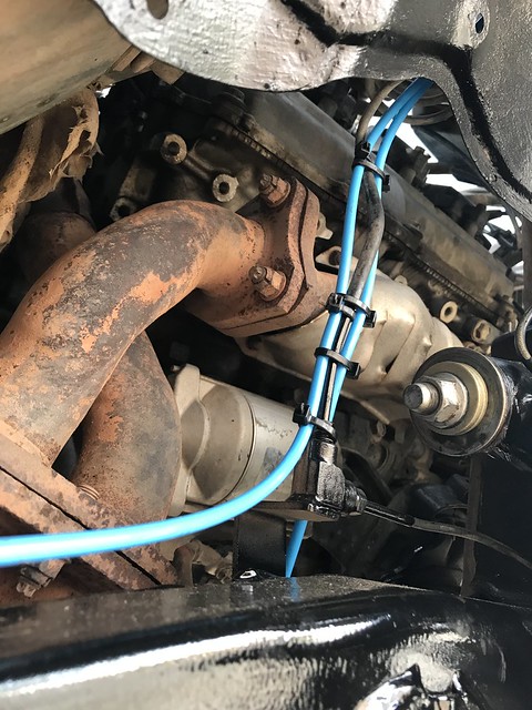

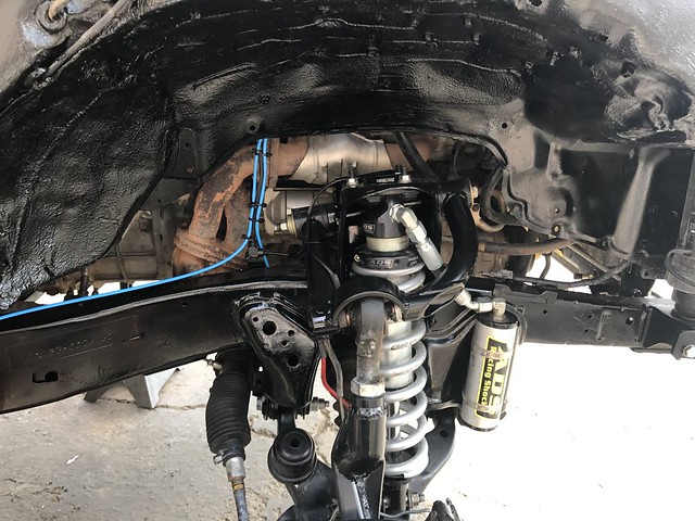

Air line routing. Tomorrow I will make a small heat shield just because.

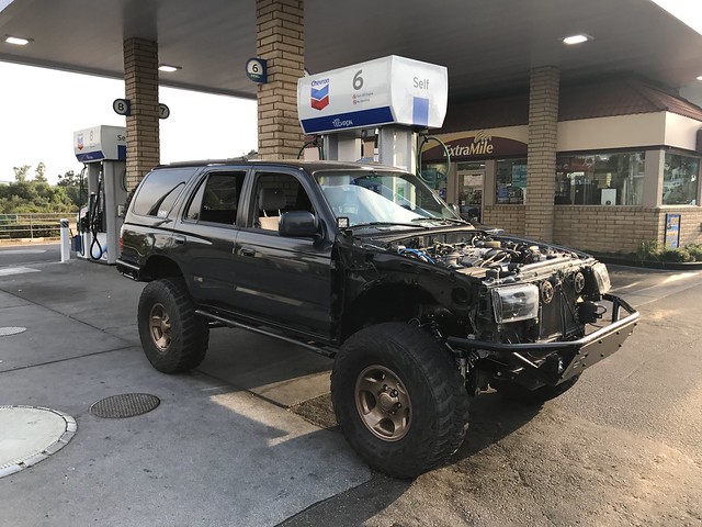

Let reassembly begin!
Money shot

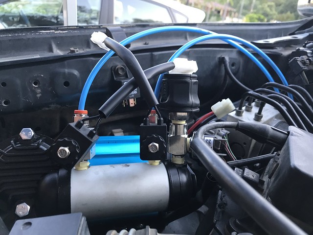

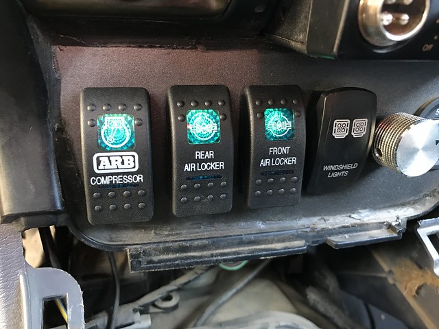

Anyways I started the wiring today. Thank you ARB first of all, because it turns out you need the ARB tire fill up kit in order to run 2 lockers. The pressure switch will not screw in with both locker solenoids on the tank. So I went and got one of those

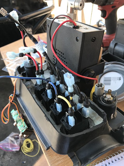

Then the fun began
OHHH YAAAA
Just need to wire the engine bay side now, hopefully finish tomorrow and verify that my wiring works and the lockers work. Then heat shield and fender liners.

The compressor tank/pressure switch location can be rotated to allow the pressure switch and 2 solenoids to fit- although I wouldn't mind having the tire inflator on mine...
It's all 1/4 NPT thread so just go to the hardware store and get a nipple, tee, and 1/4 male thread disconnect. I made one up for mine for about 10 bucks.
I couldn't find a T anywhere, and the inflation kit was less than $40, so **** it
Wiring worked first try! Both Diffs work perfectly and fast too! I just need to find a way to completely seal the ****ing air compressor fittings so they stop leaking. Still need to put everything back together too! Overall very happy!
Teflon tape? Glad everything is working!
Nope, still getting leaks. I ordered teflon paste this time and I'm praying that it stops it completely. I had this same problem on my last one.
Two wraps of teflon tape, then pipe dope, then two wraps of teflon tape. Do not overtighten anything. My ARB compressor holds it's pressure for weeks. When I flip the rocker in never kicks on. I have to release some air to make sure it's working. lol
Oh ya? So basically a pipe dope sandwich? Tape x2, pipe dope, tape x2, tighten until snug?
Quick and dirty heat shield for the air lines. Hopefully do the splash guards this weekend and call it done!
