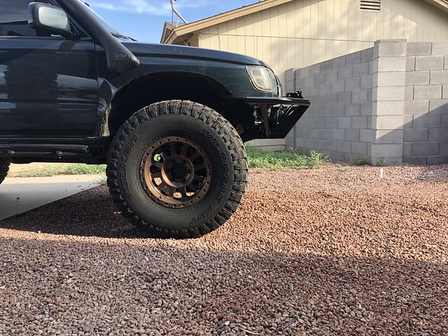

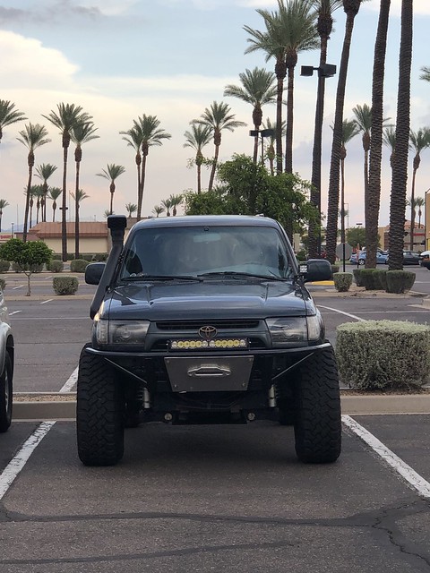

Bumper looks good bud! High clearance is the name of the game now.

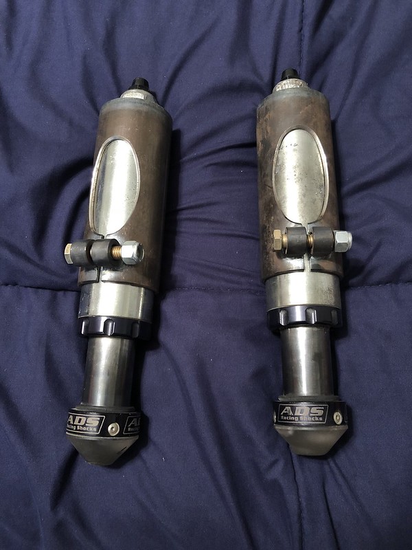

I want to build an ultra4, damn. I'll be dissapointed if you use anything less than a King 4.5 body 26" travel 6 tube bypass on the rear.
Hey Connor, I just spent a good amount of my spare time over the the last week going over your build. For someone who isn’t very knowledgeable about these things but is interested it was incredibly informative and enjoyable to read. I really appreciate the time you took to detail and photograph so many aspects of this build, it will really help me while I tackle my own.
Excuse me while I wipe the drool off my keyboard. She looks soooo good. Excited to see it in the rocks. The approach angle on yours and [MENTION=82211]TCMach[/MENTION] make me wanna rebuild mine....

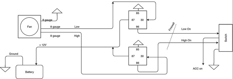

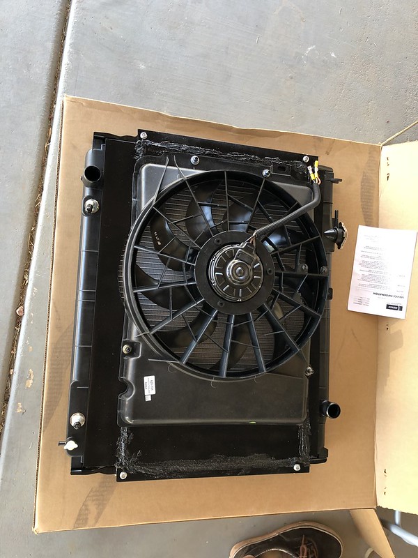

Been having some overheating issues with my short radiator and 2" body lift. This is causing the engine fan to not pull air through the radiator.
So I had to go electric. This way I'm pulling air through the radiator.
Parts List:
-Denso 221-3137 from Napa.
https://www.napaonline.com/en/p/DEO2213137
Has a 7/8" thick core, and only 18.75" tall. This is a 1/4" thicker than the auto zone POS I was running before.
-2 Relay's
https://www.amazon.com/gp/product/B00RWVLMI4/ref=oh_aui_detailpage_o03_s00?ie=UTF8&psc=1
- Dorman 620-101 Ford Taurus Fan (2-speed)
https://www.amazon.com/gp/product/B000C14FTO/ref=oh_aui_detailpage_o04_s00?ie=UTF8&psc=1
-OTRATTW Switch #V6D1D66B
https://www.otrattw.net/V-SERIES-SEALED-ROCKER-SWITCH-BODY-ONLY-NO-ROCKER-V6D1D.html

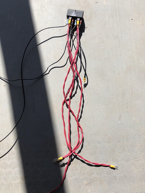

Wiring Diagram
Screen Shot 2018-09-09 at 9.48.32 PM by Connor Rhoades, on Flickr
Octopus

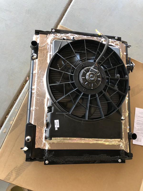

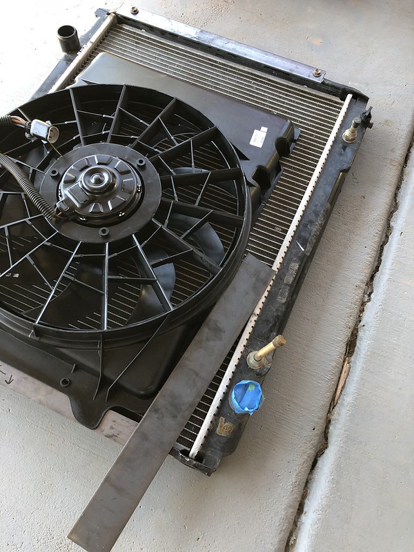

Build a Shroud
Untitled by Connor Rhoades, on Flickr
Shroud Painted
Seal it with some Aluminum Foil Tape

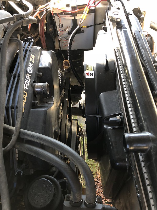

Clearance Check
Tight, but works

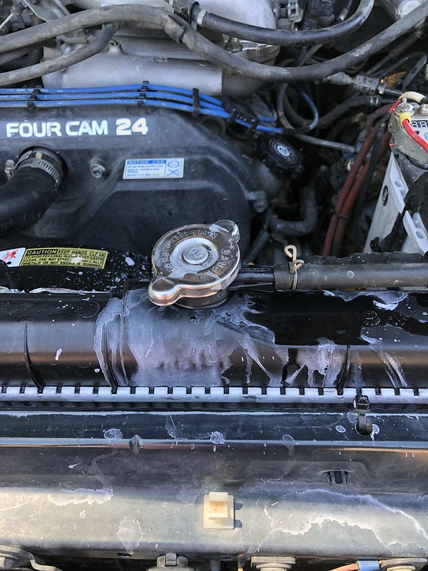

Anyways, it all works. I'm back to idling around 184 around town. Put I can't get a stupid radiator cap to stay on this thing.
This was after a quick highway drive:
So I ordered one through the dealer to see if theres are any better.

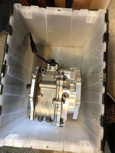

Also picked these up for the front end
