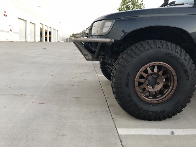

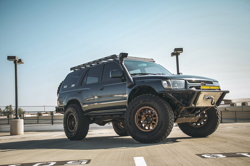

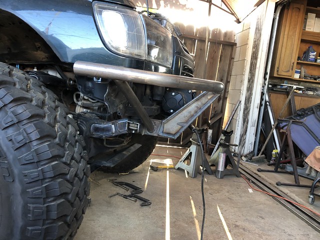

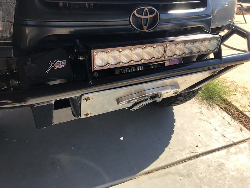

New bumper is awesome! I like how tight it is and the approach angle it provides.
Super jealous of the hydro bumps for the front. I've wanted to do that for so long, they're just expensive!
Hopefully LT and bumps go on at the same time. It was a craigslist deal, $200 for the set hahahaha

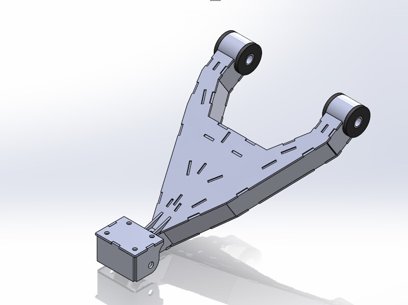

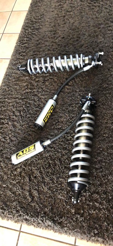

So tell us a bit about this LT kit you’re going to fab. Same version you’re making for the race truck? Uniball conversion instead of LBJ? Adjustable heimed uppers or bushings? Boxed or tubed upper arms?
Boxed lower with horizontal uniball welded to arm. Adapter plate in place of LBJ that then gets gussets and welded to the spindle. (No 4-bolt failure possible). Adjustable, tube (1.5" .120 wall), heimed uppers.

Also I'm going long travel soon

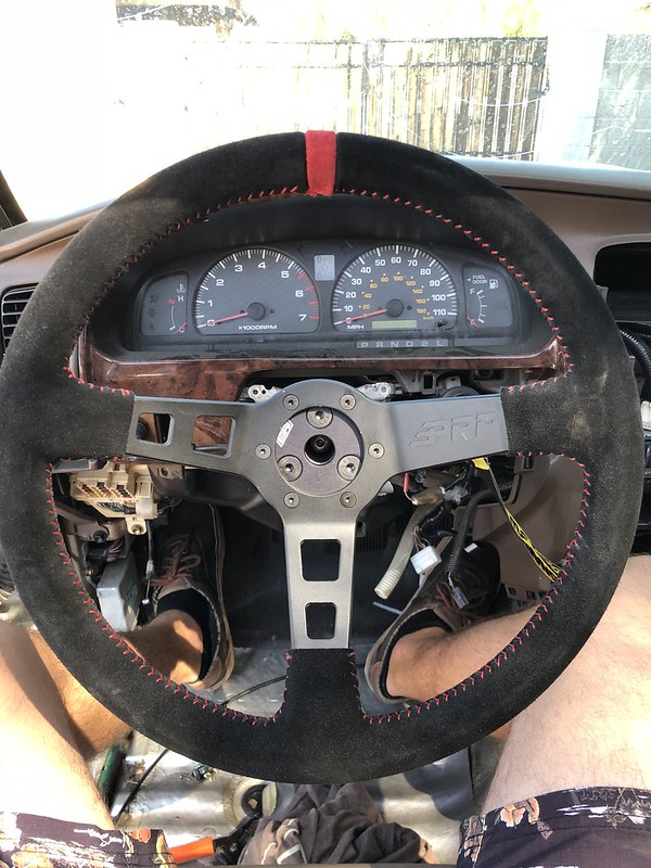

Thinking about installing a steering wheel like this on my truck too. But need to figure out how to keep cruise control

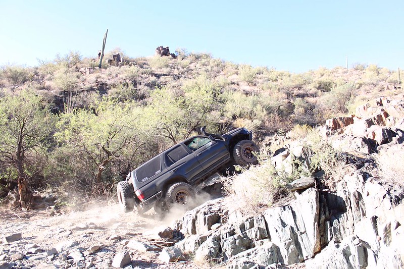

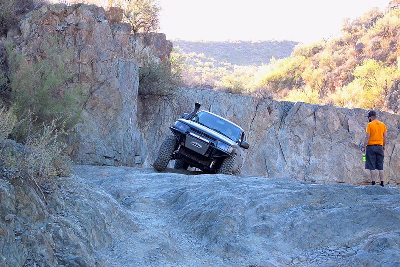

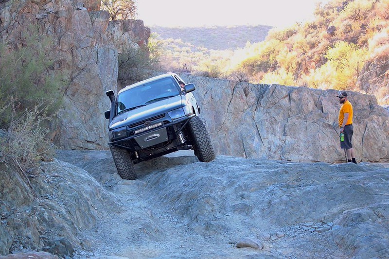

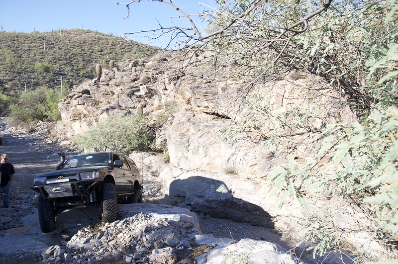

Wheeling Pics
image by Connor Rhoades, on Flickr
image 2 by Connor Rhoades, on Flickr
image 3 by Connor Rhoades, on Flickr
image 4 by Connor Rhoades, on Flickr
I like this one
image 7 by Connor Rhoades, on Flickr
image 5 by Connor Rhoades, on Flickr
image 6 by Connor Rhoades, on Flickr

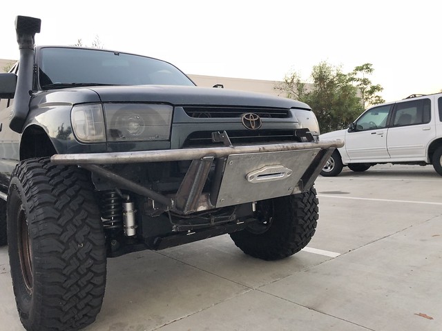

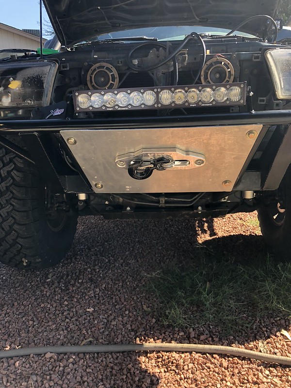

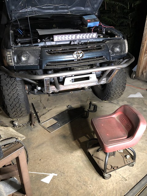

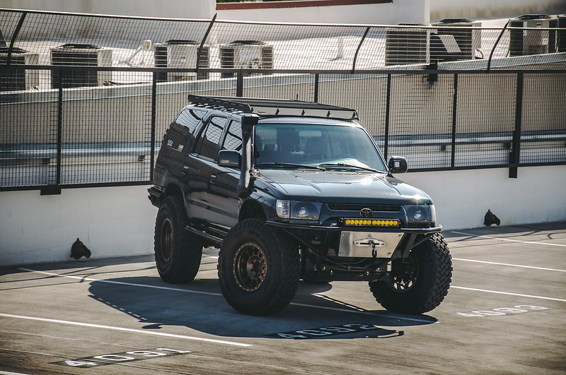

Finally installed my winch too. 9500lb Smitty with Synthetic line
Untitled by Connor Rhoades, on Flickr
Also RIP headlights
