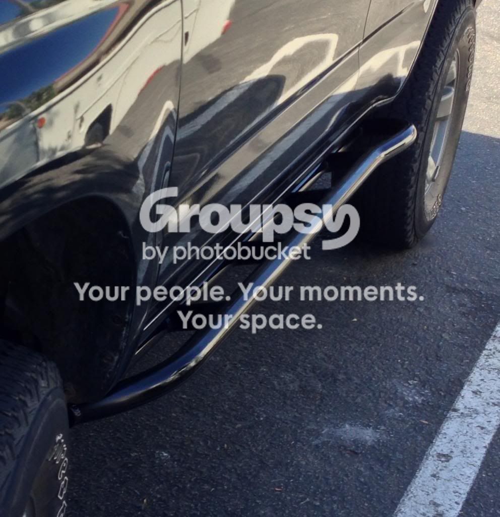

Yes they are:
Replaced the Starter contacts, it was actually really easy to do, even by myself. That seems to have solved my starting issues, but we'll see in the morning. Cold starts are the worst.
Pictures later
I drove 2 hours each way to pick these up (Yes it came with another one)
Primer (Yes my garage is nearly as bad as [MENTION=25058]ChildrenOfBodom[/MENTION]
First Coat (Porsche under the car cover)
Looked just like my sliders when I had mine installed not too long ago.. love the work they do over there@savage... wish I could say I was as happy with the" work" they did over at Perkins but I'm over it now..
