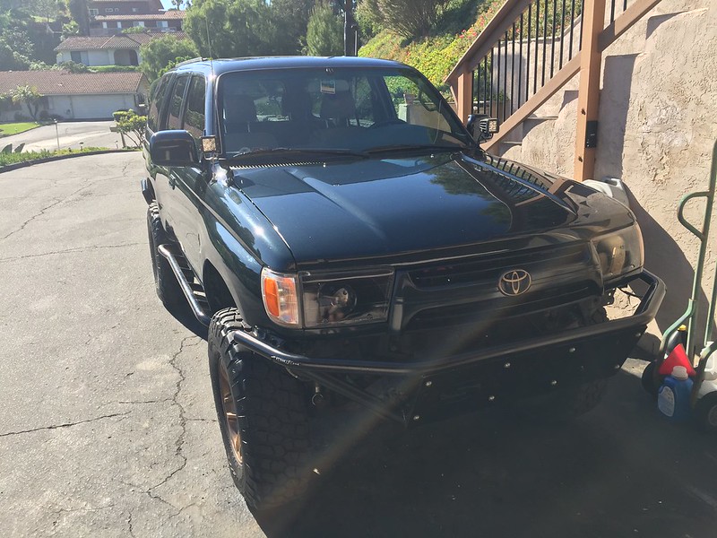

Bought ADS 4" Air Bump Stops and installed my rear extended brake line. Also polished the crap out of paint today. Used a Griots Random Orbital and Chemical guys cutting compound followed by their finishing polish, and last a nice coat of wax. Man does it look good now. I'd take photos but my truck looks retarded without front coilovers.
Edit: Here's a photo before I washed and waxed it. Sitting on bumpstops, absolutely 0 rub.

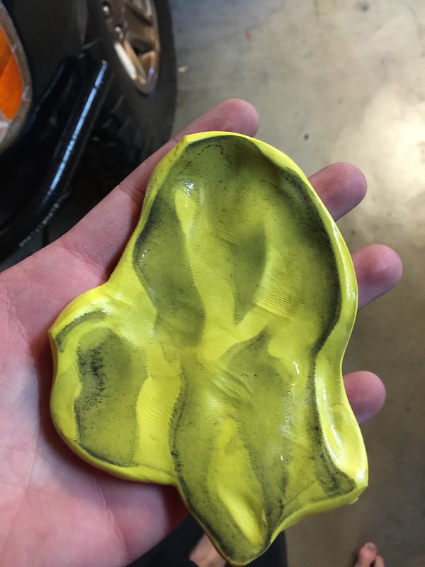

I guess that clay bar might be done for. Wow.

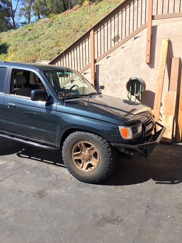

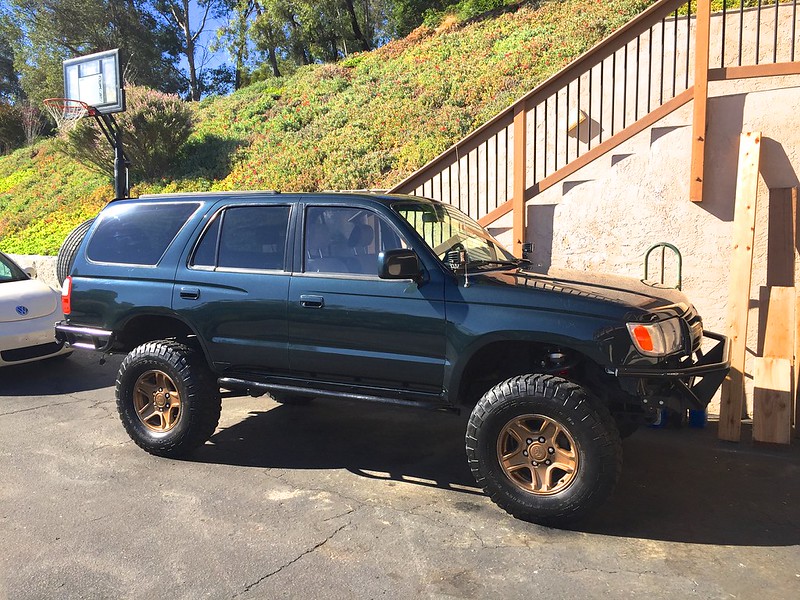

Alright Final Spring Break Update:
Crappy iPhone photos for now. I'll get it out tomorrow and take some real pictures maybe.
IMG_4424 by 4Running Daily, on FlickrIMG_4428 by 4Running Daily, on Flickr

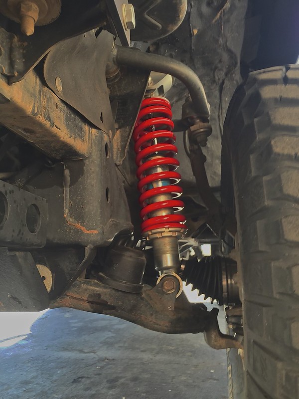

So I finished replacing the upper and lower bushings on the Toytec Coilovers. What a PITA. I still have no idea why I had to replace these damn things after only 20k miles. Certainly don't recommend Toytec coilovers. The bushings were harder to find. Toytec only had 2 in stock so I ended up calling Bilstein and went down to there warehouse which was luckily close to me. Quick work with a press and some grease and I was good to go.
However, while installing the coilovers, I noticed my CV boot on the driver side was severely torn. So this morning I went ahead and swapped my spare CV in. Not too bad of a job. While I was down there with the skid removed, I figured I would go ahead and change the Front Diff fluid. So I did that too.
Here's a photo of the clean coilover, and new CV.
IMG_4432 by 4Running Daily, on Flickr

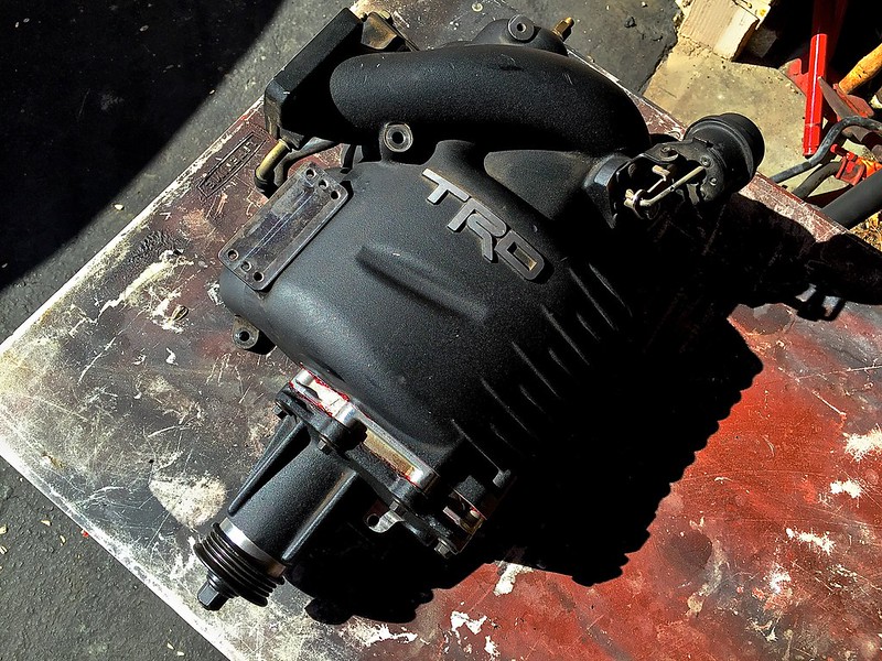

Sadly I was too busy and sick to even attempt to rebuild the supercharger. So I called up a friend of mine at DynoTech Motorsports (DynoTech Motorsports), and dropped the supercharger and parts off with him. $120 later I had a completely rebuilt supercharger.
Total Investement in Supercharger
$550 Purchase Price
$120 Rebuild Parts
$120 Labor to Rebuild
Total Investment= $790
IMG_4423 by 4Running Daily, on Flickr

Was not a homie hook up deal. He did everything. Needle bearings, rotor bearings, oil, coupler, and the seal. Truthfully yours might be less considering mine was the first he's done.
Here are the rebuild parts:
Needle Bearings: Eaton supercharger Cup Style Case INA Needle Bearing F390978 FC65477 M90 M112 | eBay
Rest of the Parts: Rolling Performance Home
That's awesome.. A friend of mine had magnuson or whatever rebuild his about 500 miles ago for around $800. When I pulled the supercharger (he's selling his 5vz swapped pickup for a tacoma) it was already leaking oil... Quite a bit of it.
Ya James (Children of Bodom) recommended Magnuson to me, that's who rebuilt his, but the rebuild would be more than I paid for the unit haha. If you ever want your supercharger rebuilt, feel free to ship it to my house and I'll have DynoTech rebuild it and then I'll ship it back to you.
