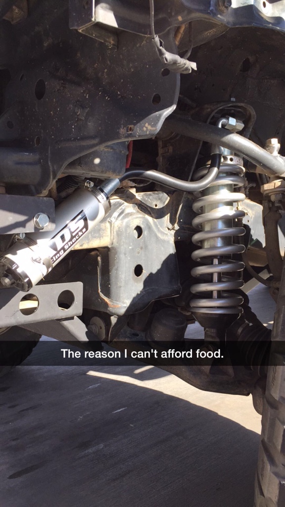

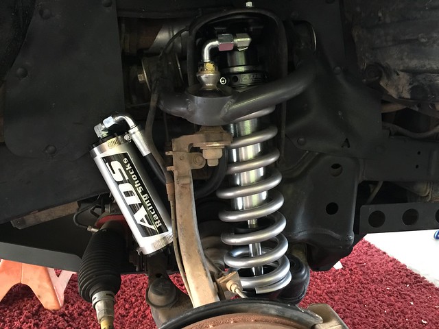

So there was some error in the building of the shocks.
The length from the top hat to the center of the eye-mount measures in at 21.25" on mine.
According to ADS, it should be 19.837”. That's 1.4" of difference, which should be enough to make it fit. Also, according to ADS, the shock body itself with a coil on it nets 5.087” of travel.

So what're they saying, you have the wrong shock but just go with it? :confused:
Also I would make sure you get limit straps sooner than later since you can get 2 for $40, you don't want the shock bottoming out if it happens often (though obviously you know this!). Pretty sure that's how my 5100 got ripped in half is from going to full droop too often and the shock being the limiter.

No haha. What I'm saying is I have the wrong shock and I'm going to send these back and they will send me correct ones

That sucks, at least they're fixing it! Does this explain the shorter than expected build time? Like they incorrectly measured a shock and thought it was the right one sitting on the shelf and sent it out? Do you still have to wait another 2 weeks?

No idea, it shouldn't be a 2 week build time this time, but it's still a pretty shitty situation. Instead of calling me directly, they just send emails... It's a very slow process. I have a guy waiting to buy my Toytec's and originally he was gonna get them last Friday, but now he won't even have them this Friday.
