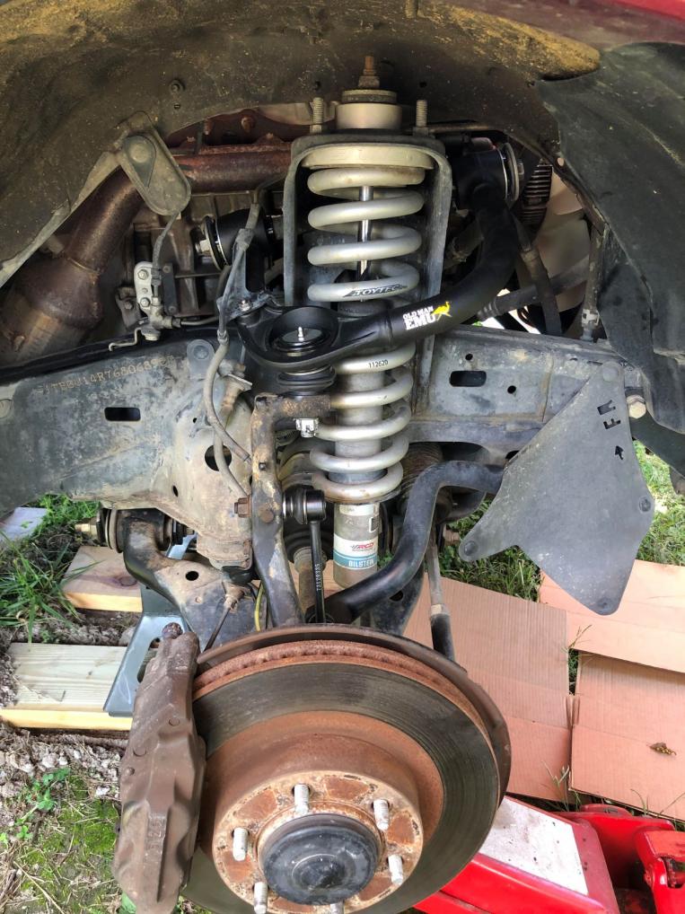

Installed OME UCAs today on a 2006 sport using these instructions. Went great thanks.
