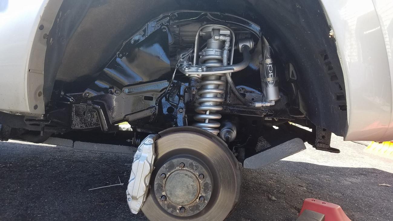

I have the JBA high caster std arms for a little over a year.. they aligned great, they hold up great, they flex as good as I need on extended travel coil overs and parts replacements look easy. Eyeing the new JBA balljoint.
I also Painted them silver because Red isnt for everyone and thats the only way they come.
