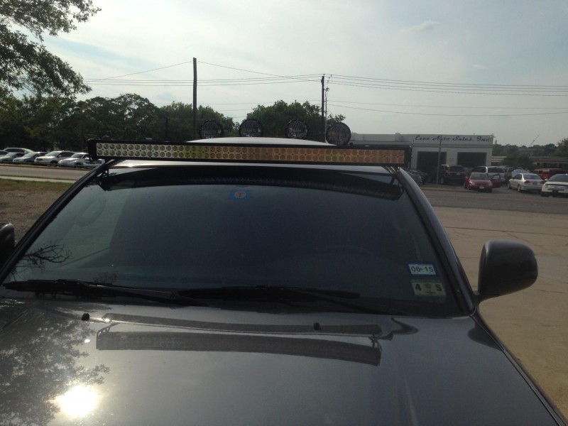

50" straight light bar mounted on a 4th gen with our mounts. The rest are being powder coated! More pics tomorrow!

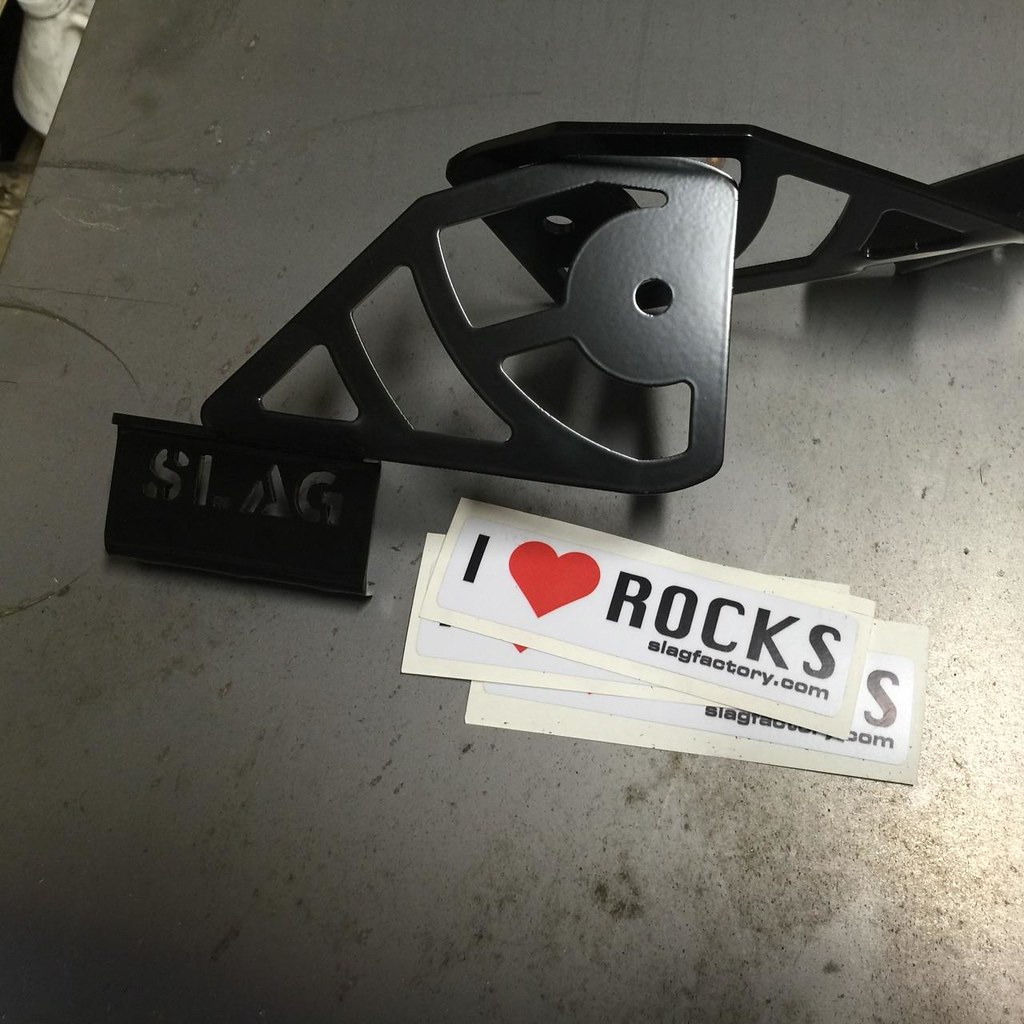

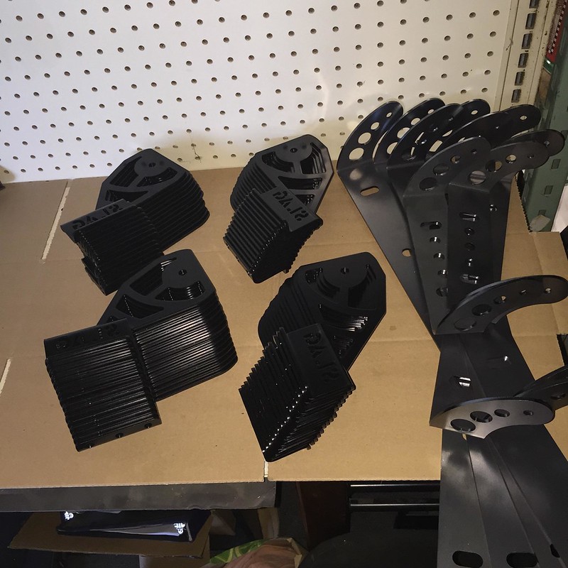

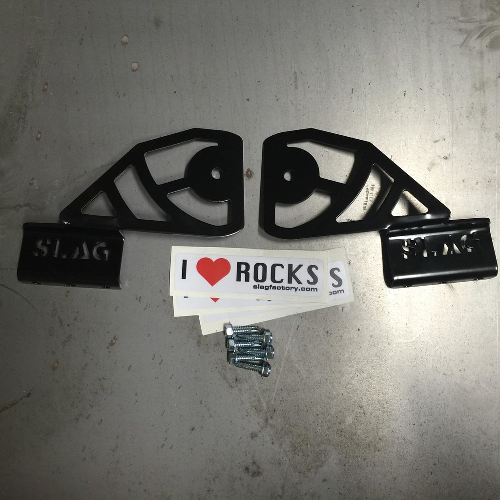

Mounts are FINALLY done and ready to ship! Price is $180
At the moment, pictures are here: 4th Gen 4runner Roof Top Light Bar Mounts (2003-2008) - Slag Factory Welding & Offroad
I will be posting powder coated pictures in the next couple hours.
Thank you all for your patience!
