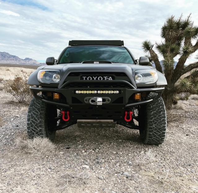

So found out I needed a little more light thrown to the side when tryna find spots in the pitch black desert lol. Visible in this pic, I added a pair of rigid D2 driving beams to the front sides below the headlights. Had some mounts welded up which was nicely done and I couldn't be happier now. I have them angles out approx 30-40 degrees. I was close to adding ditch mounts and lights but I really don't like the look of them so I ruled them out for now.

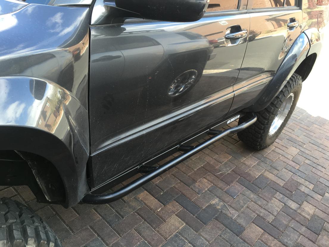

I added sliders a couple of months ago. The ones that fit my liking the best was the White Knuckle Off road ones. Nice and clean look, I opted for the bolt on units but had a bead welded on each mount to the frame for some added strength. Works great as a step for the kids too!! One with a little better view from the top and one from the side, nice n clean design, I'm super happy with them!

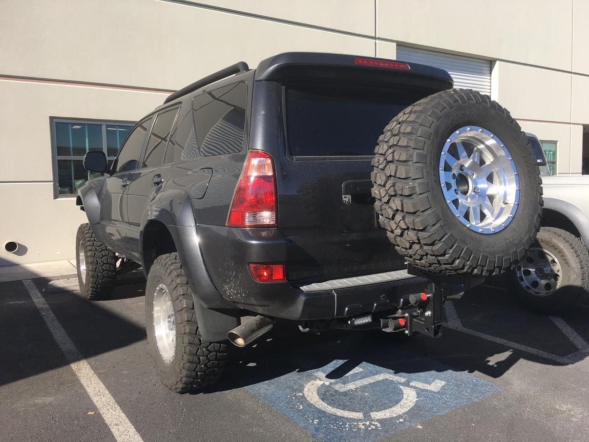

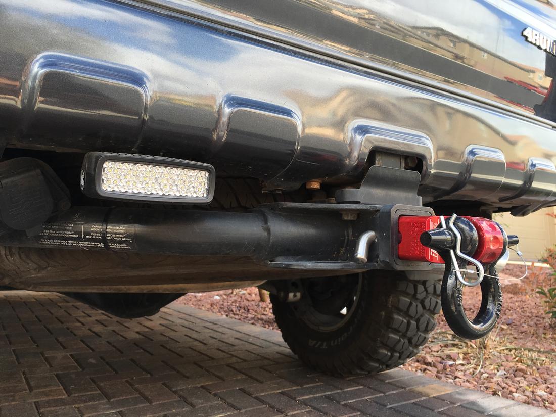

Also I figured I'd better have a full size spare handy for those times we are 50-100 miles away from home. Didn't want to break the bank on a full rear bumper and carrier so I opted for this CBI receiver carrier. Works out perfectly for me!
I don't use it everyday with normal driving as I can limp to where I need to with the factory spare if need be but I can take take the carrier with me on certain trips and runs that a full size spare would be essential. Also has a built in Rotopax mount which I don't have pictured but works perfectly. It operates fantastic, easy disconnect to get access into the tailgate. The only complaint I had was that there was a lot of movement of the unit due to slight play where the carrier inserted into the receiver and the two bolts and brackets that CBI supplied to tighten this was non effective. Luckily I stumbled upon the Roadmaster "quiet hitch" a genius but simple hitch tightener solved that! It wasn't noisy in the cab by any means but it just bothered me that it had that much movement previously.
Another cool feature is that it has a straight through receiver so I can still use it and tow my small 8' trailer as well. Here's the only pic I have of it on the Runner but I can snap another pic the next time I have it on.
PS. That handicapped stall is actually a converted employee parking out back right before it was painted over. I would never illegally park in a handicapped stall lol

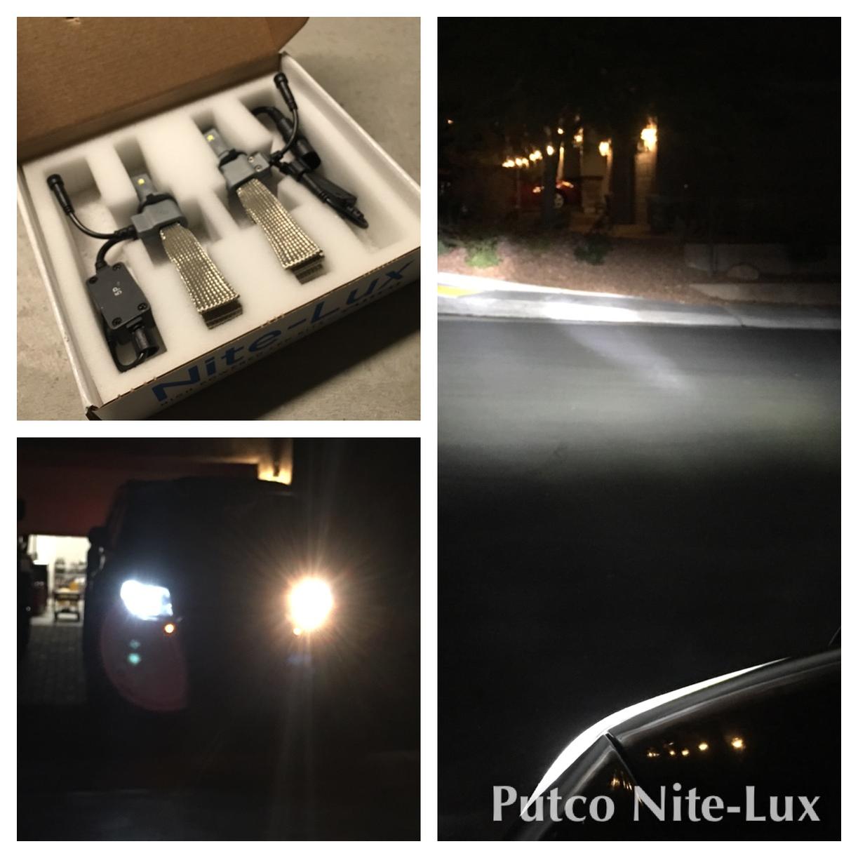

Ok most recent thing I added which was a pleasant surprise was Led headlights.
I was skeptical but I figured what the heck, I had to try it. I opted for the Putco Nite-Lux for one it was less expensive than the other alternative Inwas considering which was Piaa. The other was that the Putco didn't have any moving parts, fans to worry about. I really liked the heatsink of the Putco Nite Lux. I can say that they are most definitely waaaay better than hid in these stock housings as the light is spread out a lot better. I know they aren't designed for the hid bulbs but just mentioning what I noticed. It seems to be just as bright in my opinion. Needless to say they are a lot brighter and whiter than halogen bulbs. There are a couple of minor breaks in the light but wow I was impressed. The only other test is how long they last, we shall see.
In the first pic, you can see the color difference of stock halogen and the LED.
Below I added a pic I took while driving on the highway to get a general idea.

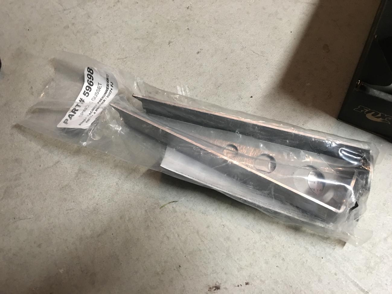

Should have the spindle gussets on soon with a buddy at work tho.

LTDSC- I'm sure I will! Can't wait to even just see them on! yep after hittin some rough terrain and some unexpected "dips" at some speed I realized I better beef up the spindles because they don't look like they'd be able to take the abuse the control arms can! I can't wait to get the bumps in, it irritates me that on occasion my tires are contacting my fenders! The first couple of times I couldn't find where it was rubbing, I was like I can't possibly be rubbing with 285's then I found the black marks on the top inner portion of my fenders! Funny I was like wow and impressed at the same time but I definitely have to limit that.

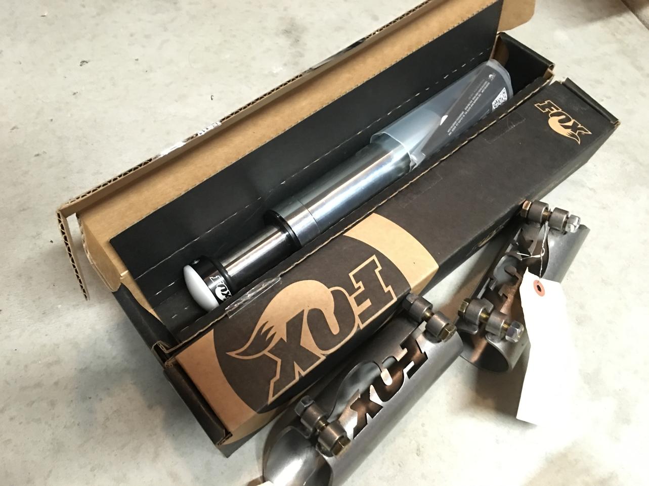

- Camburg bypass shock mounts
- Fox Bypass shocks up front

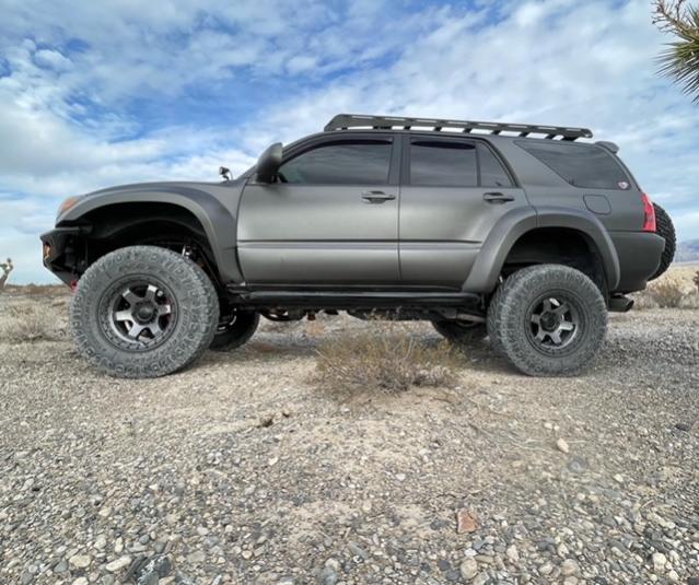

- Vegas blazing summer sun took its toll on the paint so prepped it up and got er repainted a matte color that I always wanted to do!

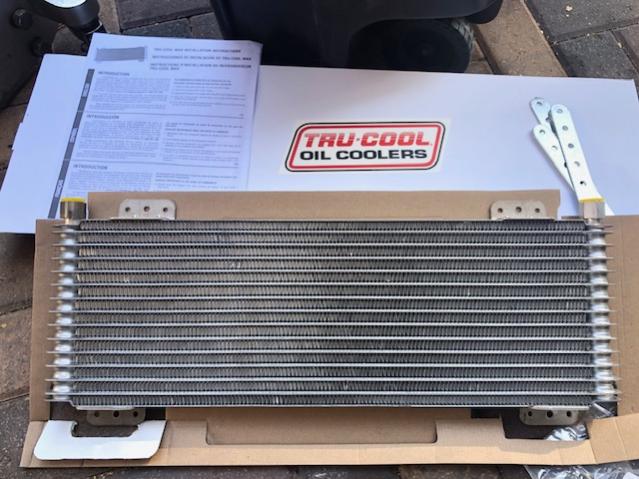

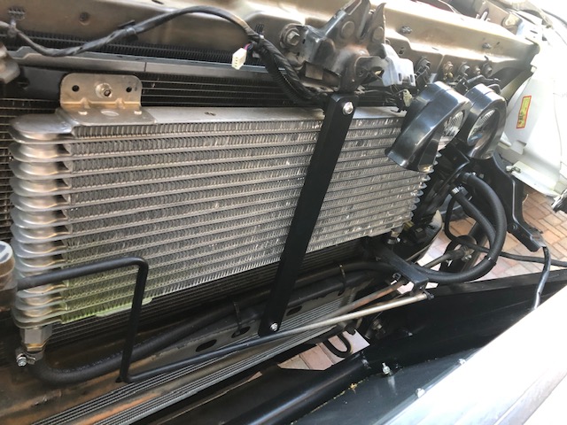

Tru-Cool 40k trans cooler, replaced my little Flexalite cooler. Towing with family on interstate on the inclines temps would gradually keep rising in the summer especially so I looked for the biggest cooler I could fit!
I had to change the center brace to make more room. Swapped the stock one with billet aluminum stock cut to size.
Believe it or not after changing to this trans cooler, even my engine oil temp average dropped about 6-9 degrees.
Believe it or not my
I also added two 9” Spal fans for the heck of it. In summer it gets brutal sometimes, I have these hooked to a separate switch and mainly use it when airflow is limited like when moving slow in the hot desert or stuck in traffic

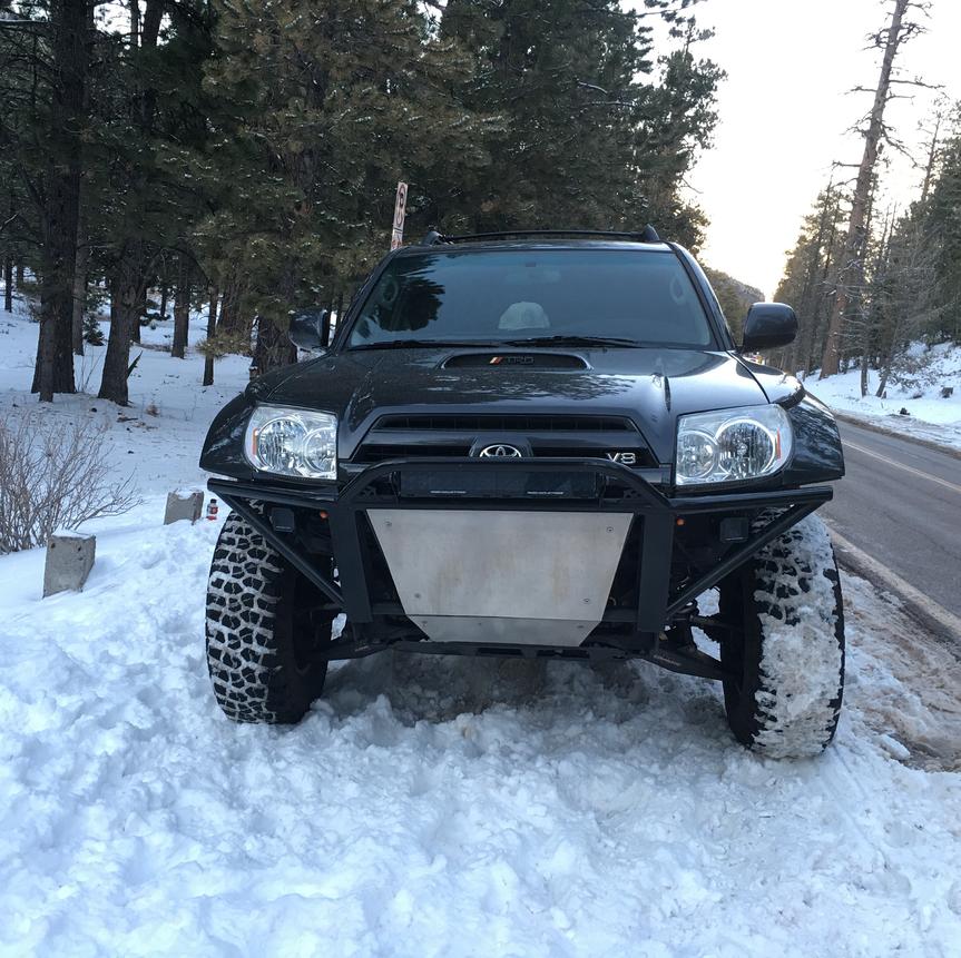

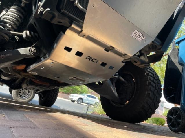

Added RCI engine skid….
Also
Changed my front bumper , added a winch , spare tire carrier , roof rack ..
LILBFAB bumper
Rugged Ridge Trekker 12s winch

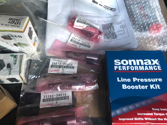

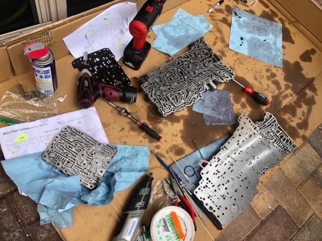

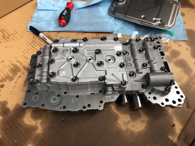

Oh btw , shift kit and booster valve body upgrade made a nice difference, crisp shifts I couldn’t get anyone to install it because of the high mileage understandably. So I ended up finally installing it and really like it a lot! Little bit of drilling and dremel’ing but follow the instructions to the T and before ya know it , all buttoned up to go back in. I swapped a few of the solenoids that I found good deals on oem ones just for preventative maintenance.
I wish I did this sooner, transmission shifts beautifully , crisper / firmer but not harsh by any stretch of the imagination. I wouldn’t mind it a little firmer but I am stoked about the difference.
