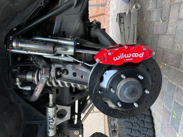

Put on Wilwood fronts fairy recently , I wanted the Wilwoods for years but finally said why not let’s try em. Love em! We’ll see How it goes pad life etc wise.

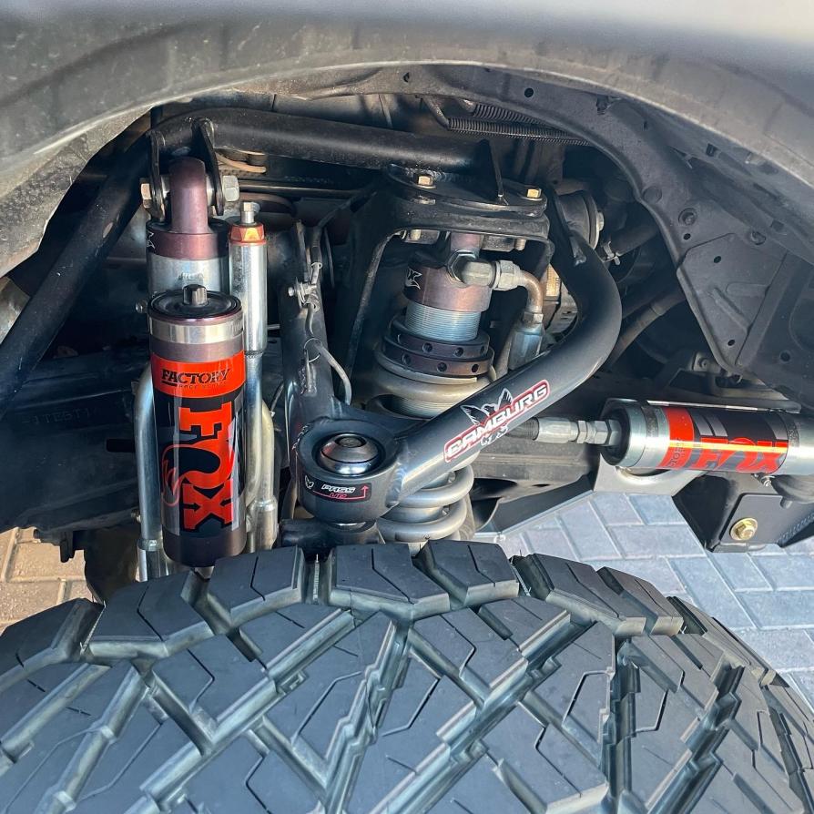

The Camburg and Fox front suspension looks freaking great on yours!

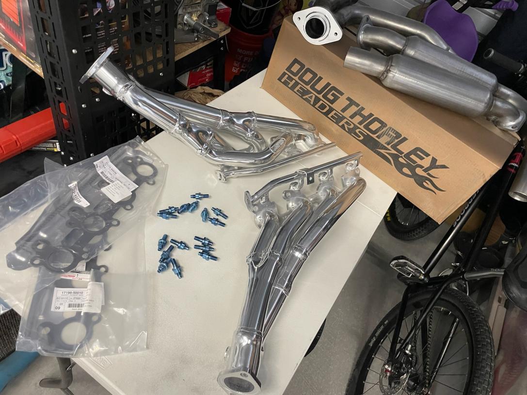

Wow , have my Thorley Long Tubes and mid but have to find time or $ to put em in hha! Can’t wait! So the injectors, what differences did you get? how did it affect fuel mileage ?

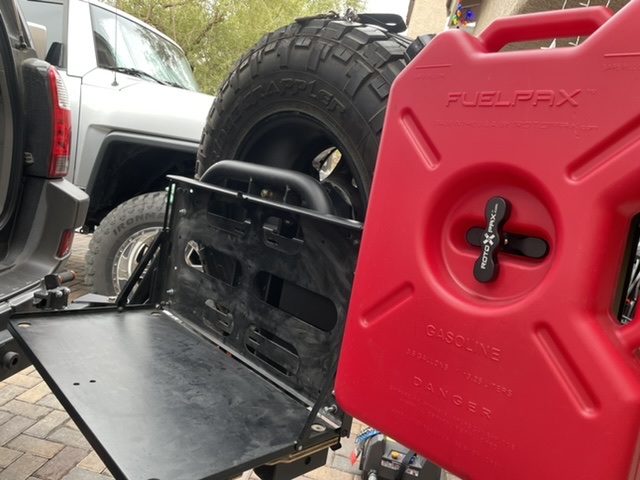

After getting a good amount of time in with the RIG’D spare carrier , I like it as much if not more than I did when I first got it. It is very solid and well engineered. I added their “sidehack” which allows adding a Rotopax mount as well as some steel molle to mount some small things of your choice. The FrontRunner folding table comes in handy a lot as well.

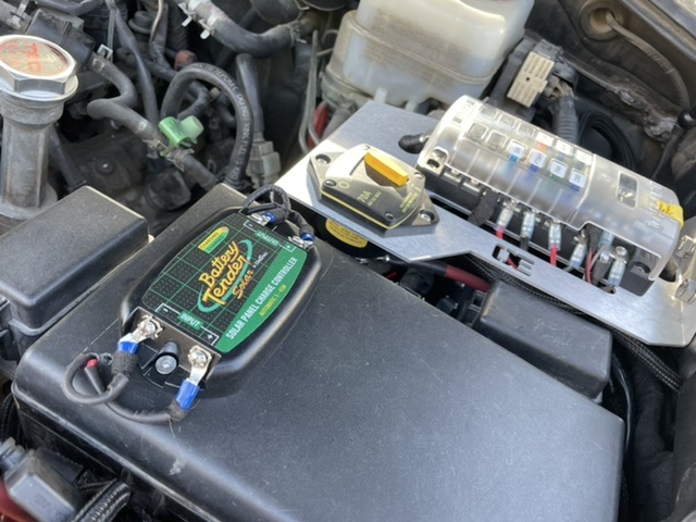

A small mod I added a few months ago was the Solar Battery tender. A female connector for the solar panel in the fender well so I can easily plug in one of my solar panels to trickle , condition the battery if needed. I have solar controllers and
Alligator clips etc when I need to hook up my bigger panels for more “juice” but the tender is nice to have when I want to just plug in a small panel to trickle condition battery once in a while without having to plug one in or may come in handy in emergency situations *♂️

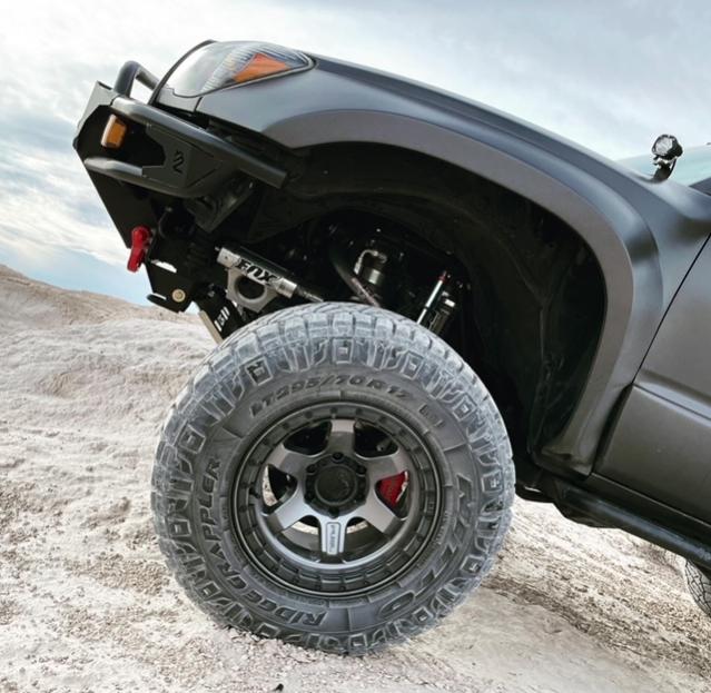

Changed my front bumper , added a winch , spare tire carrier , roof rack ..
LILBFAB bumper
Rugged Ridge Trekker 12s winch
Just very recently changed wheels and tires as well.

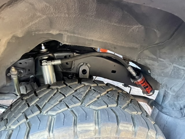

lots of weight was added , I changed to the Icon dual rate coils in rear and not only did I get the height back, it made a huge difference on whoopy terrain OffRoad.
Still have the factory series 2.0 resi in rear , waiting on my 2.5’s. And that should also make a difference and finally get the rear handling up to par.
