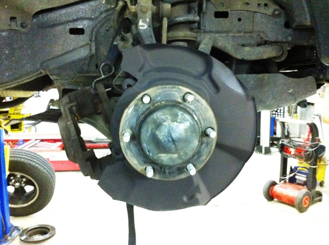

After trimming the backing plate and painting, this is what you'll end up with.

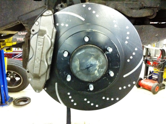

Somewhat of the finished product.
Glock_19 also had us install Hawk performance pads on the rear. There's really no need to show you guys that part of the install. We also installed Goodrich's stainless brake lines and flushed the entire brake system with DOT4 fluid.
