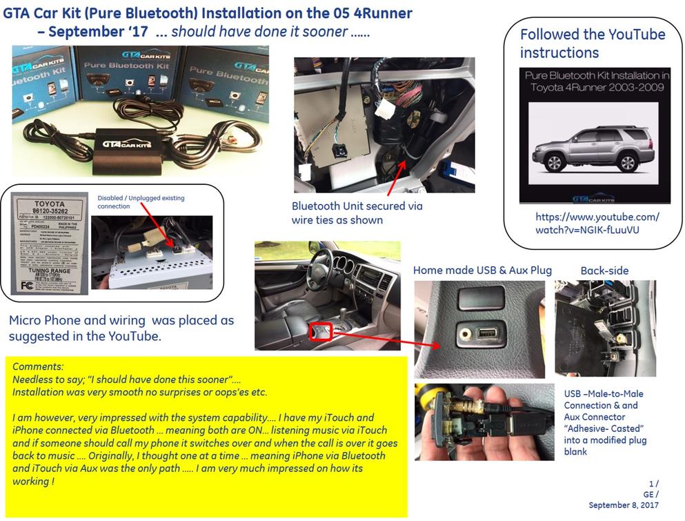

GTA Car Kit (Pure Bluetooth) Installation on the 05 4Runner
– September ‘17 … should have done it sooner ……
FYI – am sure many have done this before… just thought I post this with pic’s…
Giving something back to the community forum …. I use it frequently ….
I am however, very impressed with the system capability…. I have my iTouch and iPhone connected via Bluetooth … meaning both are ON… listening music via iTouch and if someone should call my phone it switches over and when the call is over it goes back to music …. Originally, I thought one at a time … meaning iPhone via Bluetooth and iTouch via Aux was the only path ….. I am very much impressed on how its working.
I was just looking at this GTA Car Kit. Looking forward to getting it! Thanks for the review!
