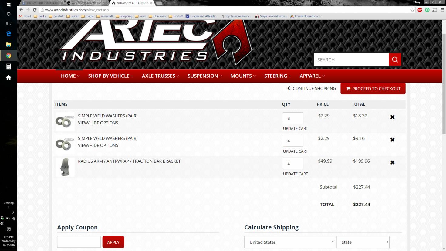

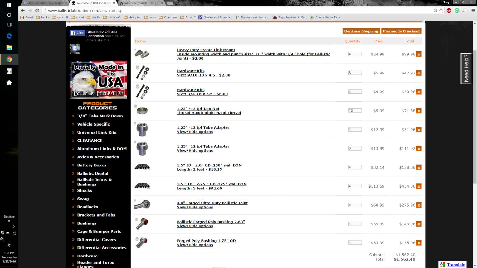

I will make sure I take lots of pictures and videos when I do it. I just added up everything for my links: DOM tubing, ballistic joints and bushings, threaded tube adapters, jam nuts... $1400. But that is using 2.25" .375 wall lowers and 2" .250 wall uppers. 3" ballistic joint on frame and 2.625 ballistic bushings on axle. Should be totally bomb proof, let me set the truck down on them and give me tons of adjustability and flex. The ballistic joint and bushings combo saves me from binding so I should get well over 35" of flex. ORI struts will keep it stable on the road and offroad. She'll be a screamin beast!Ha! I understand that! I wish I lived closer...I'd love to see the progress in person!
