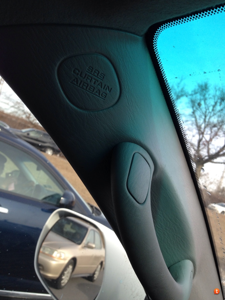

3.....can i remove the side grab handle and pilar plastic without airbags going off
Here is a pic of what i want to remove to hardwire my ultragauge and gps

3) I have taken that whole A pillar trim off without issue, few bolts and a clip or two - I would disconnect the neg batter terminal anyway
