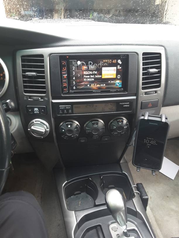

This is what I use mounted to a Proclip anlgled dash mount. Works great. Ran a charging wire from behind the dash and hangs a little bit. Slap the phone in and charging cable. Holds TIGHT in any terrain.
This looks great! Have you had any problems with this mount? Can you run with the phone in landscape, or will it fall out of the holder?
I haven’t had any issues, I’ve had it for a few years now.
I’ve used it in landscape mode but only on road. So I can’t say if it’ll hold that way if you’re on a bumpy road. Just don’t seem to need or want it in landscape mode much.
They have a version that doesn’t have a bottom, just the two sides, that’s what I originally had a few years ago and I didn’t like it. It held on a paved road just fine, but as soon as I was on a gravel road or worse, where there was consistent bumps, the phone would work it’s way loose and slip out of the holder.
When I got a new phone and needed a new size of holder, I went with the one with the bottom that is designed to run the lightning cable through. I haven’t had a problem with the phone coming loose with this holder, it’s much more secure.

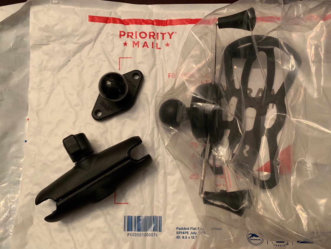

I got my order for my RAM Mount, can’t wait to get it installed.
Ordered part# RAM-B-102-UN10U for larger phones, from GPS City on Amazon. Figured I’ll make a back plate for it before installing it... and get some bolts, they aren’t included.

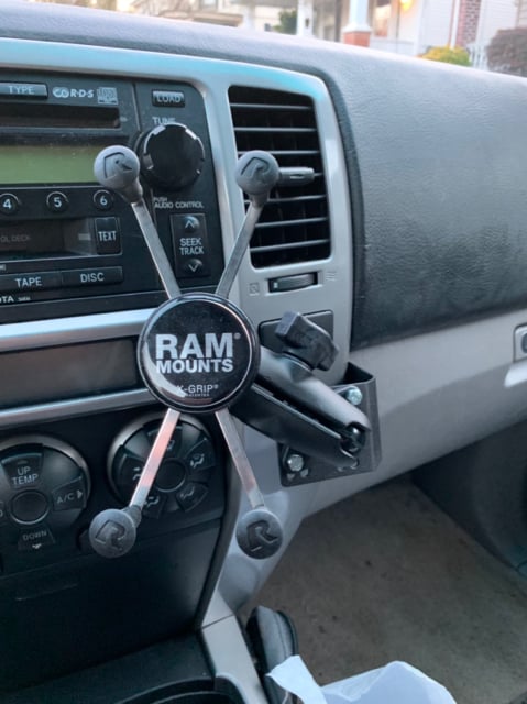

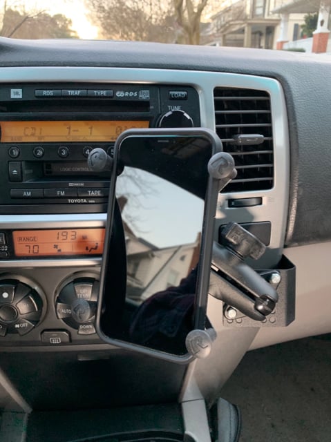

Here’s the install pics using the Panavise bracket and RAM mount. I decided to use this bracket instead of drilling holes.
Nice setup, I like it! Does that bracket just clip in behind the bezel, or does it screw into the side where it is hidden from view?

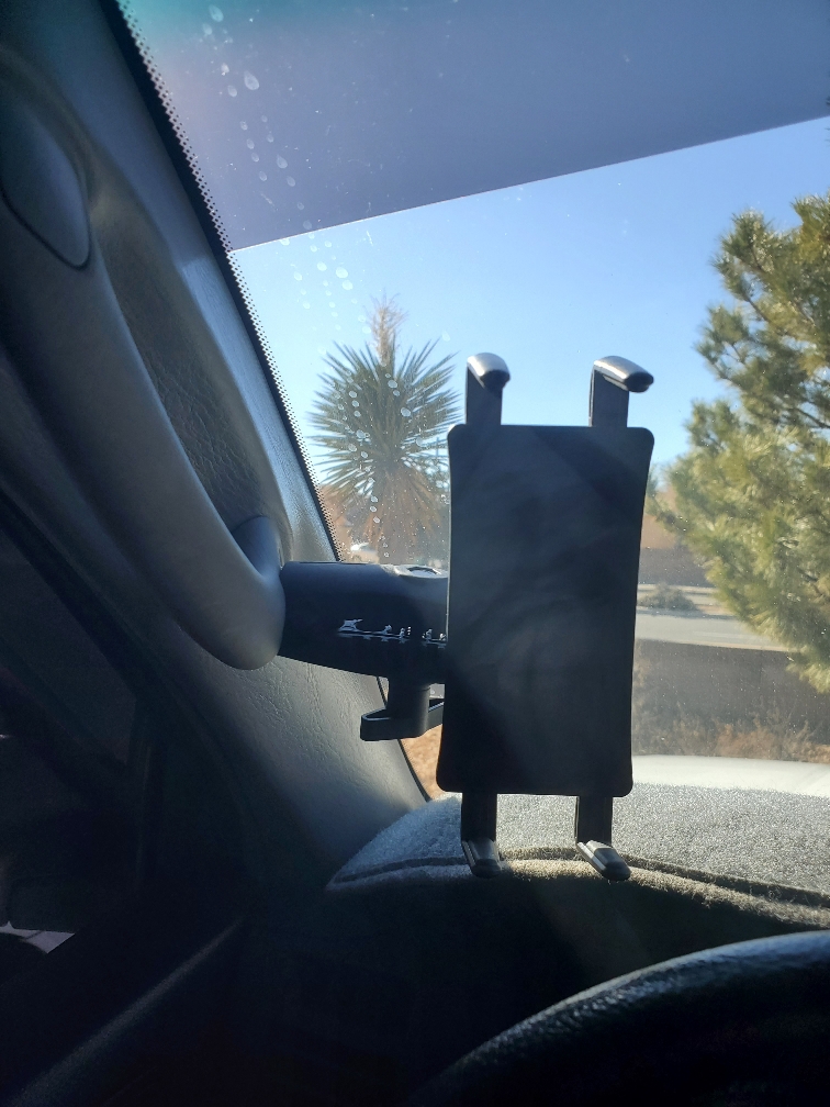

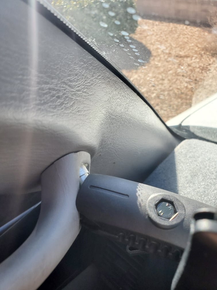

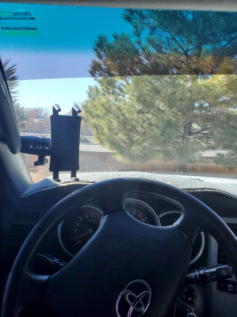

Just did something like this past weekend. Took a screw on ball mount and put it in the bottom of the A-pillar under the handle. Then got a mount with a arm to attach to it. Matched the bolt that came out with one that is sightly longer
here are the links if interested....
phone mount
Amazon.com: Arkon Heavy Duty Drill Base Mount for Note 9 8 iPhone XS Max XS XR X 8 iPad mini Galaxy Tab Retail Black: Computers & Accessories
Ball mount
Amazon.com: Maso Motorcycle Handlebar Clamp Ball with M8 Screws for RAM Mount: Automotive
I didn't want to make any holes in my dash and stick on's are trash
Like this
I bought this Panavise mount too, but I’m super disappointed how much it bounces around even just on regular roads… I’m suprised how much it sticks away from the dash I think that’s also part of the stability problem. Also the angle of the bracket is opposite of the angle of the dash so it almost looks like a design flaw, although the angle does make more sense in that you want the phone to face up and towards you. Honestly I think I would be totally happy with it if there wasn’t so much vibration and bobble. I’m thinking of cutting some dense foam to fit snug between the dash and the mount to see if that will do the trick.. but the angles will be tricky to make it look clean. I just want it to be more stable and I don’t want it to look janky.
