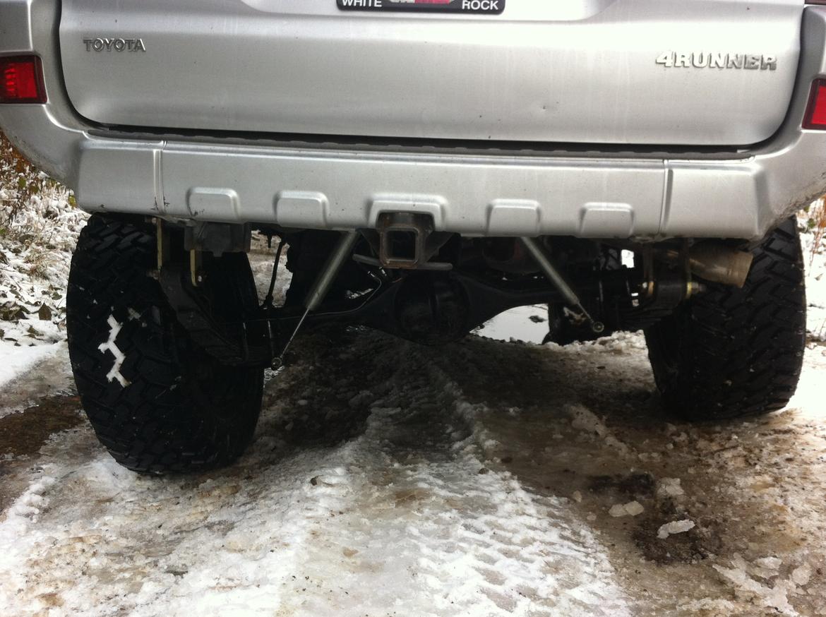

Currently here is my only pic below my back end, its not great with detail about the topic, but it shows what I have done to overcome this RAS. Take note how naked that axle looks compared to yours.

Well that makes a bunch more sence now, I probubly would never have gone with leaf springs if I saw those threads. 4x4x8 did very well. The whole time I did my research I had coilovers in mind for this with additional shocks up into the wheel well, stupid me! :redbrick:

Still seems strange that Toyota was telling me what they told me about the chassis being so different, unless all they meant by it was that I would need the cone for the upper coil mount. Initially all I wanted was an additional 2 or 3 inch lift. I totally blame beer for this, I had too many when I ordered parts, and way to many when I went to town with the grinder. I think I was just to eager to get it lifted. Oh well, no regrets, I love my T4R as it is truely one of a kind and she rides like a champ.
Two questions:
1: Is it completely unheard of to put coilovers in the back?
2: I was winging it when I did this, and the only way I could fit my shocks in were on some crazy angles... Is that also concidered strange to see? They run directly inline with the axle and are mounted 6 or 7 inches appart.
Coilovers on the rear, at least on a 4runner, is a first for me. I've never seen a setup quite like yours either, but I've not looked into anything like that either. You've got a sweet setup regardless. I'm planning on this swap, just trying to make sure I've got all the info right, don't wanna end up with it tore apart and not have everything to put it back together.

lol Seems to me like I know very little about conventional ways to lift a 4runner! I was looking into the most difficult ways to do this, but never the less I did make it work so high five for me! I'll send you a PM about the front end to keep this forum on topic.

Bumping an old thread, but damn! That rear leaf spring conversion is on another level.:jaw:
