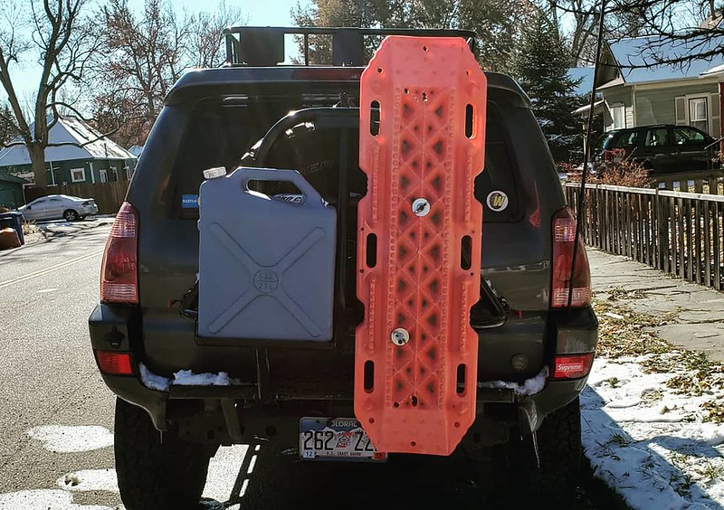

Went with the coastal bumper, I liked that I could do a few changes to it. Changed the light cutouts for my bd squadrons and had the hoops custom bent to be tighter to the body.
Like [MENTION=459231]xtremewlr[/MENTION] said... personal satisfaction thing and I also tweaked it a little bit to get the gap pretty consistent all the way around, that huge ass crack i see at the fender on a lot of them would drive me absolutely insane.

Still in progress, hopefully doing the finish welding this weekend -- and welding isn't too bad to pick up, plus it makes all kinds of projects a possibility, like the swing outs I did.
That makes sense.. It looks great! Keep us posted and make that build thread.

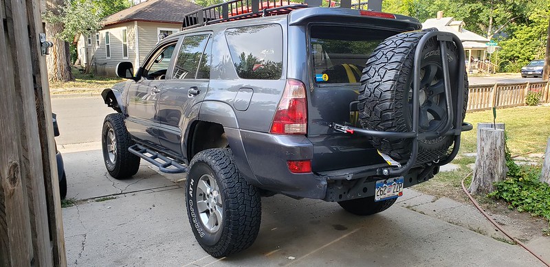

The first time I touched a welding machine was when I opened up the boxes from coastal Offroad. I did end up with that gap, I had no idea how to fix it at the time. In hindsight, the top plates need some bending upward at the corners. I don’t hate the look, just wish it had turned out a tad bit tighter. I had no issues other than that.

The 3 nuts/bolts behind your shackles... you can add 1-3 washers between the bumper and frame on the top and 2nd bolt to tilt the bumper forward and eliminate the gap. Coastal Offroad themselves suggested this and even slotted the 22mm bolt to accommodate this.

I tried that suggestion with mine, although it was to open up the gap (or at least get a gap) in the front... the front of mine was smack up tight to the headlight trim pieces. Problem was it opened up a gap when looking down on the bumper, I could see the ground cause the bumper was standing out too far. But that is the nice thing about DIY kits, you're not stuck with what comes off the truck :-)

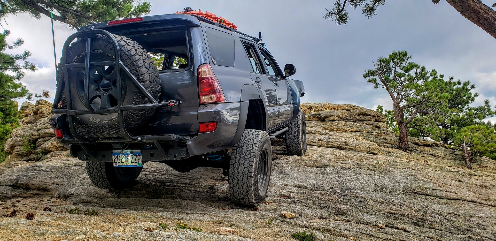

I know this thread is old... but! Just wanted to share an updated photo of my DIY rear stinger.
1. added side supports there.
2. re-created the latch points out of thicker steel.
3. Added bolts where the old latch point was- much thicker now!
2 trips to Moab (6 total days of hard terrain), 26 trails in Colorado and she's still holding very strong!
I may be re-doing the rear bumper portion of it just to make it wrap around the rear 1/4 panel plastic, but IDK for sure yet!
