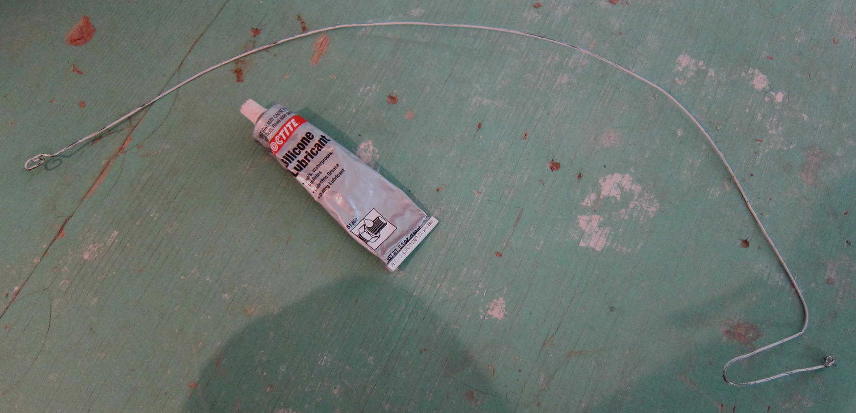

Sorry for delay:
here is the handiest tool for snaking wires through dash, doors, wherever:
Its cheap (free) and you probably have one in your closet.

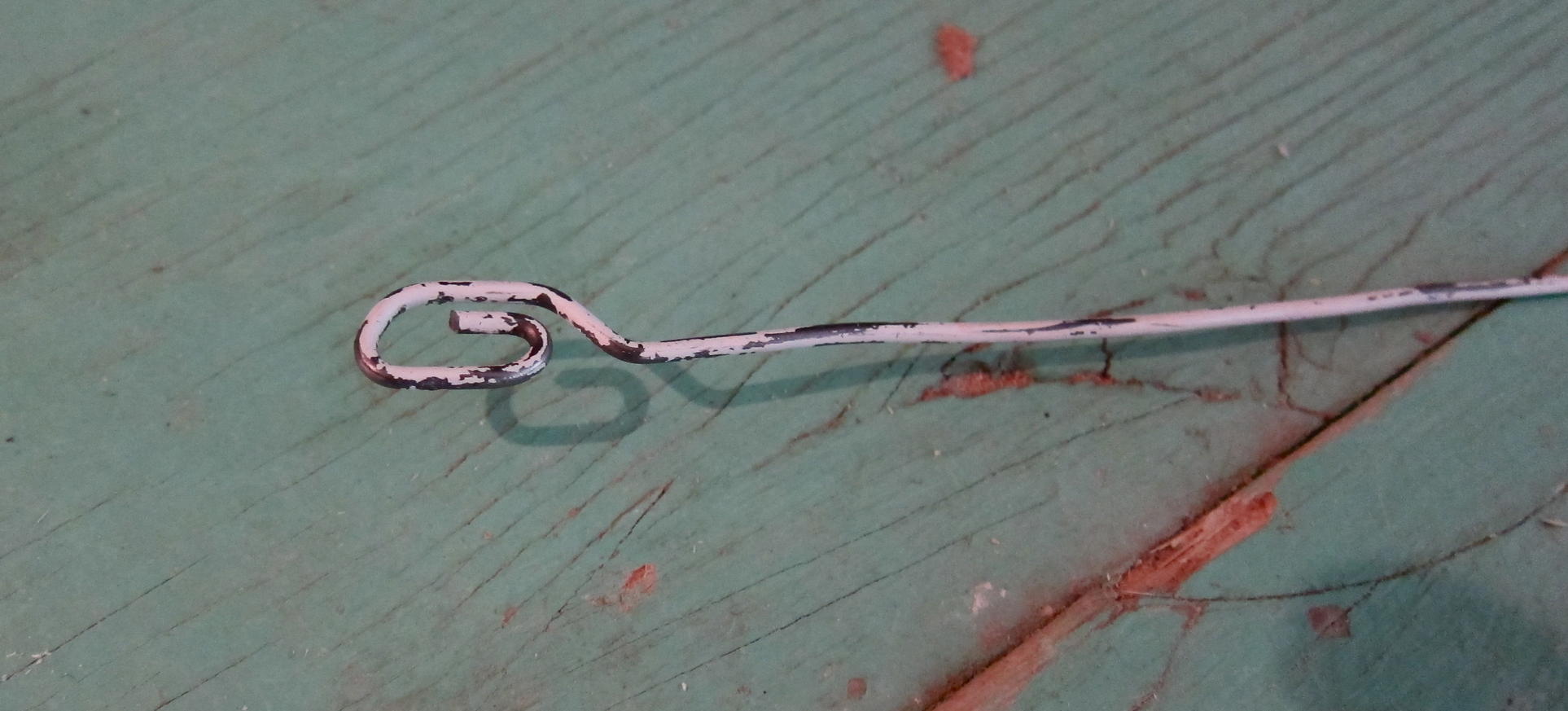

Here's a close-up of how I bent the tip so it won't snag in either direction.
The silicone lube is important when trying to get wires through the rubber sleeves that connect doors to body. Lube up the wire your pulling and the coat hanger.
