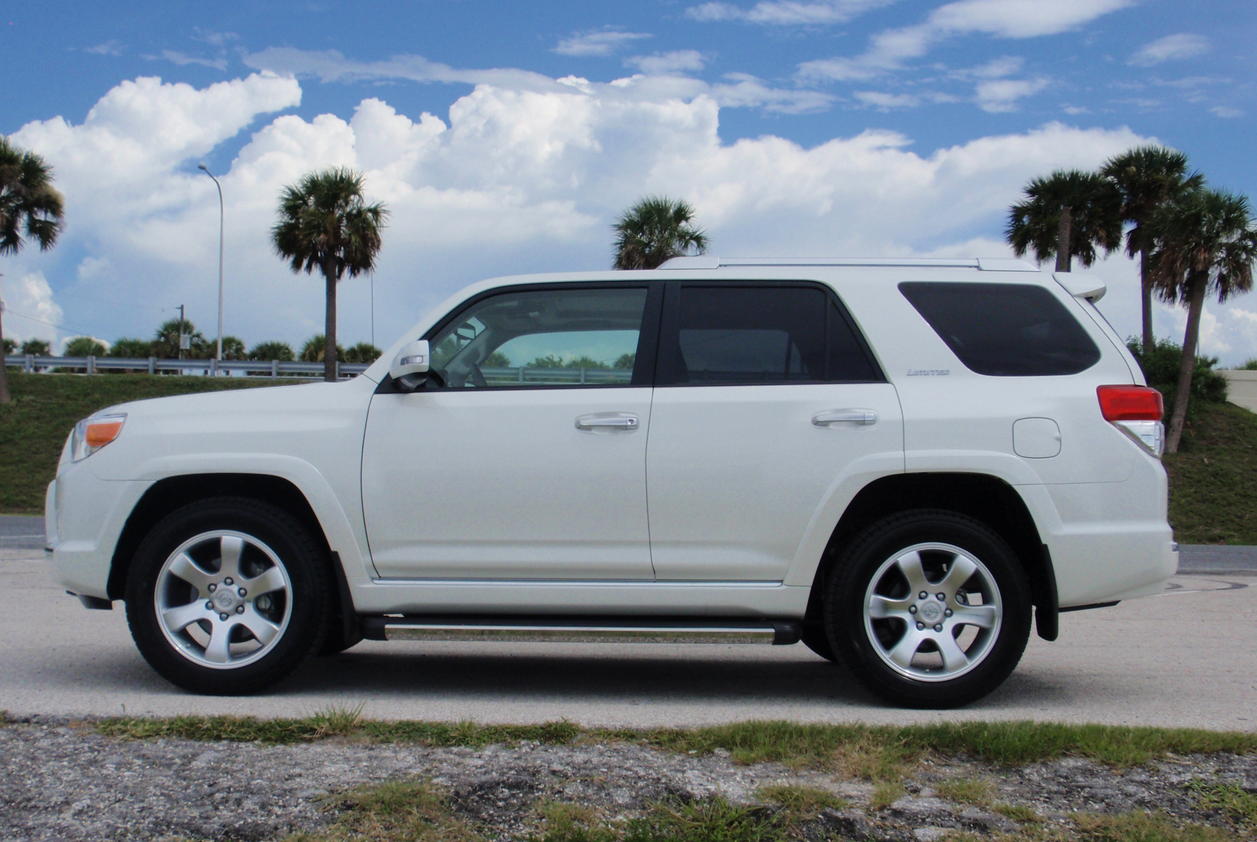

I saw these yesterday on the picture sticky. I think they look awesome!
http://www.toyota-4runner.org/5th-g...nner-owners-picture-thread-99.html#post833331
