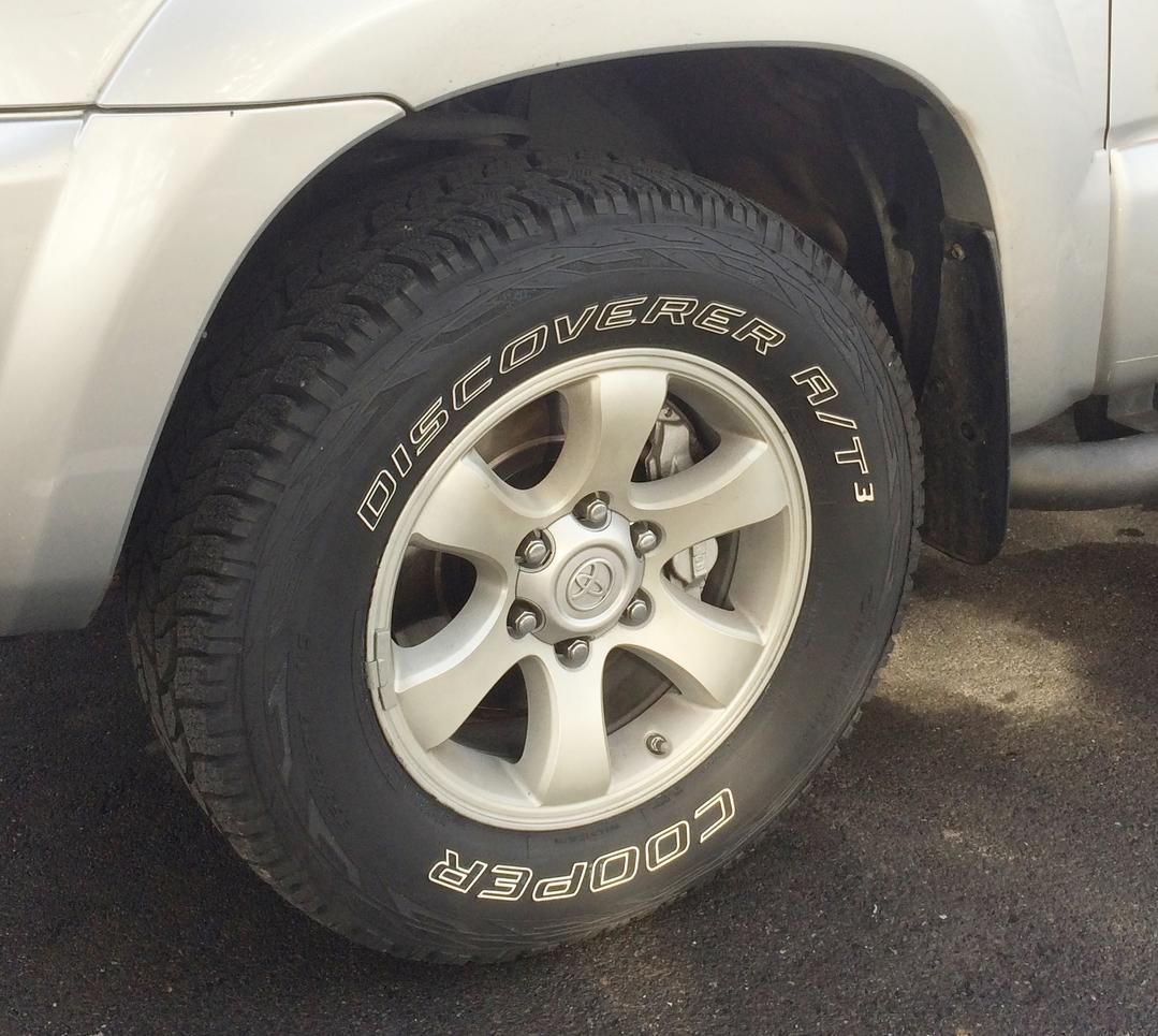

Thinking about tinkering with restoring my wheels. I would like to stick to the same silver or maybe just a tad darker. I like the attached wheels but have never had luck with Dupli Color products. Might be the high humidity of Tennessee. Any other resources? Considered plasti-dip products but I have zero experience with them. They seem a bit infomercial-like and honestly kind of expensive for a semi permanent solution. Dip Your Car has kits that are around 70 plus shipping I think.
I really want to stay away from black on black as its just not my thing. Just tired of looking at the oxidation bubbles on the spokes. Otherwise love the silver/aluminum look.

If you can source a paint code that matches or is close to the OEM paint, you can visit your local auto parts store paint dept and they can mix up a spray can for you ... and preparation and weather takes a big toll on the final product. Maybe choose a less humid day to paint? Make sure to follow the recommended directions on the paint can.
Most normal Plastidip colors can be found at a lot of local and home improvement stores now. Don't buy the online kits unless you have nothing available to you. I ran anthracite grey for awhile on my other car. If you can rattle can a rim, you can Plastidip. It's not hard. You will still need to clean off the oxidation and bubbles on your rims before starting.
If your rims are as bad as you make it sound, you might as well DIY refurb them and paint them up as best you can. Get them done professionally if you can afford it. Plastidip won't mask existing imperfections.
