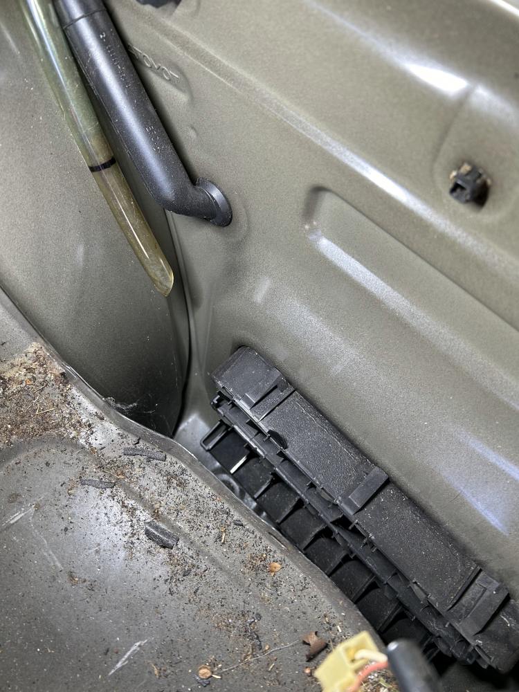

I got both front sunroof drains cleared.
It has rained since then and I didn't find any wet spots so I think I'm good there.

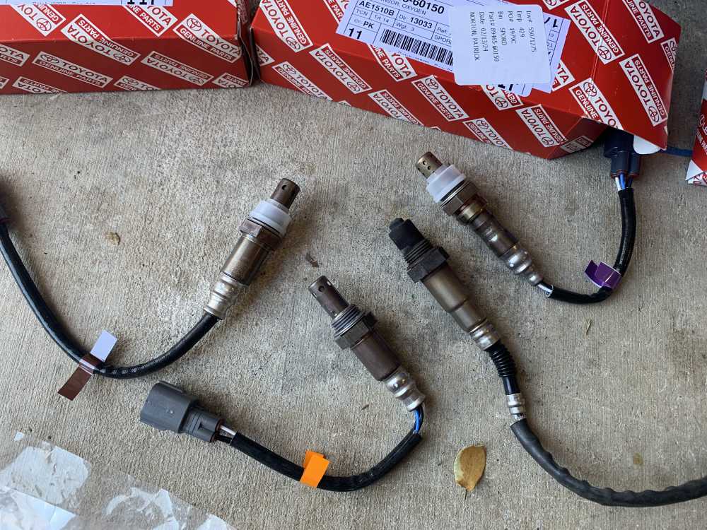

I'm now trying to track down a Bank 2 Lean condition (P0174).
I also replaced the driver side O2 sensor ... so both fronts are new.

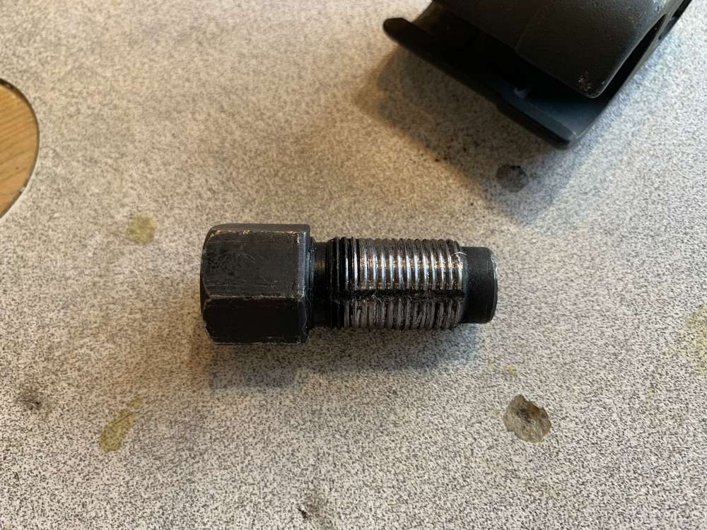

(Side note, thread chaser is < thread tap. Just FYI)
I have the rear sensors too but have not put them in.
Cleaned the MAF.
Also replaced the PCV valve, PCV hoses and a few misc bits of hardware and clips.
I'm thinking it might be a vac leak since I did replace a few brackets under the hood.
Maybe I popped off a hose or bumped a brittle one?
That or a fuel injector.
Ugh.
Time to bust out the smoke tester I guess.

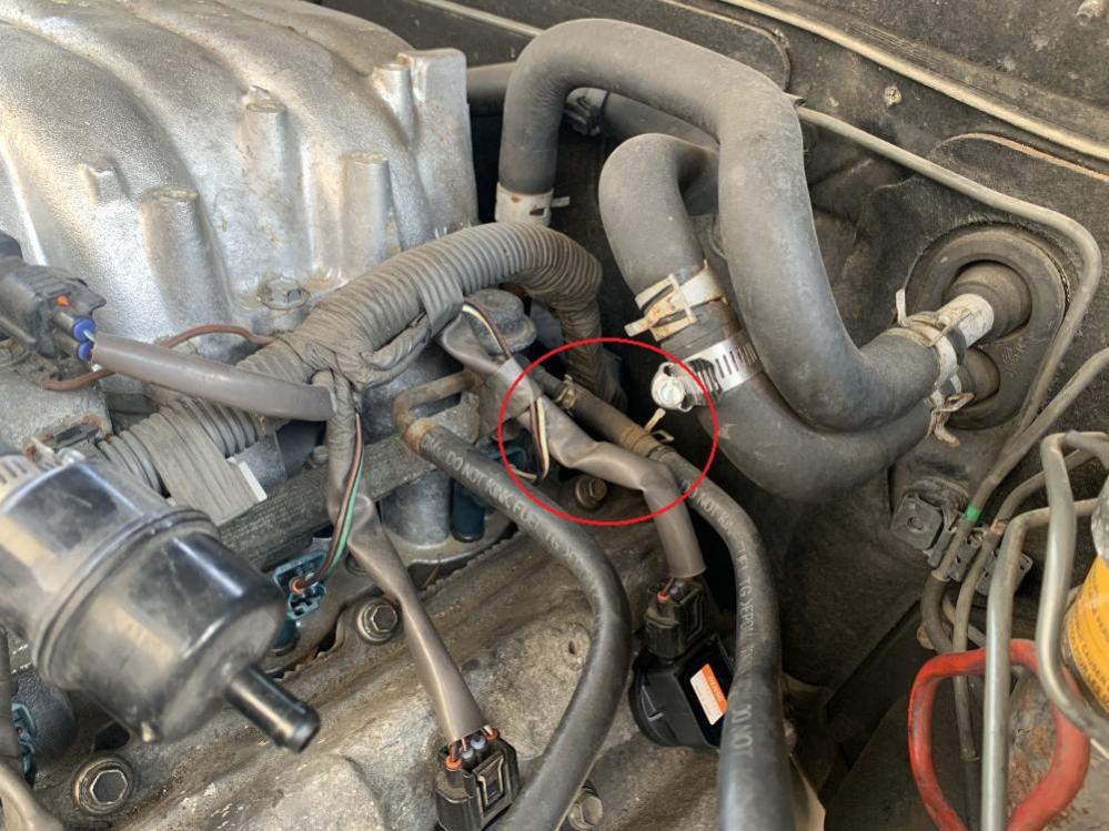

Did a smoke test today and couldn't find any major leaks.... but I did find a few Evap hoses that need some love, so those are getting replaced.
During the smoke test I did see the slightest amount , and I mean super slight, coming out from near the TB/Intake connection. I tightened that up and noticed the intake housing is looking a little ragged. Might order a new one to be safe.
I also noticed that the fuel line to the passenger side must have had a leak at some point and the PO patched it.
You can see it in the back of this pic (please ignore the missing evap lines). That would technically be going to "Bank 2" so I might replace it when I do the injectors if I can figure out the part numbers! lol

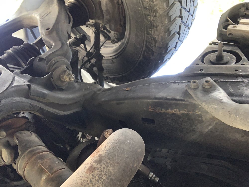

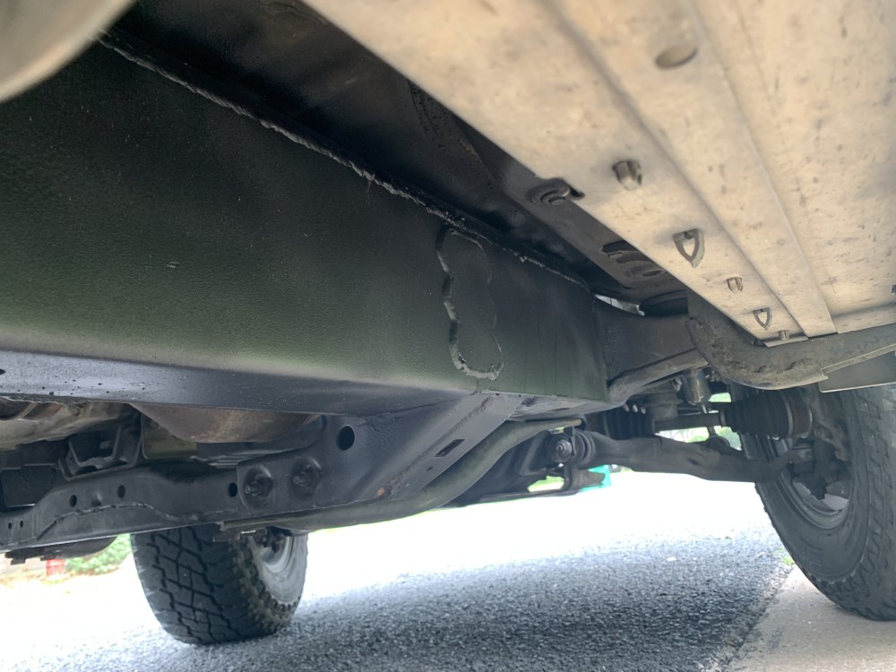

Reference frame rust. The V8 AC condenser drains right on top of the frame rail, passenger side coming through the firewall, a 90 degree down hose. This hose drips condensate right on top of the frame rail, the condensate runs down to a spot on the frame under the passenger side front door where it stops and drips on the ground. At that point it rusts a hole in the frame. you might want to get a hose barb connection and some hose and run the hose to a location away from the frame, I took mine to the passenger side wheel well and clamped it there. I had a rusted hole a foot long on the bottom of the frame there, driver side clean.
Good info!
Mine is only really bad on the passenger side up front and in the area you describe. I'll try to find the drain and move it and take pictures for reference for others.
I got all the SafeTCap parts ordered.
Went with 200, 201 & 202 on both sides as well as some fish plates and gussets.
I don't think it will need them all, but the shop I am using is far away and I didn't want to have to make a second trip/order.

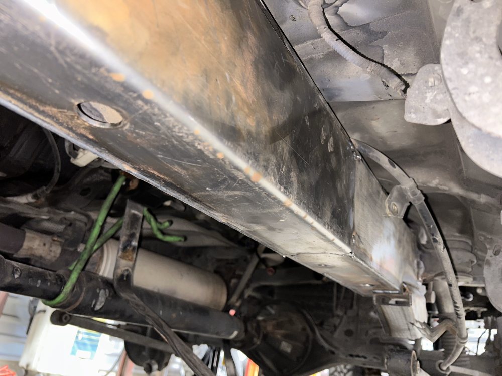

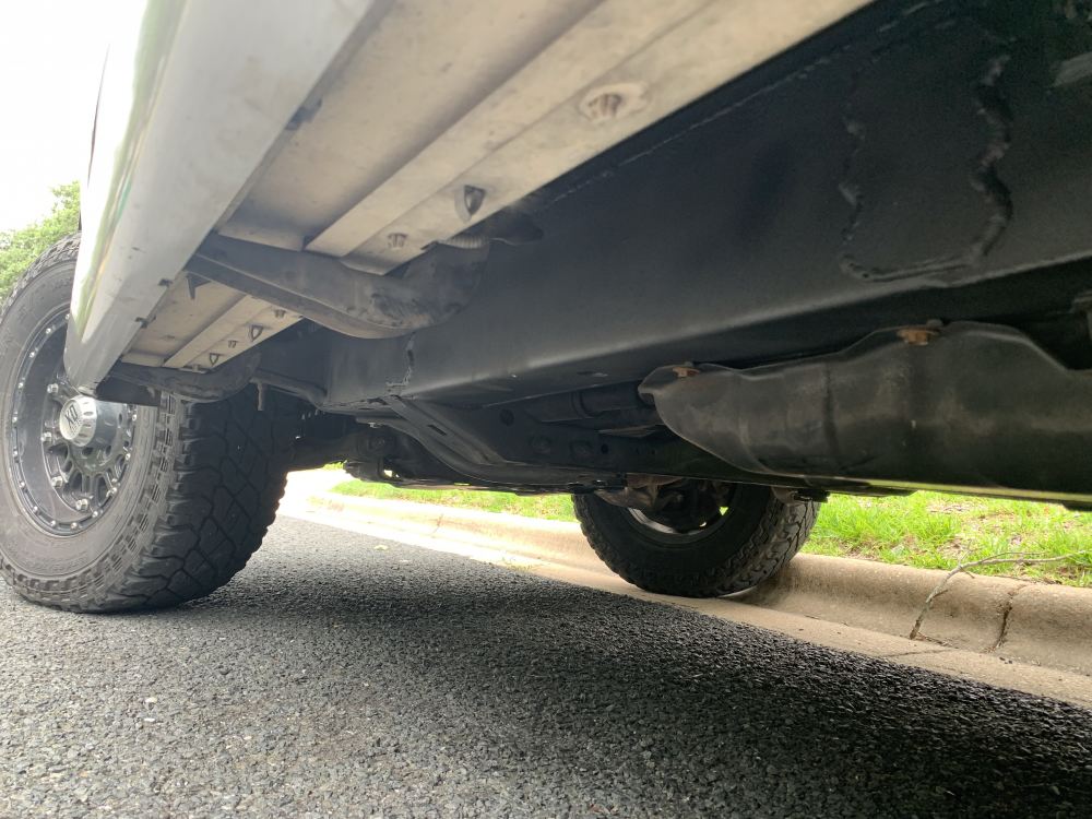

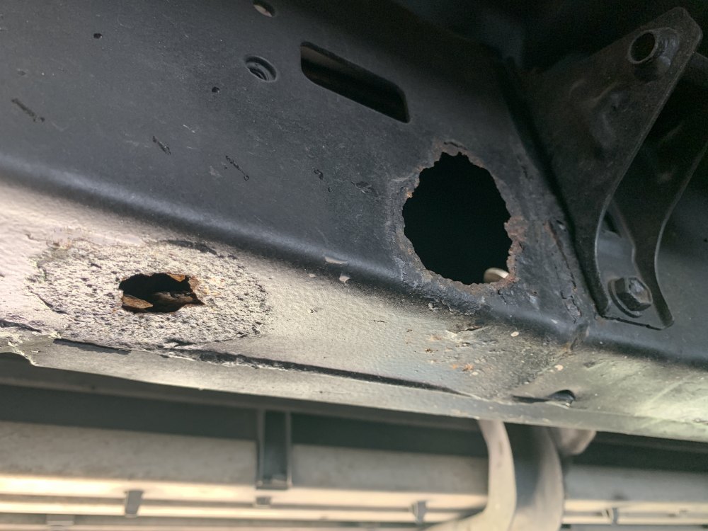

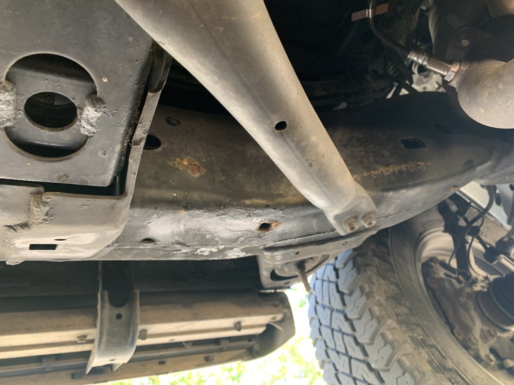

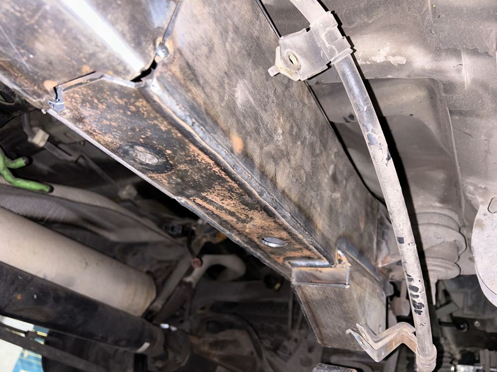

Some before shots:

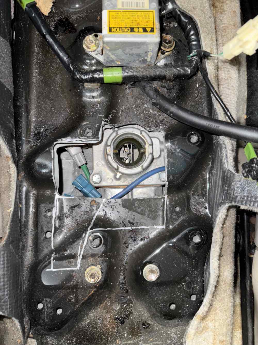

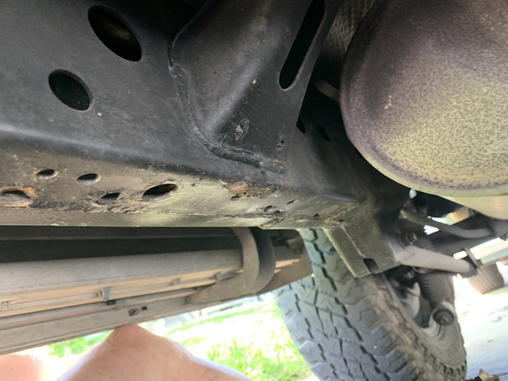

This is everything I can find (and I am looking hard) on the driver side.
3rd picture is down the gas tank side and it looks clean.
The outside (outboard side) looks immaculate everywhere. It's just the inner (inboard) side.

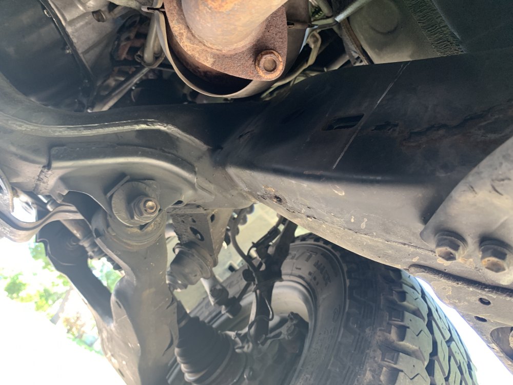

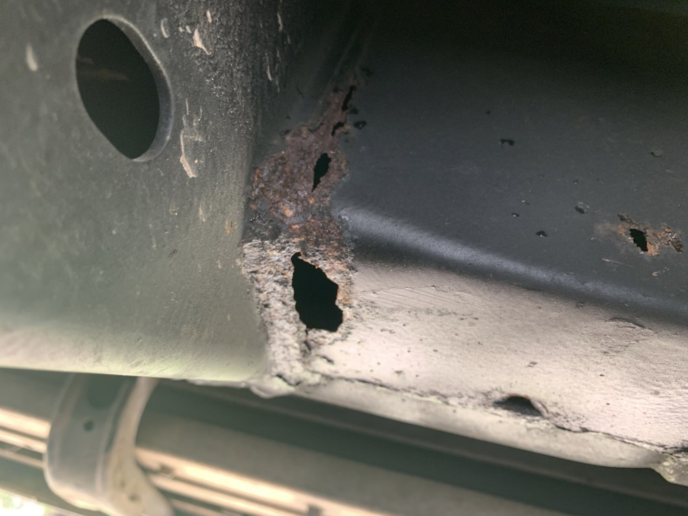

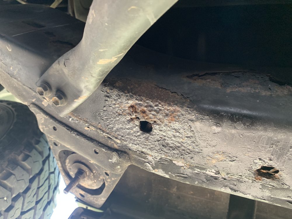

Pass side is worse and the photos make it look horrible...but still not like the catastrophic stuff I see on the web... and again the outside (outboard side) looks immaculate. very strange.
I think even on this side the 202 parts are overkill but that is my goal.
I never want to do this again (and if I have to I will re-frame it).

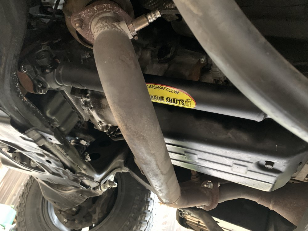

Got the front & rear driveshafts lubed up today @ 215,674
(Had the typical clunking)
Opted for Valvoline with Moly for u-joints and Mobil 1 synthetic for the slips.
Seems to have solved it.:reddance:
Dropping off tomorrow at my local 4x4 shop for the Saftcap install.
I'll share pics when I get them!

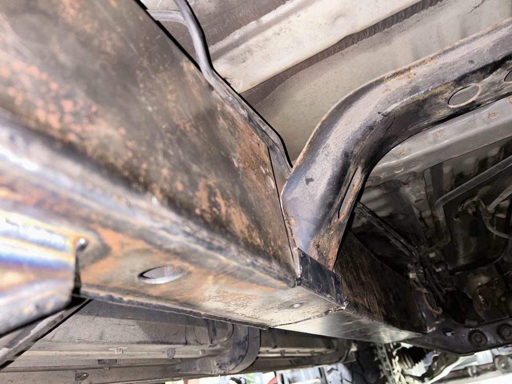

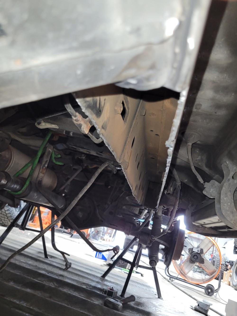

The shop was backed up but getting to me now.

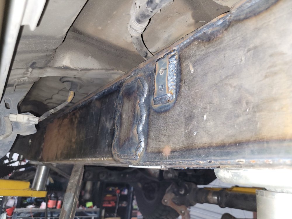

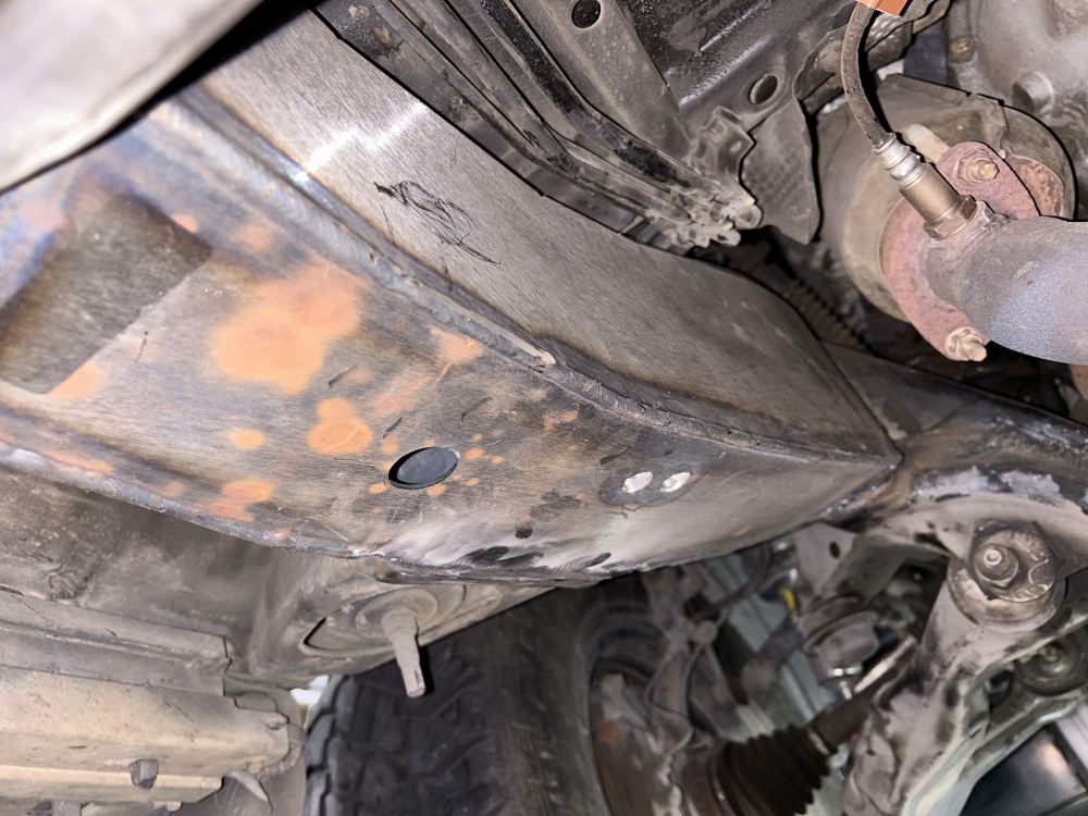

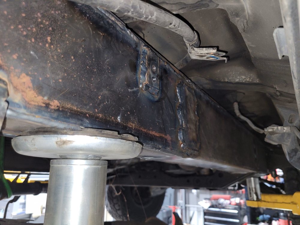

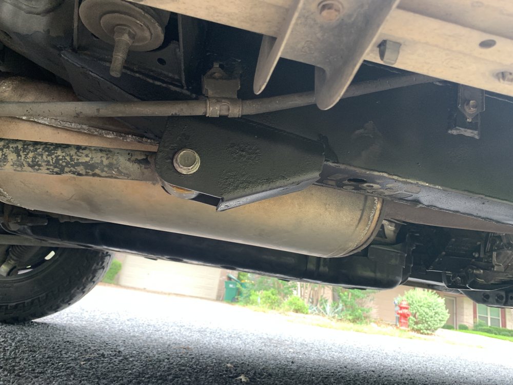

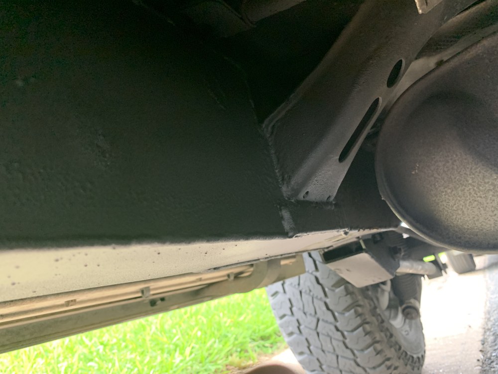

Driver side was very clean inside except for the very bottom.
Passenger side will look worse inside but hopefully not too far up.
I guess as thick as these caps are it doesn't matter.... not gonna go anywhere now!
Will share pics from pass side when I get them.

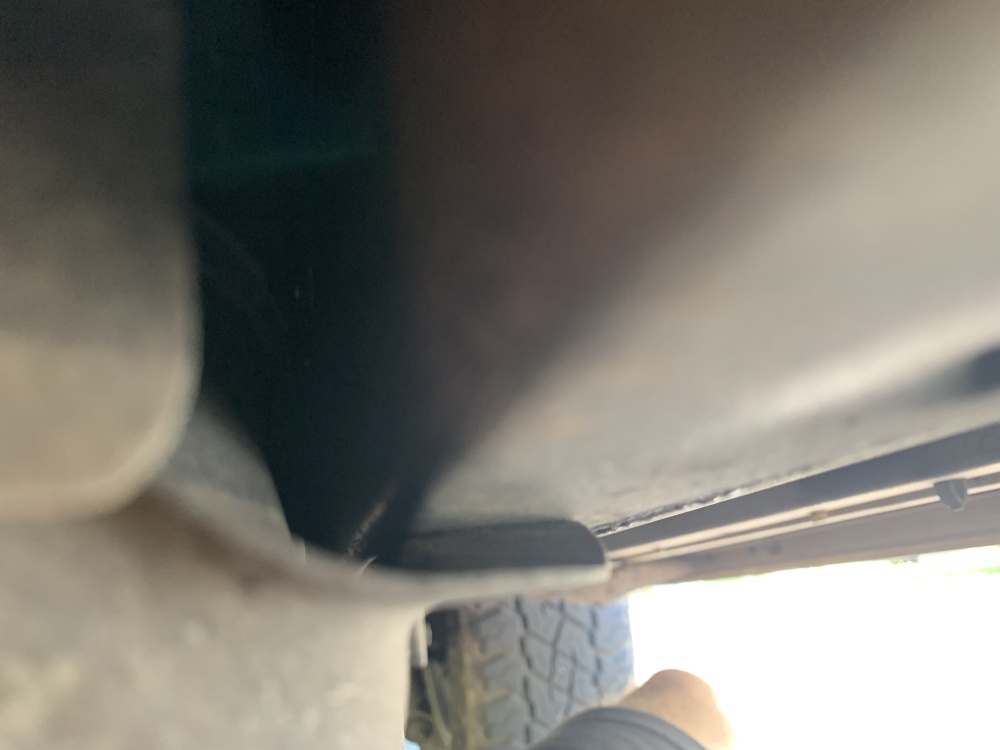

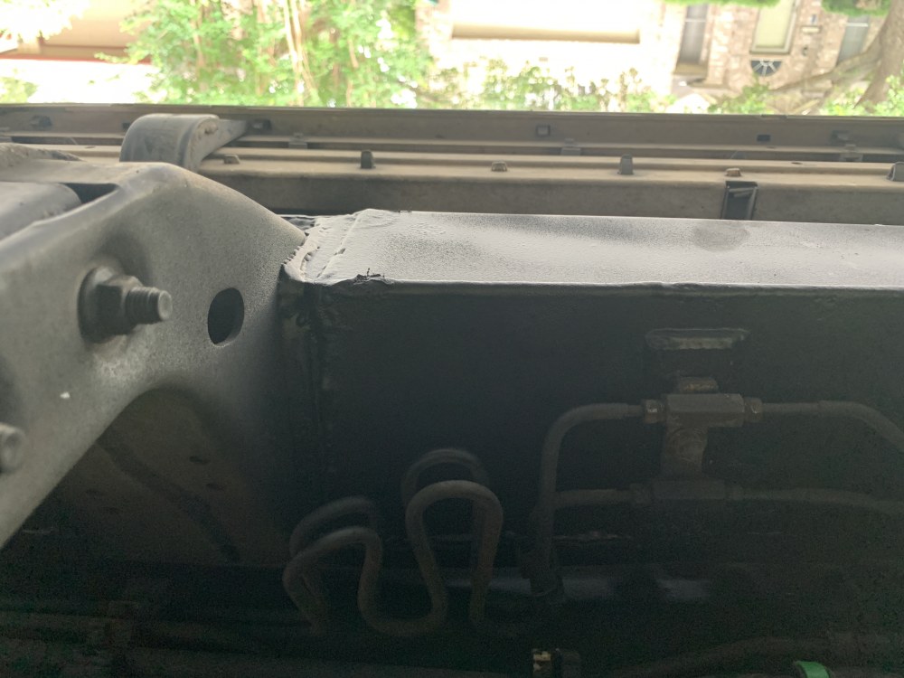

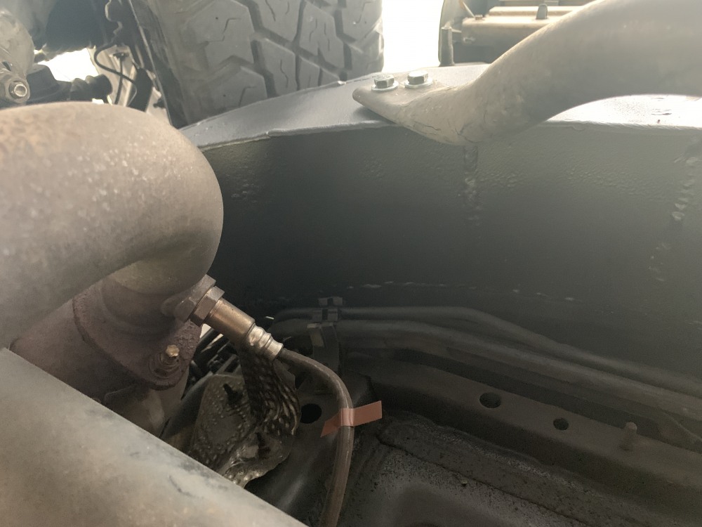

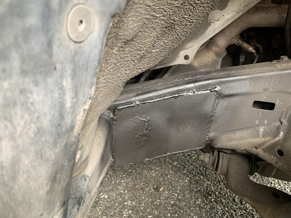

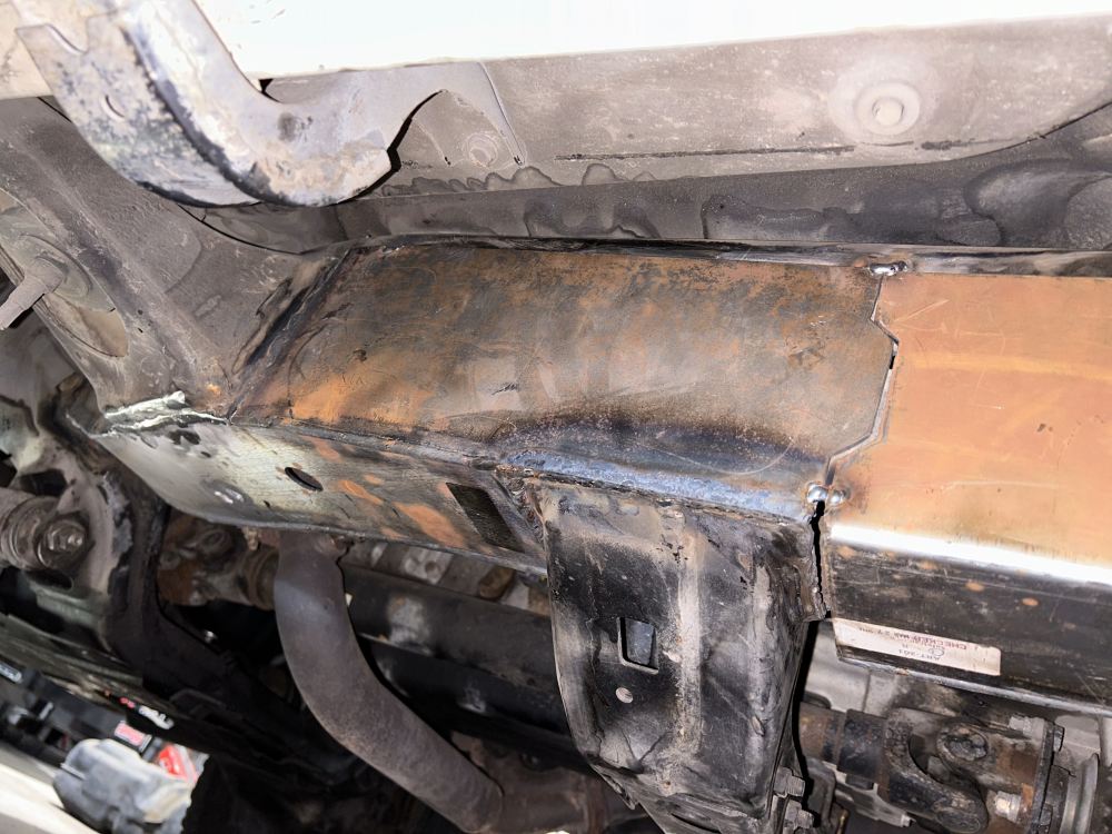

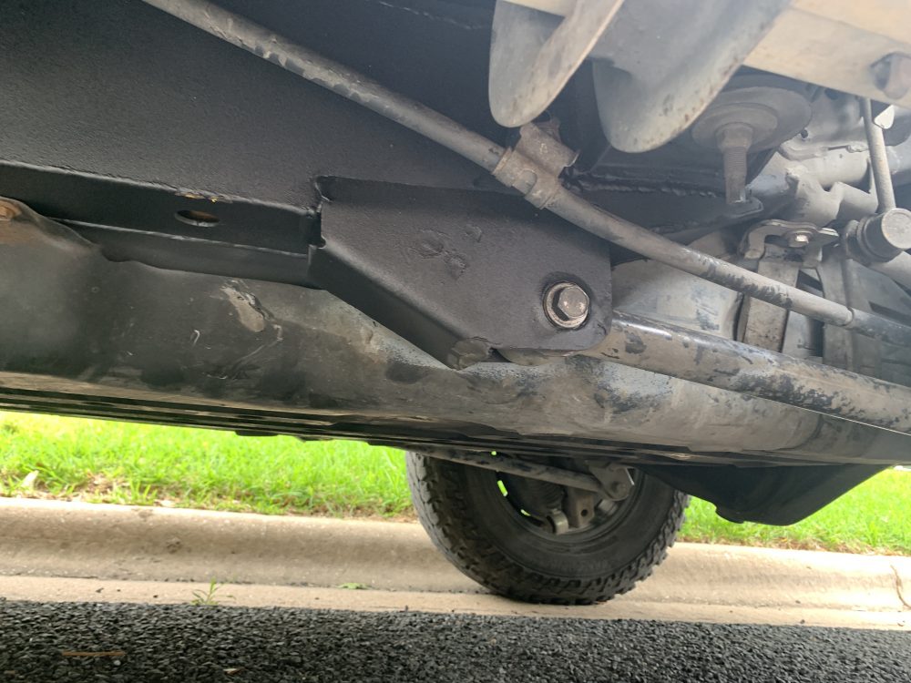

Got it back on 5/13/24 from Krawltex but forgot to update.
Frame is STOUT.

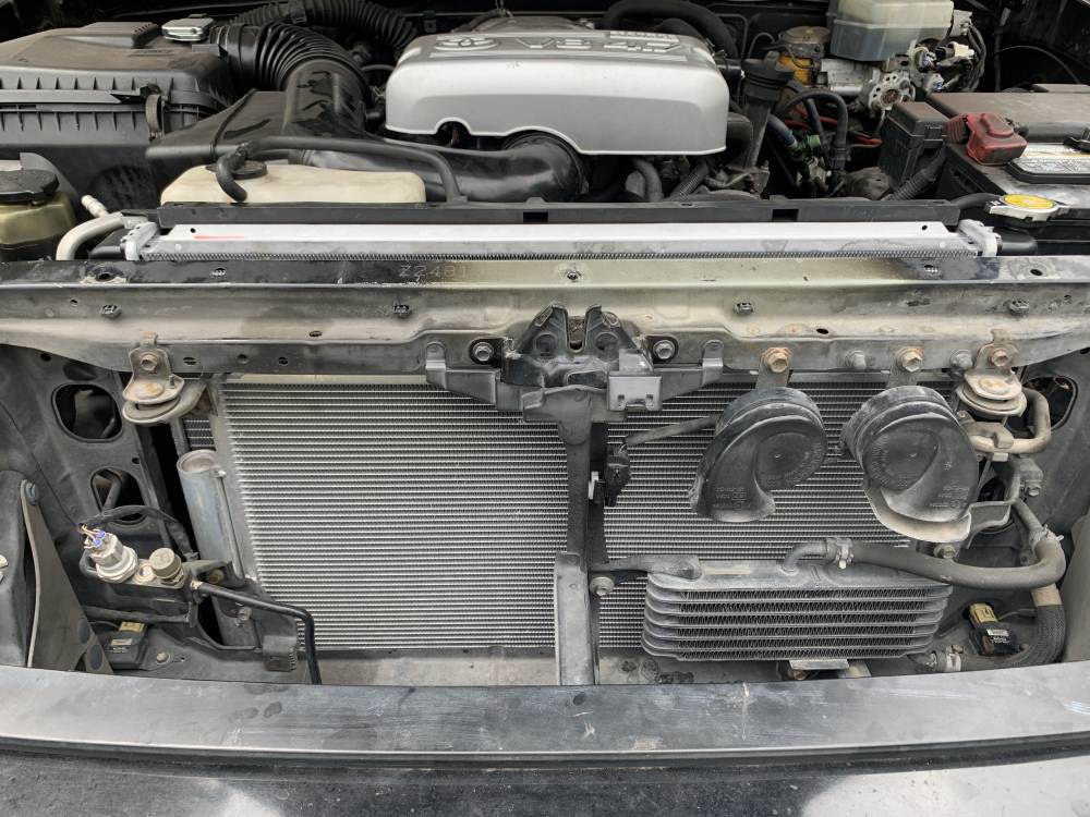

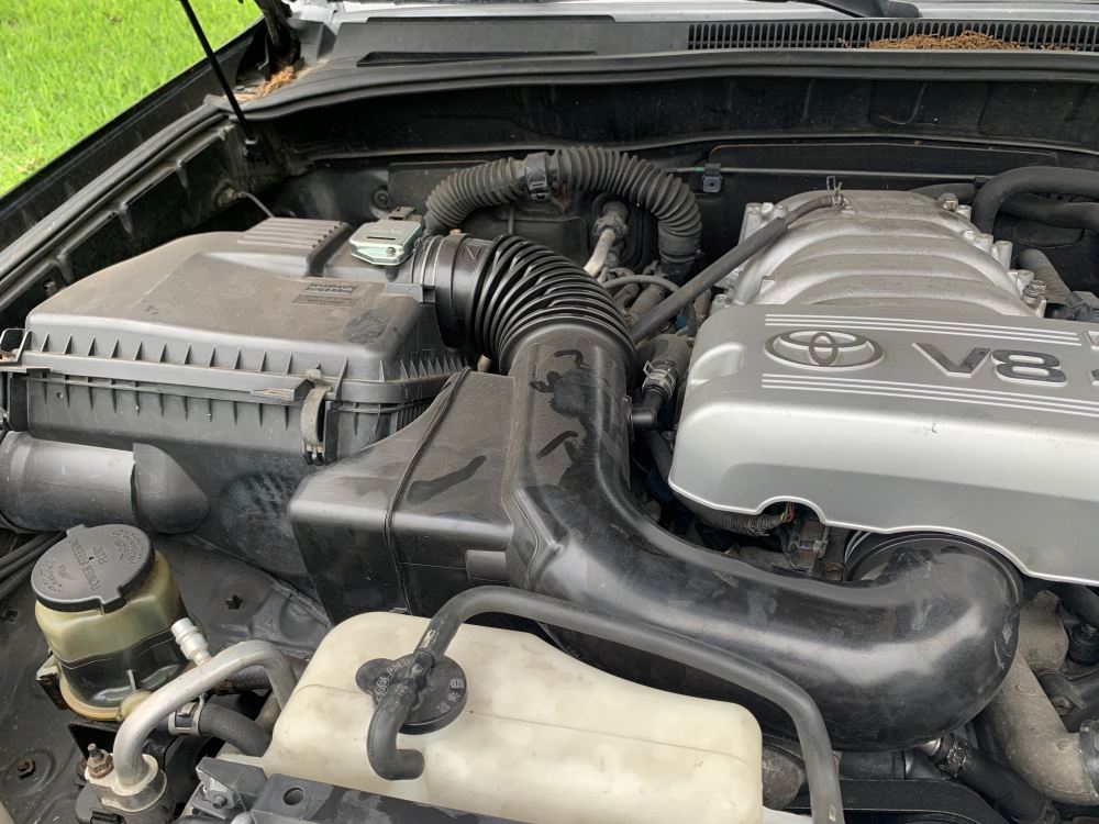

Additional shot of Engine bay because I forgot to post after I added the new intake assembly and new MAF so here they are.

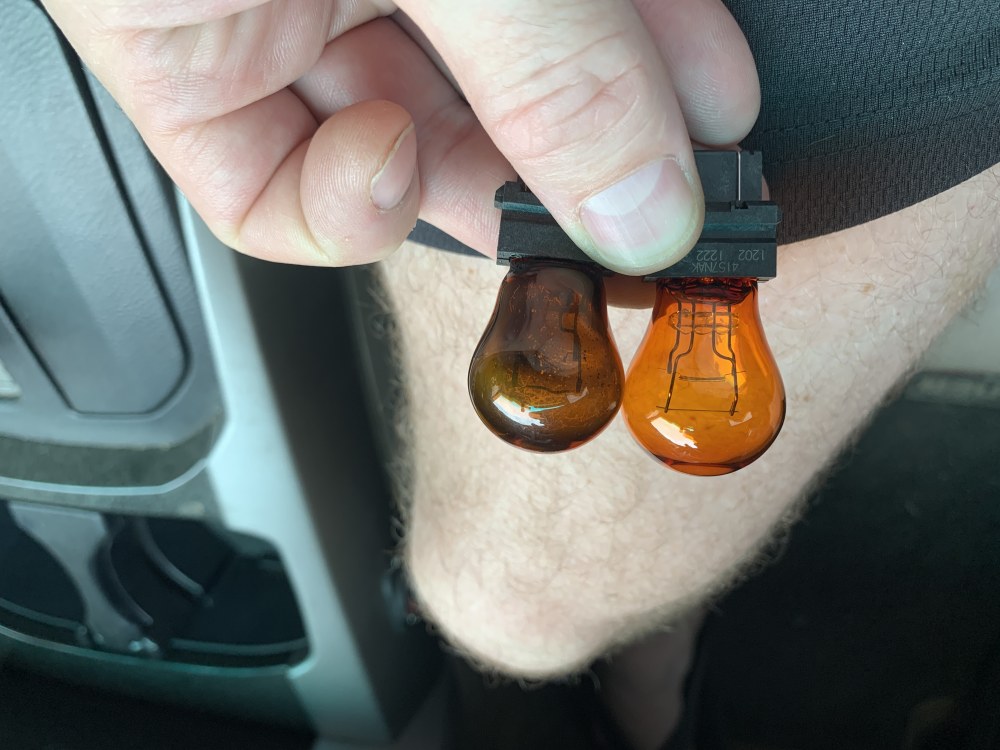

And the passenger front turn signal went out and was causing the fast blink.
So swapped this out too.

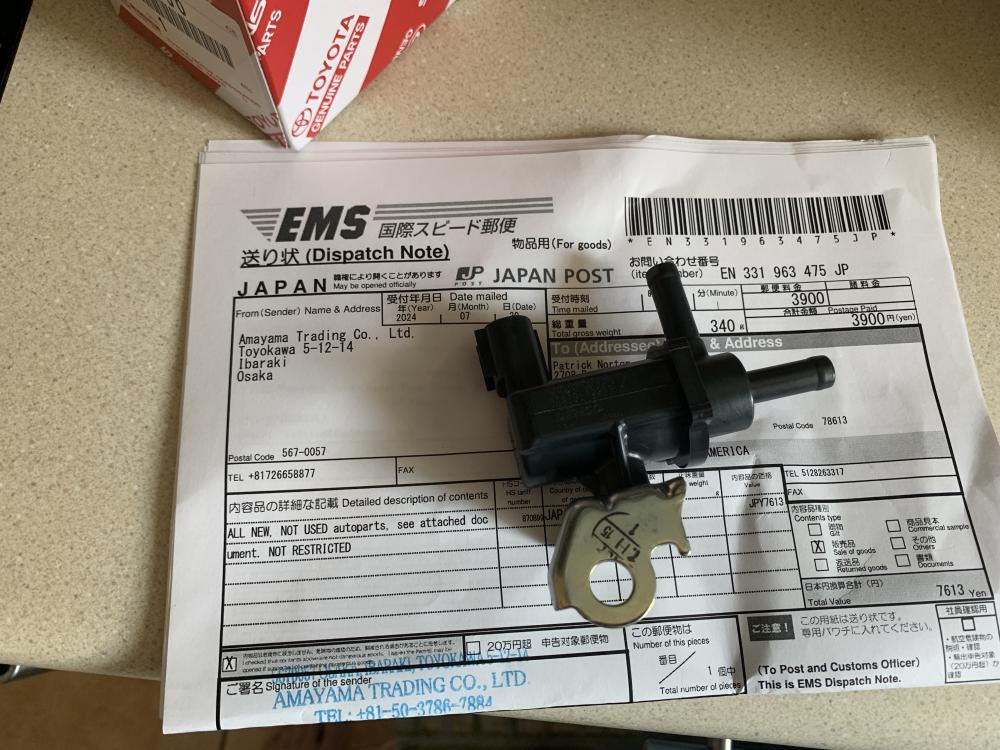

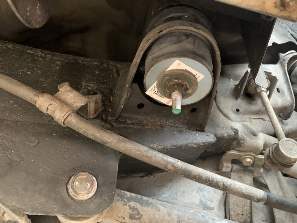

2 super exciting updates:
New gas cap and purge solenoid.
I know.
I'm excited too... :eyebrows:

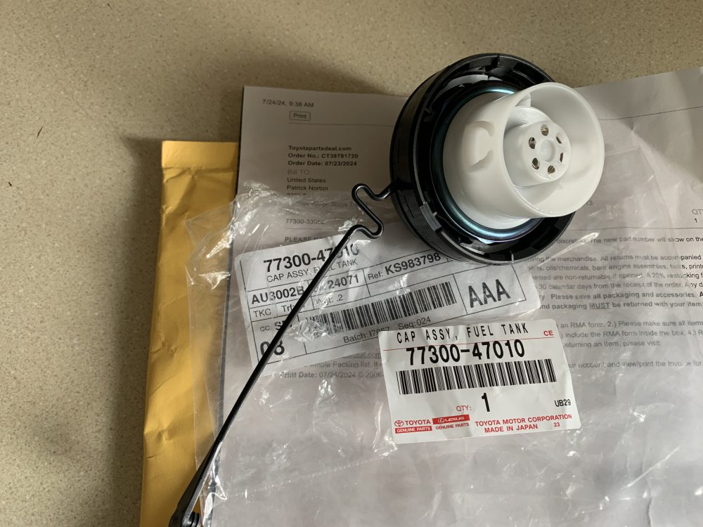

Had a P0442 code and it was just the gas cap, but I had already ordered the solenoid so on it goes.

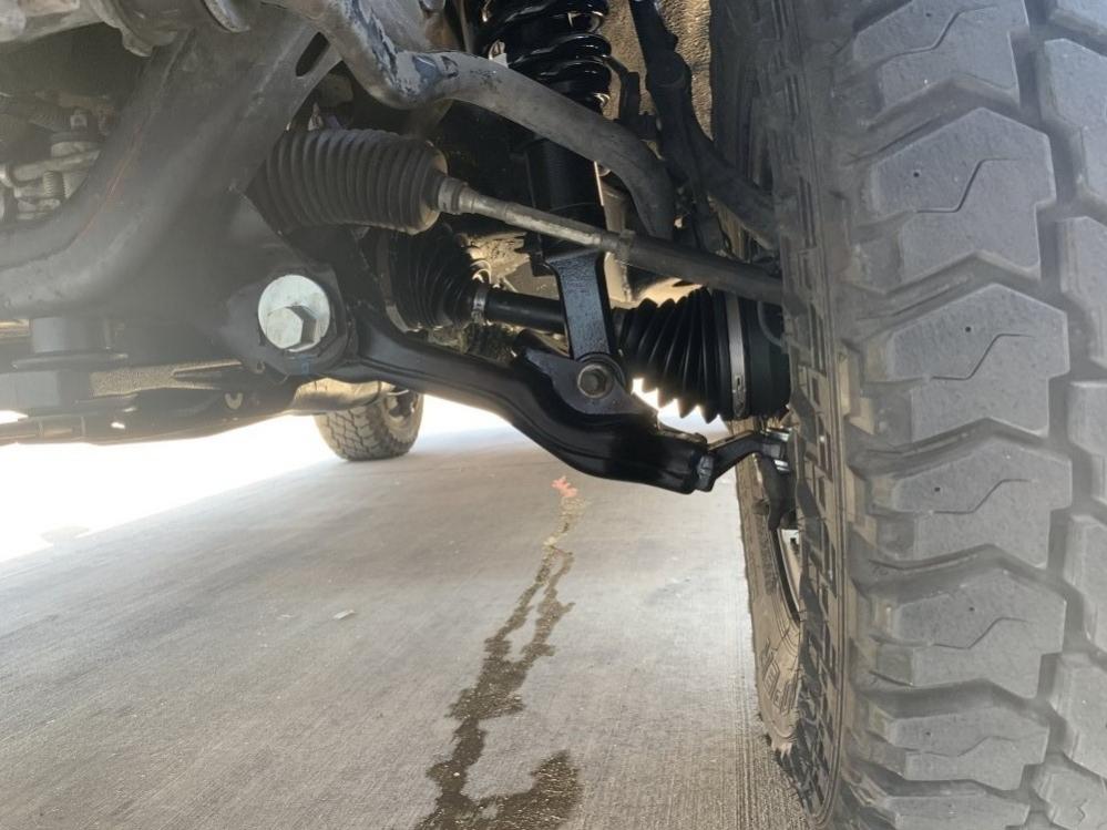

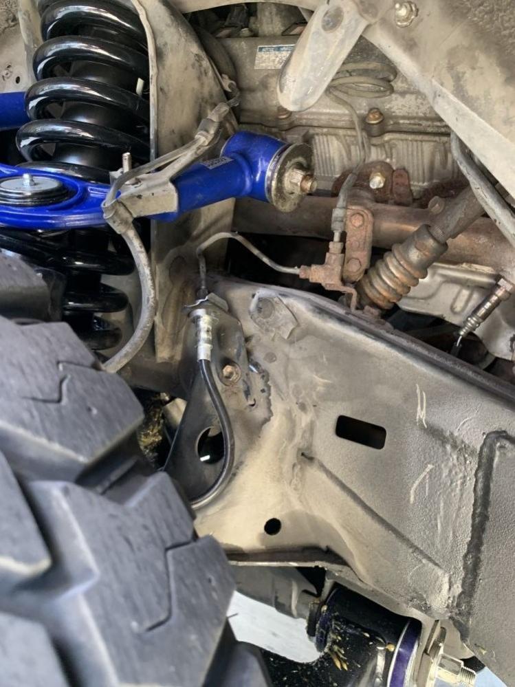

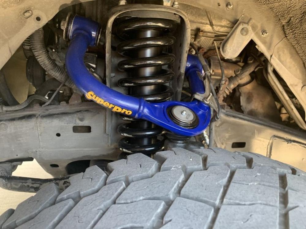

Got most of the front end redone....
8/9/2024
216,253
Powerstop Front Pads & Rotors - Amazon
Powerstop Rear Pads & Rotors - Amazon
VastAuto Hub Grease Caps - Amazon
Detroit Driver Front Wheel Bearing - Amazon
Geometry Correction UCAs - SuperPro
LCA Kit - SuperPro
Sway bar Drop - Amazon
Dobinsons 1-3.5" IMS Coilovers (+100lbs/black) - Exit Offroad
Dobinsons C59-675V Variable Long travel coils (black) - Exit Offroad
Dobinsons IMS59-50701 Shocks - Exit Offroad
Extended Stainless Kevlar Teflon (maybe some Unobtanium too) Brake lines Front & Rear (smoked black) - YotaMafia
OEM 5th Gen CV Axles (43430-60082) - Joe Joe
OEM Differential Mounts lower x2 - Partsourq
OEM Differential Mounts upper x2 - Partsourq
OEM Support assy front diff (5238060012) - Partsourq
OEM Support assy front diff (5238060021) - Partsourq
Alignment and install of above parts - Krawltex Motorsports
I opted for the 3.5" setting and extra 100lbs because I have a winch & bumper planned ... but it is sitting too high.
I get some nice vibrations under acceleration and when turning.
So, I think I will try to lower the front this weekend about 1" to let it settle in.
After the winch/bumper I will adjust it back up if need be.
Before the Dobinsons My front measurements were ~22" hub center to fender and rear was ~23".
Now they are all around 24".

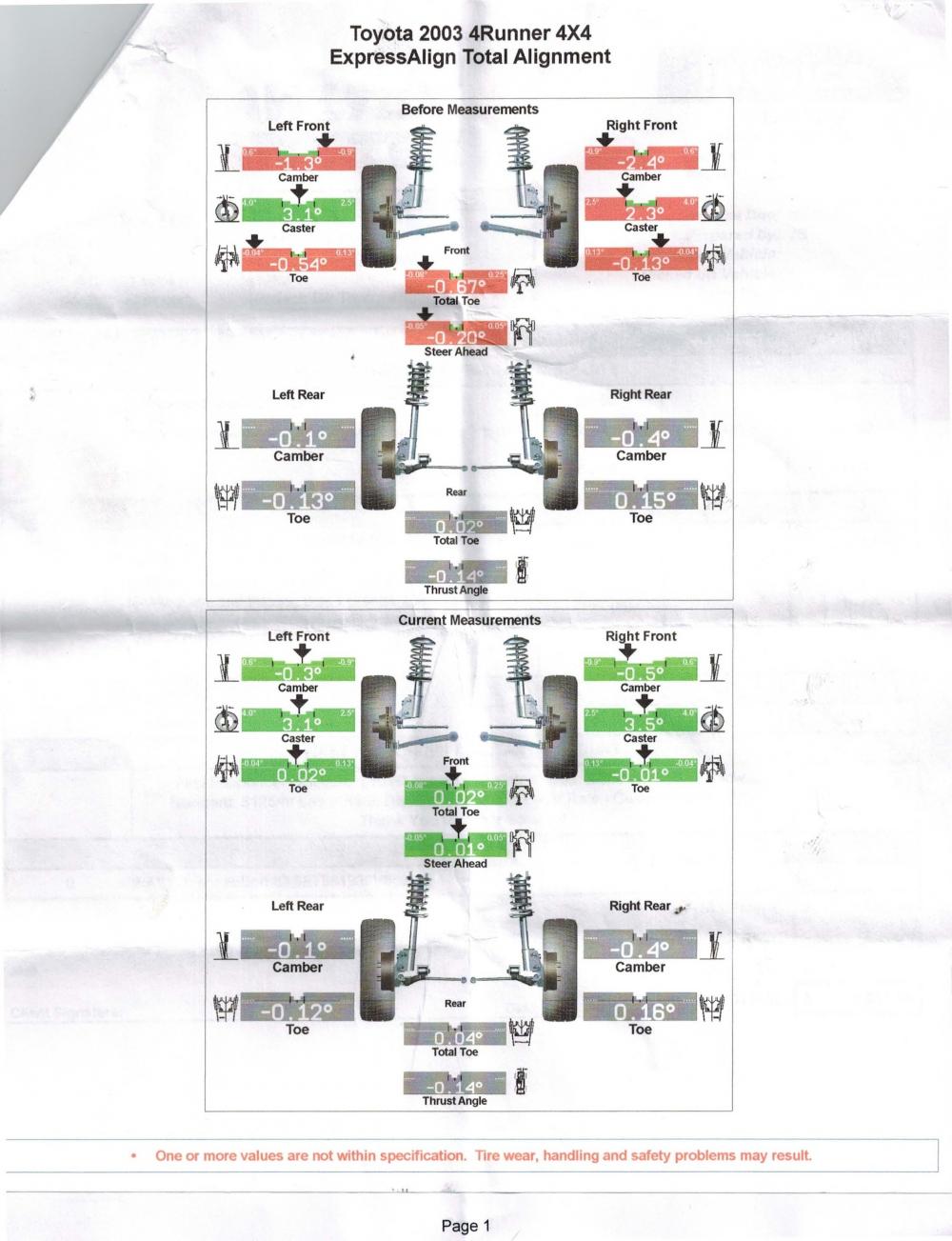

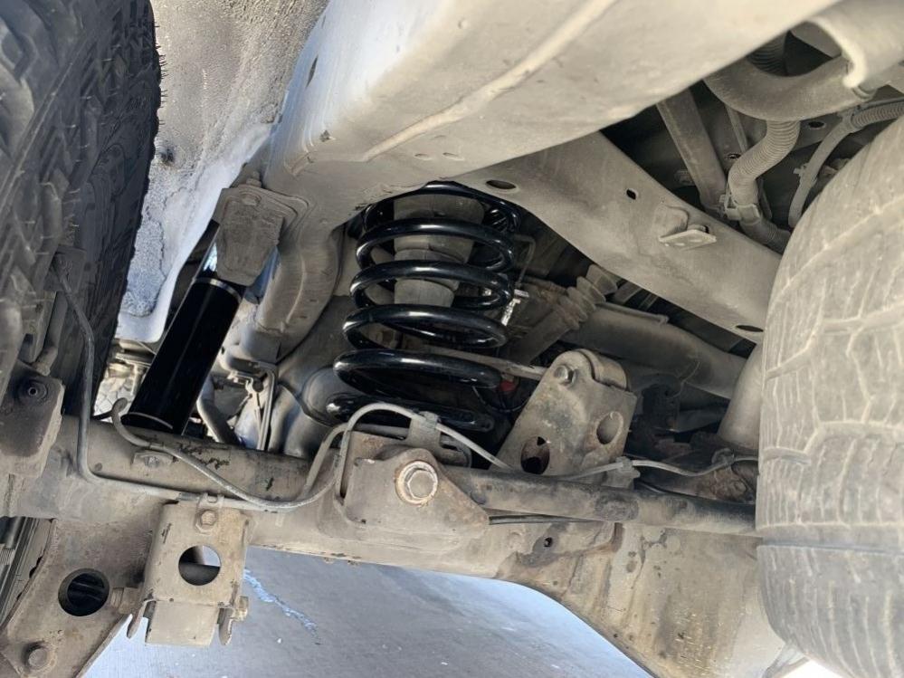

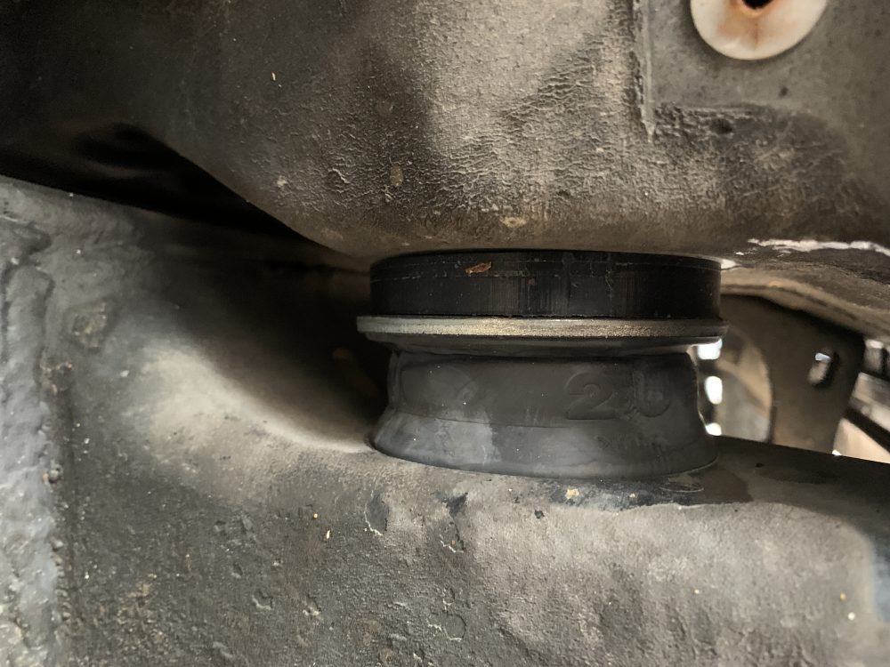

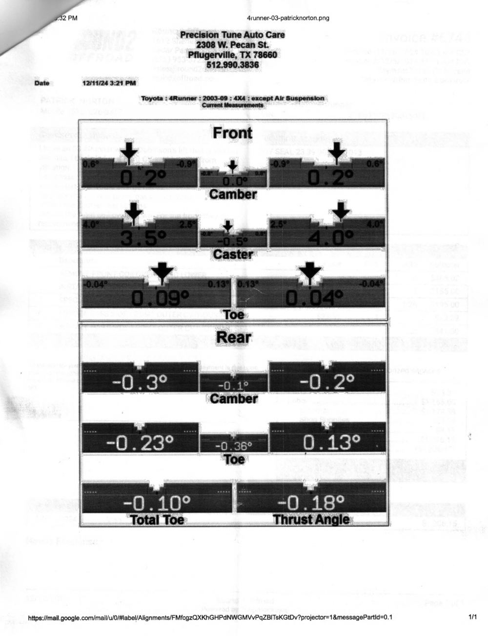

I added shorter rear springs (Dobinsons C59-325 Rear Coils ) and lowered the front quite a bit.
No more vibrations and rides great.
Based on my measurements the front is at around 3.5" and the rear around 2.5".
I do a have a slight driver side lean like everyone else.
So I may grab a shim for the rear to help with that.

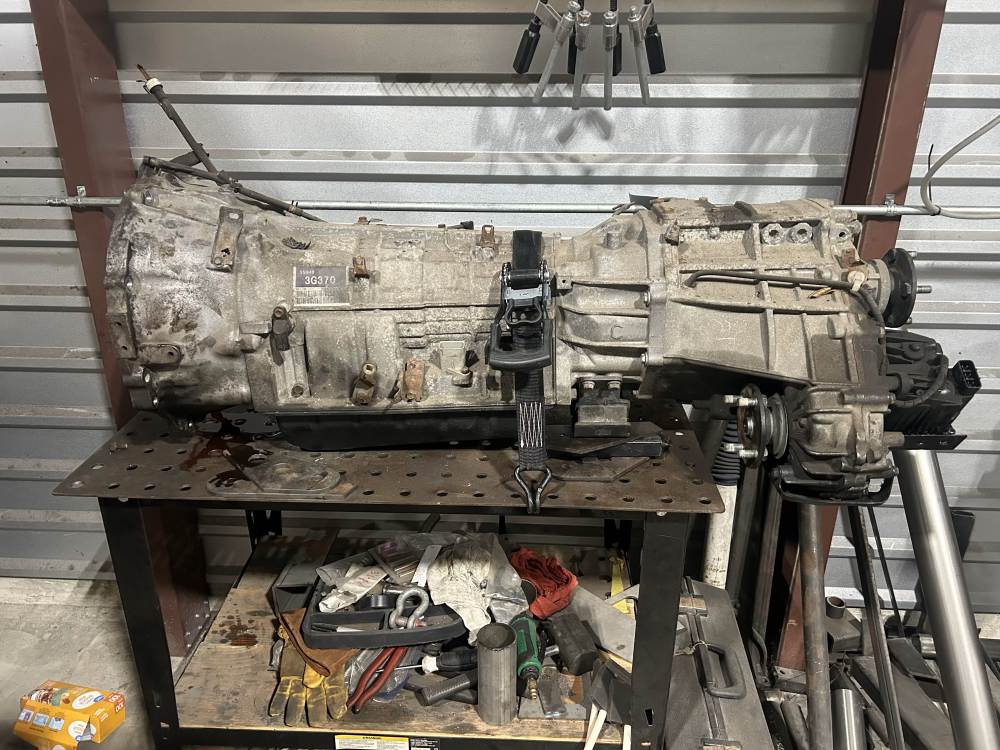

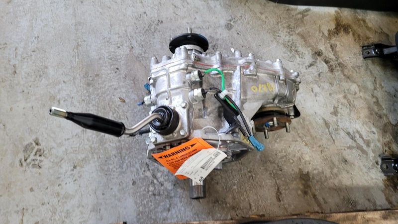

Next step is going to be a manual t-case swap.

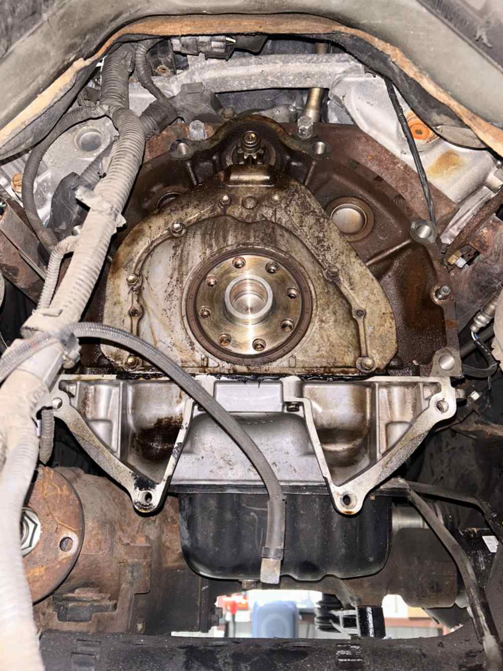

My actuator is leaking and I have a little rear main seal leak.
So while we are doing the t-case we will so the rear main seal, torque convertor seal & transmission mount. Will probably do new driveshafts as well unless I can get a deal on getting mine re-tubed.
Case has been sourced and it only had 30K on it.
So hoping to get that going this week.
After that it should be mechanically sound and I can start messing with creature comforts. Stereo, dash, seats, lights, exhaust, etc. Probably will do sliders and a front bumper too. Not saying it won't be "more capable" than now down the road but first things first.

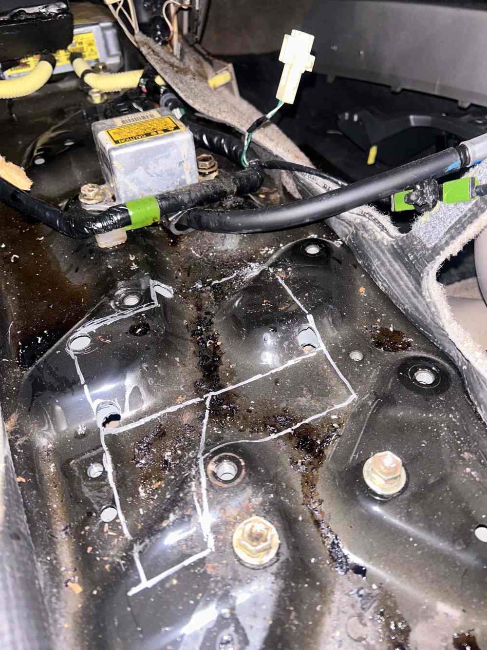

On 2/14 my Daily Driver was totaled in a grocery store parking lot incident. Kid came out of nowhere and crashed into me. So the 4Runner has become my main transportation. Luckily I work from home! BUt ..this means all the things I have been putting off have gone into express mode.
I had already asked the dealer to clear the drain lines but something wasn't right. hopefully this helps ... right?

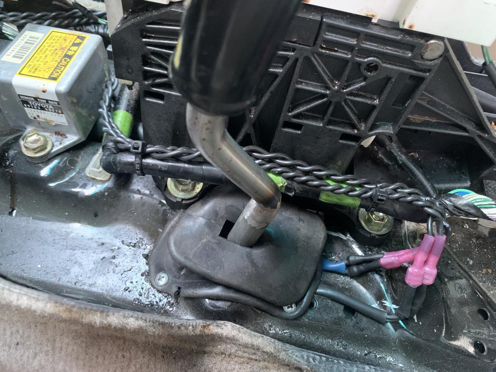

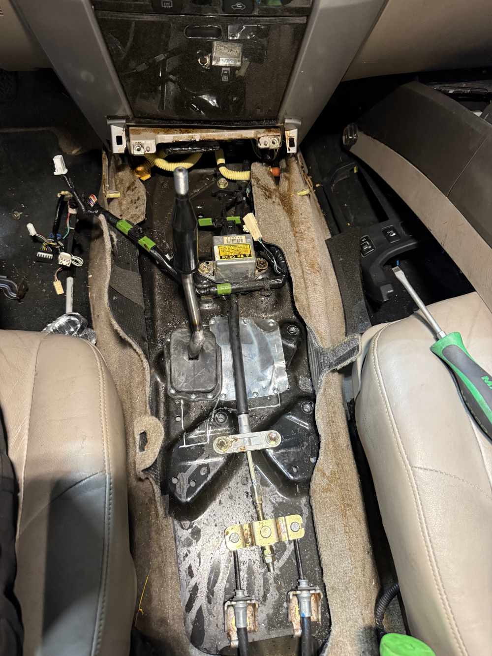

2/28/25 Update

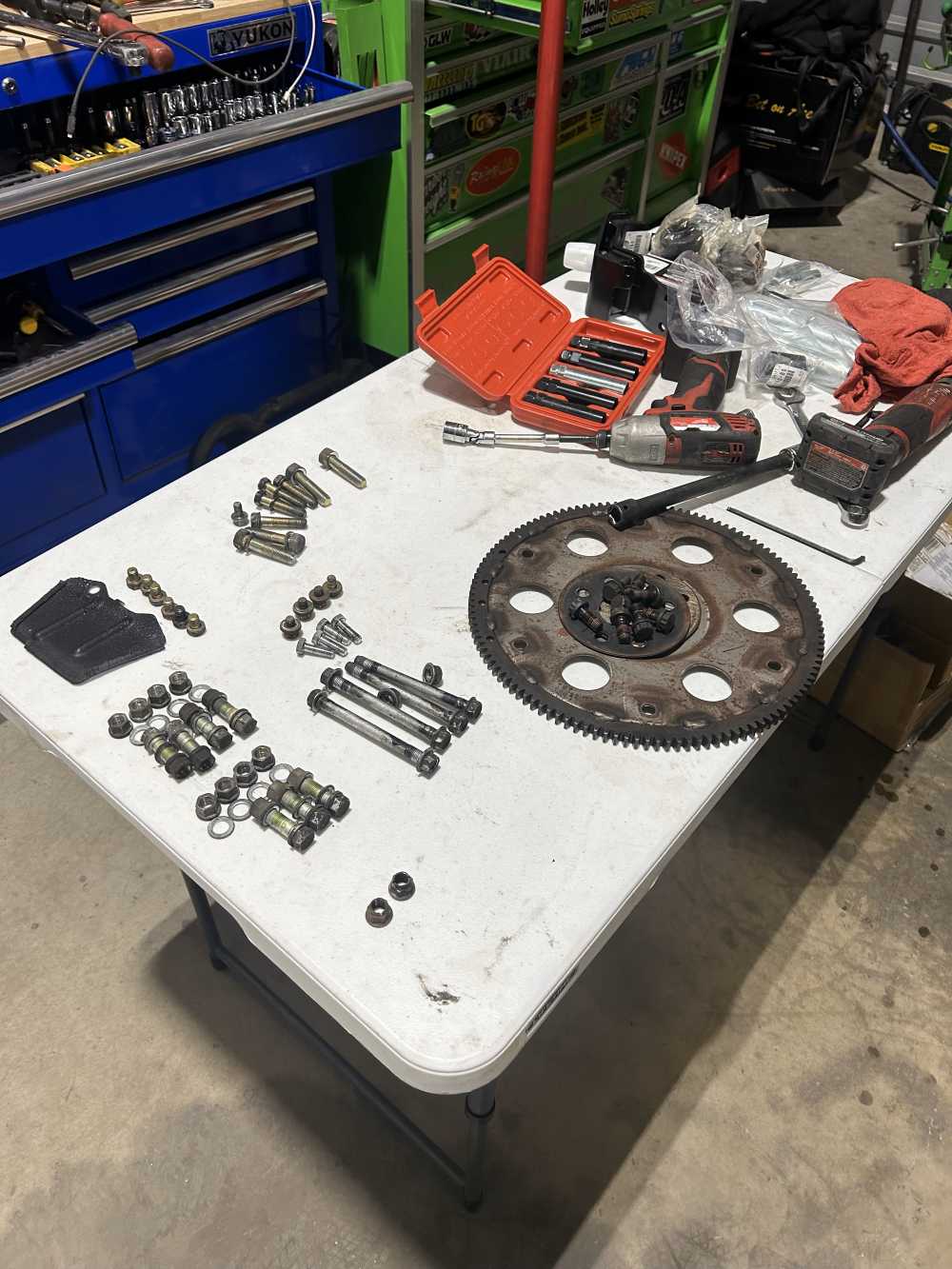

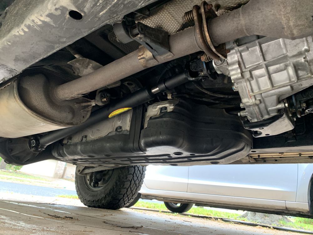

Runner was with Krawltex getting the manual T-case slapped in.
I know it isn't "that difficult" to bolt in, but I no longer have access to a welder to modify the shifter. The rear main seal was also leaking so they replaced that. I also had them replace ALL the body mounts with OEM parts and do a 1/2" body lift to help with the shifter fab.
They also ordered & put in new driveshafts from Tom Woods.
So this was just a little more work than I wanted to do in the driveway to then drive it to them for just the shifter fab. Anyway.... photo dump and please don't judge me on how nasty it was....I already cleaned it up!

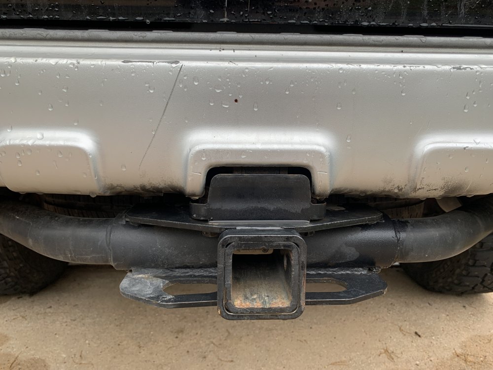

More from 2/28.
The body lift is really only noticeable at the hitch and so slight that I'm the only one that will probably see it.
Might try to remedy that when I modify the hitch for a bigger spare time.
FYI, the front driveshaft would have fit but since everything has over 200K on it I went ahead and replaced it.
