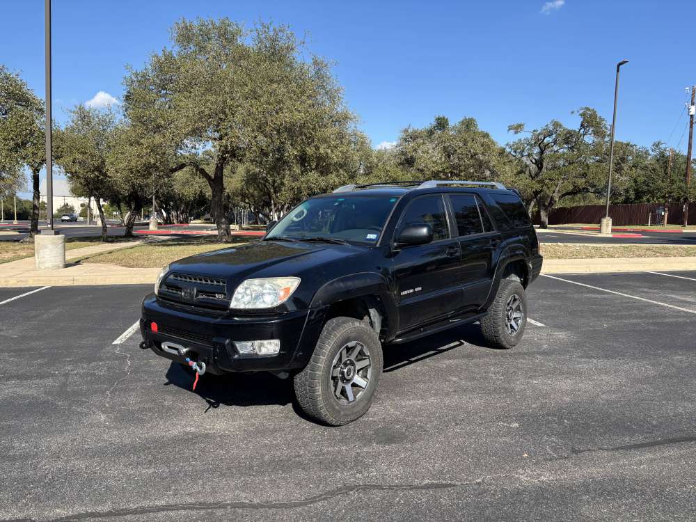

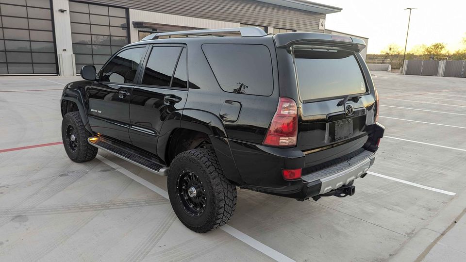

Build highlights as of 3/31/2025
2003
Part Time 4WD (Manual T-case swap)
V8
Limited
LB42 Leather
220,000 miles
Dobinsons 1-3.5" IMS Coilovers (+100lbs/black)
Dobinsons C59-325 coils (black)
Dobinsons IMS59-50701 Shocks
1/2" Body Lift
Extended brake lines
265/70 R17 Kenda Klever ATs
Toyota 17" Wheels
5th Gen Rear Axle locked
5th Gen Front Brakes
Lost Trails Hidden Winch Bumper
8K Vevor winch

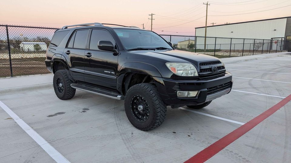

Current Pic:
417964d1778701252-locked-ups-4runner-img_9333-jpg

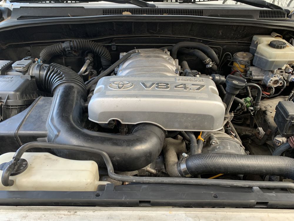

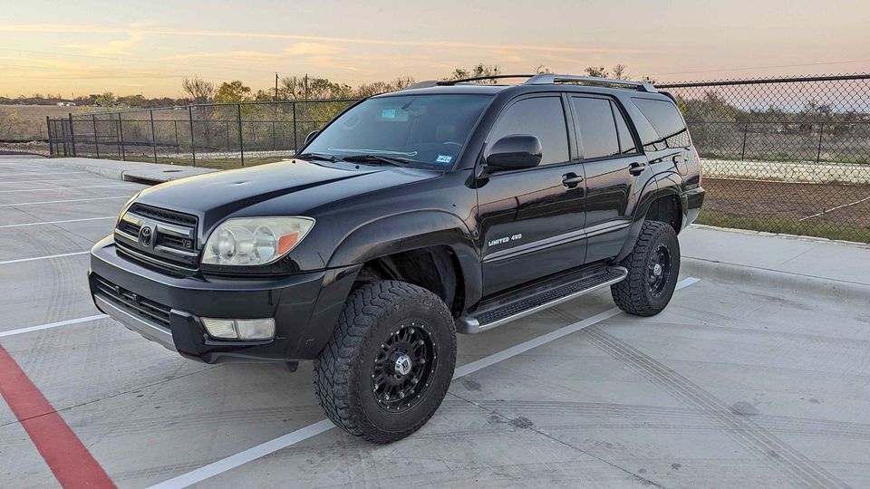

I picked this up a couple of days ago (December '23) and it's currently in the shop getting a good once over...
Motor has plenty of power and it drives nice and straight.
Dealer said "The PO said they did timing belt and water pump" ... but no sticker so I will redo it all.

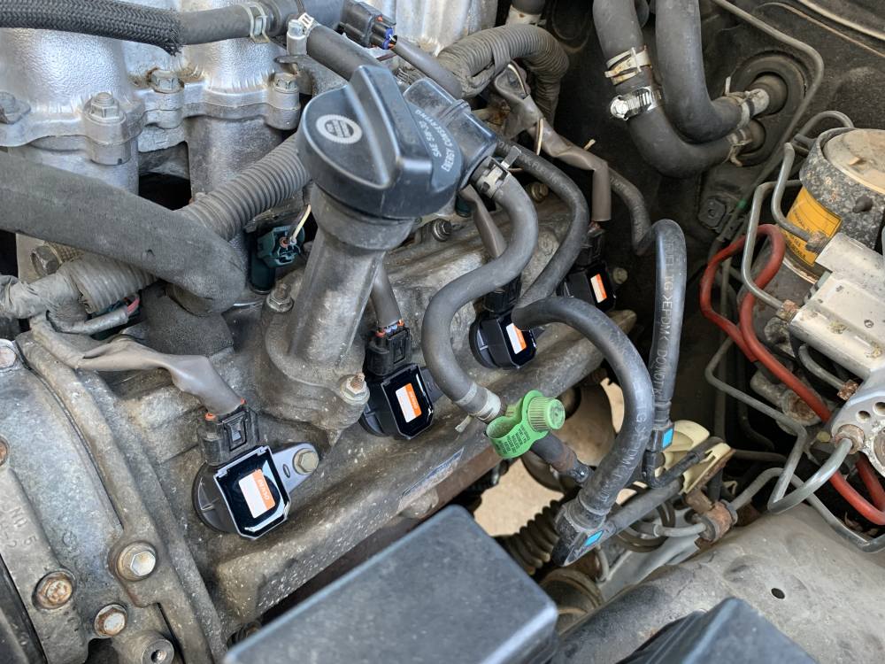

Known issues are the 4wd actuator, bad fan clutch & a cracked coil pack.
There is also a small section of the frame we need to address for rust but it's nothing like the horror stories I have seen on youtube.
Shop seems to think they can easily cut out the bad spots and plate them.
Hopefully they don't find much more so I can get this on the road and get rid of my Jeep. ;)
Plans:
Fix EVERYTHING noted above.
The front seems a little stiff so may investigate swapping something else in.
There are dents and dings that I am going to try to correct or at least minimize.
Might repaint/recolor it as well.... the black is sexy and all but it's hawt here in TX.
If I don't do a color change I might just do a white roof to reflect that sun!
If I keep the black I may look for some of the newer Limited wheels.
I generally like black wheels on white/silver vehicles and shiny metal on black/dark blue.
I will need to refurbish headlights so I may crack them open and convert to something brighter.
Grill needs some love. Emblems were plasti-dipped. Not sure if I like it.
On the inside I also want to replace the dash so will probably do a coverlay unless I find a nice one at the 'yard.
I am also going to look at replacement carpet, refurbishing the leather and some new floor mats.
Audio is the JBL system but I want something more modern.
I will investigate swapping that out for something touch screen assuming I can keep the steering wheel controls.
May remove the running boards and relocate the lights in them to under the body. We will see if they are necessary for the wife. lol

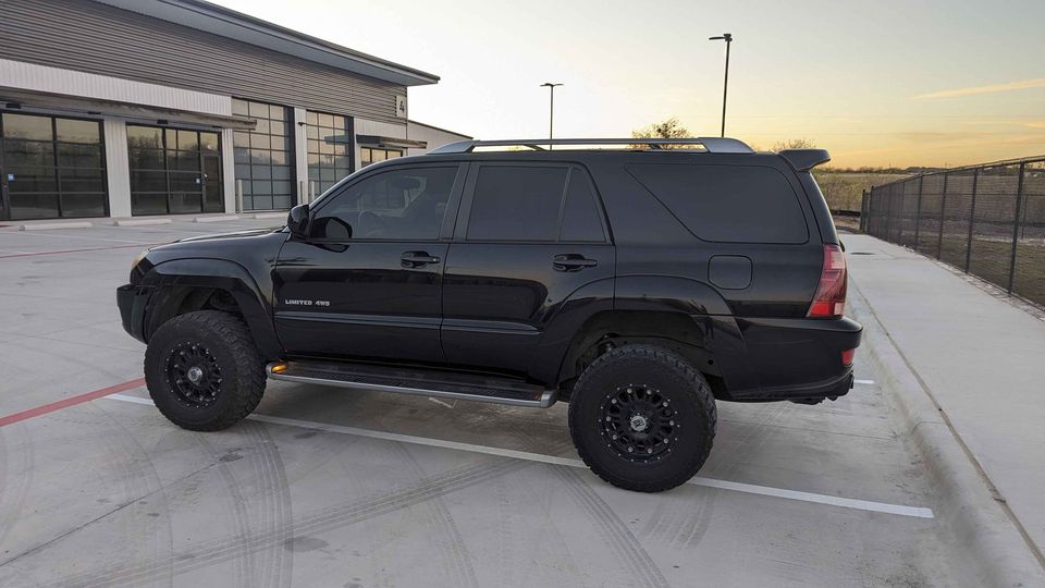

UPDATE:
Truck is done with the initial inspection.
Will have the shop mess with the AC Condenser because I don't have those tools.

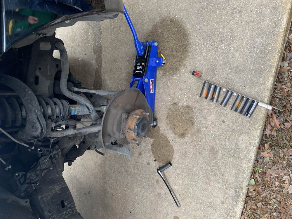

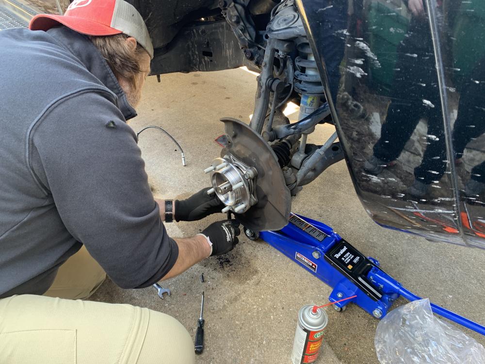

Got a few things to sort out myself once I get it back and up first on my DIY list is a wheel bearing.
Truck has a slight pull to one side under heavy braking and the passenger side bearing is to blame.
I've changed out plenty of unit bearings in my Jeep XJ/YJ/TJ days so I feel like this is a project I an handle.
I came across this wheel bearing and ordered it:
Amazon.com
Arrives on the 9th supposedly.
As much as I am a fan of OEM parts, the prices on them are bonkers ... about $500 for both the bearing and hub then I'd need to press together!
I'm opting for a complete unit because I want nothing to do with what I say Eric the car guy go though!
2005 Toyota 4Runner Front Axle, Wheel Bearing, & Hub Replacement -EricTheCarGuy - YouTube
I did see some options on rock auto for just the bearing but this saves me a trip to get things pressed out/in and I should be able to do it all in one swoop.
This one has some mixed reviews so I called Detroit Axle directly and they confirmed that price is correct and the store is actually theirs and not a knock off (although the part may come from China). I also suspect that (based on the photos) the people that had failures have 2wd trucks and didn't realize the stub axle is required to hold it all together on a 4wd unit. That is a lesson I learned the hard way in one of my Cherokees as a young lad when we pulled a shaft to limp it home after some front end problems.
All information here is cross posted over here:
Locked Up's 4Runner | Toyota 4Runner Forum [4Runners.com]
Just in case ;)

OEM Coil Pack - (90919-02230) Tom Wood Toyota
1/30/24
215,473
Detroit Pass front Wheel Bearing - Amazon
Denso Coil Packs - (6731303) Rock Auto x7

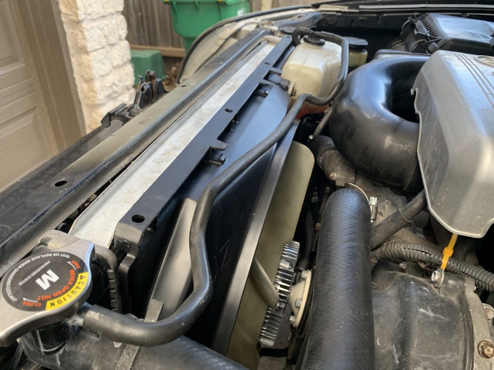

OEM Radiator Shroud - (16711-50170) Joe Joe Toyota Parts
OEM Fan Clutch - (1621050090) Tom Wood Toyota

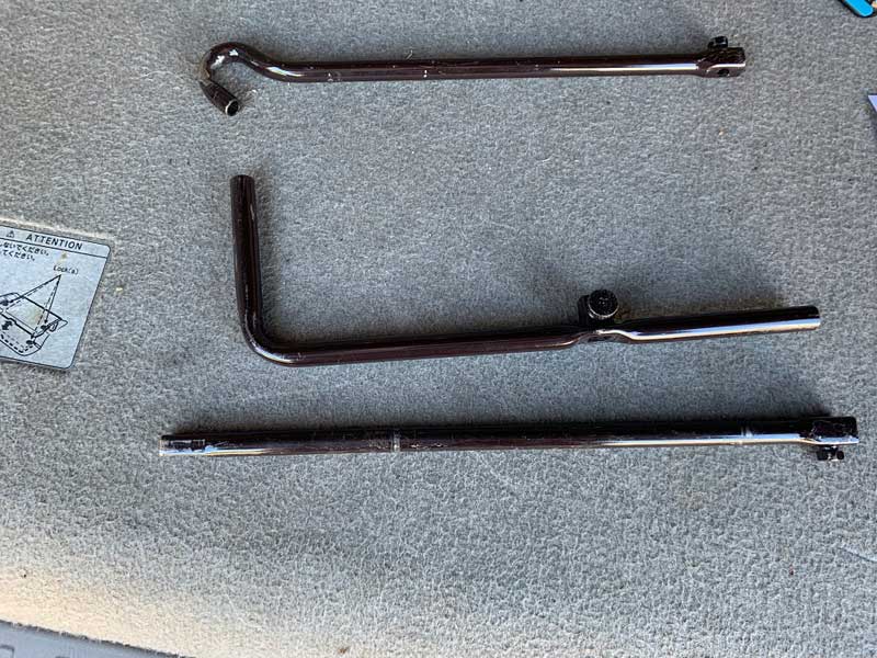

New Spare tire changing tools
Amazon

New Radiator & Cap

The bearing topic has been talked about many times and I think you commented on one thread with good info recently. A couple years ago you could get a hub assembly with a quality Japanese bearing from Rock Auto, you could see it stamped on the bearing in the pictures. Those seem to no longer be available. Personally, I'd prefer a quality bearing and either have it pressed on or do it myself with my cheapo HF press. Just no telling how long a China bearing will last. If you must go that route then maybe buy somewhere local with a lifetime guarantee so you can easily claim it.
As far as that ETCG video, that's pretty nuts for a supposed pro. I pressed mine out which made it separate from the race then cut the race with a dremel and slid it off the hub. Stuck the parts in the freezer which made pressing the new bearing onto the old hub pretty easy.

Today's plans were a new coil pack, new fan clutch, new wheel bearing and new 02 sensor...
I started with the 02 sensor and with the right tool, that was pretty easy.
Access was easy for me since it's lifted and there isn't wheel well liner there.
I highly recommend this tool if you are doing an O2 sensor:
<a target="_blank" href="https://www.amazon.com/gp/product/B004FEN9JG/ref=ppx_yo_dt_b_asin_title_o04_s00?ie=UTF8&psc=1&_encoding=UTF8&tag=lockeduprc-20&linkCode=ur2&linkId=4f34ba328d70daf0b7baeb2abf5715ec&camp=1789&creative=9325">O2 Sensor Socket on Amazon</a>
Then I started with the coil pack and since I was in there, I checked them all.
Access is very easy on the driver side:
Passenger side requires removal of the air filter housing:
I knew one was cracked but didn't know ALL of them were cracked.
Ugh.
I had help when it was time for the fan clutch and we were able to get it apart and out by pulling the fan shroud at the same time.
Didn't have to take any hoses off!
Unfortunately, it looks like the PO cross threaded one of the studs so it had to come out:
New one on order.
Ugh!
Thankfully since it was out and getting late-ish, we decided to not do the bearing today. That led us to discover some questionable wire routing, which we temp solved with bright ass zip ties. Bright so that I will notice them and they will irritate me so I will order the proper clips! lol

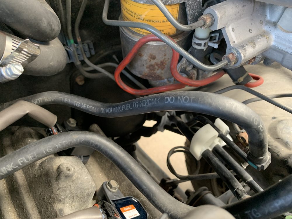

Also, while sitting under the frame checking things out ... I noticed there is something missing.
What is supposed to go in these clips (driverside):
Clips on frame are probably from original suspension system, xreas, which is a good system just very expensive to service and has been replaced by the Bilsteins. I did the same on mine. you may find a metal bracket or two as well on the frame depending on how much of that system was left behind, or not removed. That system had hydraulic lines running from front to rear for the shocks and those plastic clips held the lines.

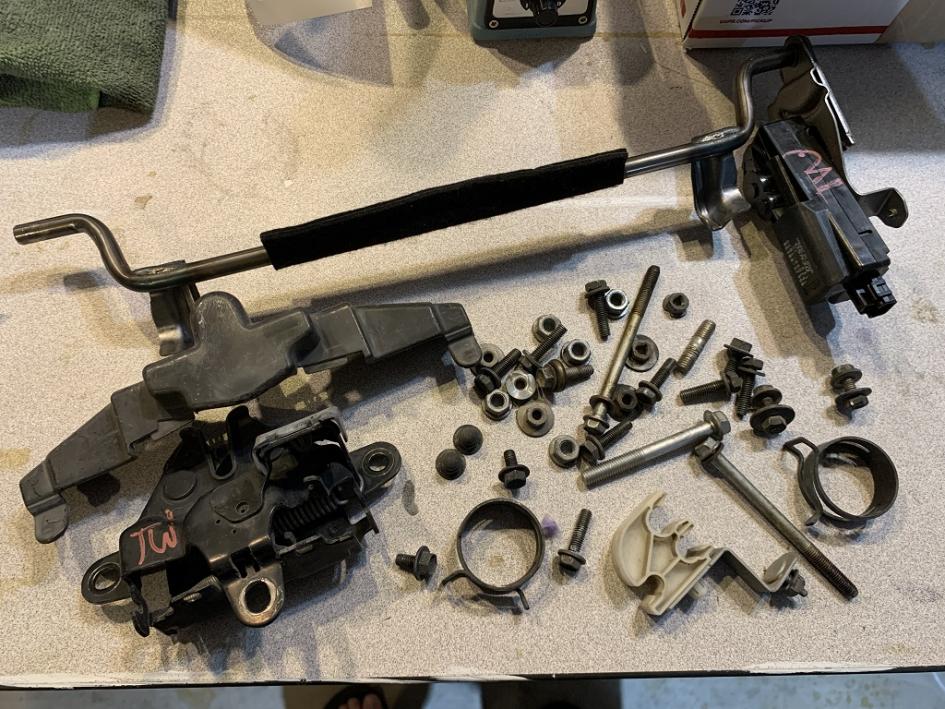

Scored a few smaller items at the 'yard because the two 4Runners there were picked pretty clean!
Found hood release & cover, lumbar assembly, 1 fuel/evap clip, fan clutch stud and a bunch of misc clamps nuts & bolts. The hardware is to replace a few things I have but that aren't in great shape.
Couldn't find the radiator cover, radiator shroud nuts & bolts, spare tire tools and one fuel/evap clip. Hope I can find those elsewhere.
Well the hood latch assembly has some sort of sensor built into it. Must be a limited thing. No way to remove the sensor from mine and add it to the new one without breaking them apart. I was only swapping it out to clean things up a little, so I ended up wire wheeling it and hitting it with some paint.
The larger project I got done was the wheel bearing which went really smoothly. I did see that the PO had replaced this before because they poked a hole in the disc shaped cover trying to get it off. So I massaged it back to close the hole as much as I could and slopped some RTV on the hole. Meh.

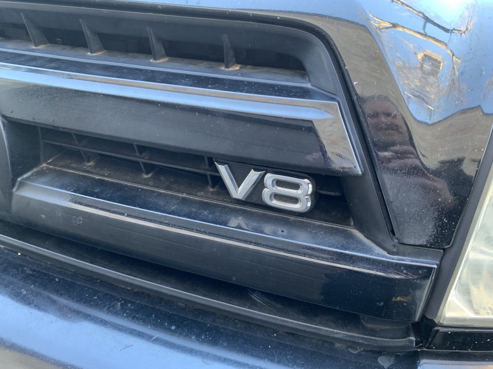

I also removed the plastidip from the V8 Emblem.
I'm not a chrome fan but the total black murdered out look isn't me either.

Also got the new fan clutch & shroud in.
PO had said it ran a little hot on long trips. I have not experienced that but also it's winter and I have not driven far.
I'm wondering if it has/had to do with the aftermarket radiator or cap? Maybe it had to do with the AC Condensor leaking (as in maybe it was running constantly?). That was changed out so I guess time will tell. Considering going back to OEM for the Radiator & cap and doing the thermostat with it. Just to be sure.
