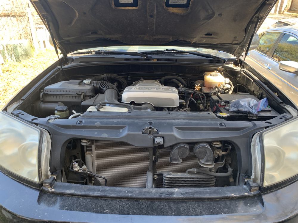

BIG 3/19 update.:heh:

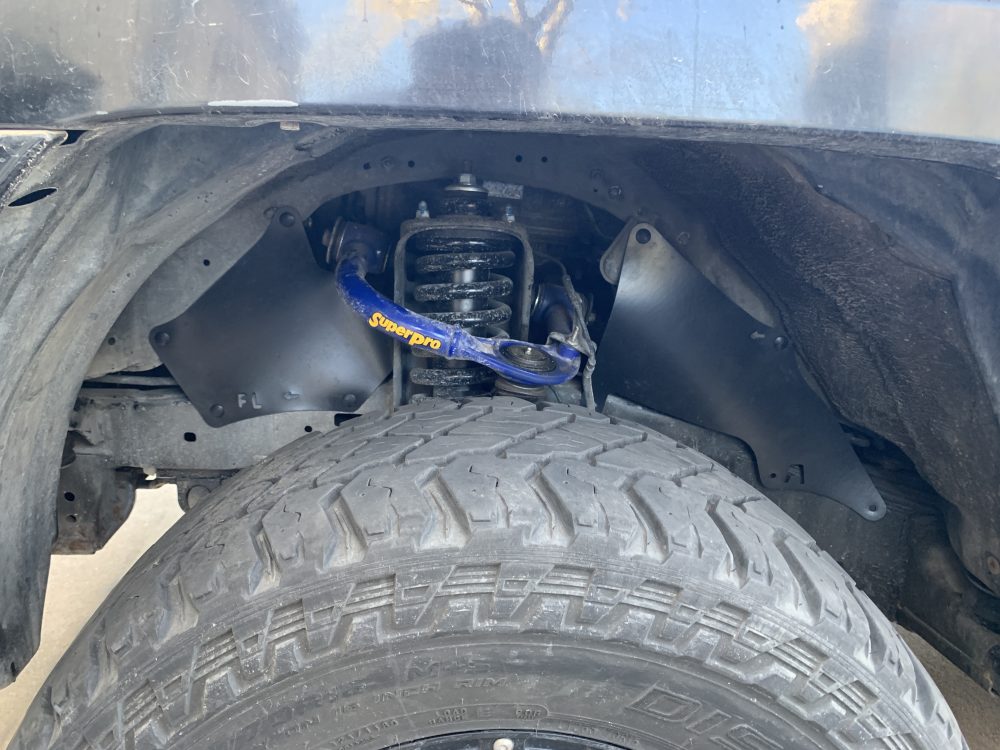

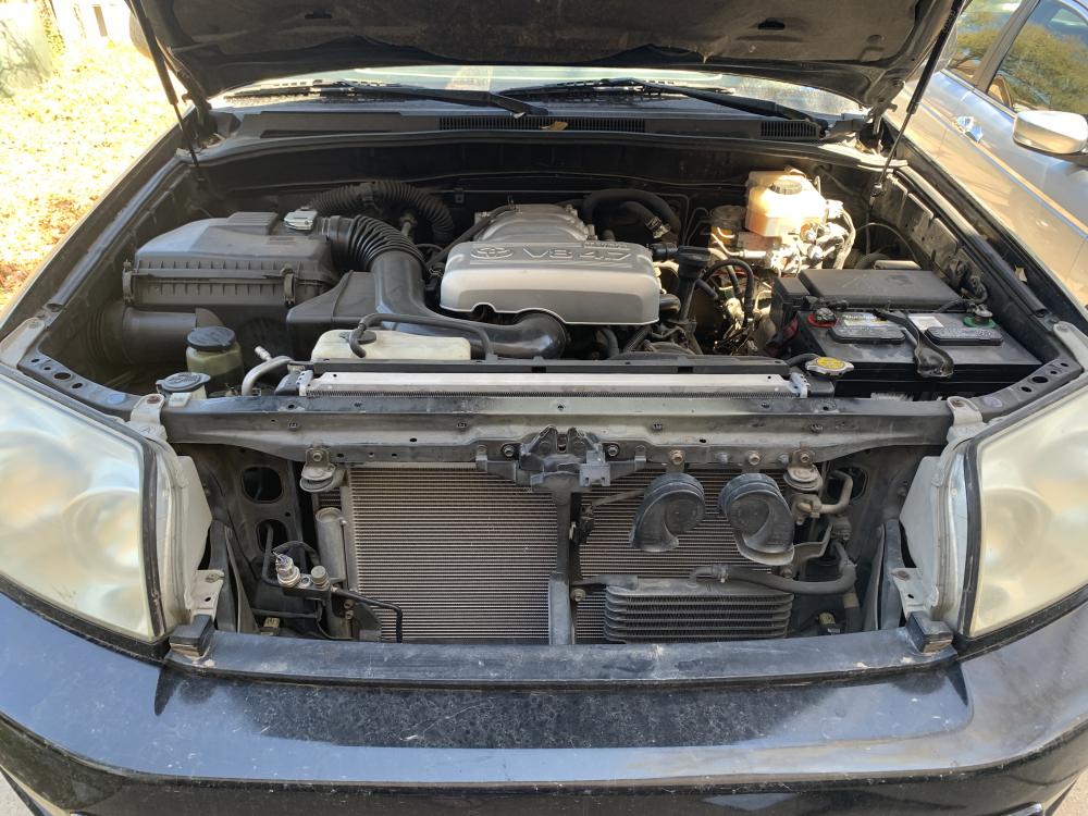

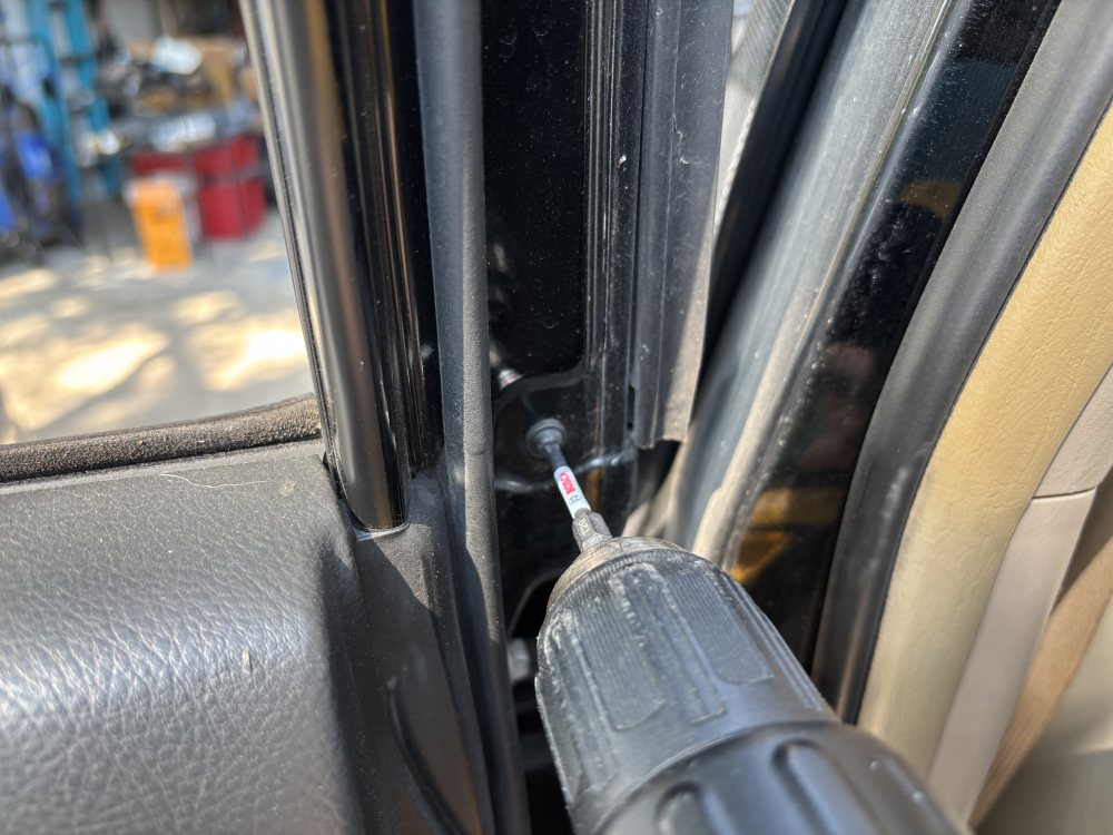

Just added the front covers for the engine bay to clean it up a little.

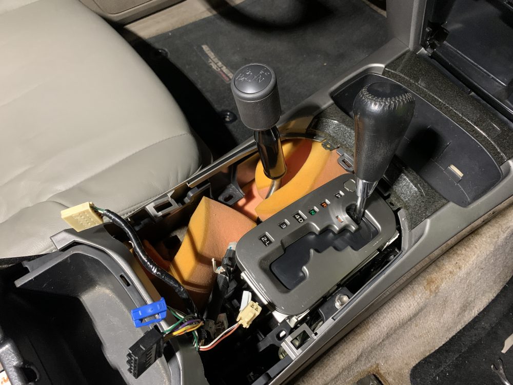

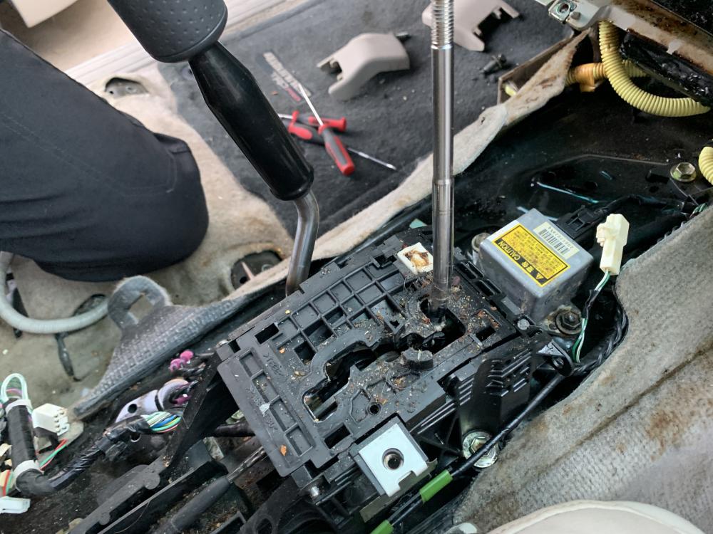

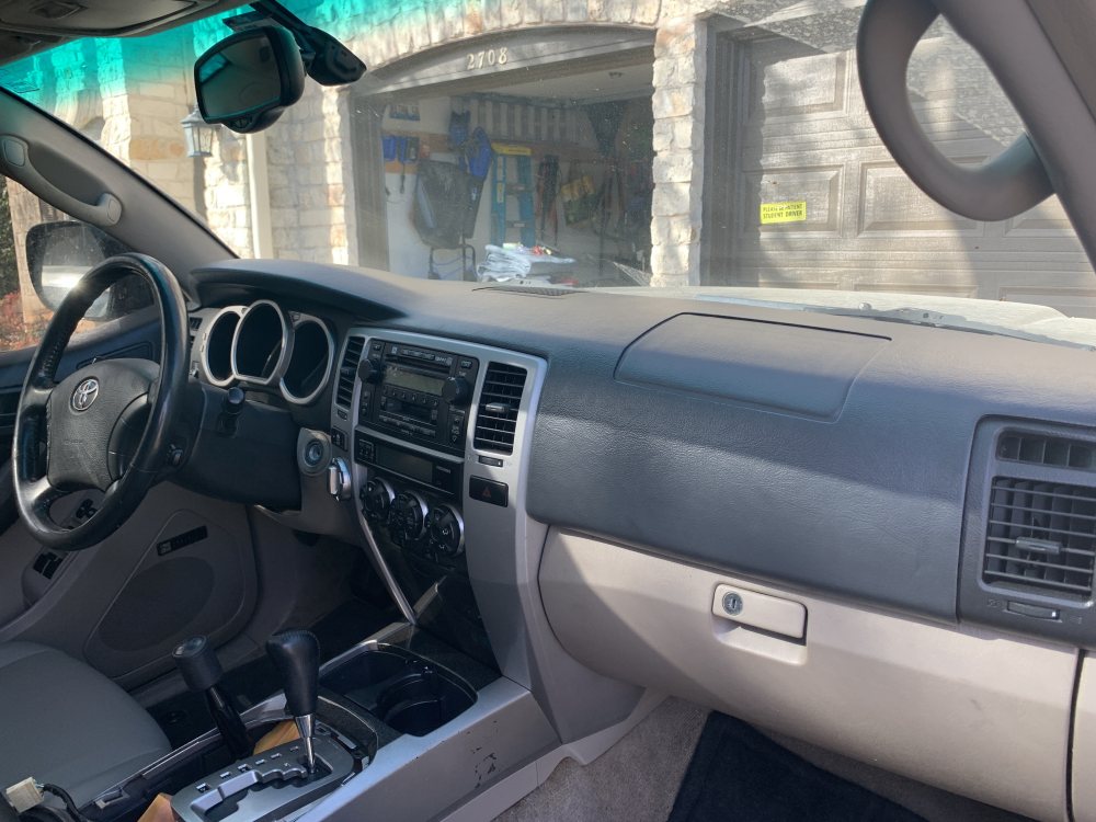

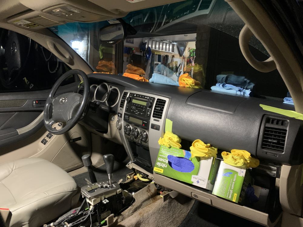

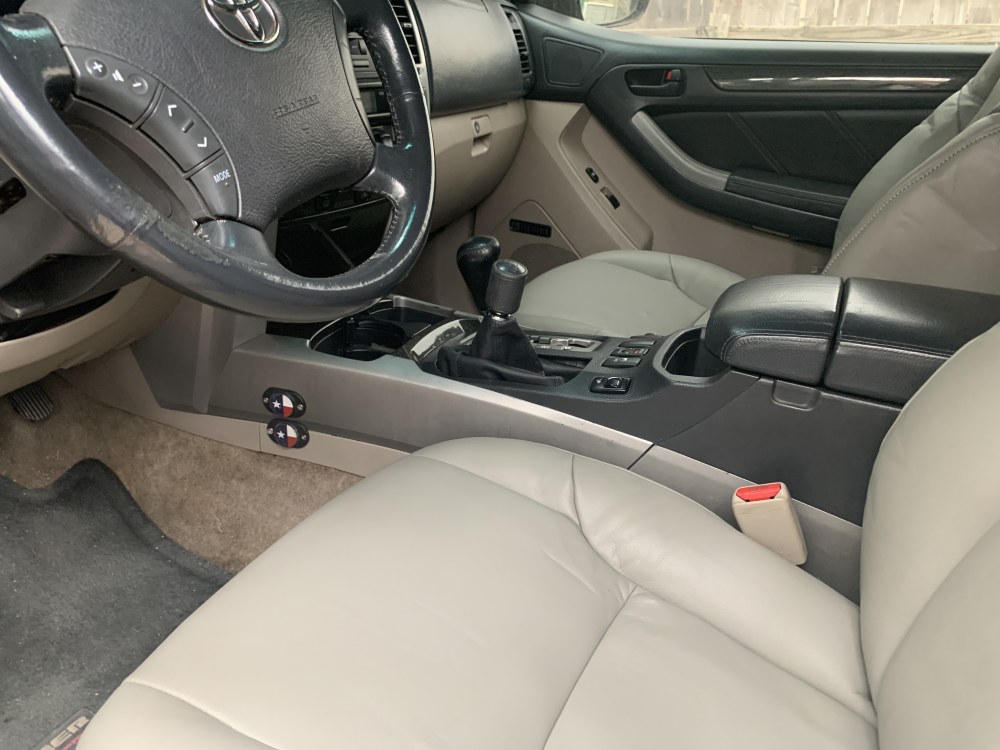

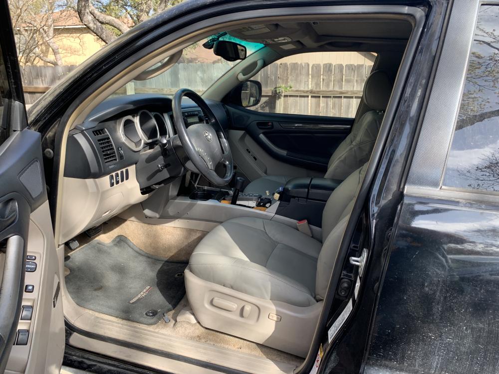

3/21/25

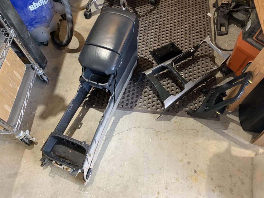

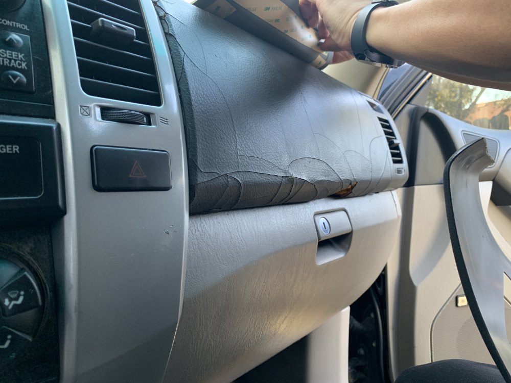

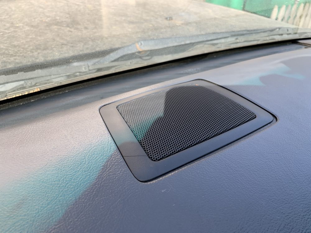

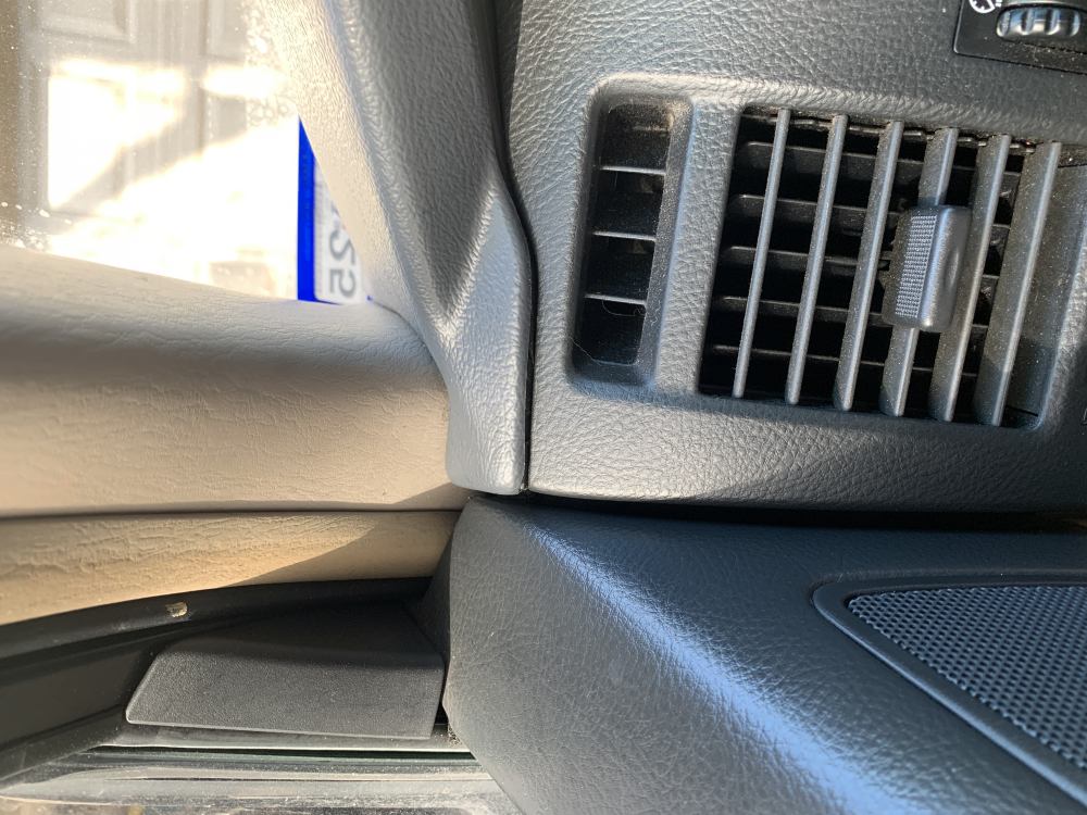

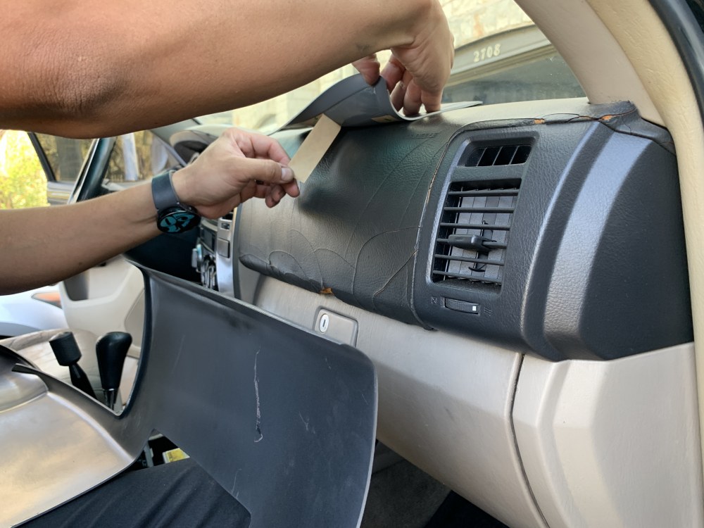

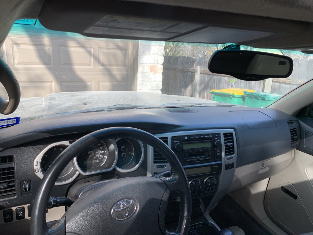

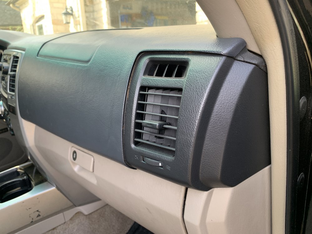

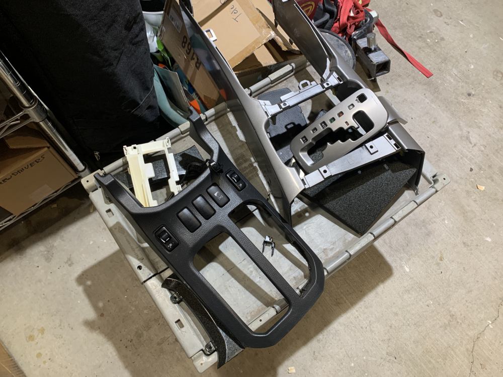

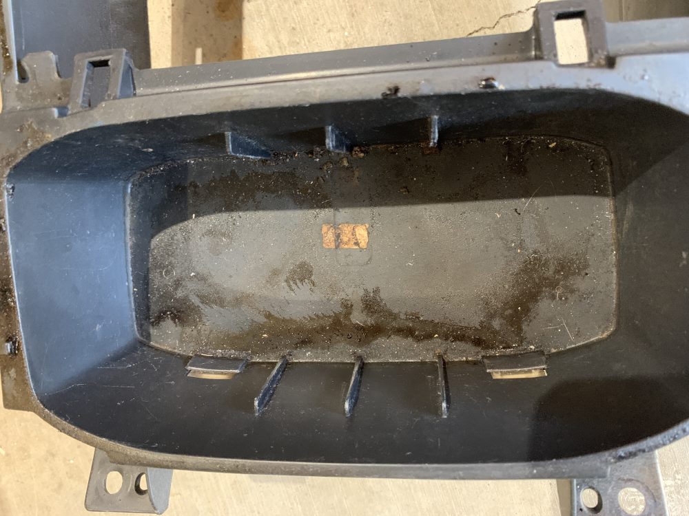

Time to clean up whatever the heck the PO spilled in the center console.

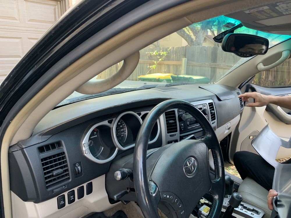

Also added a coverlay dash cover and reskinned the seats.
The dash went OK. I'd say it is 8/10 whereas before it was 2/10.
I ordered the "Dark Gray" but should have gone with black. It's not a huge color difference and 100% better than the carpet the PO had in there.

More pics.
Dash color difference is less noticeable than in the pics.
I think I am going to try to fill and paint the ends that are still visible.
If I had to do it all over again, 100% go with the black.
The foam is just to quiet some of the noise form the T-Case till my dynamat gets here and I can install it & seal up the shift boot.
But the foam is actually working quite well for now.

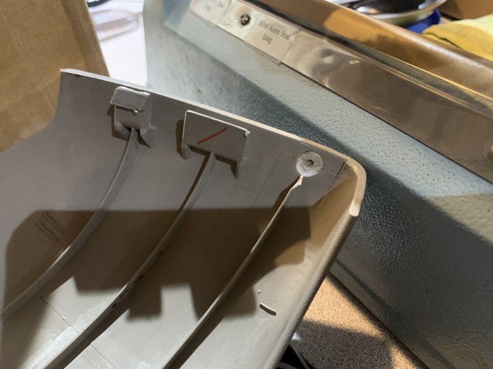

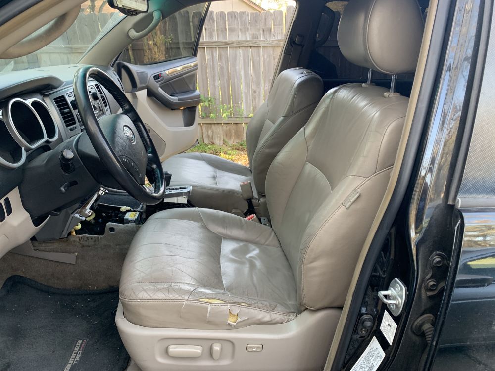

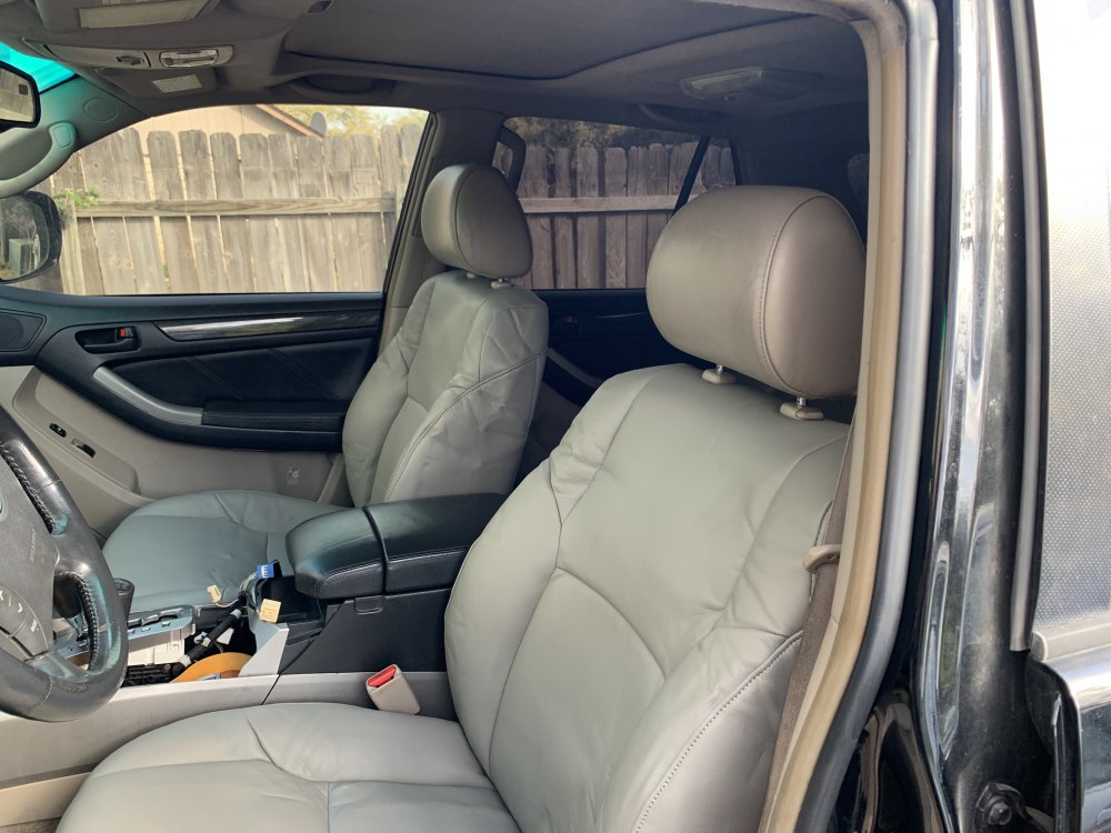

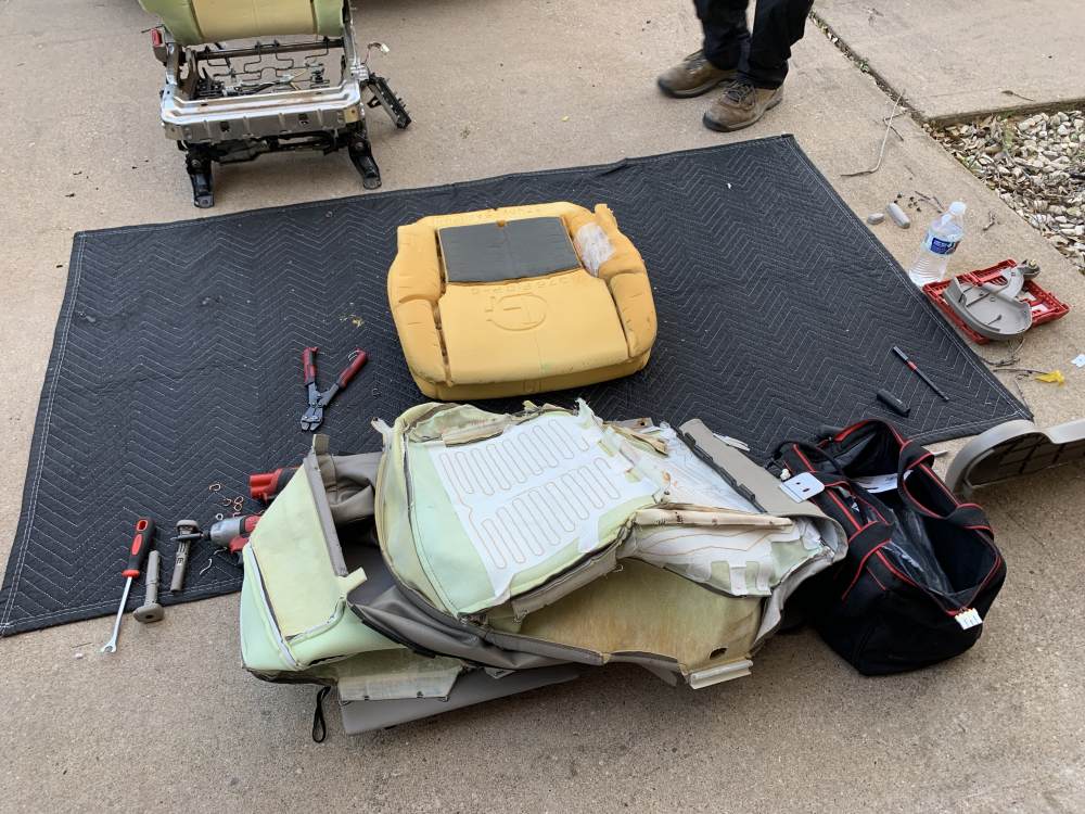

And of course the seat skins.
Install was not easy but they were $100:
Amazon.com
Broke a screw stay so I ordered a new piece.
Color is more grey than the stock tan, but less noticeable in person and less trashed looking.
100% better IMO.
I will update as they smooth out.
Probably should have replaced the foams but mine were not too bad.
We did repair one area on driver side bottom that gets the most use.
I think I may also go to black head rests with an embroidered "V8" on them because why not.

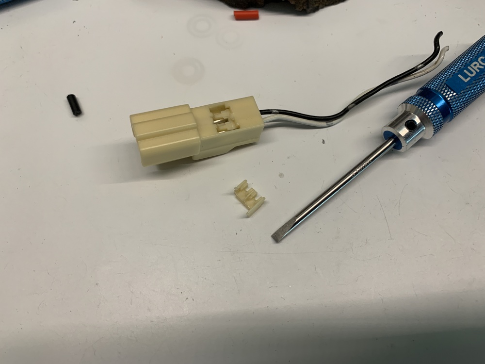

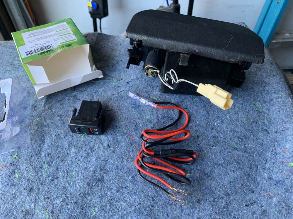

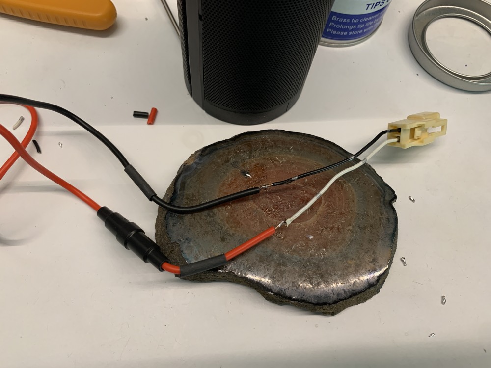

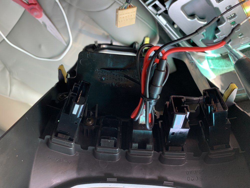

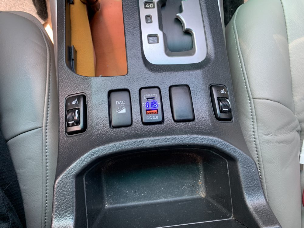

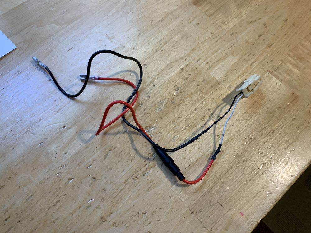

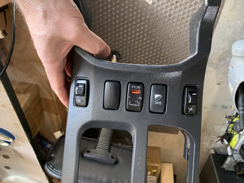

Lets add a USB!
Since I no longer have a cig lighter, I went ahead and added this USB port.
It shows voltage for the circuit so you have a general idea of your charging system but it will show a big drop when you plug something in.
So not 100% accurate as to what is happening at the battery itself.
I tried to depin the little plug to make this super clean but bastard did not want to come apart.
This is the one I used:
Amazon.com

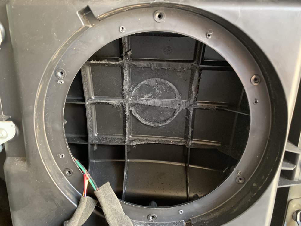

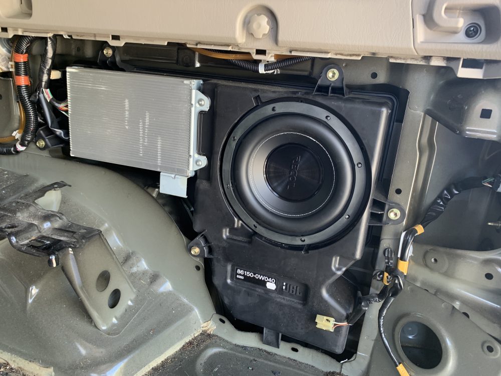

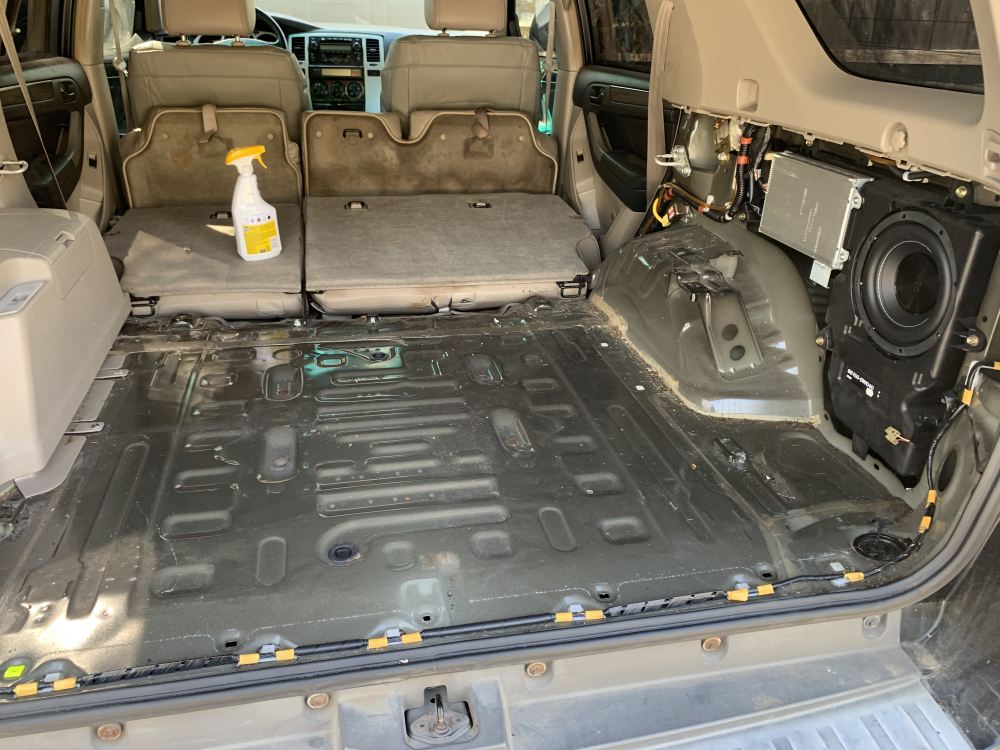

And finally I got around to replacing the sub.
What a PITA.
Really have to take things apart to get to it.
Had to modify the enclosure to make it fit.
Not quite the same diameter but made it work and feel good about it staying in place.

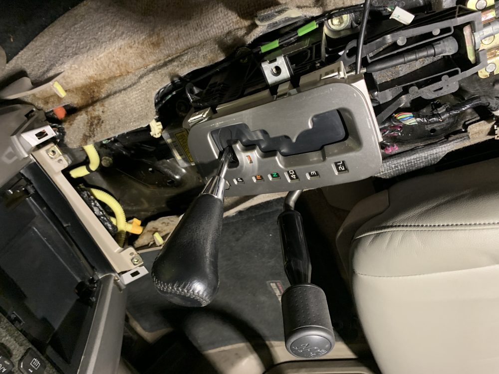

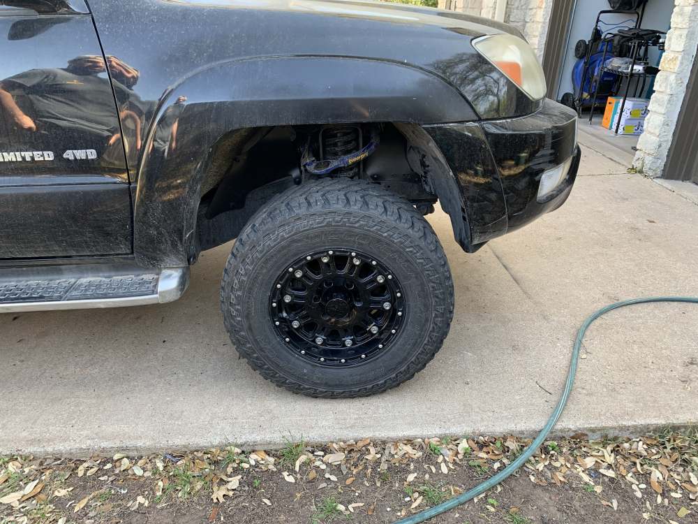

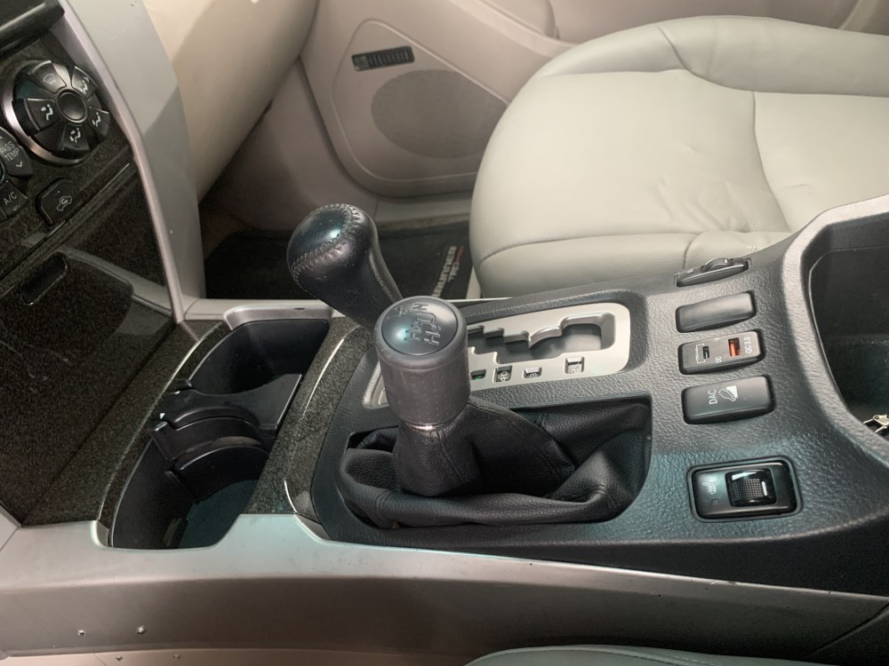

3/24/25
Added a shift boot to cover the hole.
Still need to affix it permanently but still ... better than the visible foam.
Also, playing around with caps on the wheels.
The wheels are just too busy for me and not sure what to do.
Tried removing them and then just black ones.
Might try removing the larger plastic bolts (yes they are plastic!) to see if that is better.
Not sure if I like the black caps but I guess I could make some center deals that say "Locked Up" or something silly.

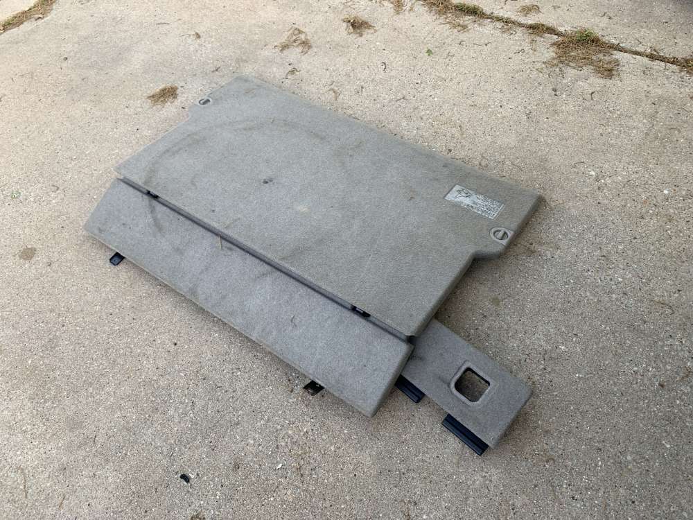

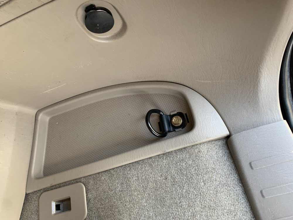

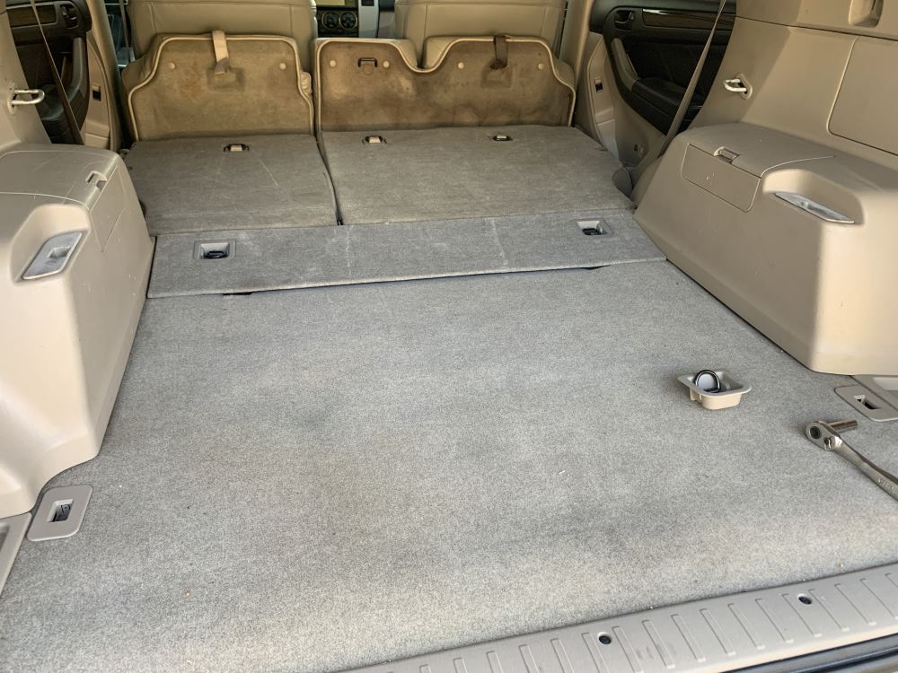

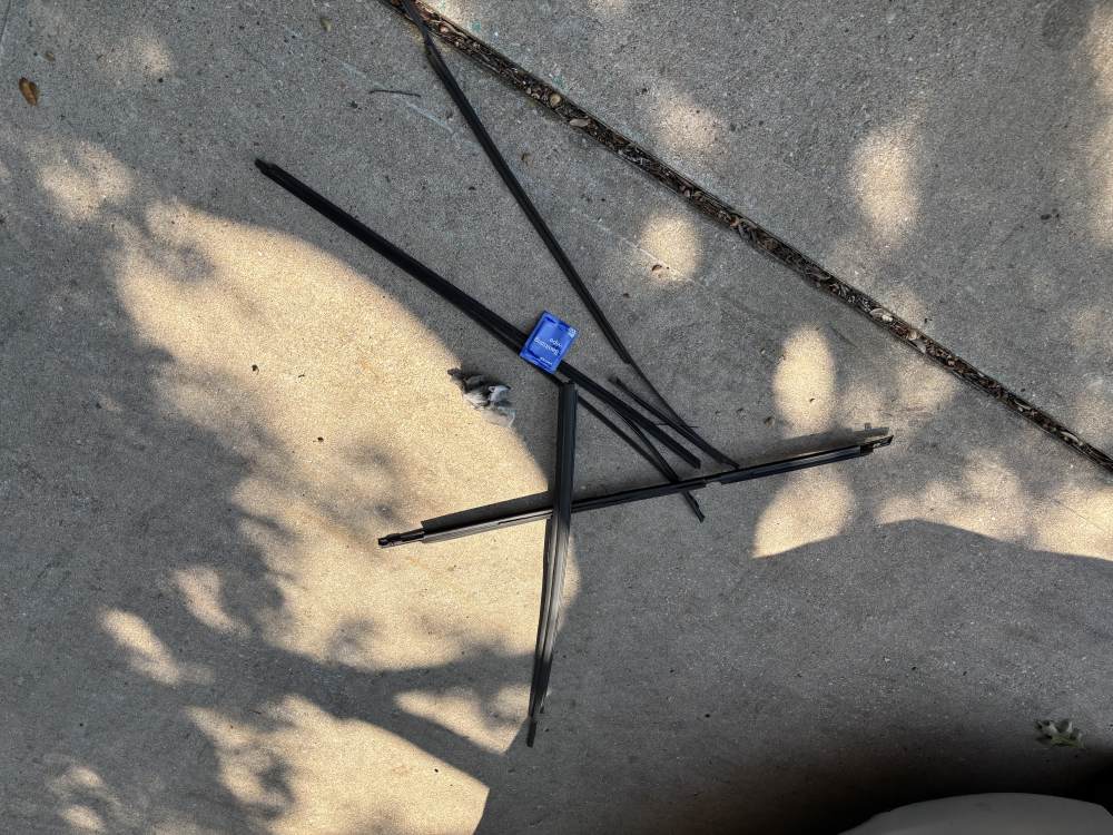

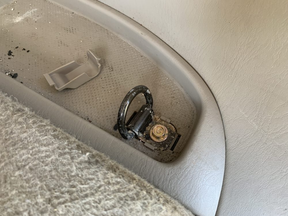

Pulled out the rear shelf system.
I didn't "hate it" but for me this is better.
If you are thinking about doing it, this is a easy change.
You really only "need" the 1 big cover & 2 little cups (they are deeper when you have the shelf).
I don't have all the parts to make it perfectly clean though.
The carpet and the cleats on the wheel wells would be different but I couldn't find them in good condition.
I may find something to put under the edge of the carpet if it bother me after I get the weather tech mats.

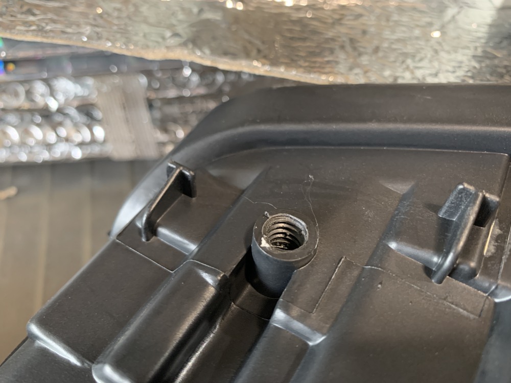

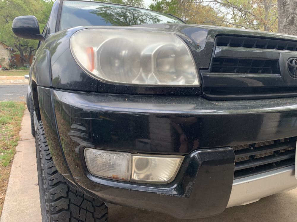

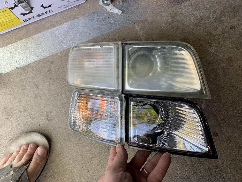

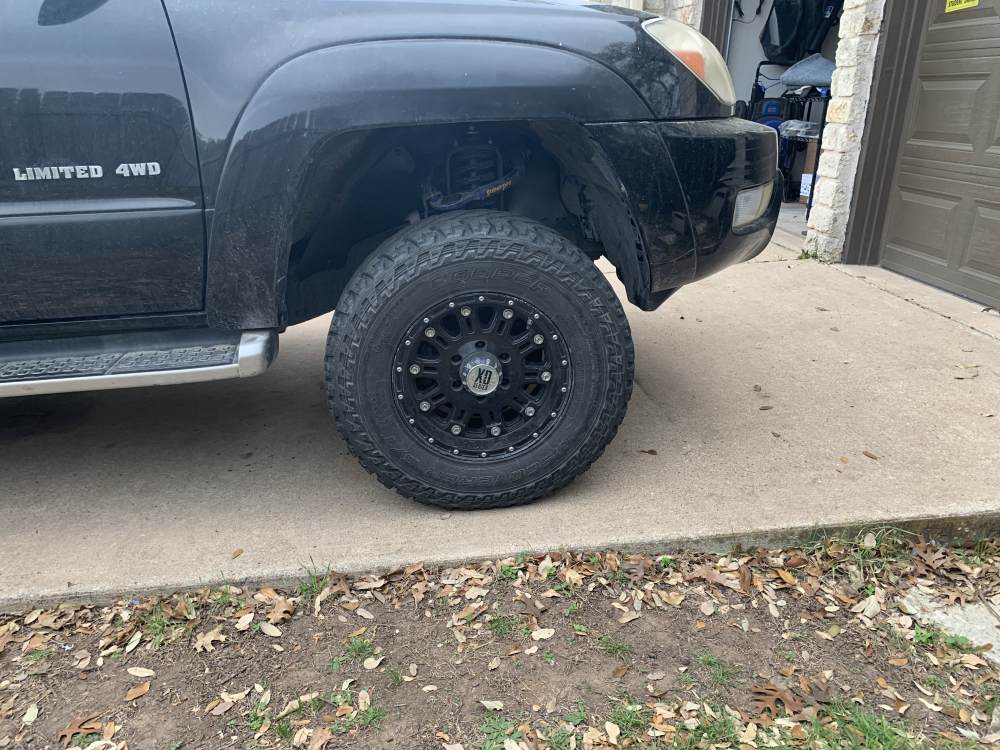

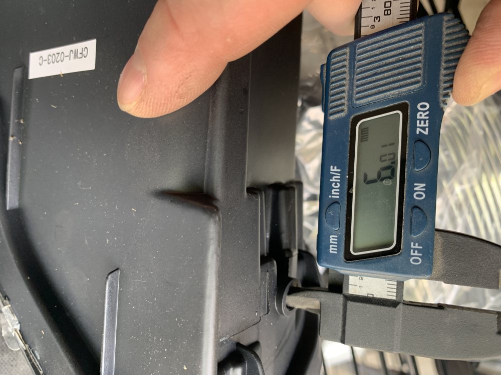

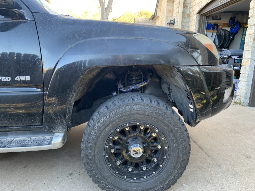

My pass side turn signal housing was leaking & filling up with water.
So each time it would rain I ran the chance of it shorting the bulb.
All my lights were cloudy and since I have a headlight restore kit lying around I figured the easiest/cheapest thing to do, for now, is replace what is in there.
Just to get it road worthy.
I ordered new parts from Amazon.
Blinker Housings
Fog Lights

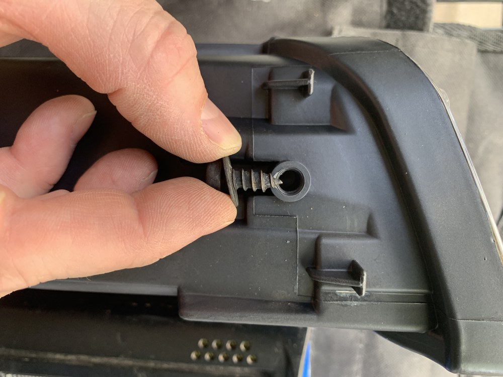

The blinker housings went right in.

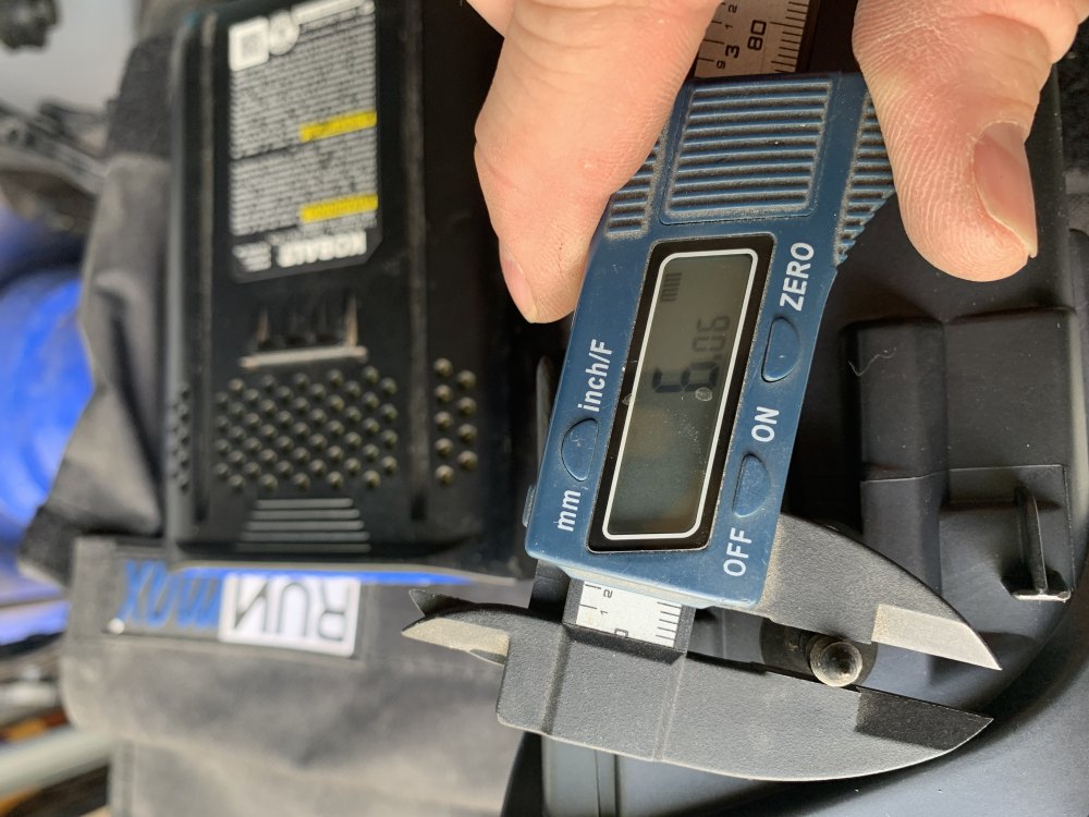

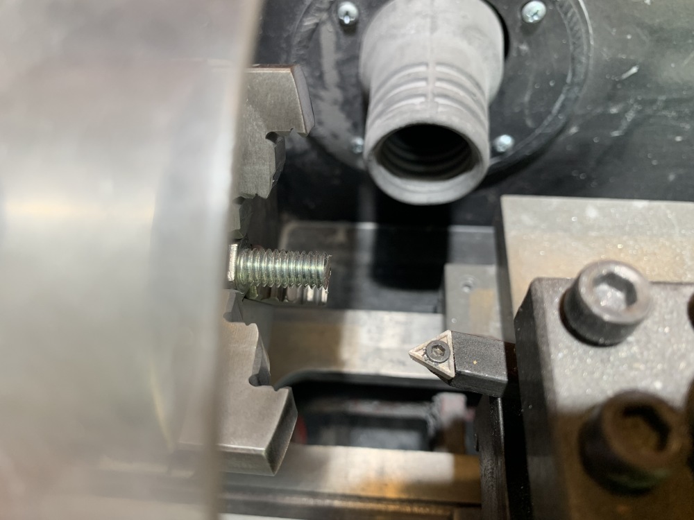

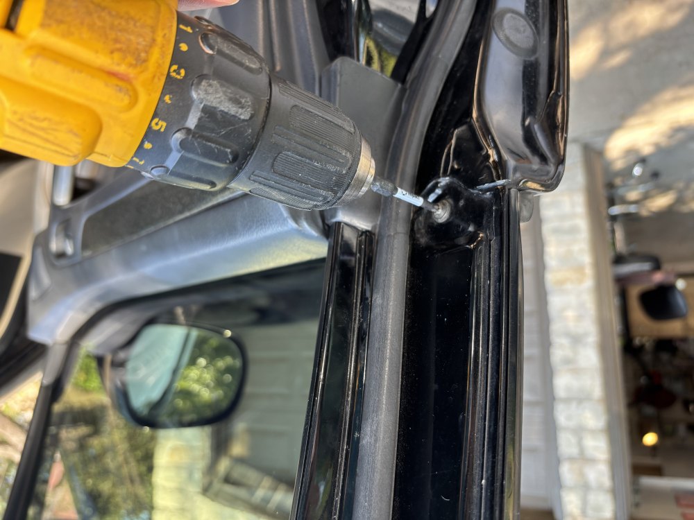

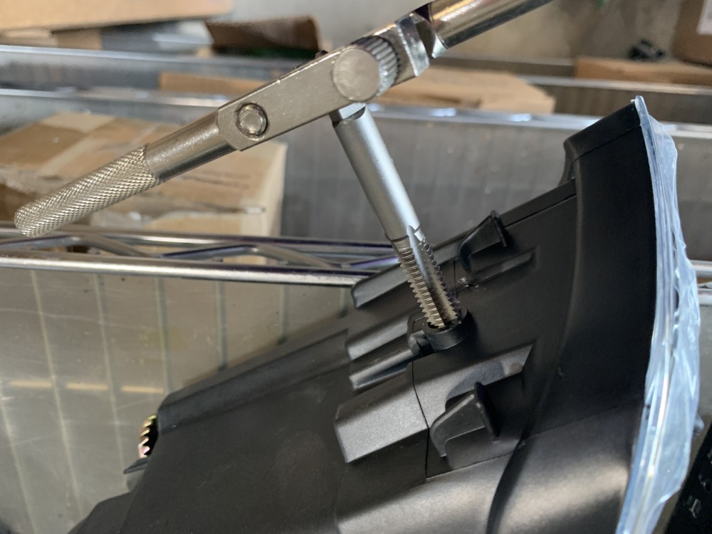

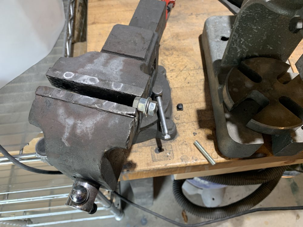

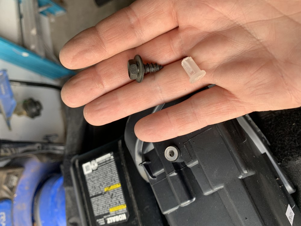

The fog lights had a minor issue.
One of the screw holes was the same ID as the OD of the OEM screw.
So that wasn't going to work.
First attempt was to cut down and glue in some plastic sheet rock anchors.
The glue failed so I had to come up with something else.
I suspect I could have used a 5/16 lag screw and just dulled the tip so it didn't bust through the housing.
That would require a trip to the store.
I'm impatient.
I opted to modify some hardware I had lying around.
Tapped the housing.
Cut the screw to match the length of the OEM unit.
Chamfered the end.
It worked just fine.
Anyway ... this is a VERY easy swap to make if you are in this boat. Just check your bolts first.

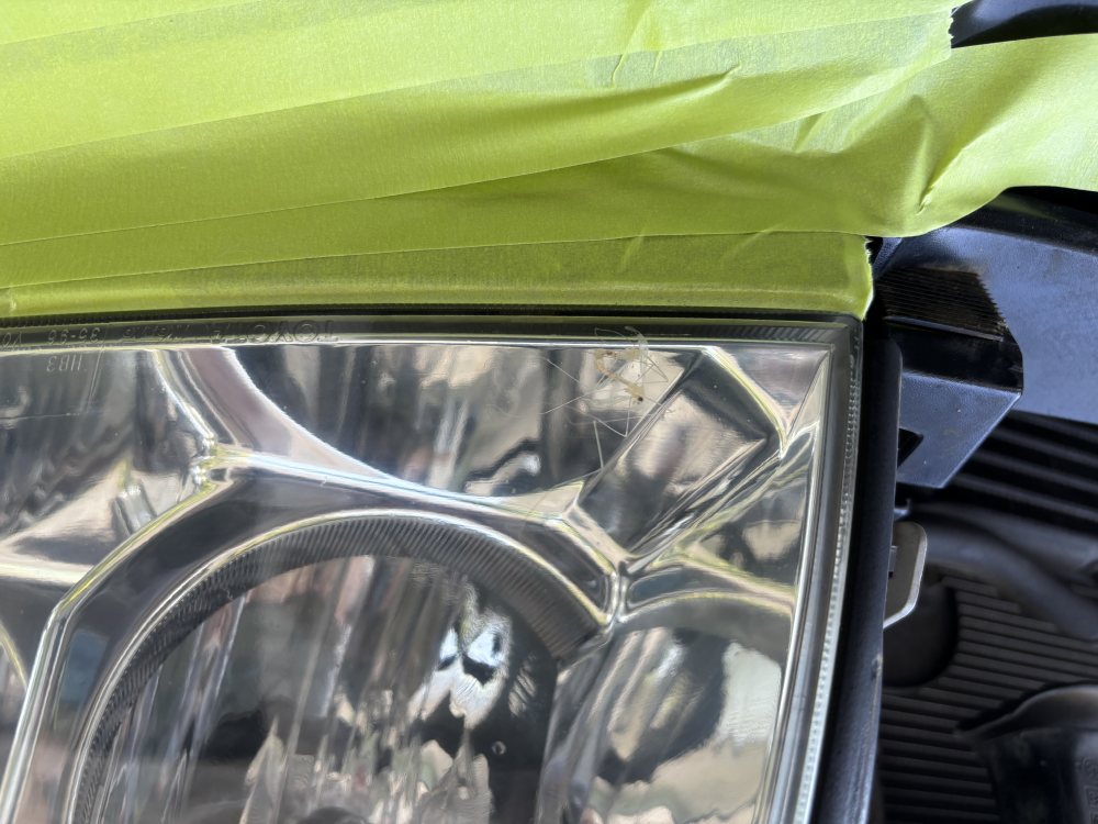

Been too long since I updated!

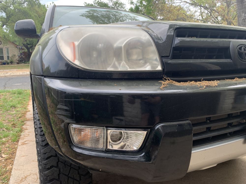

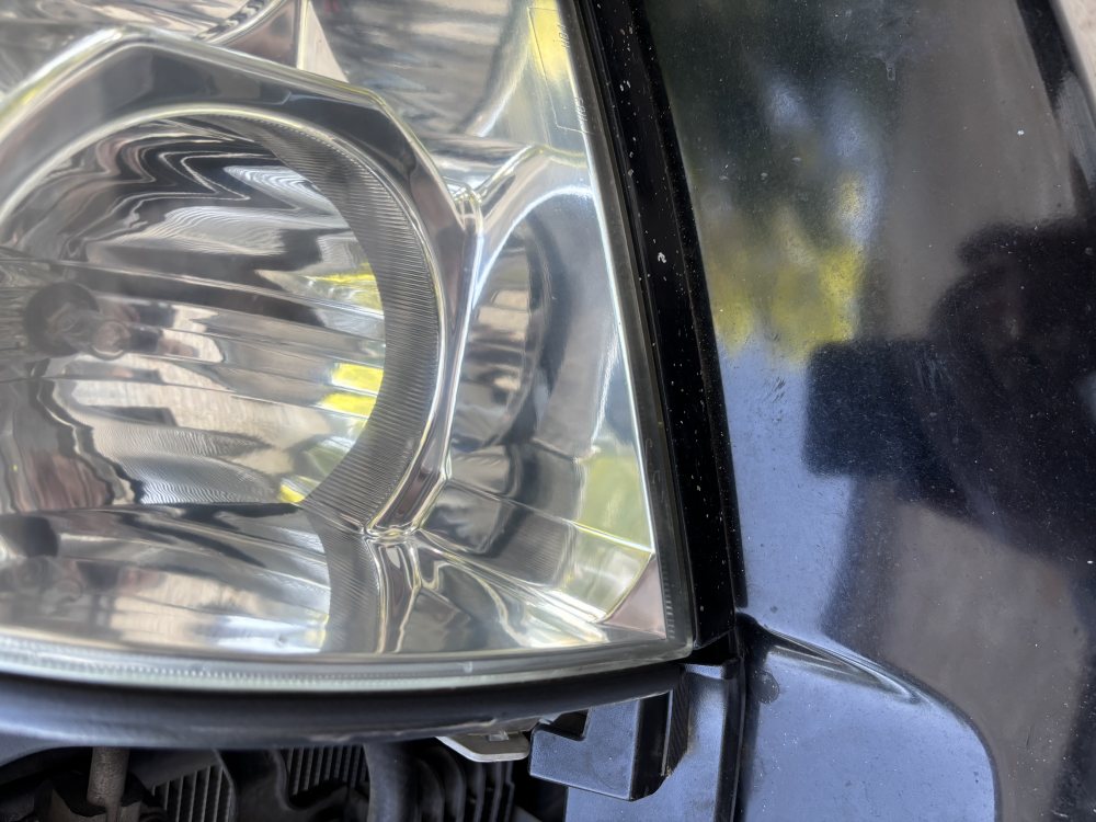

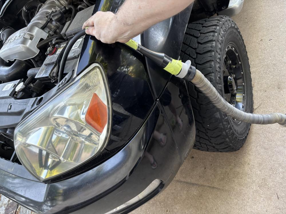

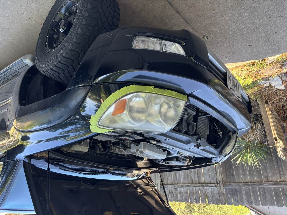

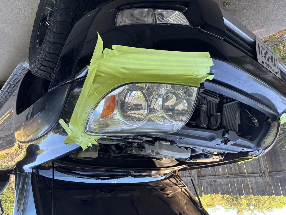

Back in April I went ahead and redid my headlights.
Nothing out of the ordinary but I did come across the most sun baked bug on the planet that I sucked out with a creative hose attachment. :wtf:
They look so much better!

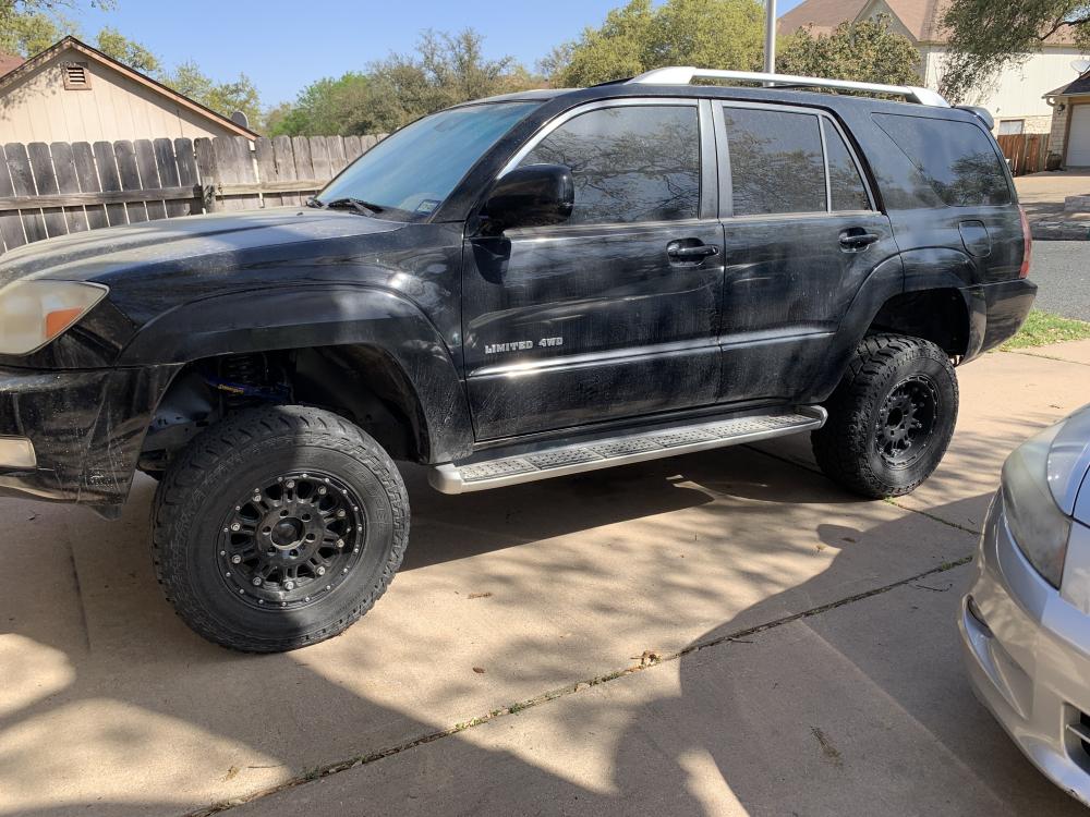

...And putting it to work in late April.
We headed out to Texas Crawlfest with a bunch of RC gear.
No complaints about the truck for this trip about 90 miles from home IIRC.

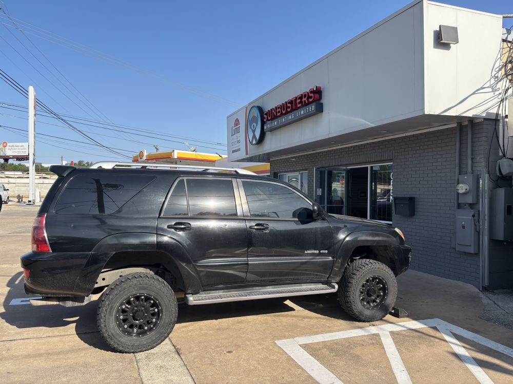

5/8/2025

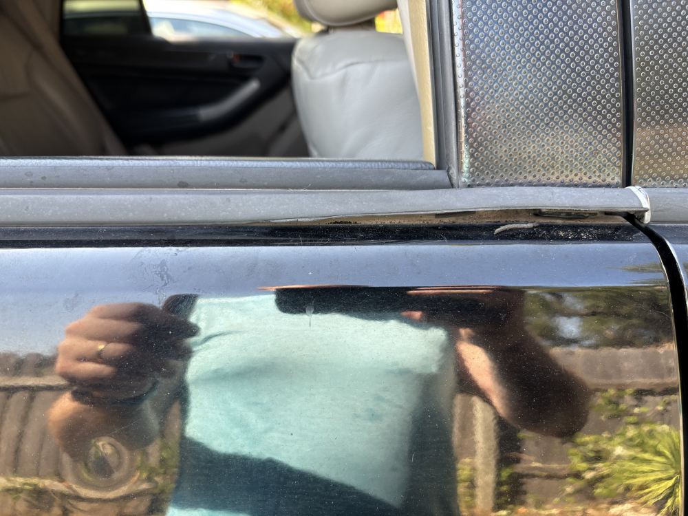

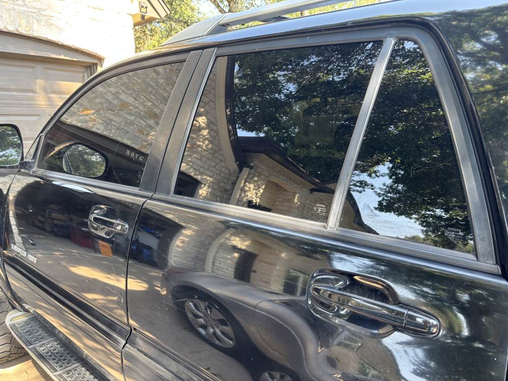

Ceramic Tint Day!!
I had the entire truck done by Sunbusters using their Formula One Stratos. 30% Front sides & Sunroof.
5% Rear sides.
15% Back Window.
Used "Air 90" which is 90% for the windshield.
Made a pretty big difference in the heat for me.
Photo is before but I'll get some afters eventually.

And today was weatherstripping day.
Woohoo!
I thought the parts were confusingly labeled but they were all correct.
I guess check yours before you rip the old ones off because they probably will not com off in one piece.
