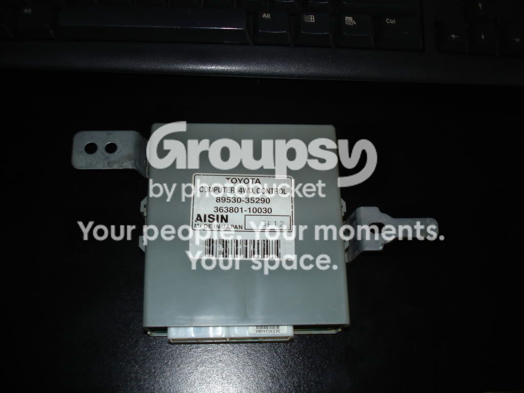

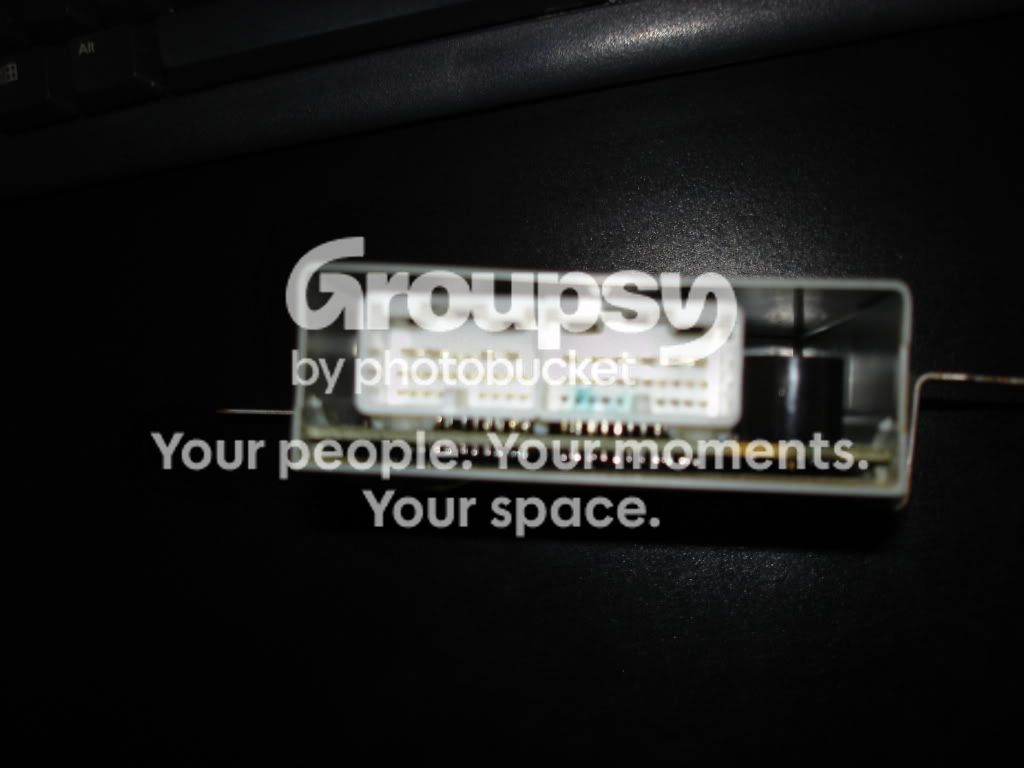

There is a 4WD control module behind the glove box. My center diff would not lock and it turned out moisture had gotten to this and corroded it. Maybe this is the culprit for the center diff and possibly the 4Lo too.?...

here's what it looks like:
DSC02461.jpg~original
corrosion:
DSC02463.jpg~original
