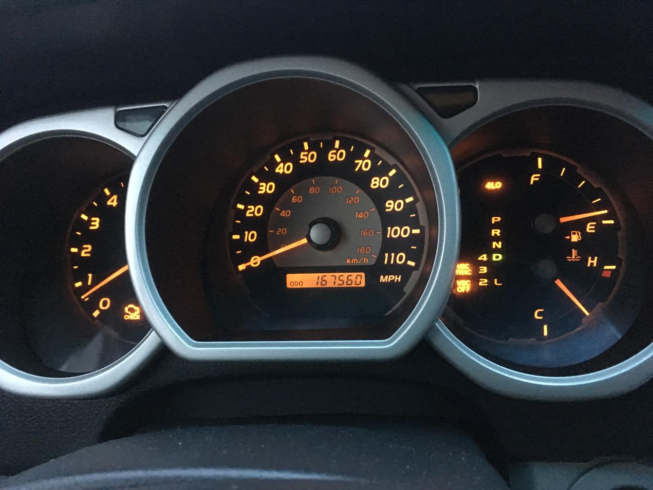

I went out on a coffee run earlier and the "4Lo" light was blinking "VSC OFF" "Trac Off" light was on. I never put the vehicle in 4Lo and the switch was still in 4Hi. I have tried everything to rectify this. I can even get it into 4Lo without the blinking after playing with the switch and center diff, and the truck is indeed in 4Lo. It will even disengage by switching to 4Hi, but it beeps at me until turning switch to 4LO where the light is steady 4LO but truck is not in low range.
Any ideas?
Any ideas?
When you're stopped and in nuetral, if you switch to 4low, (once it stops blinking) and then to drive, it keeps blinking and beeping for you? it sounds like 4low is not engaging for you, to me at least.
The switch is in 4L, but the truck is definitely not in low range... when I try to move the switch back to 4H while in Neutral with my foot on the brake the 4LO light just blinks and won't allow me to shift into D without beeping. It's throwing a frozen actuator code, but if I play with it enough I can get it to engage into 4L. Here is a pic of the dash...
JTR, I'm currently experiencing the exact same thing in my 07 V8 4WD.
Did you ever get yours figured out?
