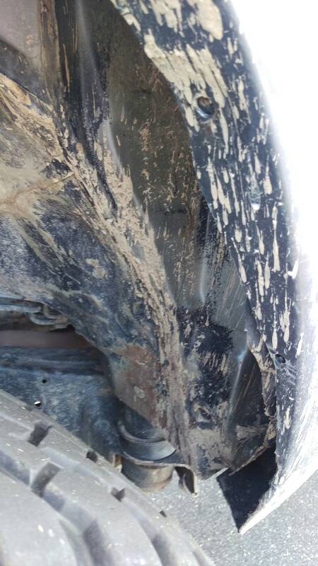

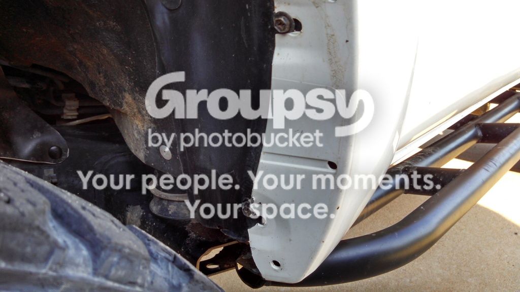

Did anybody have to trim any of the plastic near the body mount when doing a body mount chop. I just did the body mount chop, but at full turn I am still getting a little rubbing when backing up.

I also have rubbing at the rear of the wheel well even after removing the mudflap fully. It rubs on the fender flare. I think this is due to the higher negative offset wheels and tires that run large for this sizing for me. I was able to tweak alignment to get the wheel slightly more forward in the wheel well and doesn't rub most of the time.

yes, I also have removed my mudflaps. It seems to rub on the flare and also a bit on the wheel well plastic. I will have them move the wheels forward as much as possible on my next alignment. Not sure any trimming can be done.

Ya that's a common spot depending on wheel offset. Mine is cut quite a bit to fit the 35's.

I had to trim there even though I don't rub on the body mount. Only when flexing though. After trimming a bit I've rubbed on it maybe twice. A rock got caught between it though and popped a couple clips on my fender and cracked the fender material across the bolt just above.

do you mean the body mount or the plastic is cut..
any pics of how you trimmed

Both. Depending on wheel offset, tire size and lift amount. The plastic is just too close.
I had to ditch my inner Liners, flatten the pinch weld, hammer it back about another inch, trim flare and bumper. Lol
