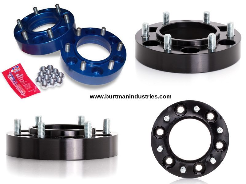

- add some Spidertrack spacers for a little wider stance
(I recently put spacers on my Mustang after springs, holy smokes, it looks fantastic).
I can make any size front or rear spacer you may need. Let me know.
Also, have the spidertrax in stock, blue or black:
Spidertraqx wheel spacers at Burtman Industries
