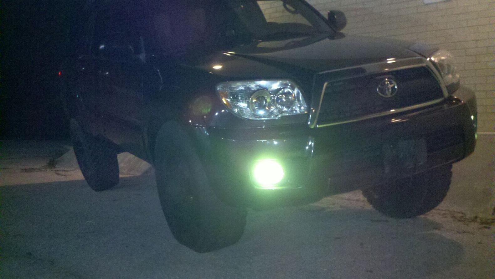

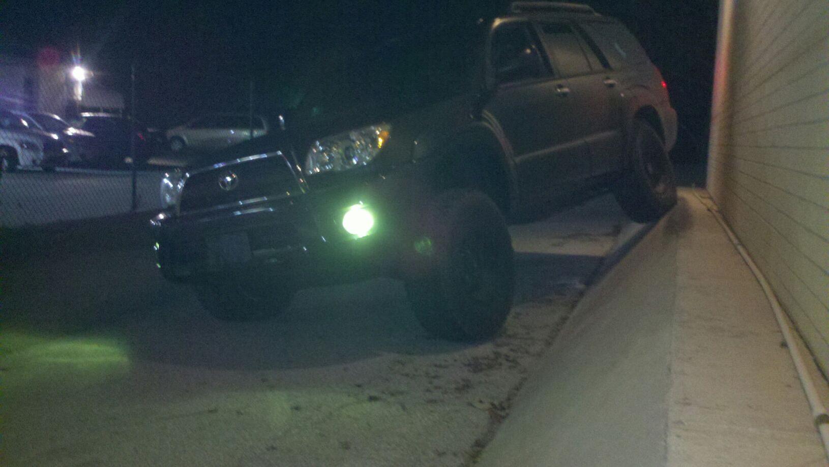

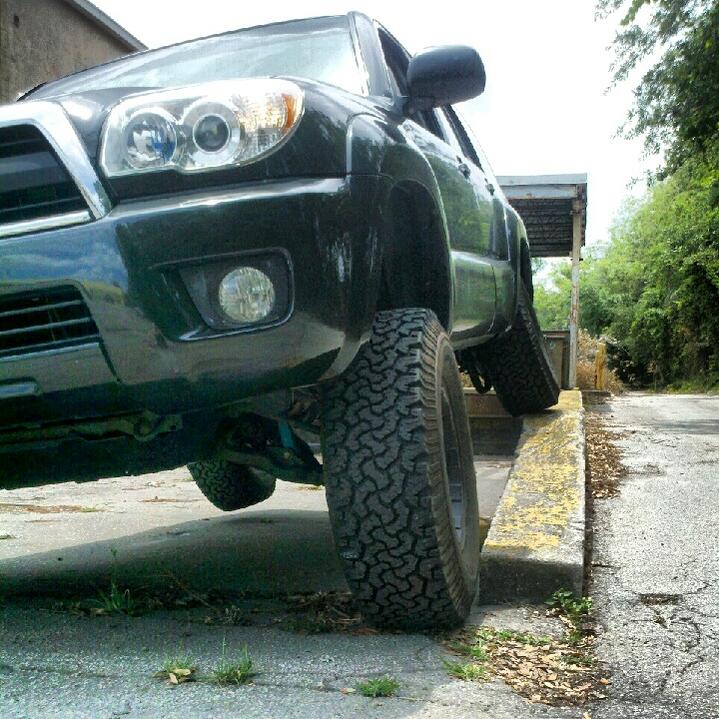

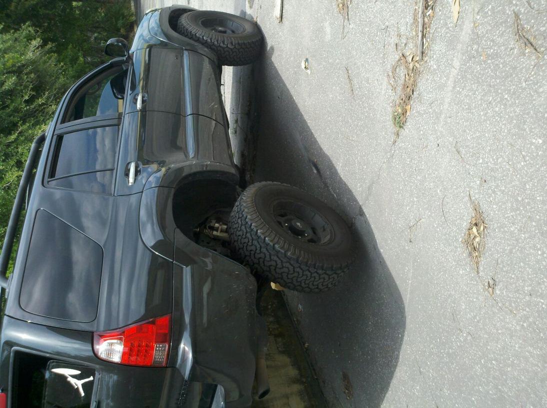

This forum member: "surfmobile" ran a 4" lift spindal with fox 2.5 adjustable extended travel coil overs set at zero lift. (spec'd for FJ's/Taco's) He sent me some travel pics when i was interested in purchasing his CO's which look as if there still for sale in the suspension section http://www.toyota-4runner.org/sale-suspension-wheels-tires/116501-fox-extended-travel-coilovers.html
Durring the convo i had with him pre purchase he recommended i used a three inch top out spacer to get my lift and keep the coils set at zero lift for more travel and smoother ride..
but these are the pics he texted me to compare... hope he doesnt mind lol...
this one was running coilovers set at three inches (showing down travel) Ill add this guy is in a prerunner 2x4 so some of these pics will show with lift spindles..
this one was running coilovers set at three inches (showing up travel) also he's running OME 3" rear lift coils
this one he had switched over to long travel rear added 4" lift spindals and set the coilovers at zero (showing down travel)
this one is same new setup coilovers set at zero (showing up travel). so basicly you only loose down travel when the coil overs are cranked up. up travel is not affected at all.
