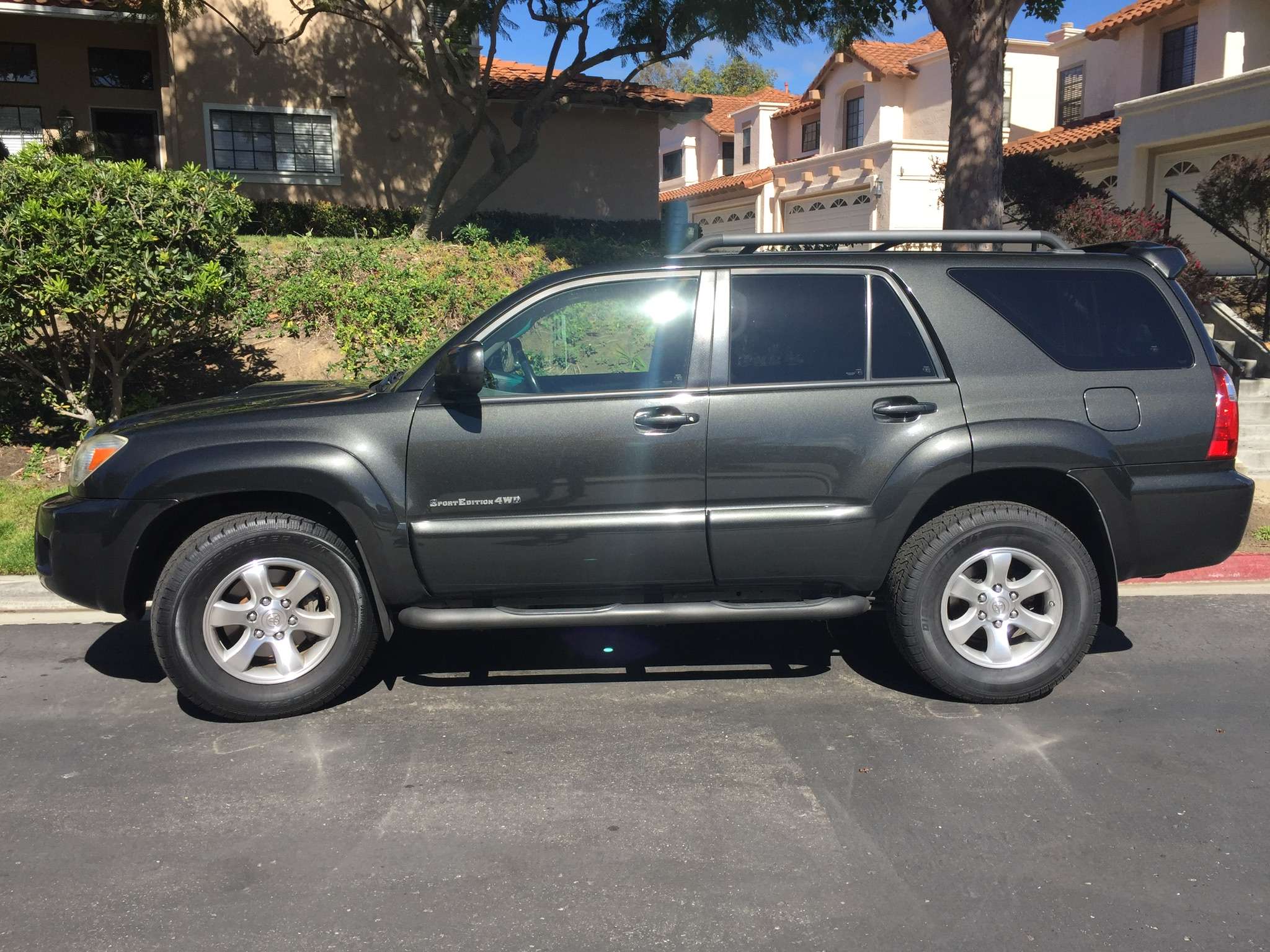

Just purchased an 07 Sport V8/4wd and wanted a full 3" lift. After research on this forum went with bilstein 6112s up front set to highest clip for full lift, ome springs rear with 5100s. Built right UCAs because I thought i was going to need them.
I'm only getting 22" from center of hub to front fender and it only seems to be 2.5" not 3" as expected. Rear is a full 24" so it's ok.

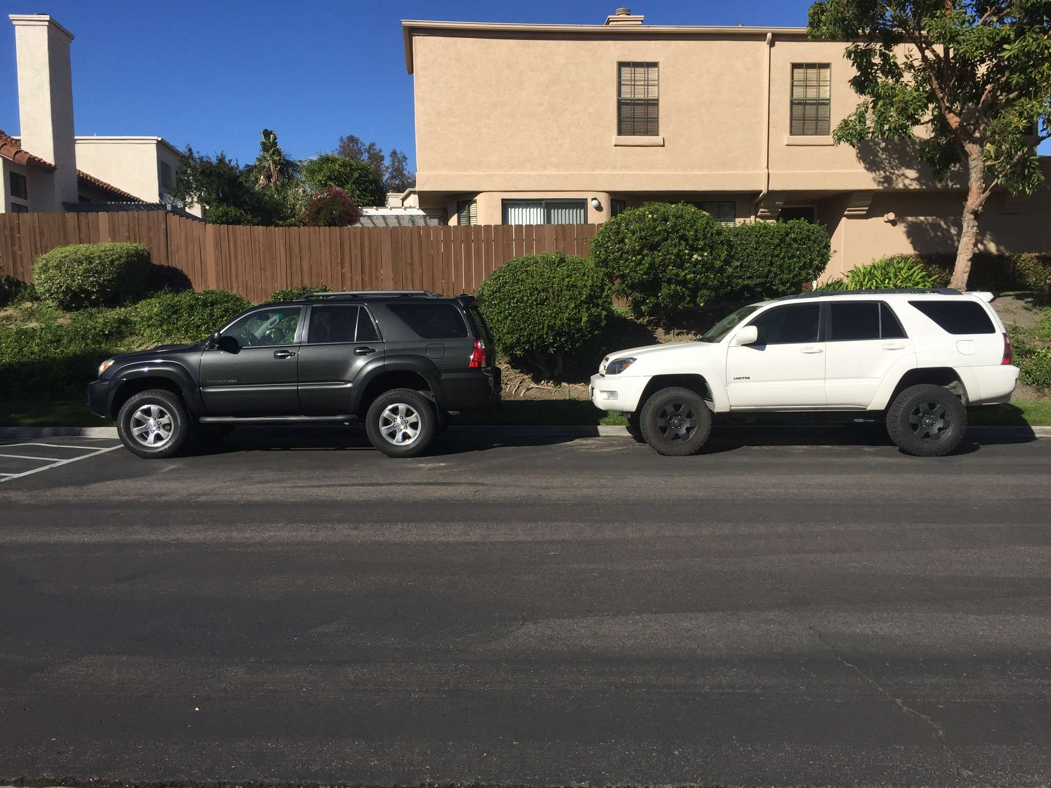

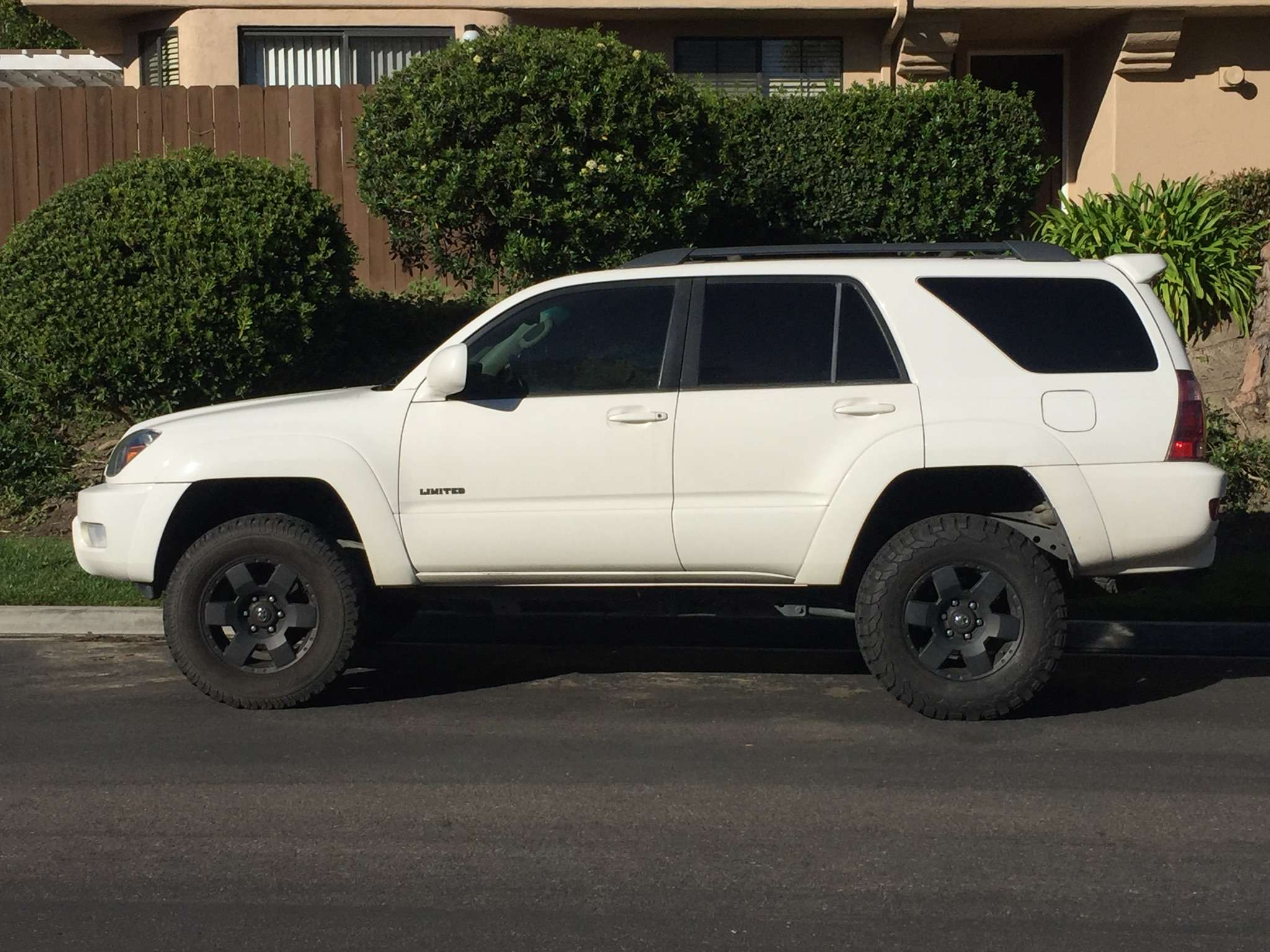

As comparison I have my previous 2003 v8/2wd 4runner with fj coils and bilsteins 5100 set to next to highest setting and it is 22" from center hub to fender, it's also the 2003 straight fender so maybe a touch lower so actually more than 22".
Btw the ride is great but just want a full 3" up front. Is it because the v8 and 4wd? I was going to use OME and 885 springs but saw the 6112 and seemed that a great upgrade.
Here is stock pic.

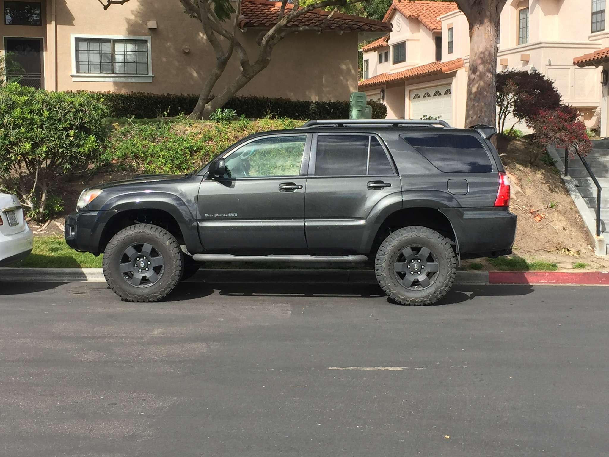

After lift
Old 2003 with fj coils and 5100s.
Both
Called bilstein and explained the situation and they said only one spring rate for the 4runner is 600lbs, no ther spring option. The V6 could get a max 2.75" and the v8 4wd less, 2.5" or lower max.
So now the question since I wanted a full 3" lift should a put a spacer like OME 1/4" to get 1/2" total? Or do I get the 650lb coils that come on a tacoma for the 6112? Would 650 be too much?
Thoughts?

I like the way it looks. If your measuring 22"s center to fender and the OE height is 18.5 to 19"s i'd say you are at or darn near 3"s.

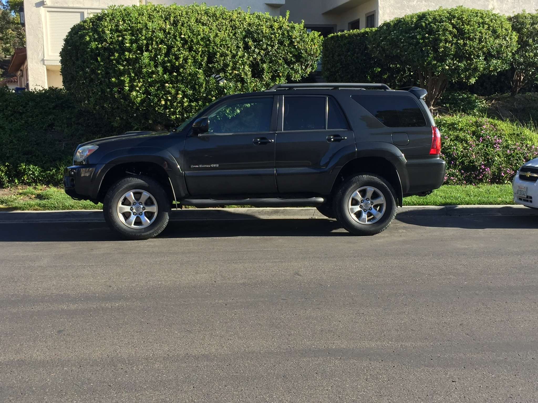

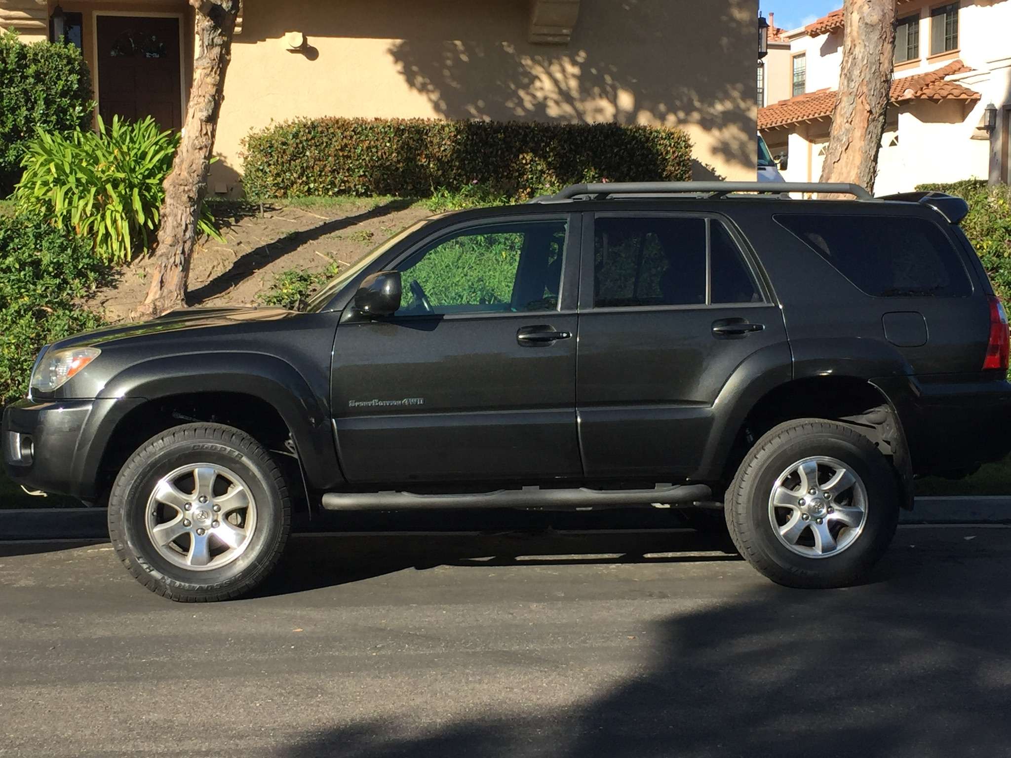

So with some interesting results we found that the King spring 14" with 3"id fits the 6112. So we popped in two king 700lb springs to test and see how the ride was and if it was too stiff? If so we would just pop them out and put a 1/4" spacer and be done. Well... After my installer put in the spring and set in the middle clip he went on a test ride.... Amazing ride quality, but, in the middle clip we were sitting at the same 2 1/2" height. So he decided to go up two clicks and assmbled the shocks again. After a quick test ride... Amazing ride and 3 1/2" lift.
Here is the after
With wheels and tires

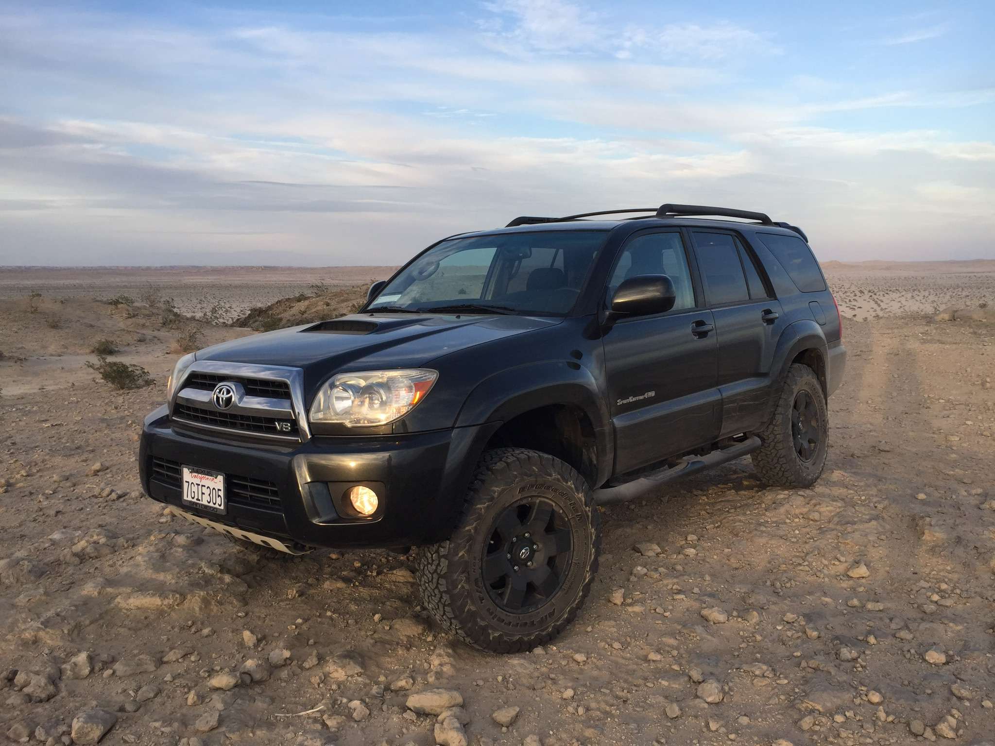

This weekends trip to ocitillo wells
265/70/R18 fit with a 3/2 lift
