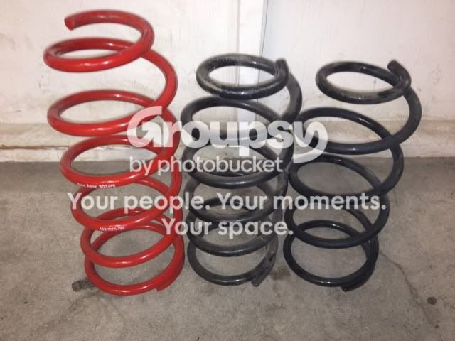

but there no better than 4th gen coils.The FJ coils do have a higher spring rate so they will be stiffer
Is there data on the spring rates? I haven't found info other than this thread.
They certainly LOOK thicker in diamter which would attribute to their stiffness over 4th gen based on the picture below from the thread linked.
Sway Away 1.5" lift coils left, 5th gen middle, 4th gen right
(5th gen has one extra wind and has a thicker diameter coil)

I may pull one to compare. In my mind more wrap and thicker coil diameter should improve the ride over 130k mile stock coils.
an improvement from OE coils with 130k on um. Especially if youre also replacing the shocks...:llama:
