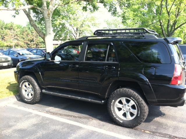

285s mounted! Trimming tonight after work!!! here is a quick pic I snapped on my way into work. Better ones this evening when I have some time.
Looking good! You'll likely get by with much less trimming on road, it's tire trails where it becomes an issue. Trimming the front bumper and moving the liner forward was all I needed until my first off road trip.

Understood, thats why I wanted to mount used tires first so I didn't gash a new set first day on the trail. I plan on going wheeling this weekend with the NE guys and getting a good feel for where I need to trim what. I am planning on packing all my trim gear in case I have to perform surgery on the trail. Hope not though.
