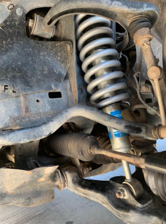

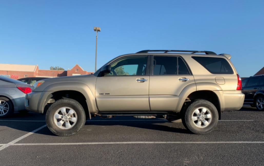

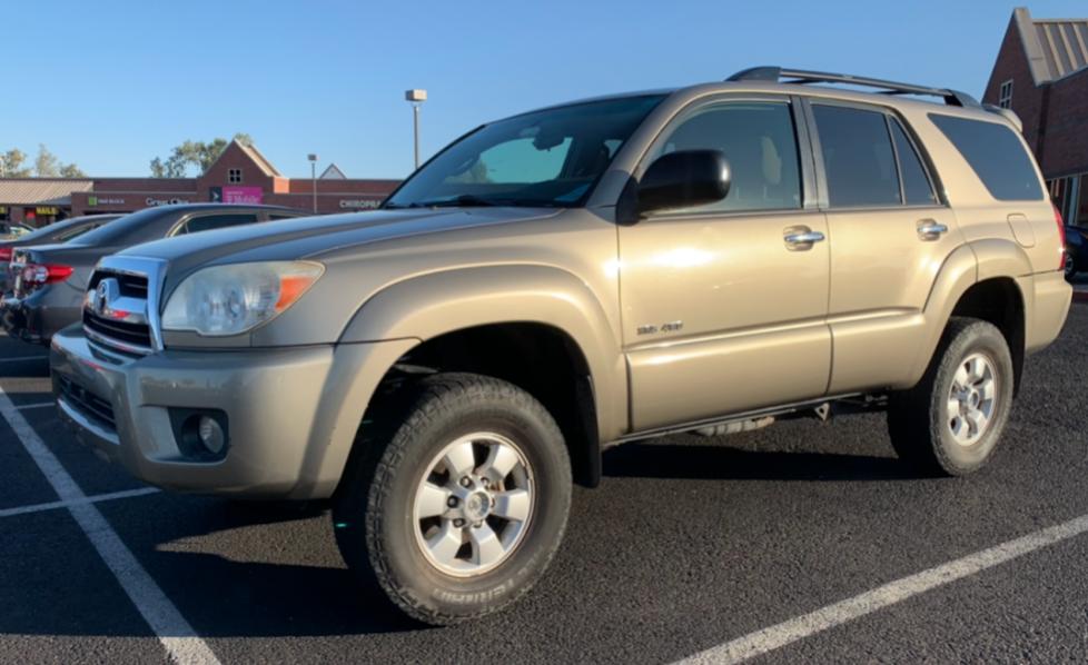

I'd like to see the pics. I'm thinking about getting the Eibach stage 1 kit.
Sorry for the delayed response. Here are the pics I took. Plan on getting larger tires very soon to fill the wheel well a little more. And like I said before I have retained a little forward rake by a little less than an inch. I plan on replacing the rear springs in the future as well, I currently have the FJ springs with 1.5 daystar spacers in the rear.
