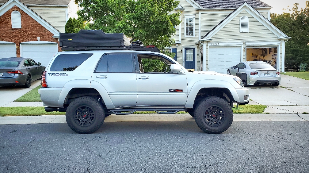

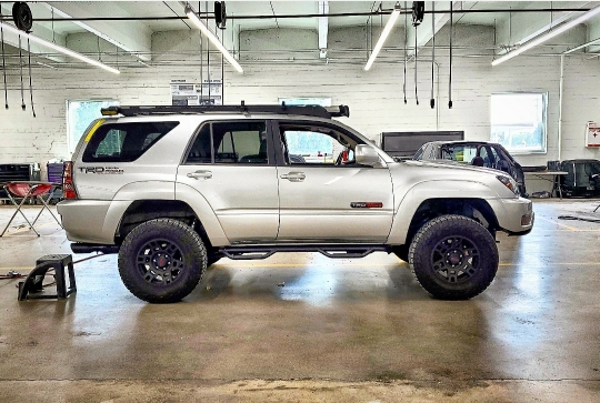

I can tell you from my mistake (or rather lack of information with the kit) I set the 5100s on the last perch with the ome springs. The nose sat damn near a 5in lift and almost blew out both cv axles lol.
If you're after the carolina squat, then you can perch em up ! ;) I ended up setting it not on the 0 perch position but the first and so far its been working out good.
First pic was the last perch, second is how it sits now on the first perch

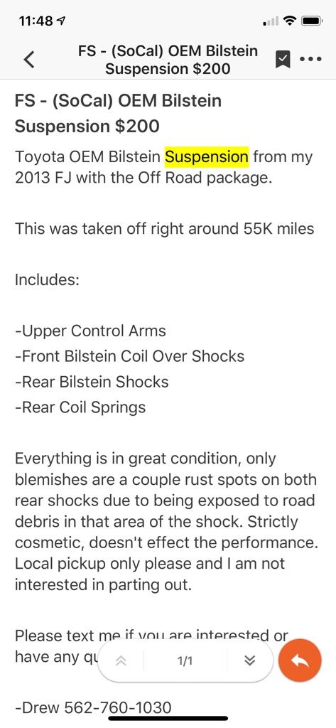

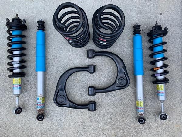

Found a set of FJ takeoffs in an FJ Forum. From I’ve read this should be a direct replacement with no modification for a 4th Gen 4Runner. Do I have the correct?
What type lift would I expect for my V8 if I were to go with this?
