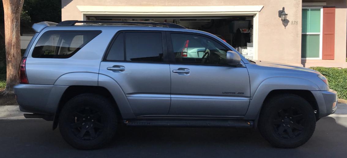

I agree with you that spacers on the front will be too much. FWIW, this is a quick garage shot of my 2007 with the same front coilover + shock combo you bought, 4Runner 4600s/FJ springs on the rear, and stock size Michelins. It's not 100% level but it's very close.
I appreciate it. Is there any shot you could get a 275/70 in the front or would it be too tight? I'm looking for a leveled out look like yours (mines even silver) and the largest tire I can fit comfortably without having to cut up a bunch of stuff unnecessarily.
That I don’t know. You might talk with your tire dealer (Discount Tire, etc.) as they’ve probably seen it all.

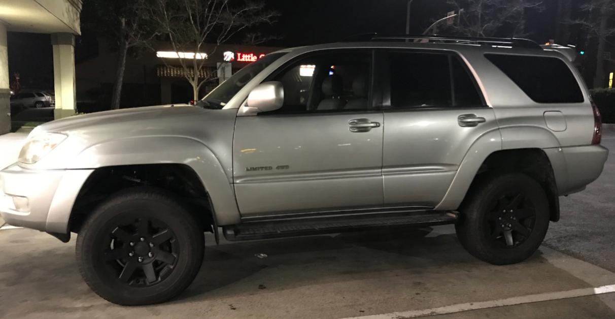

Upgraded Suspension on 05 Limited
Finally upgraded suspension on 05 Limited AWD. Here are the details:
Front: Bilstein 6112 with supplied springs; Dirt King UCAs;
Rear: Icon 2.0 Shocks and Icon 2 inch Springs
Tire size: 265/70/17 with TRD Off Road Rims
Results: 3.5" increase in front, 2" increase in Rear; Keep in mind I had 157k miles and non xreas suspension was likely sagging worn;
Ride is great and much smoother; Need to get alignment;
**Note: I chose Icon 2.0 since Bilsteins 6112 or 5100 were on back order;
Before: Day Photo
After: Night Photo
Before: Day Photo
After: Night Photo
What clip setting did you use on the 6112? How’s it ride?
It was set on the highest lift setting. I used the springs that were part of the 6112 package.

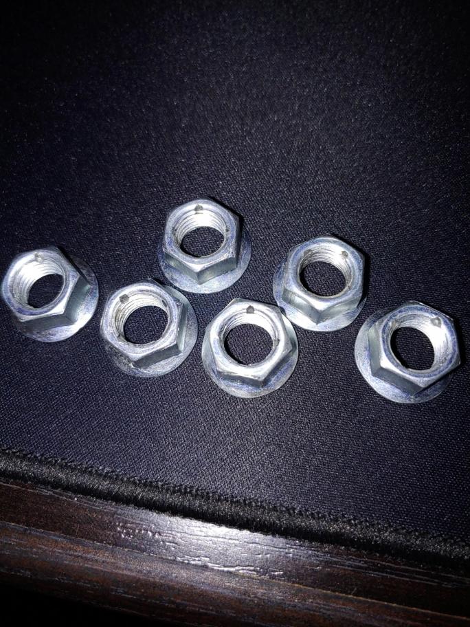

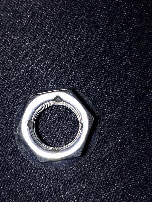

It was about time for some new shocks on my '06 Limited. I ordered 5100's and some KYB strut mounts.
Strut mounts came in today and all of the nuts appear to have deliberate notches in the threads but they are very difficult to screw down once you hit this part of the thread. Are these supposed to be there to add some resistance on the thread, or are my nuts damaged? I added some photos to show what I am talking about.
Those are a type of "locking nut" the extra tension from the notches keep the nuts from backing off/coming loose, which you don't want to happen.
